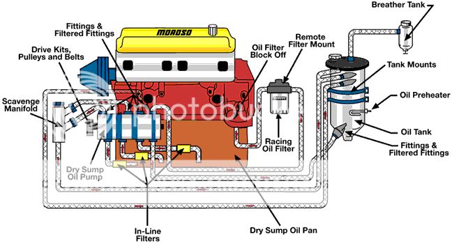

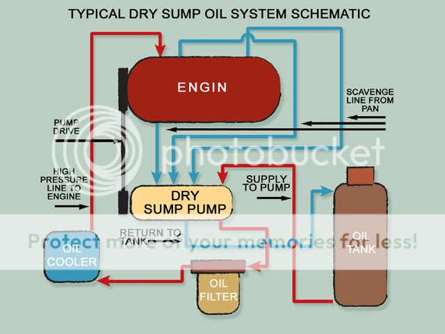

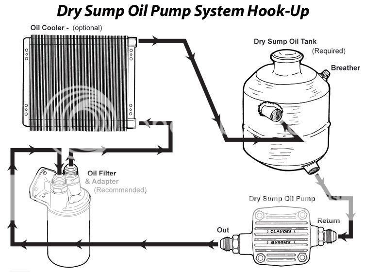

MAGNUM4342 Posted January 19, 2013 Posted January 19, 2013 Here are a couple diagrams I hope will help.
rel14 Posted January 19, 2013 Posted January 19, 2013 look at lots and lots of pictures, find out were all the pumping is run, the brake lines, brake ballis knobs are, were the rear end cooler lines go. The more pictures and information the better, most gauges are turned so the needle points up when all is normal. The above diagrams are awesome,, now you need to find the locations for everything and were its ran,, Magazine, books, diagrams, pictures,, the more the better. Good luck and have fun...

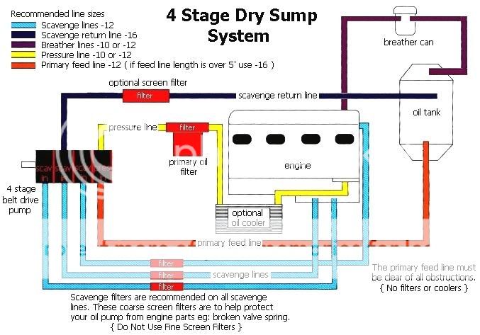

rel14 Posted January 20, 2013 Posted January 20, 2013 Forgot to post the diagram for the rear end, pump, cooler, lines,
hooterville75 Posted January 20, 2013 Author Posted January 20, 2013 Thanks for all the replys guys. Magnum those diagrams are AWESOME. Im going to try to print screen them and print them out to take to the man cave with me to the work area. They are absolutely awesome. Bruce Im going to take your advice Mate and see what hassels and heartaches it leads me too. If all goes well the first attempt, Magnum has given me some valuable info that will keep me busy for a bit the second attempt lol. Thanks again all very much appreciate our help.
