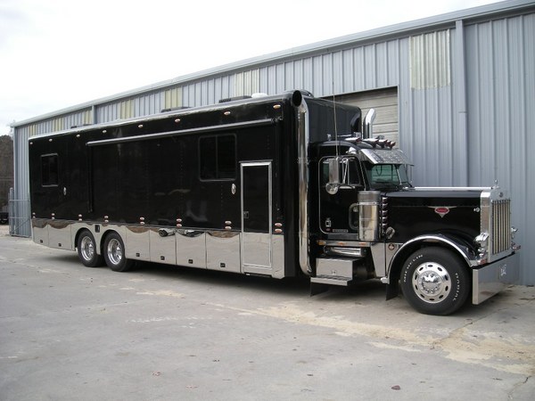

vincen47 Posted June 9, 2013 Posted June 9, 2013 Nothing yet, but I plan to start soon and work this summer on it. For the chassis candidate, I'm thinking of using the Revell Aeromax 120. I started that model years ago but never completed it - I need to switch out the engine. That kit suffers from the same geriatric diesel disease that plagues so many models. I know it costs more, but model manufactures really need to tool modern engines to go with the modern trucks. I am still planning on building another conversion similiar to the picture I posted above, so I can use the Detroit Series 60 from the Italeri 378 kit (a future purchase) for the Aeromax, which fits that mid 90's era and truck just fine.
vincen47 Posted June 9, 2013 Posted June 9, 2013 Thought this one would be a close match to the S&S coach body demensions and style.

oldr-n-drt Posted June 10, 2013 Posted June 10, 2013 vincen47...go to www.ssweldinginc.com pictures inside an outside...oldr-n-drt
cavespeedway Posted July 17, 2013 Author Posted July 17, 2013 dirt that black rig is exactly what i'm talking about. somebody could sell a lot of these. anybody?

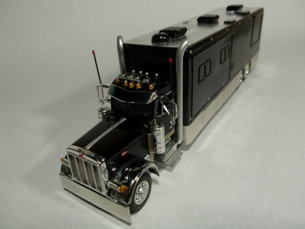

vincen47 Posted December 14, 2013 Posted December 14, 2013 Ok, I'm going to start the 1/24 scale Aeromax and Peterbilt 379 toterhomes asap. I just finished a 1/64 scale version of the 379 (sort of a mock-up):
oldr-n-drt Posted December 15, 2013 Posted December 15, 2013 cary...looking good...now lets see the bigger version... oldr-n-drt
vincen47 Posted December 16, 2013 Posted December 16, 2013 Thanks! I'll start a new topic when I get some progress done. I have a parts order I'm trying to place with P&P.
