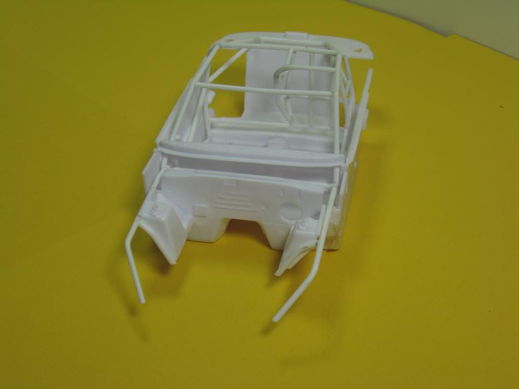

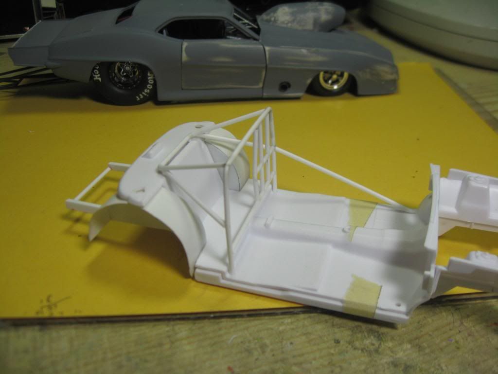

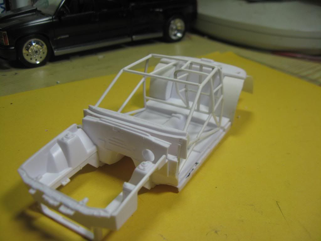

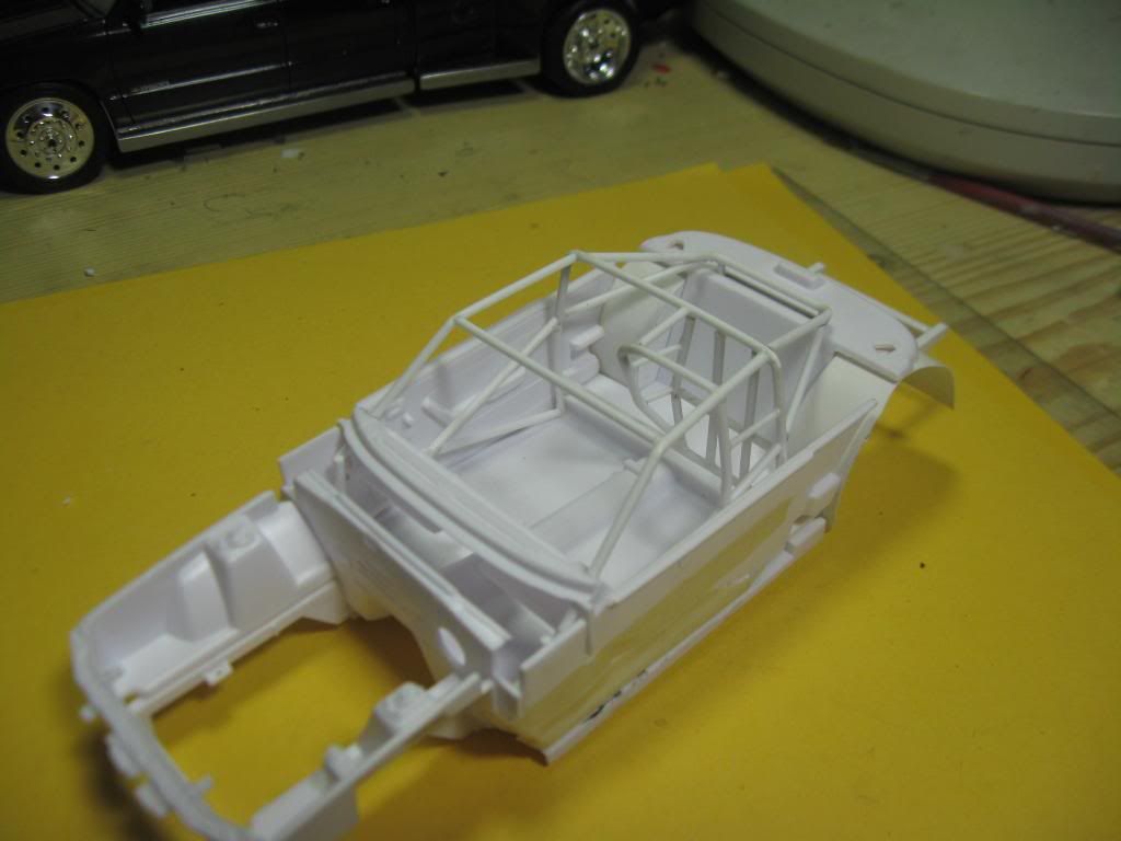

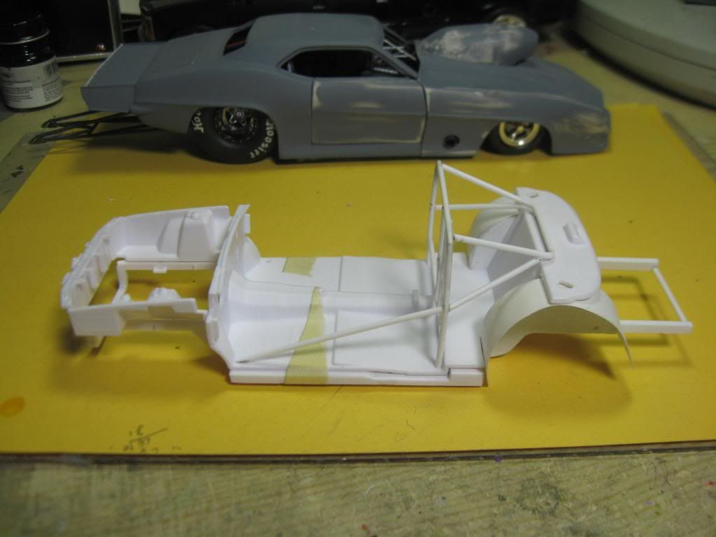

thanks for all the kinds words of encouragement fellas... I really appreciate it.. I was able to spend a little time at the bench the past few days and I made uo a set of mini tubs for the rear and have been working on the cage... thanks a million Joe for the link ;)

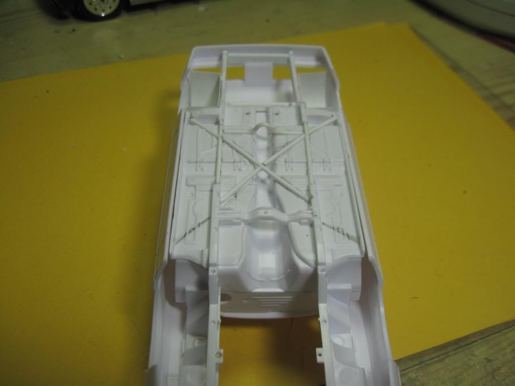

Hey Tyrone,

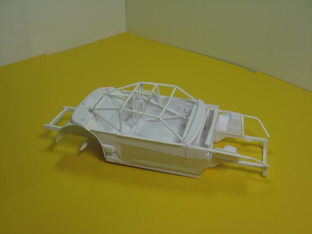

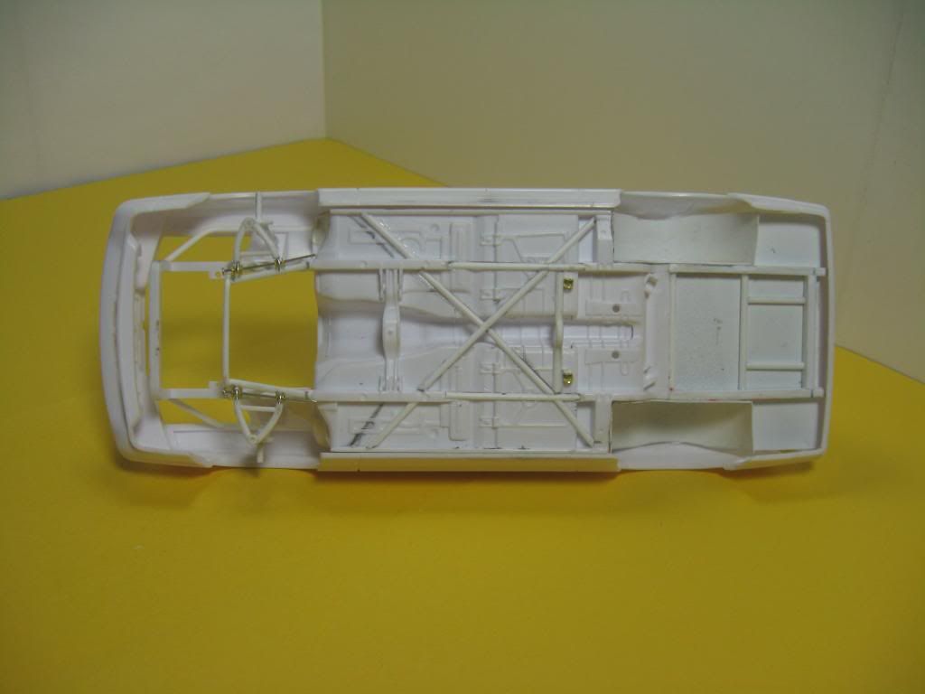

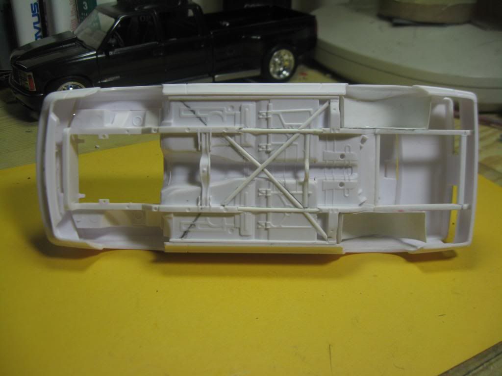

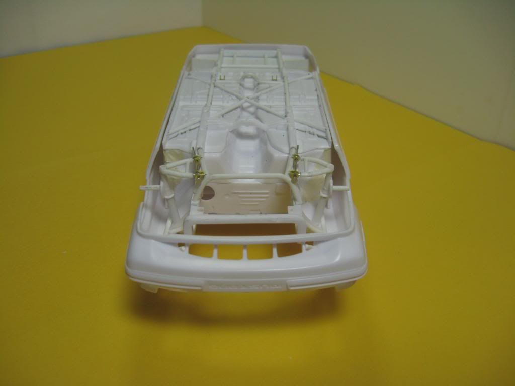

Your subframe connectors and other bracing in the floor pan look great. I like how you actually cut your connectors into the floor. Did you do the same thing with the diagonal connectors? I can't tell for sure about them. Also, how do you make the bends in your roll cage tubing to be so crisp, i.e., what is the process you follow to make them that sharp? She's going together well, my friend...

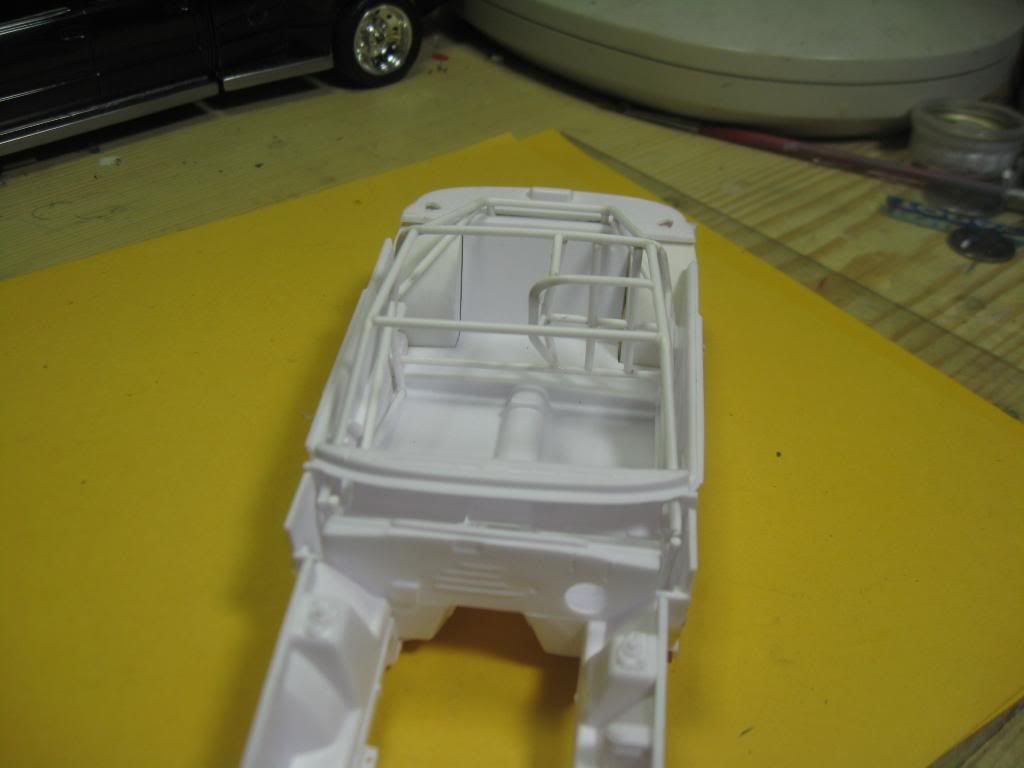

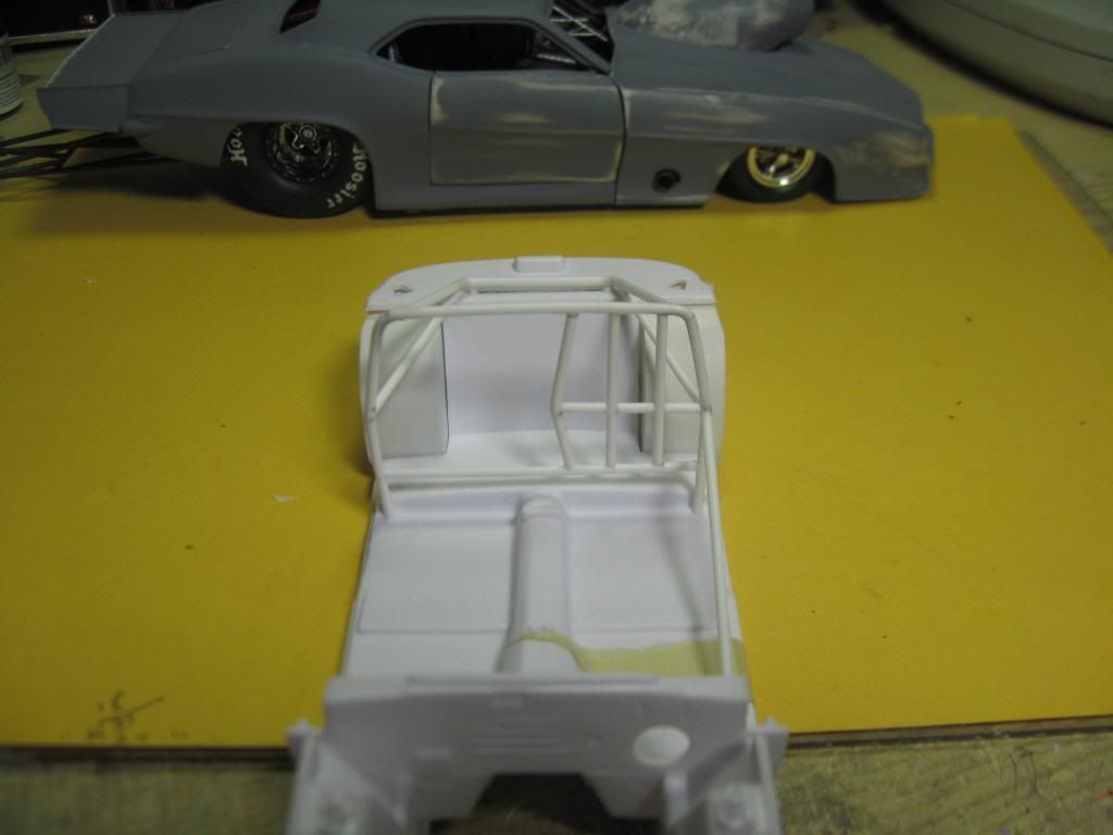

Also, what size tubing are you using for the major bars in the cage as well as the smaller cross bars??? The larger main ones look like .080.

Scott... thanks bro... I thought it would be cool to make those cuts in the chassis instead of just gluing them on top of floor.... as far as bending the styrene rod.. I use a lighter at times for some of my bends on others I bend the rod slowly and carefully by hand and then hit it with just a little heat from a lighter so that it keeps it's shape..

Michael.... I use evergreen .062 rod I think it's #221 for most of the bars...

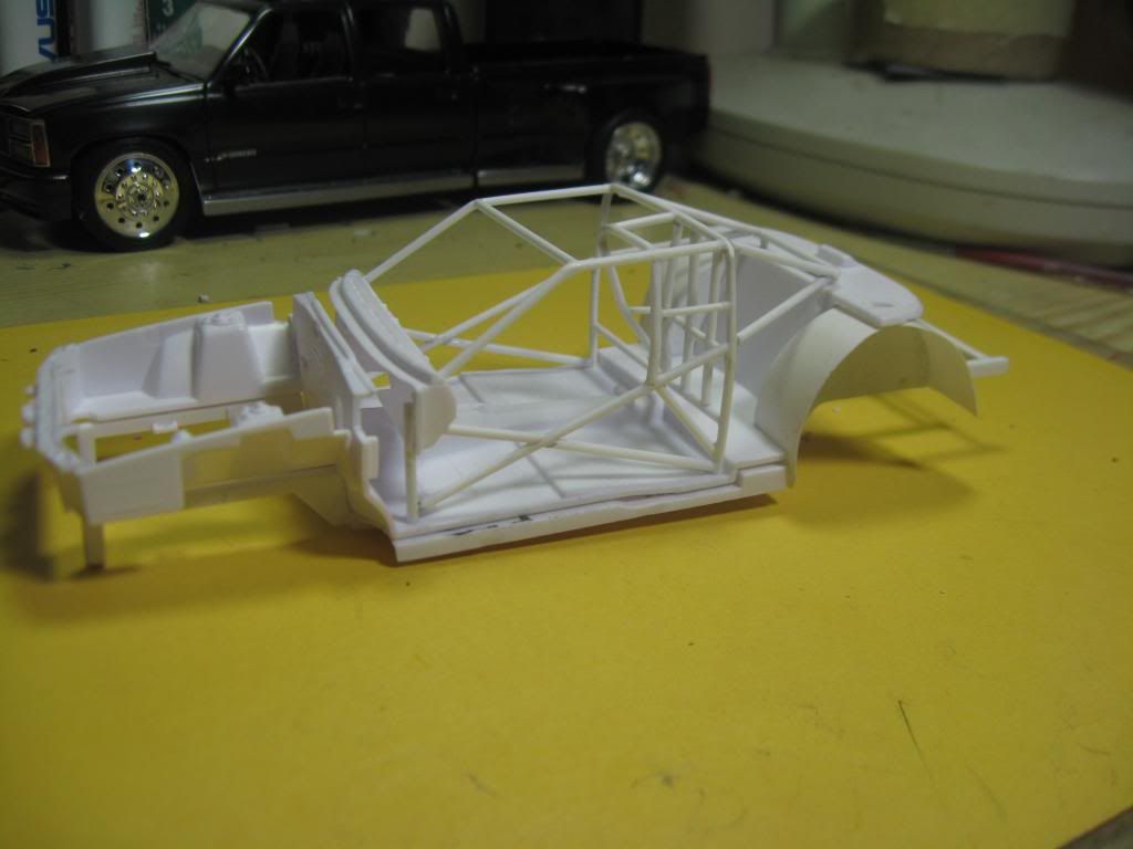

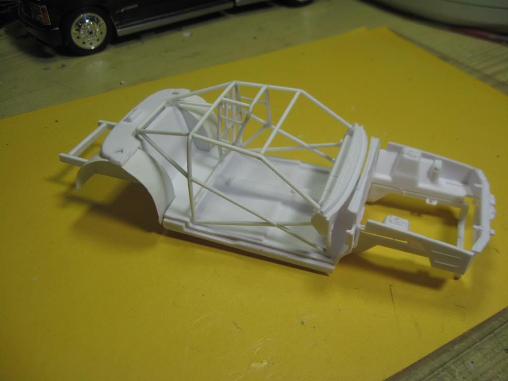

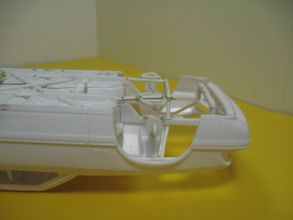

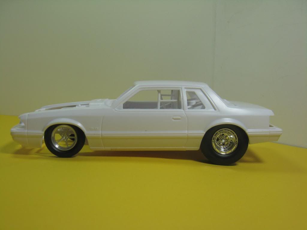

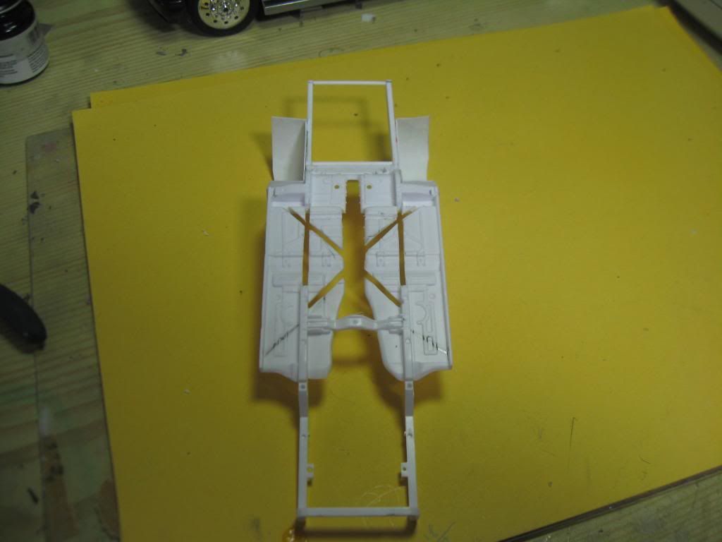

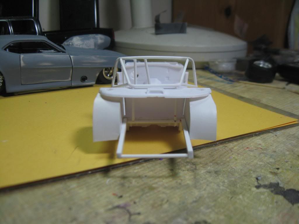

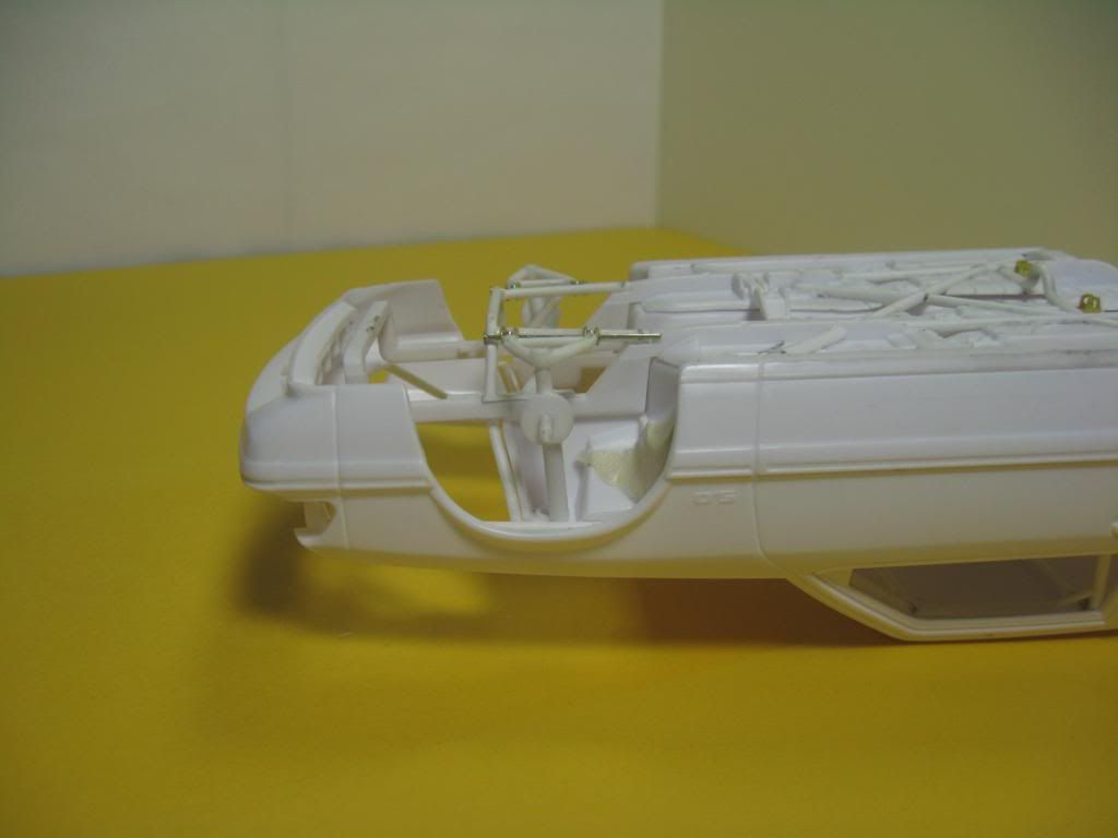

I've made a little bit of progress.. I've added some bars to the front of the car.. and decided to use the 8.8 ford rear end I'm gonna try to brace it up and make some shock mounts and brackets for it... here's a few pics...
this is close to the ride height I'm after.....
Hey tyrone what tires are you using on the rear. Ive looking for a small tire such as a 10.5 slick or even radials but from what i understand people are having problems with getting radials. Those are what i really want and need about 8 or 10 pairs for some of my projects but they are all on hold they i can figure out my tire issues. Hopefully someone out there can help me out with either resin or 3d printed ones. Your build is looking awesome though. I love watching all your builds. Hopefully one day ill be able to get as good as you and some of these other great builders on here. Have a good one.
She's looking outstanding, Tyrone! I haven't looked at the rules for this class, but I'm assuming tubular K-members are legal for it (given all the other allowable mods). I trust you'll be showing off your skills by adding one of those to the front end.?.?.? Keep it up, bro!

Kris... the tires and wheels are from the first issue of the pro-stock cutlass kits.... Warren Johnson and Larry Morgan kits.... I sanded the raised letters off...
Scott... I'm gonna try and make a K-member for the front end... I've been having a tough time trying to find some good pics of the front suspension or the rear end set ups on these little beasts....

I suspect you've already googled and come up with pics, but here's one of the D&D Motorsports tubular K-member for a Mustang. There can't be tons of difference between different manufacturers, so at least this may be a starting point. I may have some pics on a different computer at home of my tubular k-member if you want/need to see different angles. I'm pretty sure I've got pics...
http://www.mustangsunlimited.com/itemdy00.asp?T1=DD7993102+01
and pics of a couple of HP Motorsports' lower control arm kits
http://www.stangnet.com/mustang-forums/threads/hpm-megabite-vs-megabite-jr-lower-control-arms.413003/

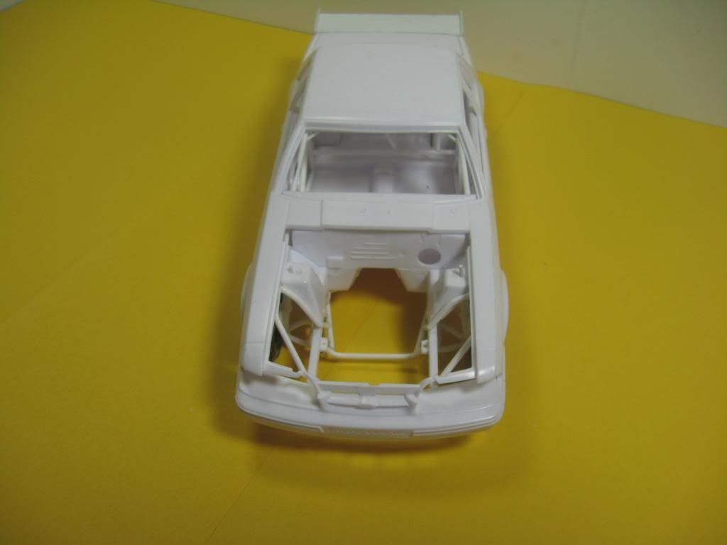

Ryan I usually make my own cowl hoods.. I'll be making one for this one also... well I made a front k-member and control arms from styrene rod ...I'm real happy wiith how they turned out... I modified the front struts from the pro stock cutlass kit, by making them longer... I made the rear wing. I decided to open the trunk, and I've started on the trunk floor and added some bracing and brackets to the rear end... thanks for looking and comments welcome....
