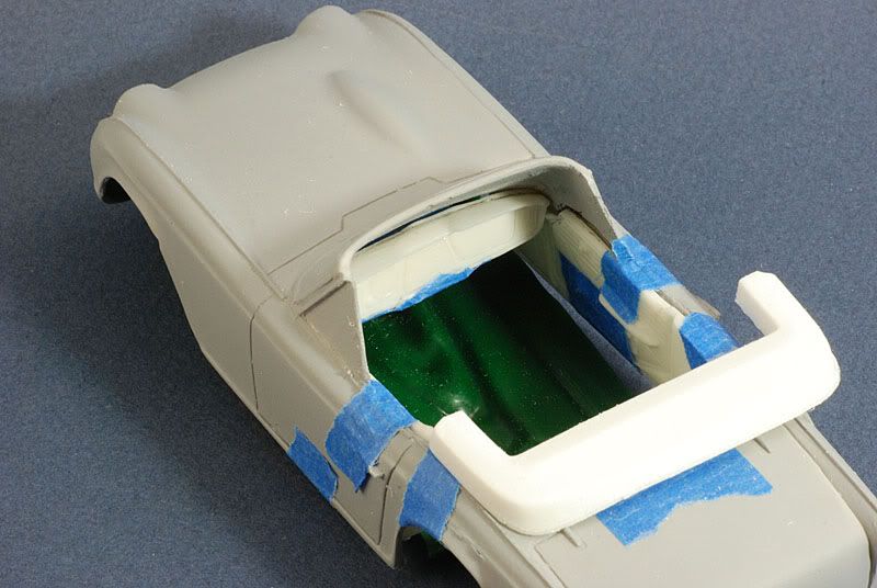

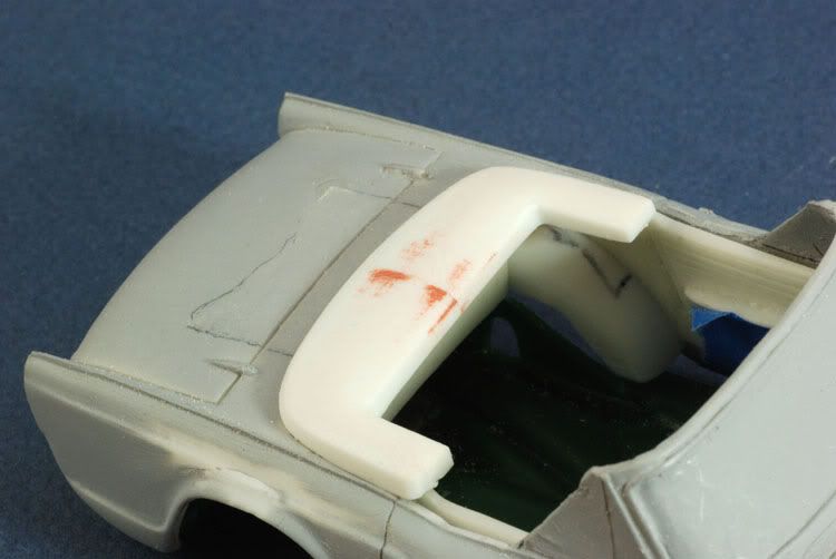

Foxer Posted October 24, 2013 Posted October 24, 2013 I have a resin Triumph TR4A I'm building that was in need of a boot. I cut down the boot from a '51 Chevy to fit, though it still needs some work. Just an example of a possibility.
