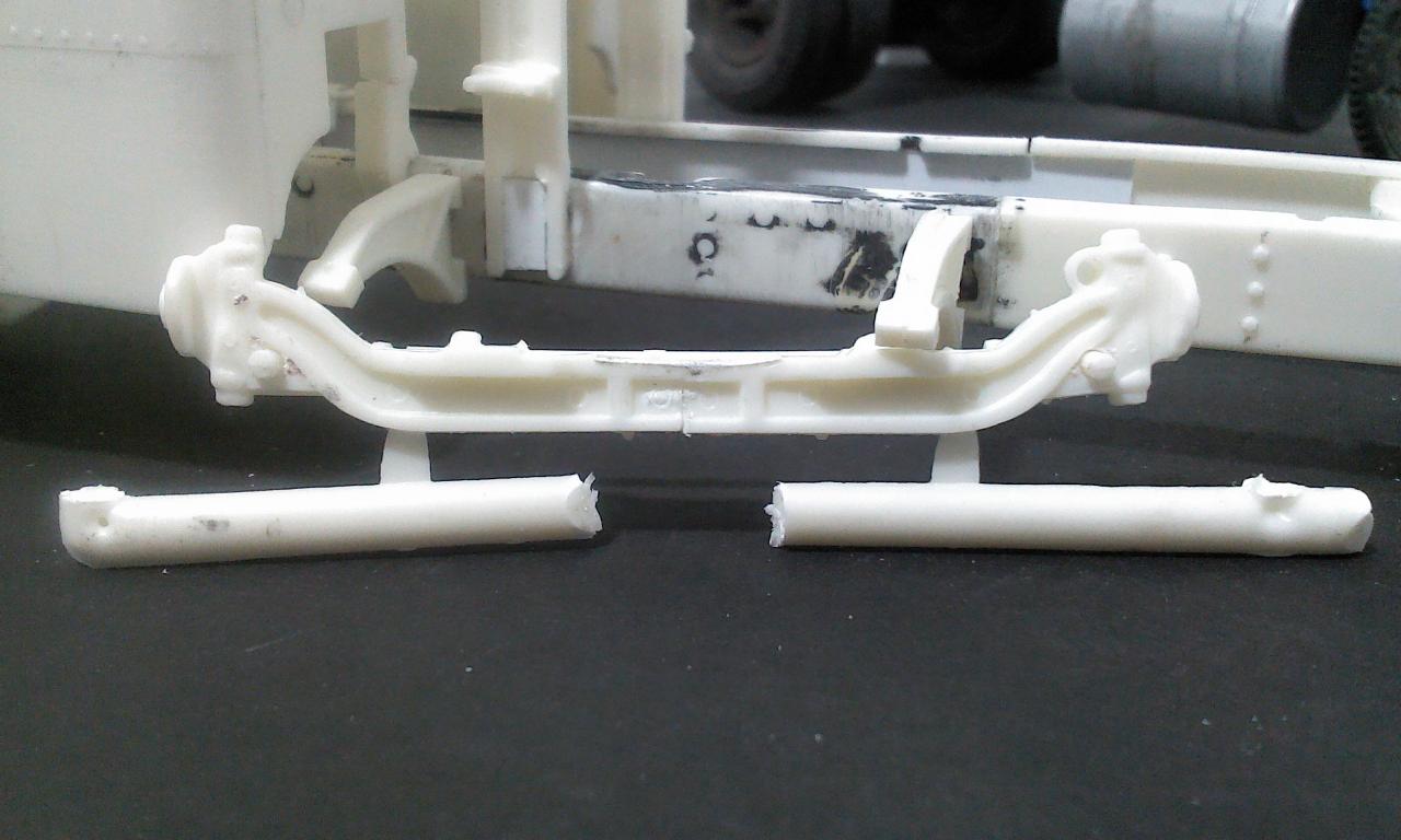

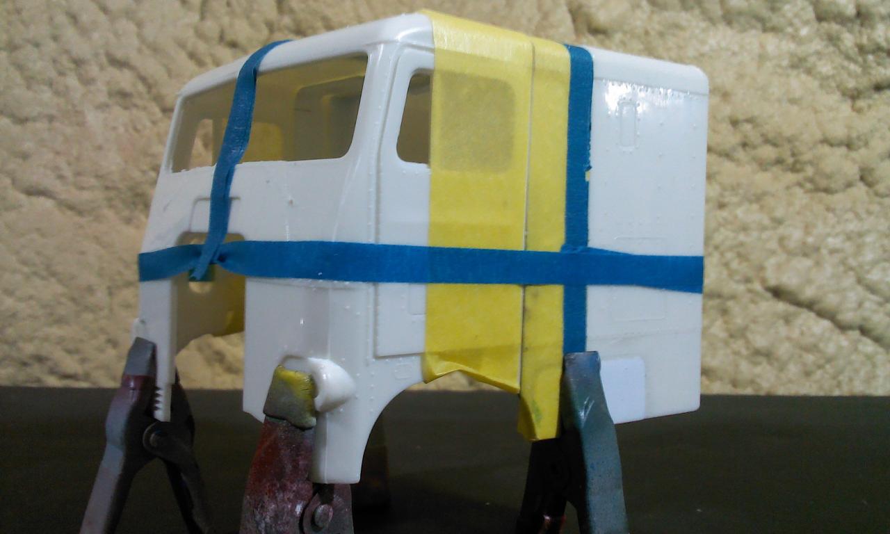

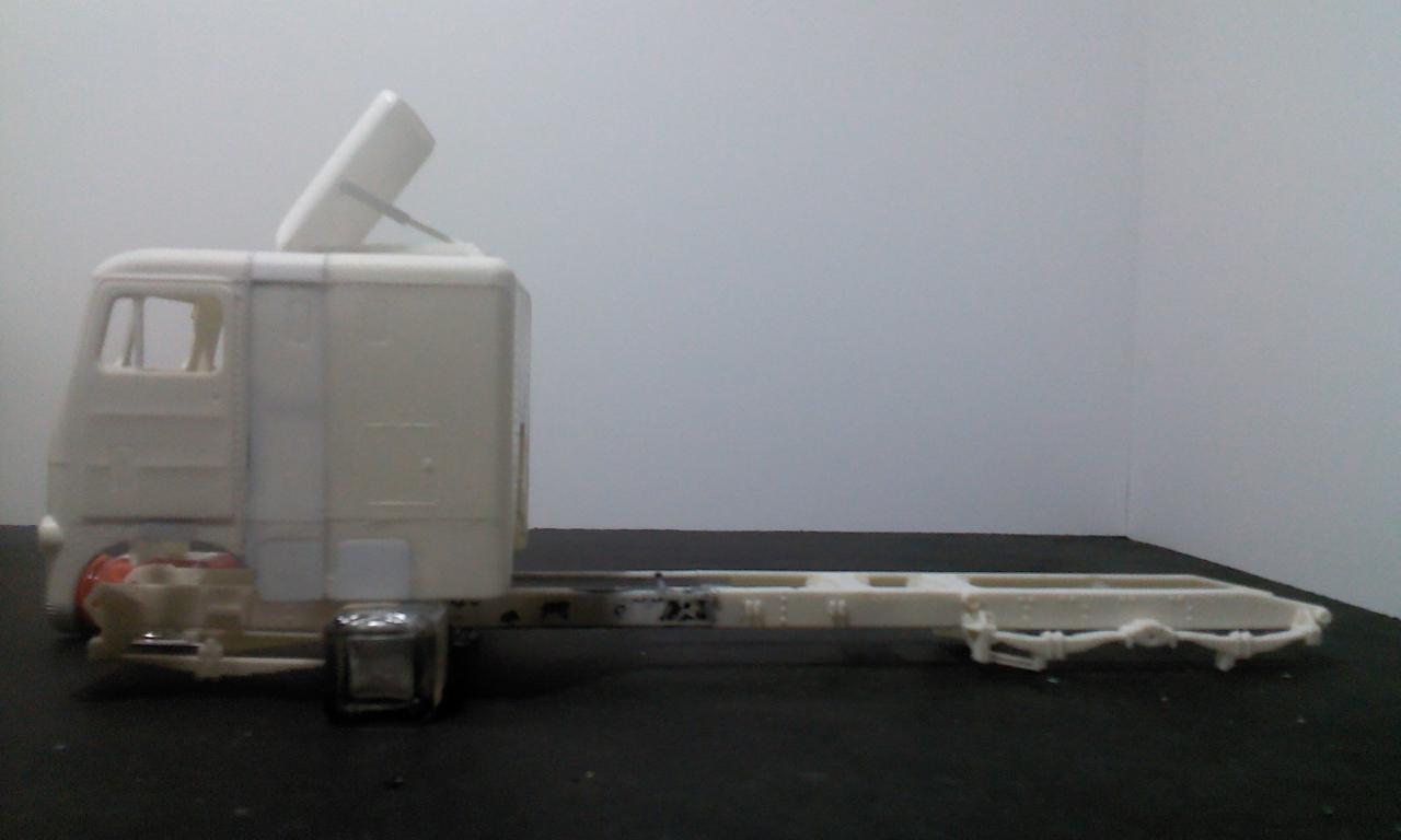

Q tip Posted January 10, 2014 Posted January 10, 2014 this is the second freightliner I've built since its re-release, the first had gotten broke and now will be built into a junker ,the second is receiving the normal build style that most everyone has seen me build, cut, chop and only glance at the instruction sheet when needed. the cab was built back in November and set aside to finish a few builds. with these older amt kits always seemed to have a steer axle that is too long, so by marking the center,and removing 1/16" from both sides of center,drilling a hole placing a pin and plating the top side lets the tires set under the cab as they should. after extending the cab the frame was too short, so by selecting a location after building the frame rails a clean cut was made and 3" was installed............thanks for looking....john

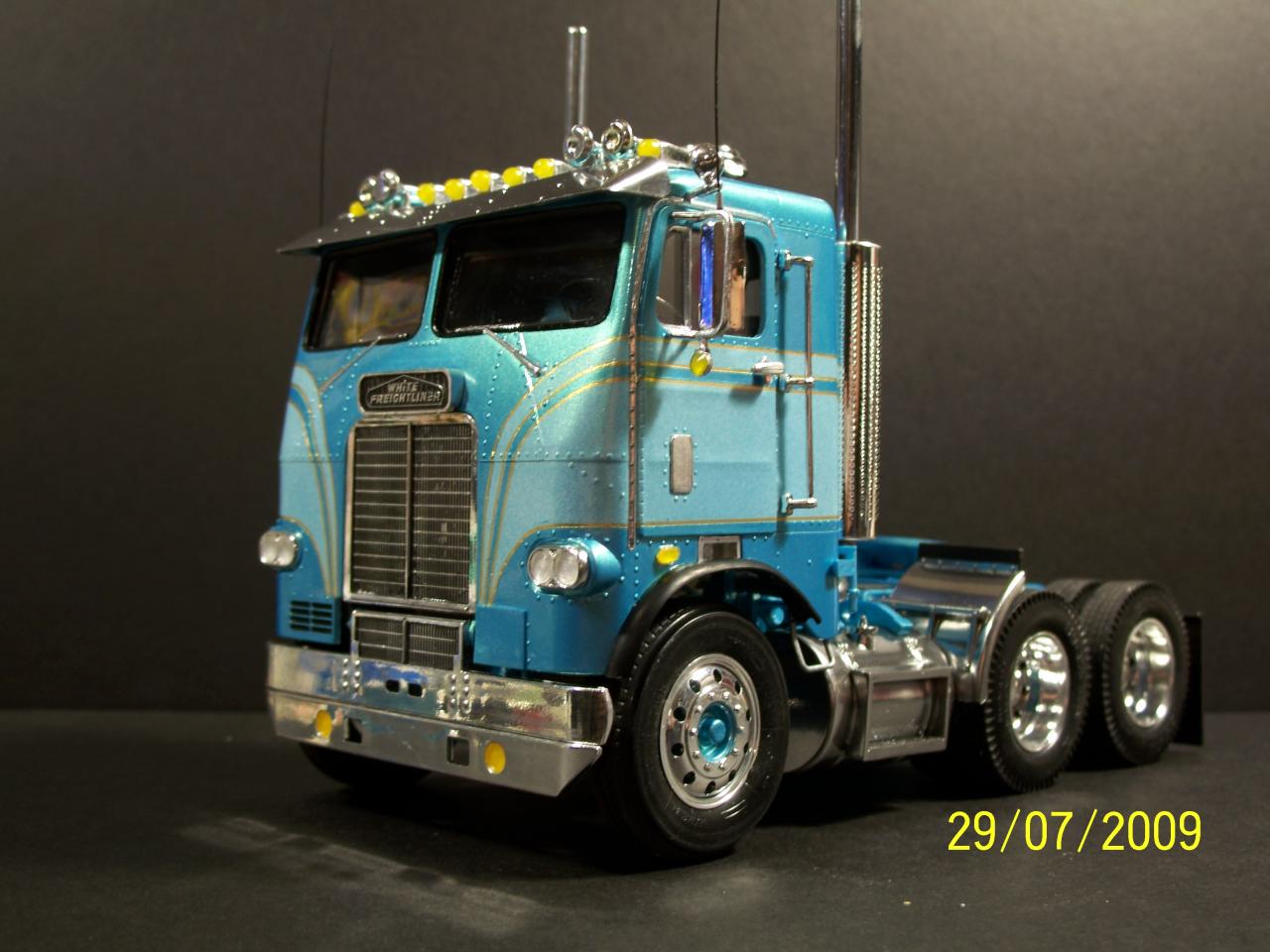

Q tip Posted January 10, 2014 Author Posted January 10, 2014 the shield is a left over from another kit,the center section of the cab is what was left over from the junker, but I have in the past used tube cut in quarters to get a good side curve, and yes I do remember the varisheild..now here is a brain teaser, does anyone remember the shield kw tried that would open in the center and let the wind hit the front of the trailer to help slow it down?????..........john
Q tip Posted January 10, 2014 Author Posted January 10, 2014 heres a mock up of the steer axle and fuel tanks.....the vanliner image is loosly what i'm aiming for......thanks for looking,,john
purepmd Posted January 11, 2014 Posted January 11, 2014 John, you're right. The norrowed axle does make a difference. Pretty easy fix too. Great start on this project. Can't wait to see more.

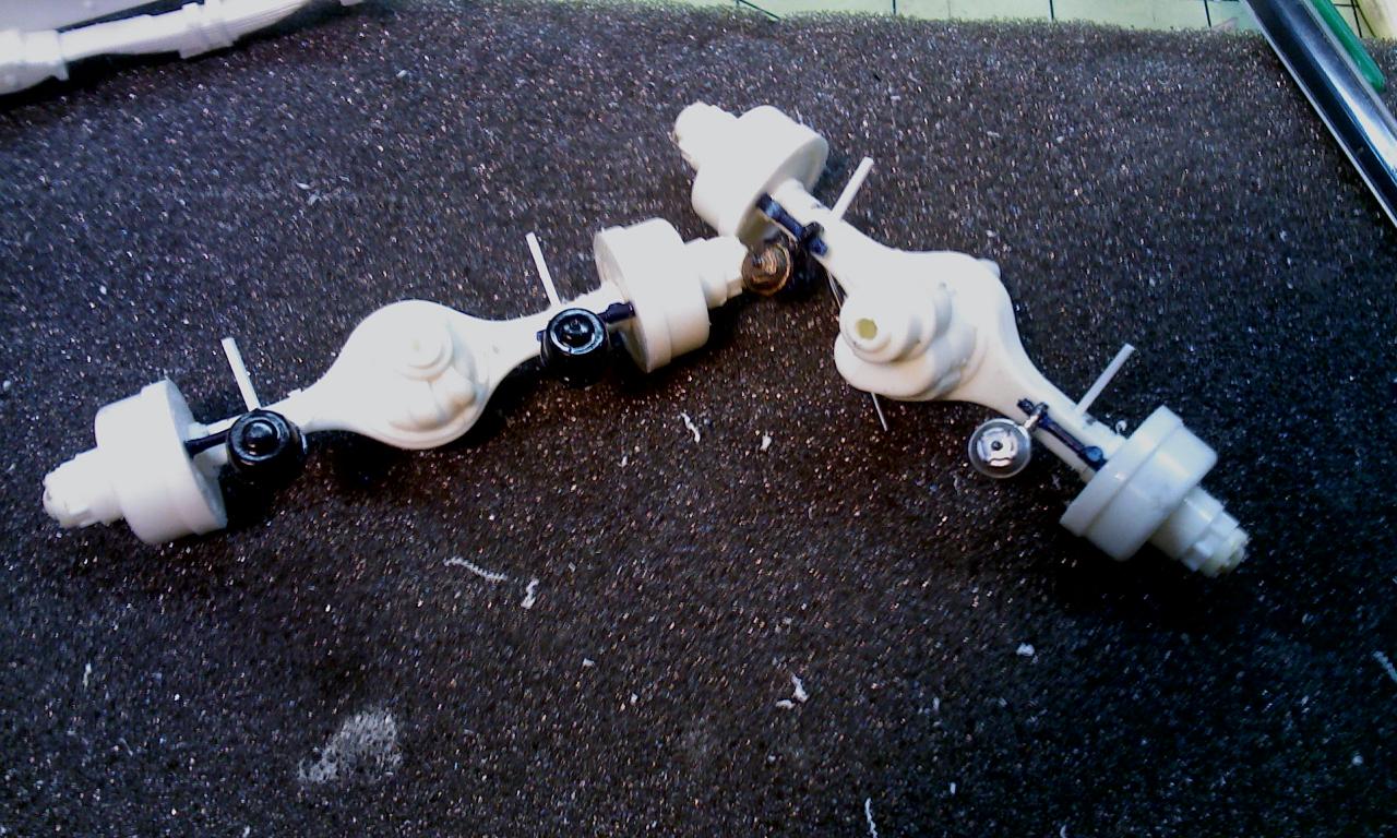

Q tip Posted January 13, 2014 Author Posted January 13, 2014 done a little of work on the rear ends , since the wedge brakes were not going to cut it I dug through the parts boxes and found service brakes for the front drive and normal piggy back chambers for the rear, now they wont fit the springs,so...cut small details from springs and drill holes,,drill out tops of axles and install guide pins, first for placement and second for added support...and jt, I've got 3 projects going since the pete and after surgery, its good recovery , it keeps me from doing something I shouldn't........john
