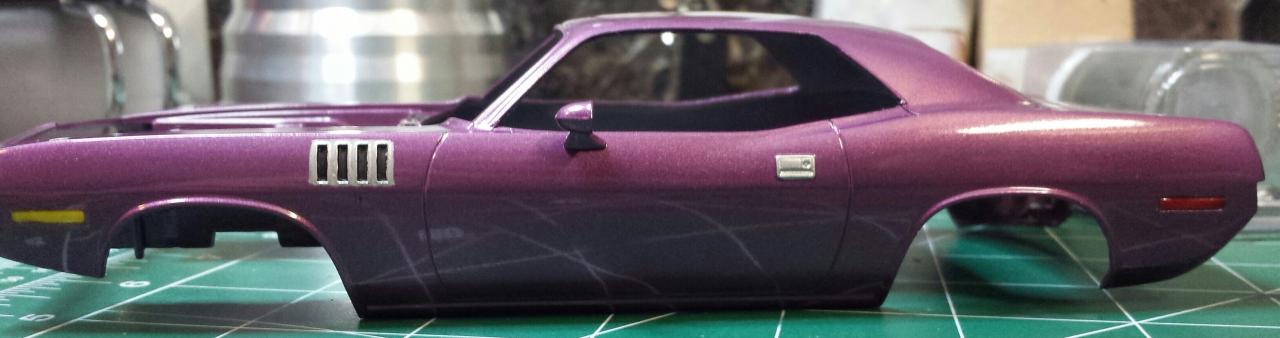

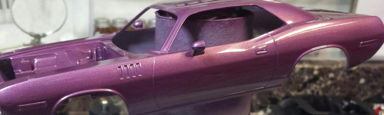

Field_Artillery63 Posted March 13, 2014 Posted March 13, 2014 Hey everyone, just started building my first model, I'm 25 and a Army Vet. When I was around 12 I built a few models during my summer breaks from school. Money was tight being that I was only 12, but 13 years later I'm getting back into it and have around 1500.00$ worth of equipment. Almost done with my first model and just seeing if I can get some tips and "constructive criticism". I'll be posting some pictures, so if you have a comment on them don't be afraid to criticize, I'll take it with open arms. Thanks everyone!

Field_Artillery63 Posted March 13, 2014 Author Posted March 13, 2014 69, that awesome! Thank you sir. And as far as the wiring, I don't think I'm ready for that yet, I don't know where to get the wire, our how to mount them. I've watched a lot of videos that had completed engines with them, but don't know if you have to drill holes or just glue. My biggest concern right now is laying a clear coat on my body. I don't know what to use. It's painted with testors enamel, airbrushed, and I just did the small detail paint work on it(vents, door handles, etc).

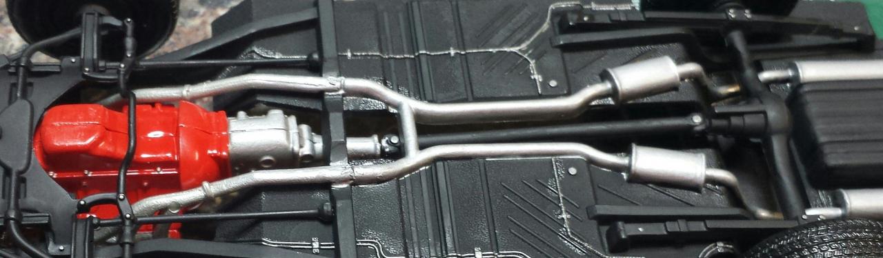

cartpix Posted March 13, 2014 Posted March 13, 2014 It looks great, for a first build. It looks like you've been building. The paint is awesome. Shiny with no orange peel. I don't think a clear coat will be necessary. My only criticism, would be the engine & trans halves & the mold parting line, where the roof side panels meet the 1/4 panels. A little filling & sanding, on the engine & trans & some sanding on the parting lines, is all it needs. Keep an eye, on it, for your future builds. You did a good job, on the molded in exhaust system. I hate chassis' with molded in details. Of course, you won't see it or the engine / trans parts, sitting on a shelf.
Field_Artillery63 Posted March 13, 2014 Author Posted March 13, 2014 It looks great, for a first build. It looks like you've been building. The paint is awesome. Shiny with no orange peel. I don't think a clear coat will be necessary. My only criticism, would be the engine & trans halves & the mold parting line, where the roof side panels meet the 1/4 panels. A little filling & sanding, on the engine & trans & some sanding on the parting lines, is all it needs. Keep an eye, on it, for your future builds. You did a good job, on the molded in exhaust system. I hate chassis' with molded in details. Of course, you won't see it or the engine / trans parts, sitting on a shelf. Completely agreed, when I opened the kit and realized that the exhaust and chassis were on the same mold, all I could think was...yay..but after some meticulous painting it didn't come out to bad. I have some testors putty but I'm kind of unsure how exactly to use it. Drying times, etc. I also used Sand paper for the body but I think it was too course, the papers from the model masters pack. The coarser one left some pretty heavy scratches, and I went down in order, through the paint on the body it is noticeable but not too much, that's why I was going to use a clear coat. In hopes that it would fill the fine scratches. As far as the engine, 100% sure I'm going to putty it the next time.

cartpix Posted March 13, 2014 Posted March 13, 2014 You're on the right track, Joshua. Don't look for perfection, on your first model. Practice & experience. Learn from your mistakes. I know I have. As scratches go, I use primer & Micro Mesh padded sanding pads. I got them from an online model shop. They start at 2400 & down to 12000 grit. The finer ones (8000 & 12000 grit), are for color sanding the paint, before polishing. For body work, I usually use sanding sticks, I get from a beauty shop supply store. They are like large emery boards, for finger nails. They come in a coarse, medium, & fine, sometimes ultra fine. For brushes, I use 00000 brushes (craft stores & art supply stores), for the real small detail. There are even finer ones. I have never used a micro applicator.
Field_Artillery63 Posted March 13, 2014 Author Posted March 13, 2014 Would 0/5 brush be the same as a 00000 brush? And what brand do you use. I primed the body, bumper, and hood with model master gray enamel primer. It worked very well in my airbrush with a 3 to 2 thinning ratio. I saw the micro mesh pads on a hobby store online. (Hobbylinc) They have very big selection with some very good discounted prices. How well do they hold up though? Also, it seems like sandpaper holds up better with the wet sand method than doing it dry? In a case where paint on a small precise area has leaked onto the other painted area that surrounds it, (accidental mess up) what's the best way to cover it up? I've been using the wait till it's dry and paint over it method, but that's a 1 day process. Is there a quicker way, like removing it before it drys, or do you risk taking out the underlayed painted area as well? Thanks for your time and all the info sir, glad I joined this site.
