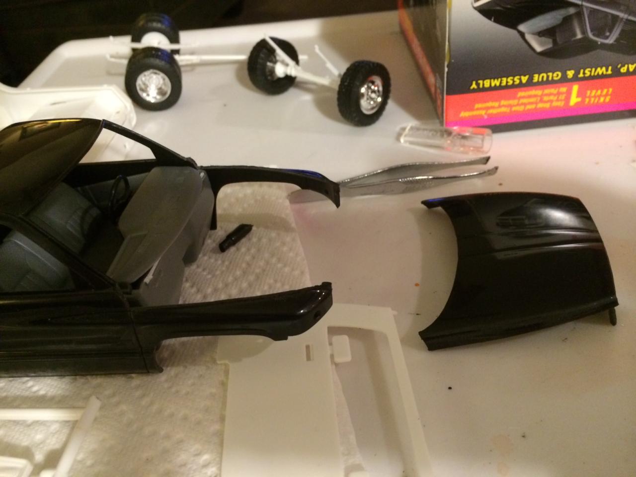

Dandydan Posted March 23, 2014 Author Posted March 23, 2014 (edited) The other thing I started with is opening the hood on the Ram. I didn't feel right planning some detail on the wheel lift and leaving the truck curbside appearing in the front. Edited March 23, 2014 by Dandydan

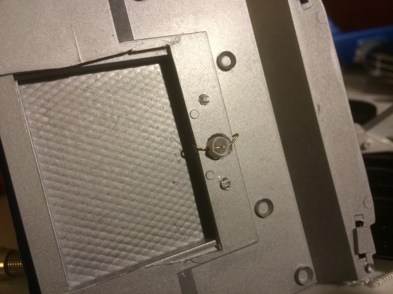

Dandydan Posted March 24, 2014 Author Posted March 24, 2014 (edited) Nice quiet weekend let me get most of the lift built and got some color on the body. The stationary part of the hydraulic ram fits loosely into the floor of the bed to allow movement. The underside I drilled and wired fast so it can't pull up through. The actual ram is smaller diameter to fit down inside and is secured to the underside of the boom. This should make it moveable. Edited March 24, 2014 by Dandydan

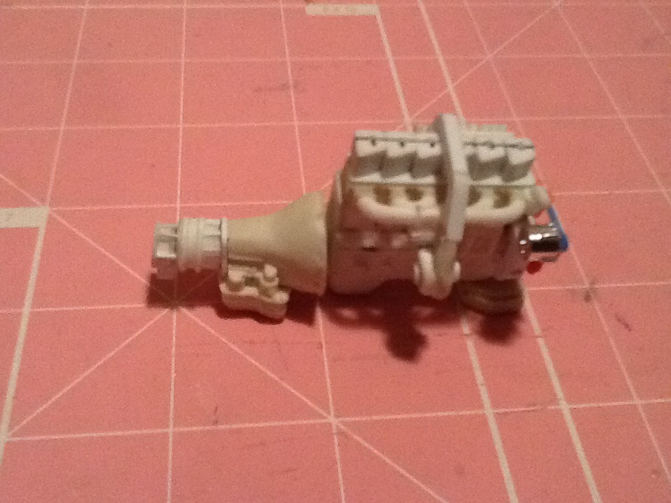

Dandydan Posted March 28, 2014 Author Posted March 28, 2014 (edited) Thanks Chuck and Buzz. I opened the floor to make room for one of Rusty's Cummins. Now to try to figure out how to hinge the hood... Edited March 28, 2014 by Dandydan

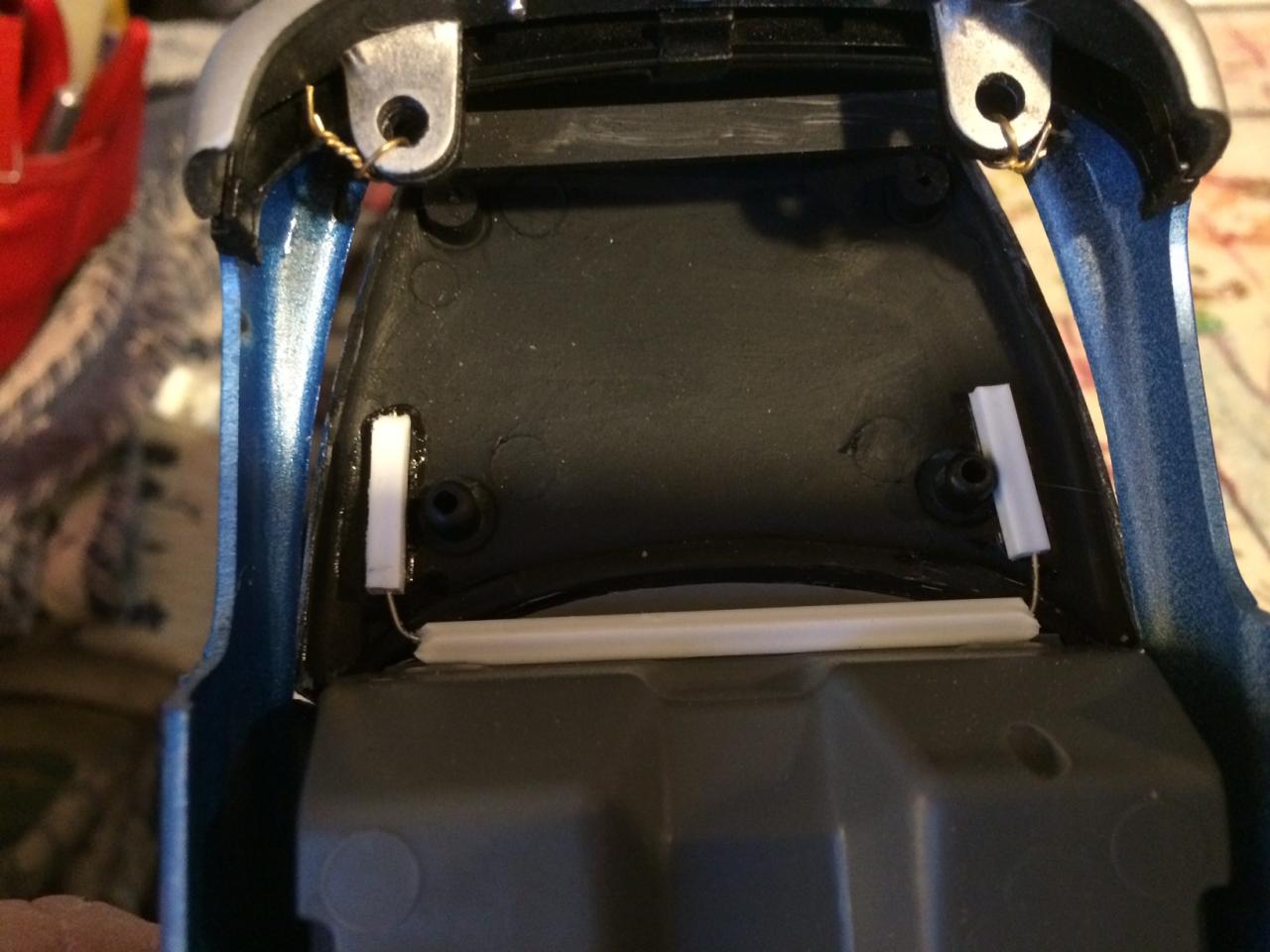

Dandydan Posted April 1, 2014 Author Posted April 1, 2014 (edited) Opening the hood wasn't too bad, but figuring out how to hinge it wasn't my favorite task. Basically the open square tubing slides on the wire running through it as you lift it up. Still on the fence about that but I did add a styrene upper radiator support to help keep everything in place. Edited April 1, 2014 by Dandydan
