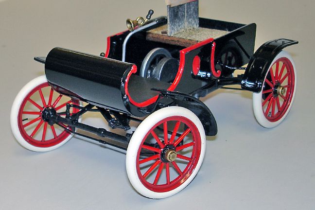

Harry P. Posted March 29, 2014 Author Posted March 29, 2014 I modified the steering system so that the tiller actually steers the wheels... Up on wheels! I decided to add missing real wheel brake and linkage detail and make this a "proper" 1904 model. Next up... scratchbuilding the top.

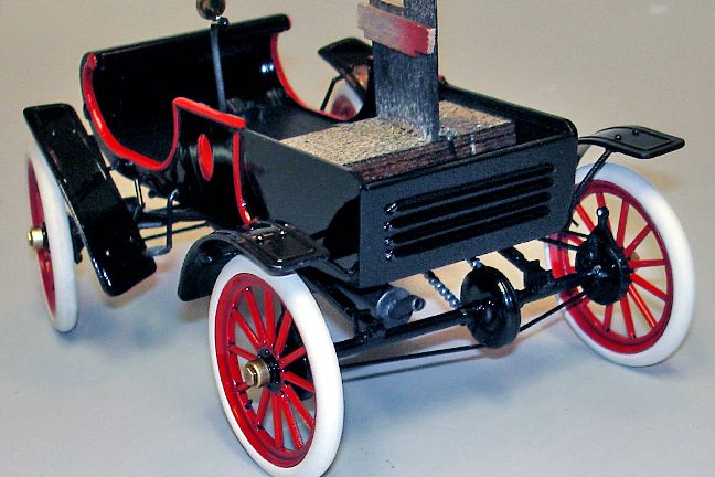

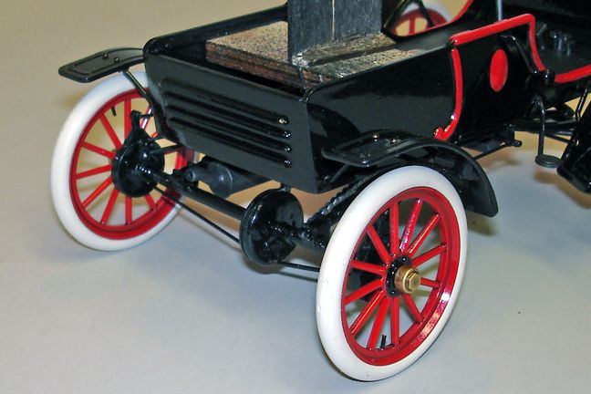

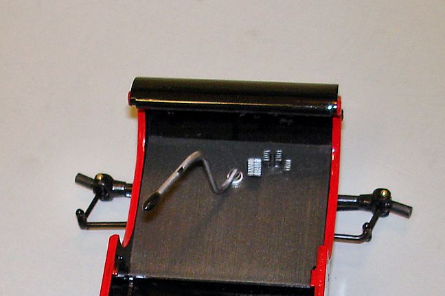

Harry P. Posted March 31, 2014 Author Posted March 31, 2014 It's hard to see details when everything is painted black, but I added the missing rear wheel brakes and linkages to make this an "official" 1904 model (1903 had only a band brake on the trans, no brakes on the wheels).
Cato Posted March 31, 2014 Posted March 31, 2014 Great job-I know what you mean with blacks and details...

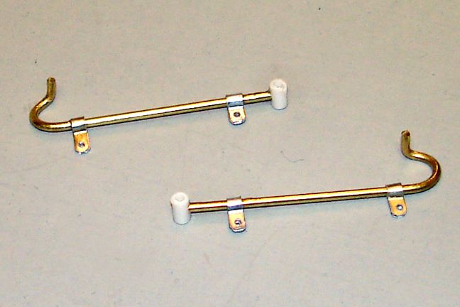

Harry P. Posted April 1, 2014 Author Posted April 1, 2014 The kit's top is molded plastic, and the top irons are hoghly simplified, with a bunch of missing pieces. And the way the top irons mount to the seat is completely wrong and inaccurate... so I'll have to build a complete top framework and mounting system, along with the top itself. First up... to create the rails that are bolted to the sides of the seat, and on which the top irons will connect to. I used reference photos to get the shape of the rails, and used styrene tube, brass rod, and sheet aluminum (for the individual mounting brackets) to create them:
Cato Posted April 1, 2014 Posted April 1, 2014 Beautiful and simple. I have been using lead foil for similar brackets and it works well too, You apparently have really good reference photos, Harry.

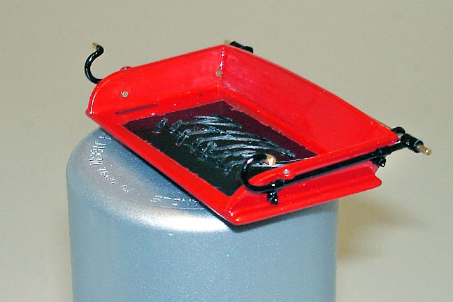

Harry P. Posted April 1, 2014 Author Posted April 1, 2014 Here you can see how the side rails from the previous photo mount to the seat. The horizontal brass rod behind the seat is what the lower edge of the top's back flap will attach to, and the main top iron will attach and pivot on the forward ends of the side rails...

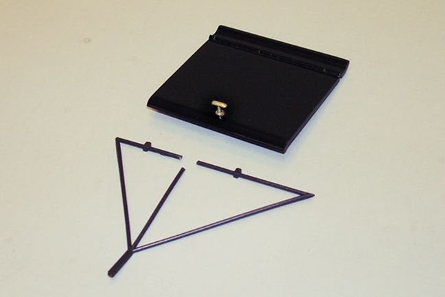

Harry P. Posted April 2, 2014 Author Posted April 2, 2014 I used part of one of the unused top frames to make a trunk lid handle.
