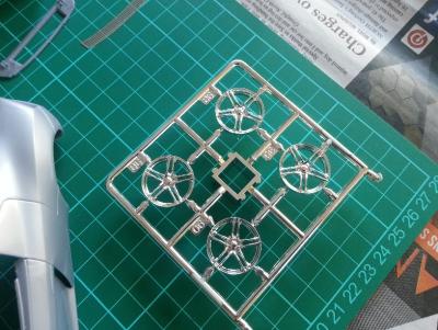

First thing I wanted to do was remove the chrome plating from the wheels as they are a little too bright and "chromey" :blink: for my taste.
post-13721-0-32806700-1399538381_thumb.j
After soaking in bleach for a few minutes, it came right off very easily.

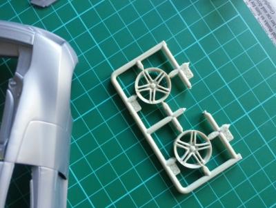

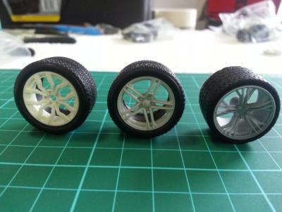

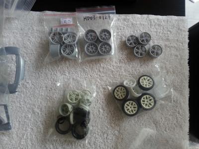

I need to make a choice of which wheels to use with each model. Whichever way I go, the rims will be painted Alclad Polished Aluminium or Airframe Aluminium. I'll have to test on some spoons to see how each finish looks.
post-13721-0-37600000-1399538822_thumb.jpost-13721-0-32173900-1399539931_thumb.j

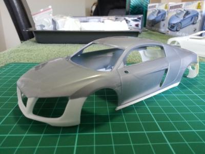

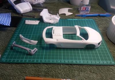

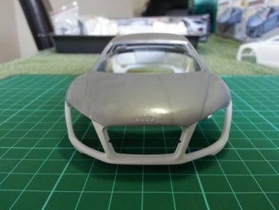

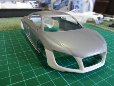

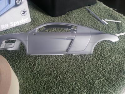

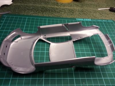

I like the front and rear vanes (not sure of the correct term) and lower body panels of the Spyder more than the coupe so I've used a second Spyder kit to add these parts to the coupe. I removed the side panels from the coupe
and spyder
post-13721-0-33475600-1399540427_thumb.j

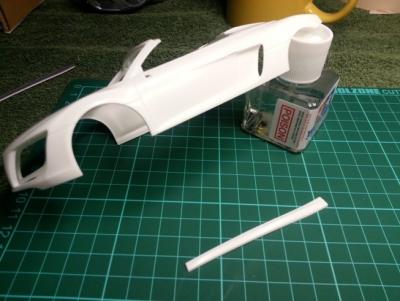

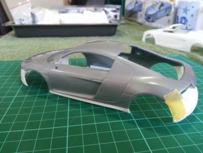

Then added styrene strips to the inside of the coupe's body to provide a more stable platform for the new panels.
post-13721-0-24745200-1399540537_thumb.jpost-13721-0-87127200-1399540549_thumb.j
post-13721-0-68300500-1399541323_thumb.j

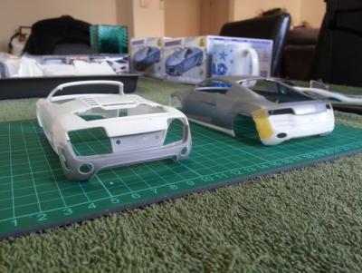

The process was repeated for the front end.
post-13721-0-35566700-1399541367_thumb.jpost-13721-0-85662000-1399541376_thumb.j
post-13721-0-11376100-1399541393_thumb.j

Personally I'd go with the ( Hobby-Design ?) wheels on the coupe & the V10 wheels on the Spyder. The stock wheels for the coupe are just too small & not "blingy" enough, just my opinion though. I'd skip white ( for a colour ) just too plain, these beauties deserve a colour that will truly show them off ?? I'm liking what you're doing though... Great start ???

I've got a couple of Pegasus 23" rims that the stock wheels fit inside nicely so I may make some deep dish versions of the stock for the couple. I'll post up s pick soon.

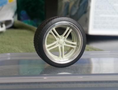

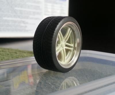

Pegasus rims with stock coupe wheels. Will make a decision after seeing how they look painted and have decided on a body colour, etc.
post-13721-0-08333500-1399615827_thumb.jpost-13721-0-29865500-1399615837_thumb.j
Also.. I do apologise for the quality of the pics. I'm just using my phone at the moment. Hopefully I'll get an actual camera soon but I keep spending money on model stuff :P
Nothing wrong with your pictures Nigel...
Ditto! ? Pics are fine! As are the stock rims in the bigger Pegasus rims/tyre combo' ??

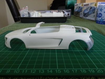

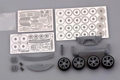

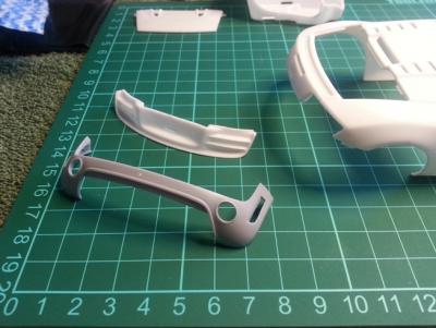

Hobby Design's GT version back end for the Spyder...
post-13721-0-85677400-1399703348_thumb.jpost-13721-0-85623400-1399703360_thumb.j

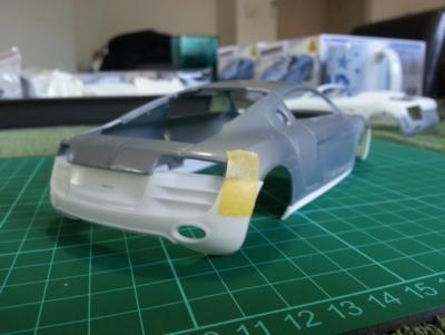

The fit wasn't 100% and required several layers of putty to have the body and rear end flush with each other. I was using the Tamiya fine white putty and it seems to sink a lot. Anyone got any ideas for a better putty I can use on future kits for body work? Hopefully the putty won't crumble when I re-scribe the panel line.
post-13721-0-13367200-1399703620_thumb.jpost-13721-0-88942800-1399703629_thumb.j
