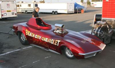

Well, since box stock is out the window, might as well go nutz on the body.
So far all is going well with the roof removal. Next comes the rollcage Doghouse cover thing. I'll do a small cowl at the front too.

I can see where your question is coming from John. What you're seeing is me working with what I have. To make it look more correct, I would have to modify the rollcage and raise the seat slightly. In a "purpose - built" topless car, the driver sits a little higher and the rollcage is taller too. In that scenario you could see that the driver could just stand up, lean forward and escape.
I'm sure the builders of the Beach City Chevrolet and countless other innovators who ran those cars could give you a better answer.
