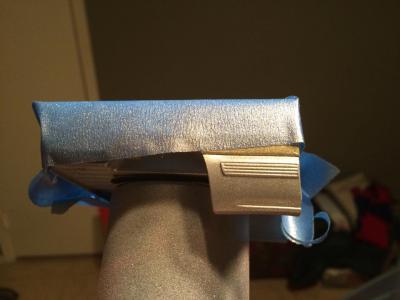

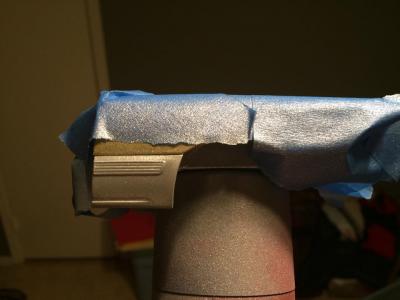

I have primed the bed and masked off the top with Scotch blue painters tape and fine edge curve between the bed and lower front bed fender with Tamiya masking tape. Before it was primed, I wet sand the bed with a 1000 grit hobby sandpaper. I applied one mist coat and one wet coat of Duplicolor primer. I just painted the lower half in Pewter Metallic. This is just the first LMC (light mist coat) at 11 inches.
