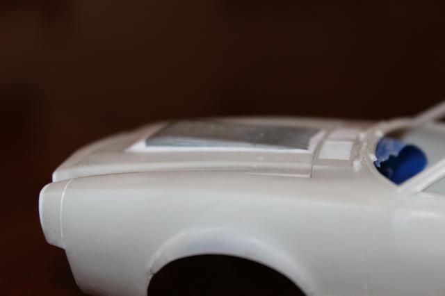

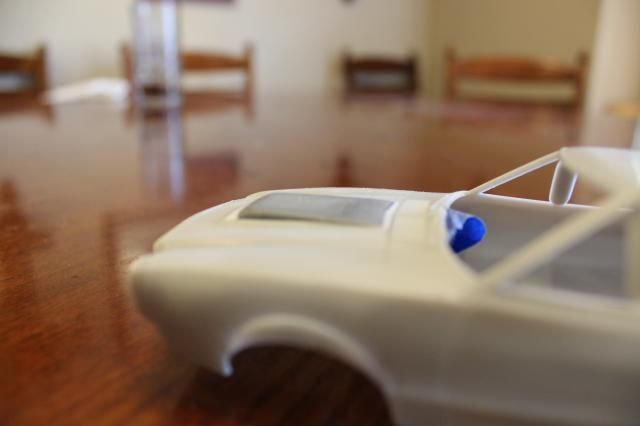

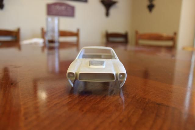

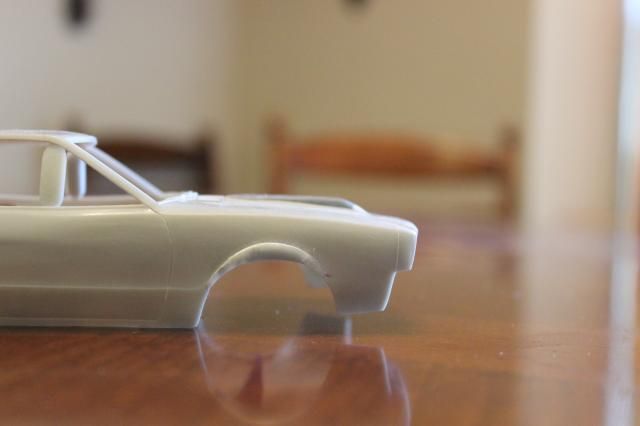

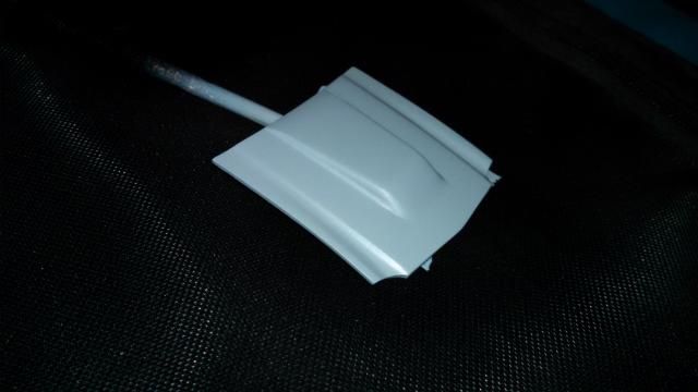

I have very little progress since I got sidetracked by my disorganized parts box, but what progress I did make is, in my opinion, awesome as it is an essential detail for any Elenore inspired build. THE HOOD!
Like I stated earlier, I used the hood from a Coors Light Silver Bullet sprint car. I removed about 90% of the hood and saved just the top. Attached with some Ambroid pro weld and filled the gaps with strip styrene and some Plumber's putty (I'll get more information on the putty in a bit.) sanded and shaped a little and here it is, not primed just yet. I want to save the full picture for an all at once debut with primer over the whole car.

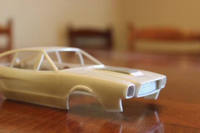

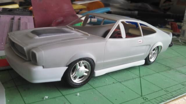

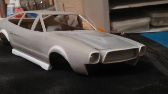

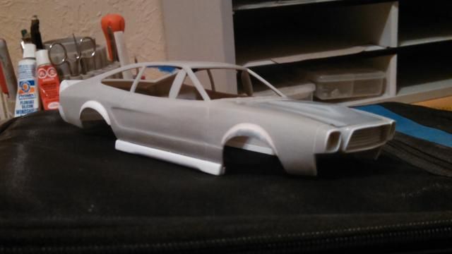

Not a LOT of progress, but I did get the hood done, minus paint, of course. I used Tamiya fine gray primer, the stuff is great, I have to say. You may also notice that I made up some side skirts. I used strip styrene and carved/sanded the basic shape. I am debating weather I should go side exit exhaust or rear exit. Likely going with rear exit so I can break up the slab of a rear bumper I am building, which I'll be having an update on that very soon.
Pics:
You may also have noticed some wheels. I was using the chassis, axle and front suspension from the chassis donor kit, the revellogram 94 mustang GT/95 Mustang Cobra (I had a few partial kits laying around), to check wheel clearance and wheel base. I shortened the chassis by about 3mm and simply cut the sides off down to the "pinch weld" and then trimmed the wheel wells for a perfect fit. I think I'll be building my own interior, but using some aspects from various cobras throughout the years. I'll have pics of the chassis when I actually start working on it.

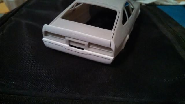

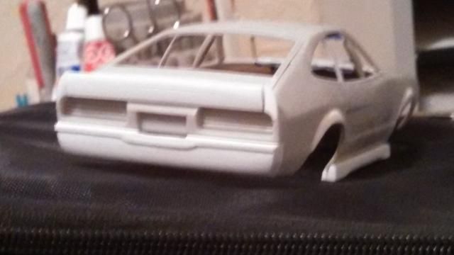

Update: Rear Bumper, roughed in, still, very much a work in progress. I have the basic shape and some styling but still a long way to go. I was thinking center exit exhaust, but the gas tank is going to be so close to the rear end, it will be impossible, so side exit may still be an option. I may decide to scribe in a "frenched" bumper and apply some BMF. We shall see.
I also placed the hood on the body. It looks right at home there

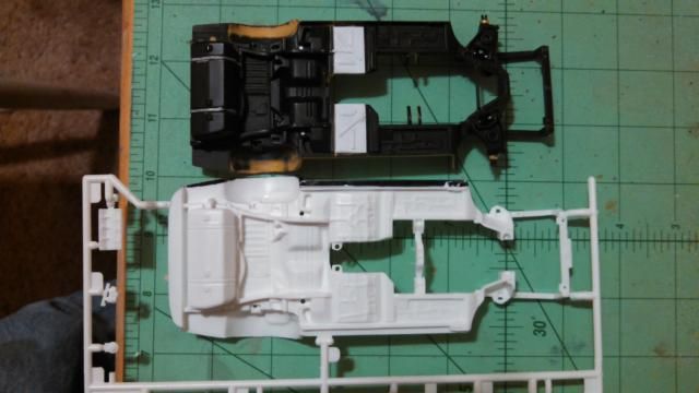

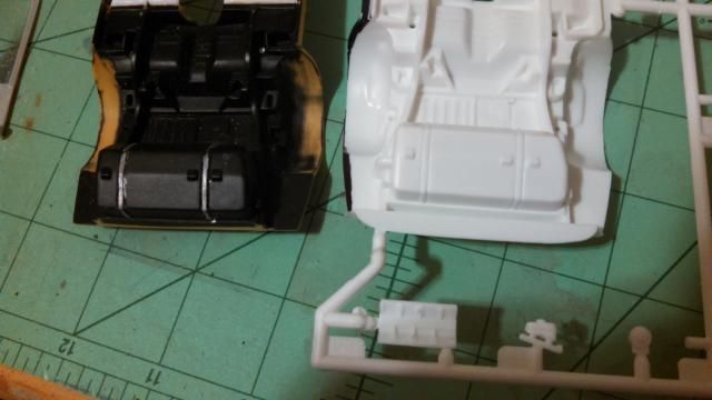

Little update. I got some pics of the chassis that I modified and I went ahead and cracked open another Cobra vert kit so I could show you the difference in the chassis pre and post modification.
this is a side by side comparo. The un-sullied is the white one, the tainted is black. You can see I cut the section out where the white plastic is on the black chassis. I cut about 2 or 3mm at the rear of the back seat foot well. after doing so, I realized I should have cut somewhere else to save the detail, but I just trudged on and made a new set of foot wells. They look the part to me.

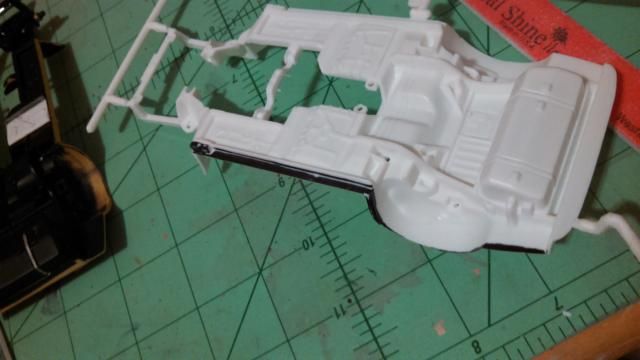

I took this shot to show exactly what material I had to remove to make it fit the chassis. The black colored section is what was removed. The body fits perfectly at the chassis' pinch weld, so I just chopped the sides off smooth with the lip. As for the fenders, it was a slow process of sanding and test fitting, sanding and test fitting and more sanding and test fitting. It was a slow process, but worth the time.
Here is a comparison of the rear end. I didn't want to try to fit the stock rear 'trunk area' to the custom rear bumper, so I just chopped it off and decided I'll deal with it later. I wanted to get my wheel base correct.
