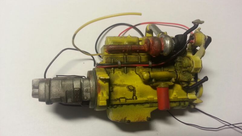

Good first truck purchase. It is a little simplified (one piece frame, one piece cab & sleeper, no brake details, skinny tires), but it can be detailed up quite nicely. The engine is a Caterpillar 3406, and is quite nice. Here is an article from 1991 that will help you in detailing the engine:http://public.fotki.com/modeltrucks25thscale/model_magazine_articles/car_modeller/cm08_july_1991_cate/ As for the tires, well, they could be replaced with some AMT 11:00x20 wheels & tires or the Moebius Big Rig Wheel set. There is a nice W900 P/E detail set out there, but it's more than the kit, so it probably isn't worth it in this case. Here it is if you're interested: http://www.czechtruckmodel.com/catus.php

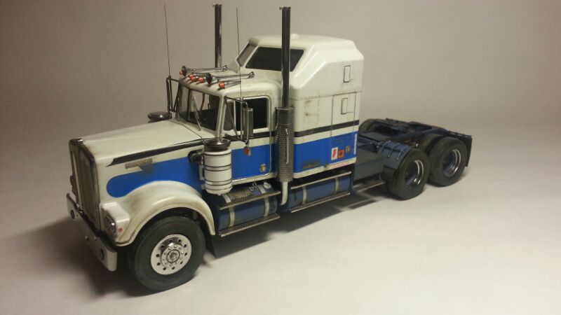

The kit is a 1976-82 Kenworth W900, but if you remove the AeroDyne sleeper (which was introduced in 1976) you can "back date it" to a 1973. Here's one I did a couple of years ago before the reissue:
The stacks are from KFS, and I did relocate the marker lights that are molded onto the headlights to the top of the headlight bucket were they're supposed to be. The wing on the sleeper is an aftermarket item. Kind of wish this kit has a visor.

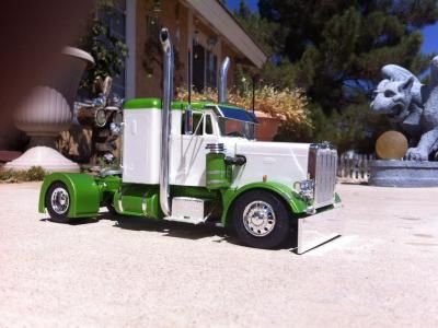

This is what i did with the Revell Pete from the same historic series as the KW.
It has the stacks i was telling you about. Aluminum drop visor, resin rear fenders, Moebius wheels and tires, aluminum bumper, slammed, blocks, leafs, shackles and air bags cut up.

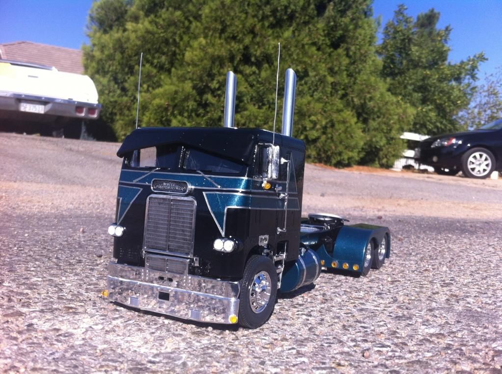

Pretty easy, just spray the black 1st. Let it cure, about a week or when theres no paint smell. Get some good, delicate surface masking tape. Lightly clear it to seal the edge. Let if dry. Then spray the blue. Let it dry. Unmask and you should have a sharp edge. The silver stripe is another story. You can either try to find some decals or get some of that vinyl pinstripe tape from auto parts, cut it thin and lay it on, then clear it all.
I used that method on this but did the teal 1st then the black, cut the vinyl thin laid it on then cleared all of it.
This cab is replacement for 1 that grew wings and fell victim to the tile floor. Thanks to JT for supplying the replacement.

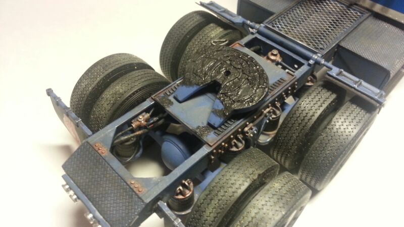

It is very good kit to start. Here's one from me. With wiring and plumbing. Also photoetched parts are used on this KW, so as streched chassis.
