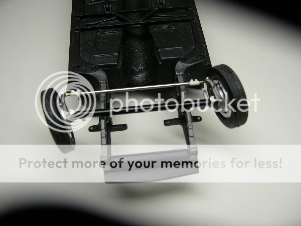

W-409 Posted April 30, 2011 Share Posted April 30, 2011 You can get parts from many Gasser kits. I think that if you are looking for high leaf springs, take them out from Monogram's BadMan kit. That kit has also quite good axle, but you get better one from Revell's '41 Willys Gasser. Also Revell Miss Deal Funny Car ('53 Studebaker Commander) has good axle systems and ladder bars. Also that BadMan kit has good ladder bars. I think that you got good basis for the build if you just buy just some Gasser kit, they all must have good leaf springs and maybe ladder bars too, but good front axle comes from Revell '41 Willys, as I said before. For example, BadMan's front axle is not so good, it's just a straight tubing. If that axle would be in 1:1 scale, wheels would not turn nowhere. Here is a picture of my '57 Nomad, it has the BadMan from axle system, and I'm not happy about that axle. Quote Link to comment Share on other sites More sharing options...
a/gass Posted April 30, 2011 Share Posted April 30, 2011 (edited) theirs a site? www.straightlinemodeler.org it works good 4 straight axle & springs and somewere in tips tutar is axle & spring for 4x4 their both good in different ways on springs.im still trying to get 1 right ha ha!some day.but snap tight 4x4`s will give good springs and scrap plastic 4 strait axle in picture`s dirt cheep:) and those are bad man parts or mono`s 55 in black it also has this front but no cool rims & ladder bar?like said any gasser kit but none are as good as home built.another sorce that looks pretty good and cheep is linberg`s little red wagon but agin no ladder bars. Edited April 30, 2011 by a/gass Quote Link to comment Share on other sites More sharing options...
a/gass Posted April 30, 2011 Share Posted April 30, 2011 You can get parts from many Gasser kits. I think that if you are looking for high leaf springs, take them out from Monogram's BadMan kit. That kit has also quite good axle, but you get better one from Revell's '41 Willys Gasser. Also Revell Miss Deal Funny Car ('53 Studebaker Commander) has good axle systems and ladder bars. Also that BadMan kit has good ladder bars. I think that you got good basis for the build if you just buy just some Gasser kit, they all must have good leaf springs and maybe ladder bars too, but good front axle comes from Revell '41 Willys, as I said before. For example, BadMan's front axle is not so good, it's just a straight tubing. If that axle would be in 1:1 scale, wheels would not turn nowhere. Here is a picture of my '57 Nomad, it has the BadMan from axle system, and I'm not happy about that axle. i think it look`s good ? any body could nit pic it!but if it was fun 2 u you will keep progresion and come back and change things as u get older ha HA HA!like my 71 grand prix in prosses of changin from gasser like this (with bad man parts malco mus parts + i dont know parts ha ha!)to back yard mechanic mid 80`s street racer.happy modeling mike Quote Link to comment Share on other sites More sharing options...
Tim Pentecost Posted April 30, 2011 Share Posted April 30, 2011 HI! Does anybody know who or where I can get gasser parts, tube front axle,"old school" ladder bars? Or any Ideas on building these? THANKS... In my opinion, the best SINGLE source for gasser parts is the new Revell gasser kits. I'm talking the Maz & SWC models here. However, many of the "Gasser" components can easily be fabricated from various materials on hand. Brass/aluminum tubing for straight axles, sheet plastic & metal for springs, tubing for shocks and on & on. Hope this helps. TimP Quote Link to comment Share on other sites More sharing options...

Mark Brown Posted April 30, 2011 Share Posted April 30, 2011 In my opinion, the best SINGLE source for gasser parts is the new Revell gasser kits. I'm talking the Maz & SWC models here. However, many of the "Gasser" components can easily be fabricated from various materials on hand. Brass/aluminum tubing for straight axles, sheet plastic & metal for springs, tubing for shocks and on & on. Hope this helps. TimP I'm with you, 100%, Tim. I've bought at least a couple dozen of the Revell Willys kits just for parts. Not only are the Maz and SWC kits trasure troves for vintage gasser stuff, but the street machine version is full of great modern suspension stuff, like the Mustang II front suspension. And I completely agree about scratchbuilding these parts, too. It's a snap to convert the Revell front axle to be poseable, but it's almost as easy to just make the steering axle from scratch. I also make all my ladder bars anymore - it's easy and they'll be unique to your model. Quote Link to comment Share on other sites More sharing options...
Tim Pentecost Posted April 30, 2011 Share Posted April 30, 2011 Mark, What you're doing and showing here is exactly what I am talking about. Not only are there VERY useable parts to be used as is, but they are easily modified. Many parts are just as easy to fabricate like you show with the traction bars! TimP Quote Link to comment Share on other sites More sharing options...
