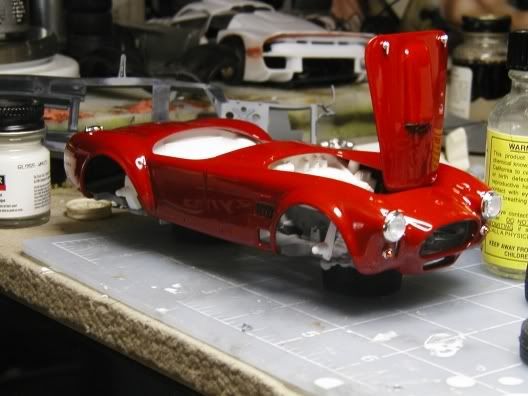

ramonesblues Posted February 25, 2008 Share Posted February 25, 2008 wow, the paint looks gorgeous! Post more pics. Quote Link to comment Share on other sites More sharing options...
CAL Posted February 25, 2008 Author Share Posted February 25, 2008 (edited) wow, the paint looks gorgeous! Post more pics. Thanks, it's my first time clearing with Future. I was pretty impressed myself. I also spent a lot of time polishing and retouching and polishing the Tamiya Italian Red before airbrushing 3 coats of Future. It's not perfect, but it's one of my best paint jobs to date. I don't know, red has been troublesome for me, whereas Boyds Orange Met. turns out perfect every time. Yellow has been 50/50 split. I will get some more pix uploaded soon. Another thing I have notices that I might be over working it. I will be downstairs with a bunch of artificial lights and see all kinds of little problems and defects in the paint. I take it upstairs in the sunlight and it looks perfect. I am pretty happy with it, I just have a little orange peel in the future on the top behind the hood. Again take it up to the sunlight and it's invisable, plus add the windshield frame and ... I am done. Needless to say, and I never thought I would say this, but I am sold on Future as a modelers best friend. And really my old Olympus D520 isn't doing it justic. Edited February 25, 2008 by CAL Quote Link to comment Share on other sites More sharing options...
lizardlust Posted February 25, 2008 Share Posted February 25, 2008 I wish MY paintwork had your "problems"!!! The finish looks incredible!!! Quote Link to comment Share on other sites More sharing options...
Raul_Perez Posted February 25, 2008 Share Posted February 25, 2008 Looking good, Cal!! Red looks really good on a Cobra!! Later, Quote Link to comment Share on other sites More sharing options...
LVZ2881 Posted February 25, 2008 Share Posted February 25, 2008 looks great CAL!!! and I have decided to pick up my first bottle of future as well..... Quote Link to comment Share on other sites More sharing options...
CAL Posted February 26, 2008 Author Share Posted February 26, 2008 Thanks for all the kind words, I agree that red is just the 427 Cobra's color. It's kind of like Yellow on a Porsche GT2 and sorry to say it but Purple on a Diablo, only a Diablo can pull off Purple IMHO. I was anti Future for a long time, but I am sold, now. I tried brushing it at first, which gave pretty good results. No brush strokes or anything like that. I just had a problem with dirts and nibs brushing it. I would say if all possible airbrush the stuff. It's pretty easy: I sprayed Future straight out of the bottle. It's plenty thin, maybe too thin, so you'll have to watch out for runs. Note small runs will self-level when it dries. It helps if you down the PSI and close the needle a bit and work from the top down. The sides are the only place I had a little trouble. However, it sands easy or strips just as easy and reshoot. A sanding and polishing note: I found no polish that didn't disturb the Future coat. Maybe I didn't let it dry enough. Zymol didn't strip it but left some streaking. I heard most other waxes and polish will take Future right off. Wet sanding will also take Future right off and had best luck with dry sanding it with Micromeshes. Cleaning I just used some ISO, I first tried acetone but that didn't touch it. And like I said before, you still need a pretty good base or color coat becaue it wont fix everything: some minor scratches and imperfections, and will give you an unbelieveable shine. I seems to stay somewhat soft though and is easy to put a nick or dent in the Future finish. So just becareful handling it. It will also show every fingerprint everytime you touch it. I might just start wearing those little cotton gloves They wipe right off, but nevertheless it's so glossy it shows everything, at least under florecent (day) light which is what I am using in my studio. True day light not so much. It looks outstanding in daylight. My next experiement is a flat base with future top coat: an Aotake Nova. Quote Link to comment Share on other sites More sharing options...
