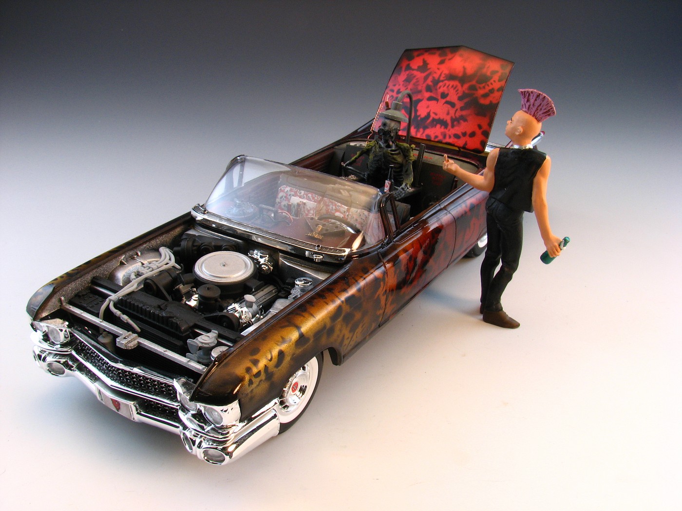

Dr. Cranky Posted January 26, 2009 Share Posted January 26, 2009 (edited) Hello, maties, D. Cranky here bringing you another building chapter from D. Cranky's Workshop . . . this time, after almost getting fried on so many flat and rusty paintjobs, I've decided to return to shine & light!!! So, take your comfy seat, and share the experience of putting this one together with me. Thanks for looking and not getting pop corn butter the computer keys! Edited January 26, 2009 by DamnCranky Quote Link to comment Share on other sites More sharing options...

Dr. Cranky Posted January 26, 2009 Author Share Posted January 26, 2009 All right, maties, here are the steps I took to get to where I am now with the paint job. 1) washed the body with warm soapy water, smoothed it down with a 400 grade sheet . . . 2) used Plastikote gray primer 3) used HOK basecoat black--light coats until good coverage 4) used HOK Orion Silver base coat--light coats over the black unti full coverage 5) used HOK silver-white marbelizer & saran wrap to give the silver a gauzy/smoke look . . . it worked! 6) used Craig Fraser skull templates with the original blackbase coats . . . this kind of paint dries very fast with FAST REDUCER so you can move the template around and you try to get the best compostion . . . 7) used HOK Pagan Gold candy at the front and faded it toward the back 8) used HOK Tangerine cany at the front and faded it toward the back. 9) used HOK Apple candy at the middle and fogged it toward the back. 10) used HOK Brankywine candy from the decklid toward the back . . . Let everything dry for 20 or so minutes, and then repeat all the candy steps from the rear to the front . . . Quote Link to comment Share on other sites More sharing options...
Dr. Cranky Posted January 26, 2009 Author Share Posted January 26, 2009 Here are the results . . . the body dried overnight, and next up is a few coats of clear, but before that I have to paint some skulls on the underside of both the hood and the trunk lids, this way they show the same "damned-souls" quality to the paintjob on the body . . . The interior is going to have some upholstery but it will be mostly red/black flat paint . . . with lots of accents for the most contrast . . . Quote Link to comment Share on other sites More sharing options...
juergen Posted January 26, 2009 Share Posted January 26, 2009 hi ! WHOWWWWWWWWWWW!!!!!!!!!!!!!!!!! your paint job is absolut imazing !!!!!!!!!!!!!!!!!!!!!!!!! one of the best paints i ever seen !!!!! greets jürgen Quote Link to comment Share on other sites More sharing options...
rv1963 Posted January 26, 2009 Share Posted January 26, 2009 Wow that paint job looks great now but after you spray a few coats of clear it should look amazing, i also like the trunk hinge. Quote Link to comment Share on other sites More sharing options...

Dr. Cranky Posted January 26, 2009 Author Share Posted January 26, 2009 Okay, here's some more progress . . . I put a few coats of HOK intercoat clear just in case I would not be able to shoot the clear for the next couple of days . . . with all this bad weather and humidity . . . Intercoat clear allows you all the time you need to put clear on a vehicle . . . A few coats goes a long ways . . . and it seals your paintjob well . . . The other plus is that it dries really thin and you can handle it within an hour or so . . . less in humidity . . . Quote Link to comment Share on other sites More sharing options...
Dr. Cranky Posted January 26, 2009 Author Share Posted January 26, 2009 Here's the work under the hood . . . And here's the underneath of the trunk lid . . . I went with a yellowish candy because there's something that's going to be glowing out of the trunk . . . but that's another story, or as some folks like to say, we'll cross that bridge when we get there . . . Quote Link to comment Share on other sites More sharing options...

horsepoweraddict Posted January 26, 2009 Share Posted January 26, 2009 wicked cool!!! I think your fade from yellow to red is the best I have seen on a model. very nice paint work. Quote Link to comment Share on other sites More sharing options...
