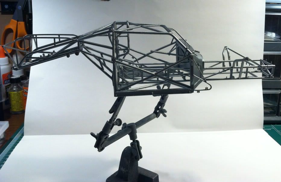

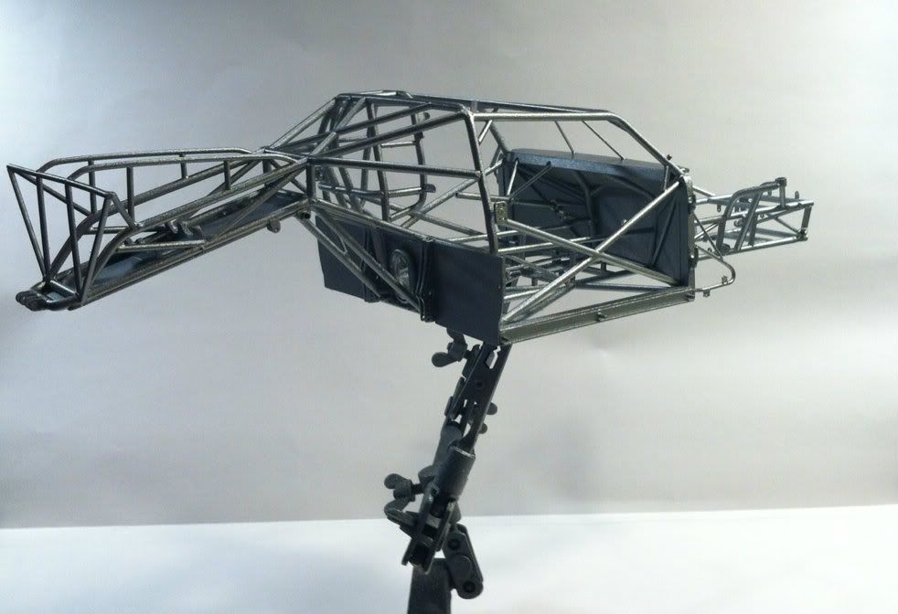

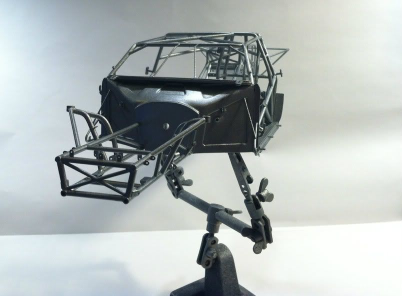

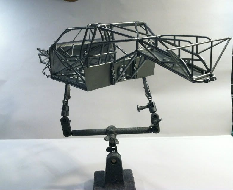

I agree with everyone else. reference material is your friend, Also look at other builds on the site. There are alot of extremely talneted builders on this forum, I was in the same boat as you and decide to take the plunge and build my own chassis. I'm working in 1/16th scale so i had no choice but to build my own, If your just starting on doing chassis i would start with the kit floor pan like many guys do and go from there. The more you build the more confident you will get doing chassis. Here's a couple pics of my build, keep in mind this is the first chassis i ever built. There were alot of mess ups but in the end i tackled it and i'm very happy with how it turned out. Have any questions feel free to Pm me anytime and i will help to the best of my knowledge.
Here's a link to my Photobucket and Fotki if you would like to see the different stages of the chassis.
http://s862.photobuc...y Turbo ProMod/
http://public.fotki....7-chevy-promod/

Wow, Joe, I had no idea, based on the quality of your chassis, that it was your first! Amazing.

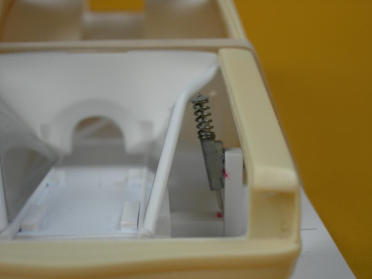

I know your question was aimed at Joe about locating front suspension points, etc., but I wanted to show you what I'm doing on my Fairmont suspension. I'm going to pick up my thread from back in August on this shortly and will include some of these pics, but wanted to show you how I'm establishing those points, as long as the thread pertains to this subject. I'm sure others will have different ways of doing it.
I measured the diameter of the front tires I'm planning to use, drilled spindle blocks that match the tire centerline and so the spindles are parallel to the ground, determined track width and fore/aft location within the wheel well opening. I then glued the spindle block to a styrene base. Once the block was in place I could set the caster where I wanted it. The upper tubing ties into the firewall and was dictated in large part by the shape of the aluminum tinwork that is integral with the tube frame members, which I had to fuss with. I am going to work on the lower mounts next, but haven't gotten that far yet.
