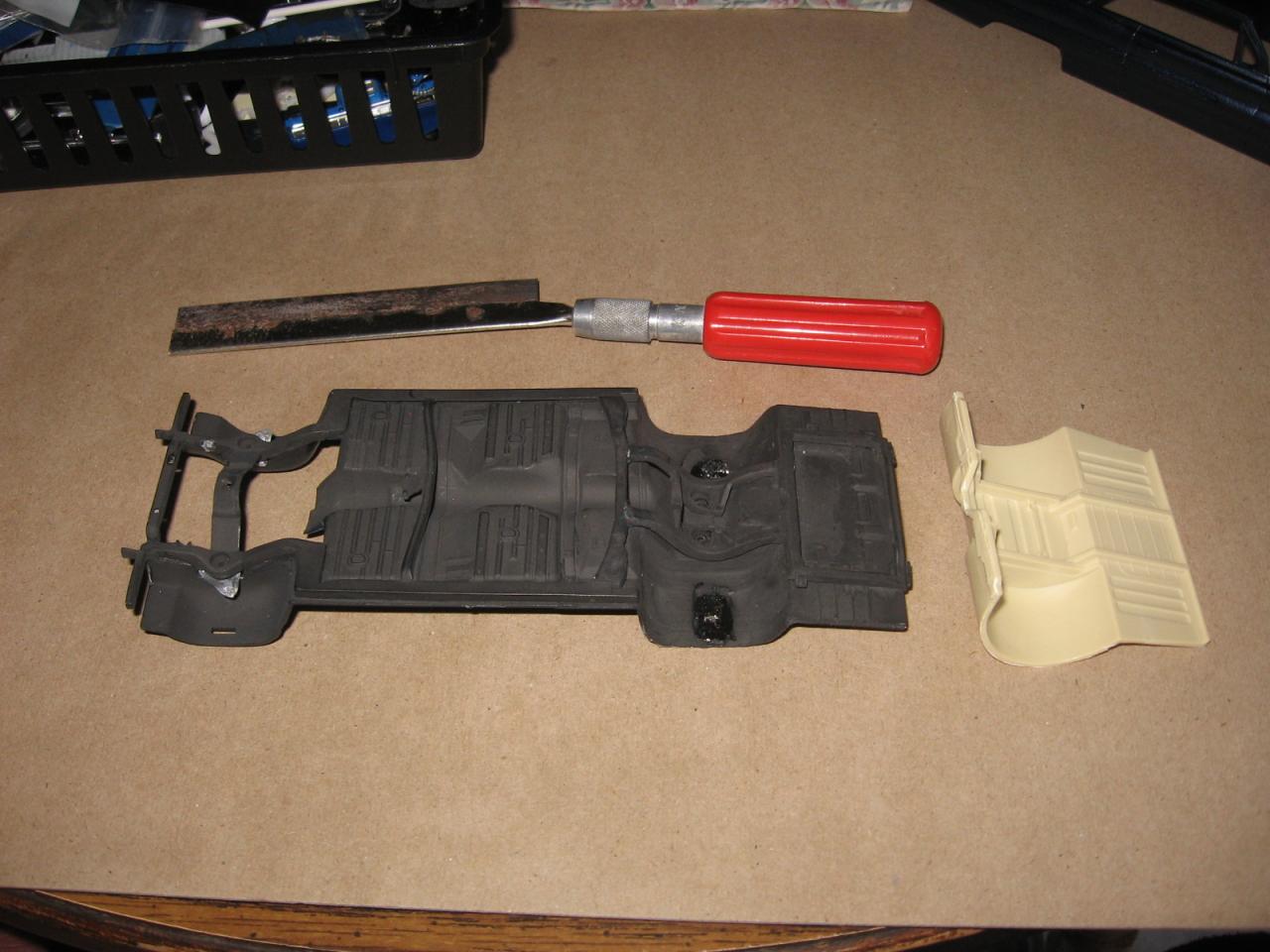

I finally got the interior panels modified to fit the new chassis (thanks again for reminding me Roger!), and here's how I did it. I put my interior panels in place on the chassis, and marked where the new rear wheel wells land with a pencil. I carefully followed the pencil line with a #11 blade, then followed that line with my Trumpeter panel scriber. Once it was thin enough, I snapped the excess off, trimmed up the cut area, and tested my fit, and they both fit fine!
Stock door panel on the left, modified on the right...
Cut line marked with a pencil and ready for removal...
Lightly scribed with a #11 blade...
And deepened using the panel scriber, ready for the excess to be snapped off!
Next up is the back seat. To mark this, I used my modified door panels as a template. Once again, the line was marked with a pencil, but the cutting was done with the #11 blade only this time. Once the cuts were made, I discovered I was going to have to remove some plastic from the back side of the seat and the wheel wells to get it to fit properly. I didn't get any pics of that process, but I'll snap some later if I get to the bench.
Stock side of the back seat...
And how much has to be removed to get it to fit in the new Pro-Street chassis. Amazingly, it looks good once the door panels are in place. I need to mock it up with a spare Duster body just to check clearances, but so far it looks fine!

OK, I've got some more updating to do, I got the interior mocked up to check the back seat's alignment (Along with the door panels) and the modified chassis. It fits great, here's some pics to prove it!
Here's the minor mods needed to the wheel wells and back seat to get it to fit properly, just a bit of plastic removed from both...
And the interior mocked up with a spare Duster body. The gap between the package shelf on the back seat and rear window opening is fine, the rear glass is pretty thick!
Next up, a bit of masking was done to the body so I could paint the headline and under-hood areas Black, some Black embossing powder was added to the floor pan, and the interior assembly was started. I stopped here for the night, I'm sick as a dog, and I need some drugs and sleep!

OK,  the interior is now done, but it's in the spare body to keep it all squared up while the glue dries. I got a bit more done, starting with making a new driveshaft. I chopped the universal joints off the kit part, added a piece of aluminum tubing, and we have a driveshaft that fits!
Next up was a minor fix to the back wheels, the inner wheel backer was not as big as the rim, so the tires were looking slanted toward the axle. A strip of styrene around each one makes the tires look like they should!
Once it's painted, you can barely tell it's there!
