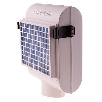

First a couple of questions: Do you rent or own? In other words are you allowed to cut a 6 inch hole in wall? Second question:  Is this going to be a permanent long term paint area? If you're allowed to cut a hole and your going to stay in that part of the house to paint I would suggest venting your paint booth with a clothes dryer vent below the window out of sight. If you spray acrylic only you could use an indoor clothes dryer filter.

Well I live in parents house, so can't really put a hole in the wall. YH70 that would work but it have to go over the screen.
Im wandering if I can just put the dryer vent hose on the screen its self, although it may just blow back in, and wouldn't want paint on the window.
Im wandering If I take a box fan face the fan part straight on a wall with a heavy filter in place, then on the back of the fan where it would draw the air and place a filter there, if that would do anything.
The paint and the fumes would go straight into the wall its self aka dry wall and I could tightly seal it.
I also wander if venting it into a tub of water would do anything. The acrylic smell could be tolerated with out a booth, It's the lacquer or urethane clear I would be spraying sometimes is what the problem is.
