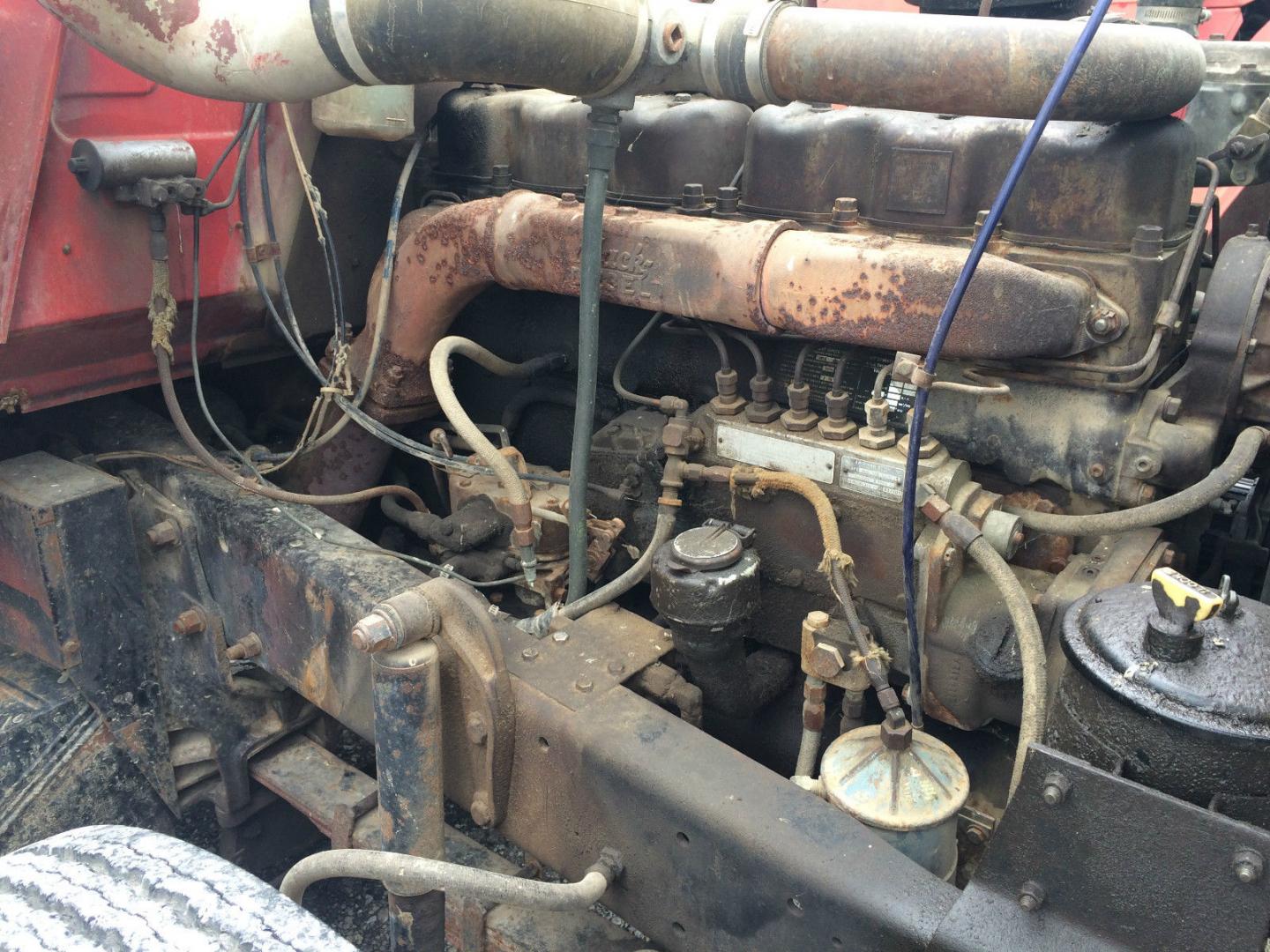

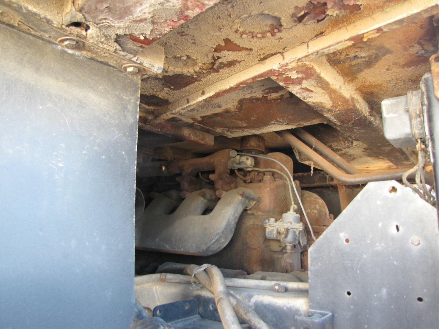

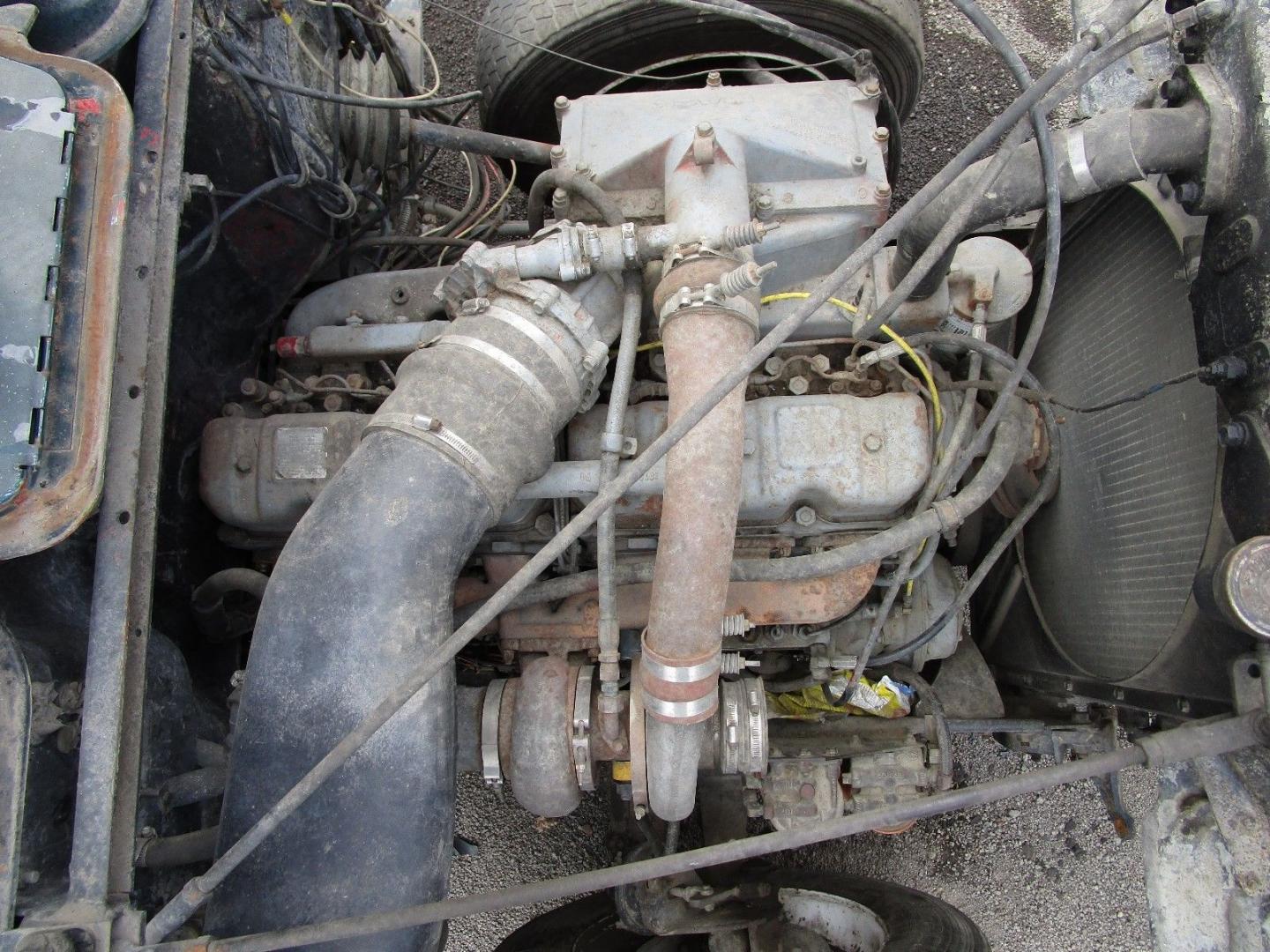

I am building an ENDT 673.I'd like to add the fuel injector lines but I am having trouble finding good photos or drawings. The line appear to go up , then across the top of the engine between the rocker arm covers and around the front. It is the left side which baffles me. Do they go to the top of the heads along the covers or behind the intake manifold between the runs?
The injectors are on the left side and the pump is on the right. Two lines go around the front of the head and the rest go between the valve covers on most I think as you said, but some run around the back of the head as well. You can see the injectors in the second photo.
