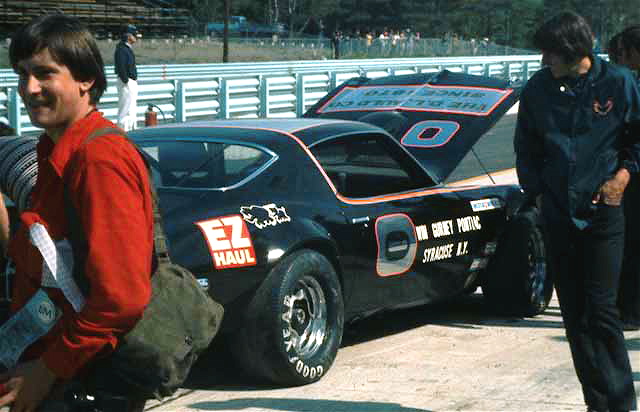

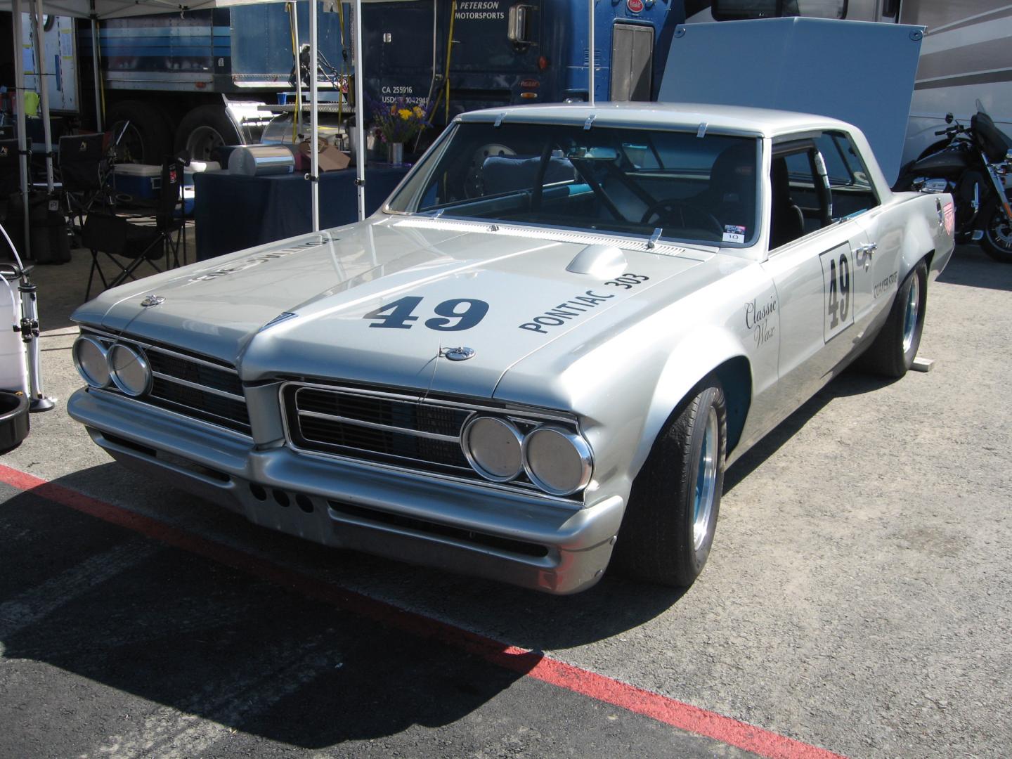

A couple of comments on wheel colors on the Titus Firebird and the Tempest.
I am going to guess that the restored Titus Firebirds were researched thoroughly when they were restored. My long ago impression was that the door numbers, and likely the wheel centers, were painted a blue intended to mimic the center blue stripe on the production car.
(BTW - one tidbit. Herb Adams told me he designed the original center hood stripe, of which he is quite proud. Although known for his engineering prowess, as evidenced by the Vivant one-off custom he did when he was still in his 20s (the design was basically done as a scratch-built model in high school).
Also note that teams needed an absolute bare minimum of 6 wheels for dry, because you would typically change two (on the same side of the car at a pit stop, and then you could get two new tires mounted before the next stop, if you were going to change them again,  But if there was a puncture, 6 wouldn't be enough. Then you needed a minimum of 4 for rain tires.  As a result, different finished wheels would be used, and even sometimes they didn't all match during a race.
Next, if you are trying to duplicate the look of the original Minilites, don't go by what you see on the restored Trans-Am racers, the rims on a couple of brands look different up close.
On the Tempest, a huge amount of effort went into recreating the exact silver exterior, and the interior color, which was also used on the frame, underhood area, and beginning with the Elkhart Lake event, the Minilite centers.  While it was often described as Pontiac engine blue, that wasn't what was used originally. I asked Tom Nell, the engine builder, who passed away a  couple of years ago, what he used on the engines. He bought a Pontiac Blue engine paint at the local auto parts store (Duplicolor was a popular brand then but he didn't recall). Having looked at the various Pontiac production engine paint colors, what he used doesn't, to my eye, match any of them. On the frame and interior, and on the wheels, the guy responsible for the body bought gallons of a blue epoxy from a surplus store, and used a brush, I think, for it all. To my eye, the color we ended up picking for the restoration is a teeny bit more tourquoise-ish than what we used originally, although because all of the color photos from 1971 have either changed because of the years, or been adjusted in the process of publishing them. Further, while the car was pretty original before restoration, on close inspection, various parts of the car originally covered with brush-applied blue epoxy, had been spray painted with what appeared to be different shades of blue, and what was left of the original blue could have aged.

Firebird looks pretty cool. Do you have any information on the one black one Herb Adams fielded?
Share this post
Link to post

Yes, it was built for the 1972 SCCA Trans-Am Series, which used very similar rules to the 1971 Tempest.  It raced under number 96 at the first race, where it was driven by Tony DeLorenzo. Herb Adams had originally wanted to drive for the season, and the rest of us supported that decision. Herb decided after the first couple of practice sessions that he wasn't going to be able to do as well as a seasoned driver, and Tony DeLorenzo was drafted for that race. Tony finished 3rd, after pitting because the shift linkage lost a retainer clip which meant no 4th gear. He continued on and finished 3rd. He told me a few years ago if he had just stayed out, and feathered it in 3rd gear, he might have won.
Milt Minter drove the car the rest of the season and finished 2nd at the next race at Bryar, and it used the number Zero from then on.
In the spring of 1973, it was entered in the Road Atlanta Trans-Am race, with a 366" NASCAR spec version of the motor, but with the same external appearance. We had a problem with the motor before qualifying and ran a 303 in the race. The rules had become a lot more liberal, and other cars including Corvettes, a European Ford Capri, Porsches, etc.
It was a conventional Firebird leaf spring rear suspension, The rear axle tubes were cut welded to provide negative camber, but it was a stock full size rear axle.  It used a very similar front sway bar like the Tempest, but 1/8" bigger at 1 3/8", same front spindles, same brakes.The rear sway bar design was just like a production Firebird.
The frame, underbody, engine compartment and interior were painted flat black. The orange stripe was day-glo on chrome film. Eventually, the main part of hte roof was covered with chrome film.  The engine configuration with dry sump was the same as the Tempest. The engines were painted gloss black. It used a Doug Nash intake manifold,  A search will show you pictures. It had 180 degree headers, fabricated using pre-bent tubing elbows and welded with an oxy-acetylene torch by Herb Adams.. The exhaust exited each side kind of recessed part way into the rockers. With the angle they exited (as a guess, at a 30 degree angle from the rockers) they were cut flush with the body, and with half-oval cut outs in the rockers.
One unusual feature that you probably want to try to duplicate was that it had a very large center tunnel that was hand fabricated, replacing the center part of the floor, from the firewall to the rear bulkhead. Unfortunately, nobody has found complete pictures.
It was far more successful, but didn't get as much publicity as the Tempest.
