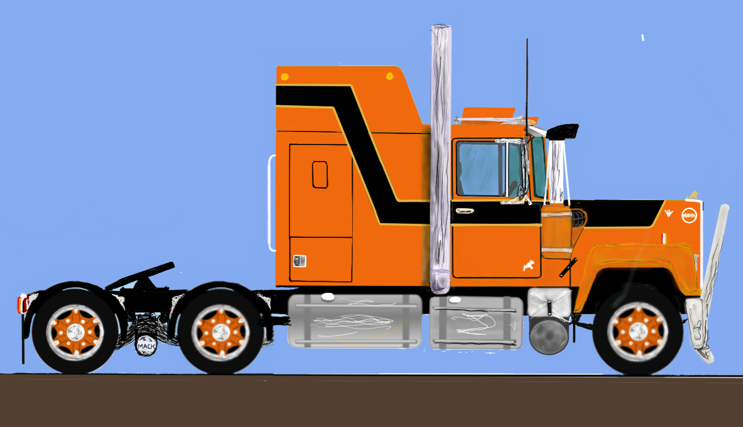

The Renault 360 that I ordered from Italeri finally showed up yesterday so I got started with assembling the Mack E9. This is a European version and a lot of stuff had to be changed to make this correct to what I'm modeling.
  Ok, here we go. I have the E9 together. I had to do some modifications to it to make it more like a actual E9, not a European version.

20210409_172223.jpgthis view shows everything together. I painted the wheel centers a dark orange and Molotow chrome on the rims and details. Well that's it for now be back with more updates soon.
