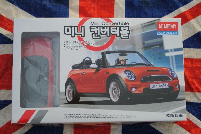

Academy made a kit. I bought one on eBay from someone in Russia.

Thanks, guys!
I've already got the Revell kit on its way, so I'll continue down that avenue.
If either of these had come up when I was doing my searches, they both would have been good candidates for me to consider using.
