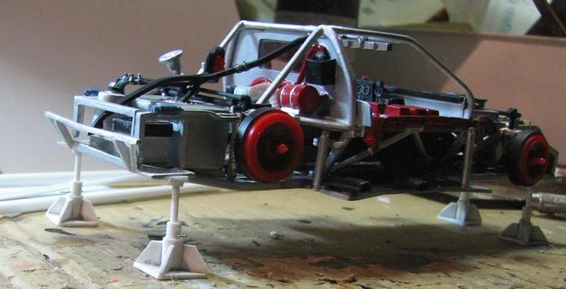

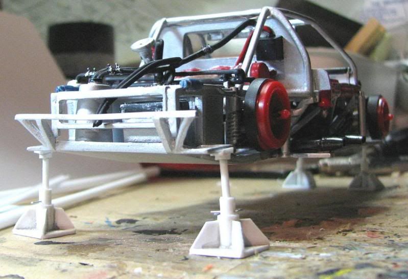

Extending it to July 1 would be great! I had an issue with the Thunderbirds paint and need to strip the body and start over... B) . The rolling chassis and engine are finished and the interior is on its way. I need to finish the six-point cage and repaint the seats... The engine and chassis went together great, I just wish the rest of the car had followed their example. B)B)

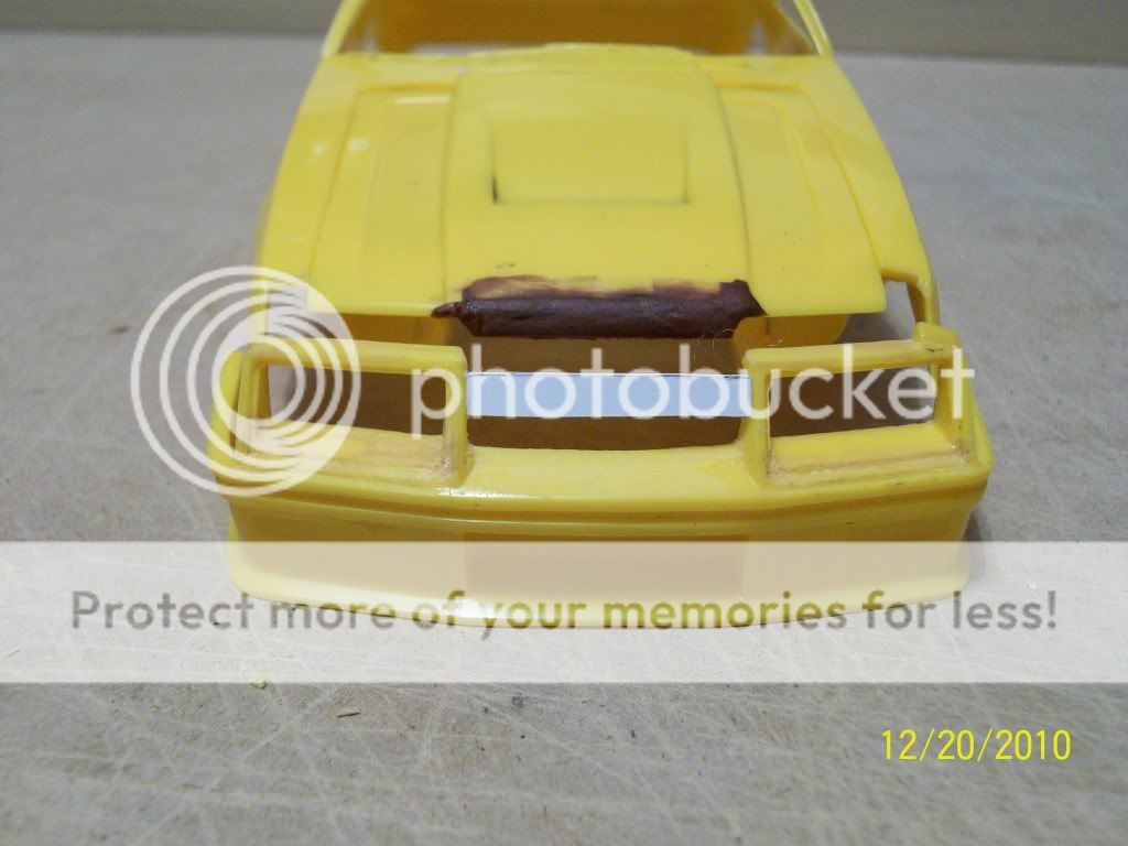

I've stripped off the old paint and I'm changing the grille area to match the '85 style. Pics to follow.

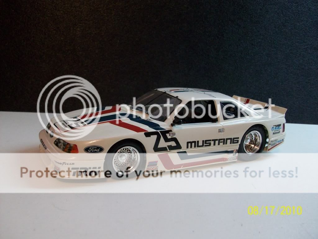

Hope you don't mind me jumping in with a picture of the 25th Anniversary version Mustang racer I built OOB quite a few years back. The decals have seen better days. I also have the "Seven Eleven" car to build but haven't found the correct blue paint color to match the decals yet.

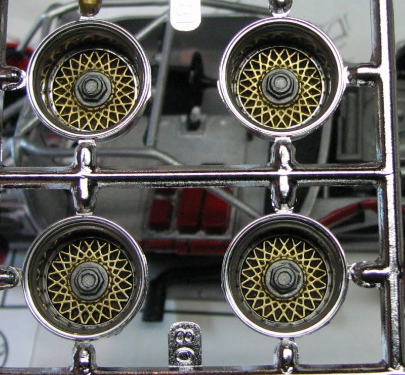

Those wheels look great Tony, and will really show the car well.

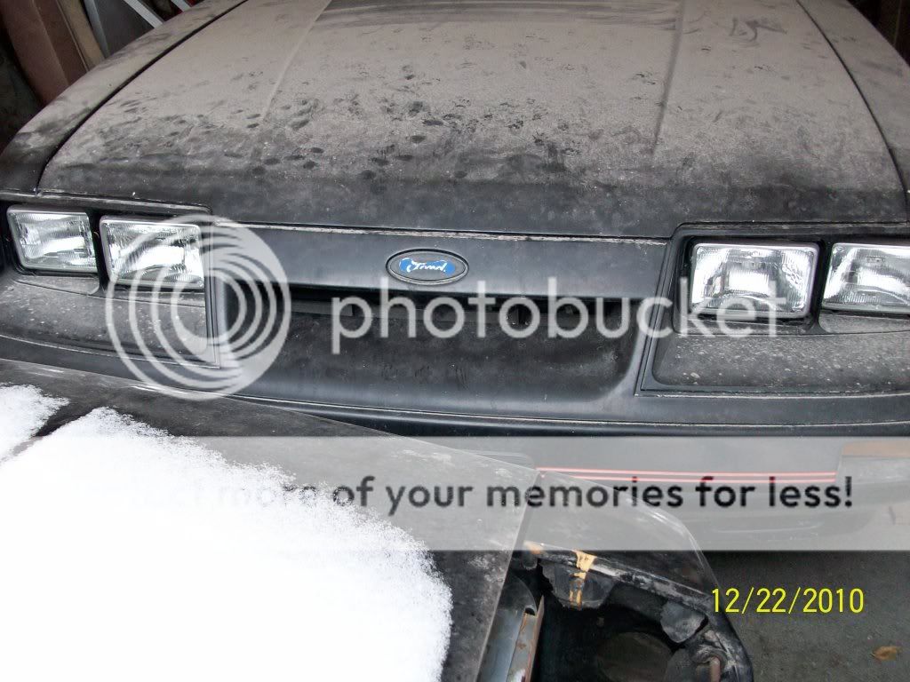

For reference, here's a pic of the (dusty) front of my '85 Mustang. ('86 is the same and unique to those two years.)

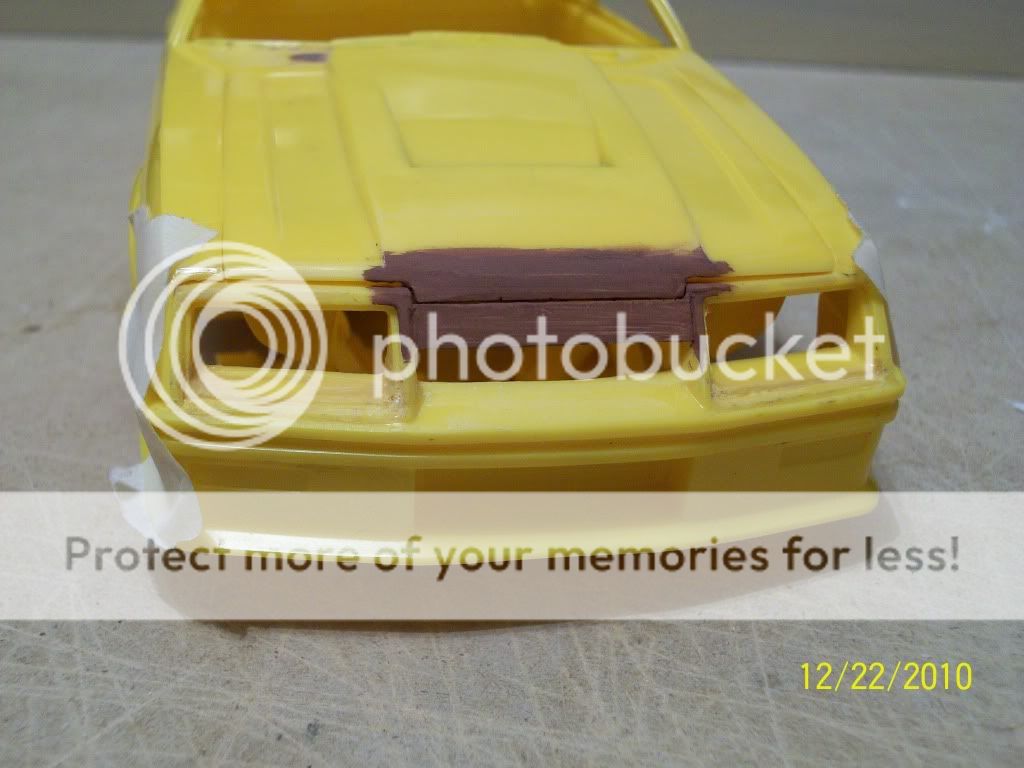

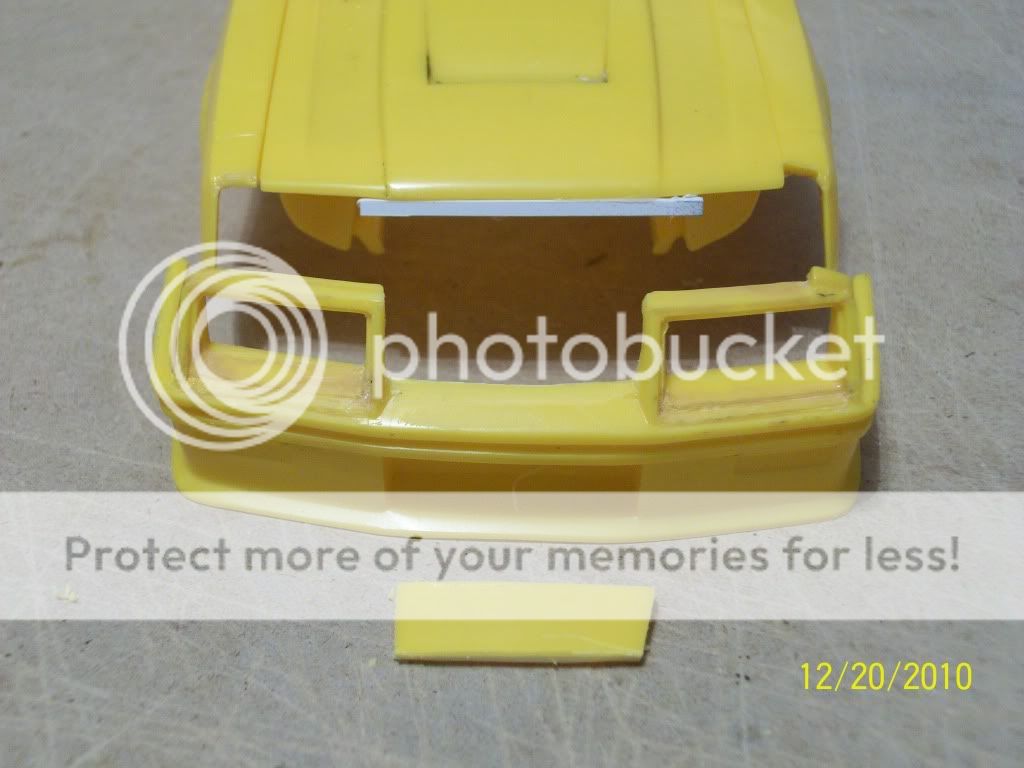

Here's my (sorry... Backyard Billy's) attempt to update the '81.
Still a little clean up and "Bondo" to get the opening exactly right, but you should get the general idea?

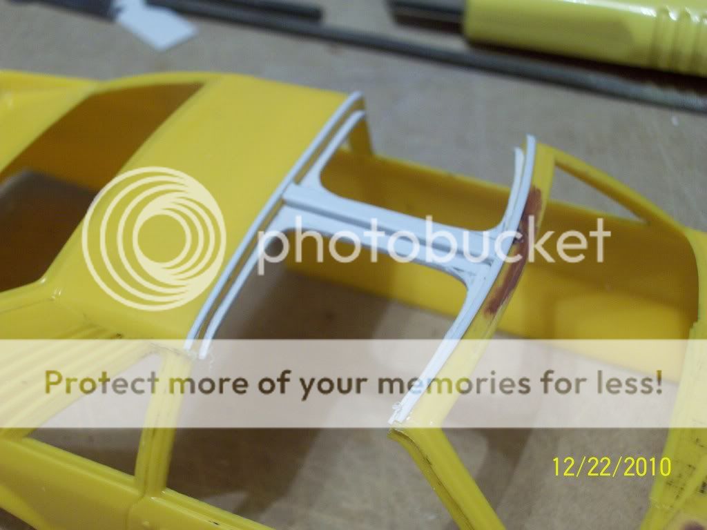

Next job is to carve up the roof for the T-tops.

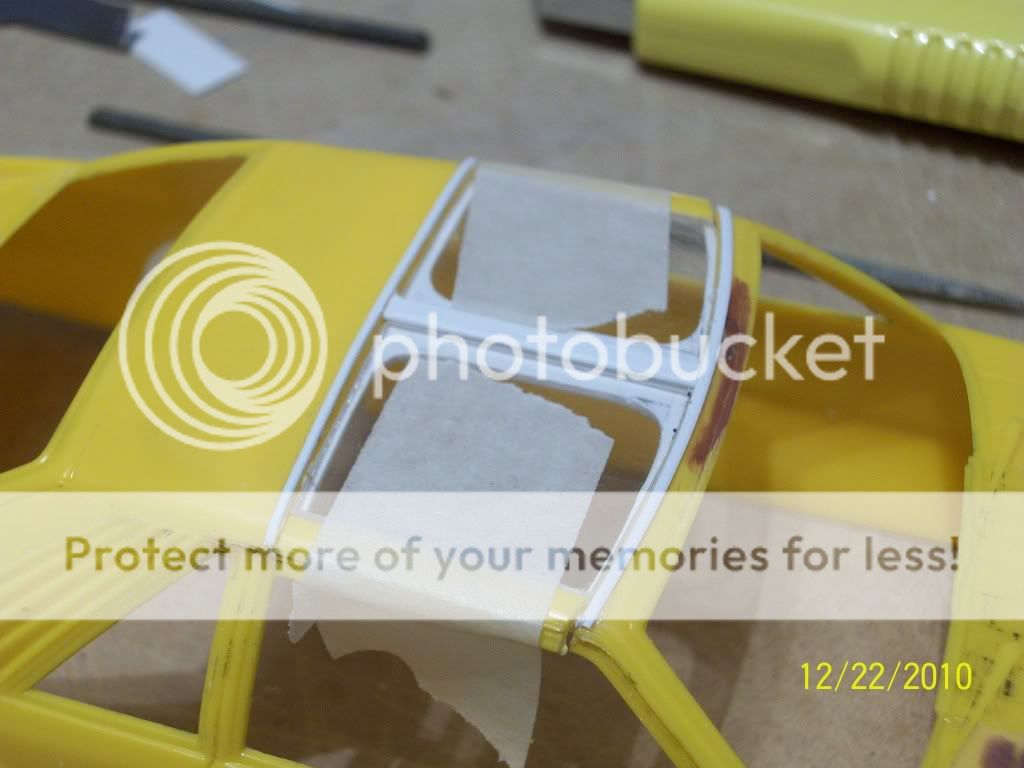

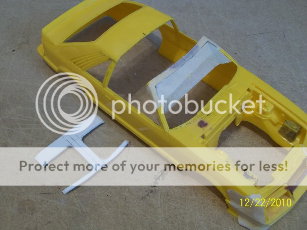

Time to start carving up the styrene for the T-Tops.

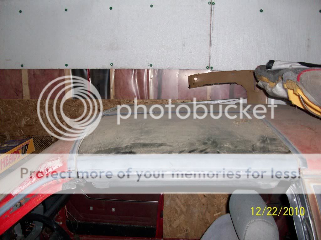

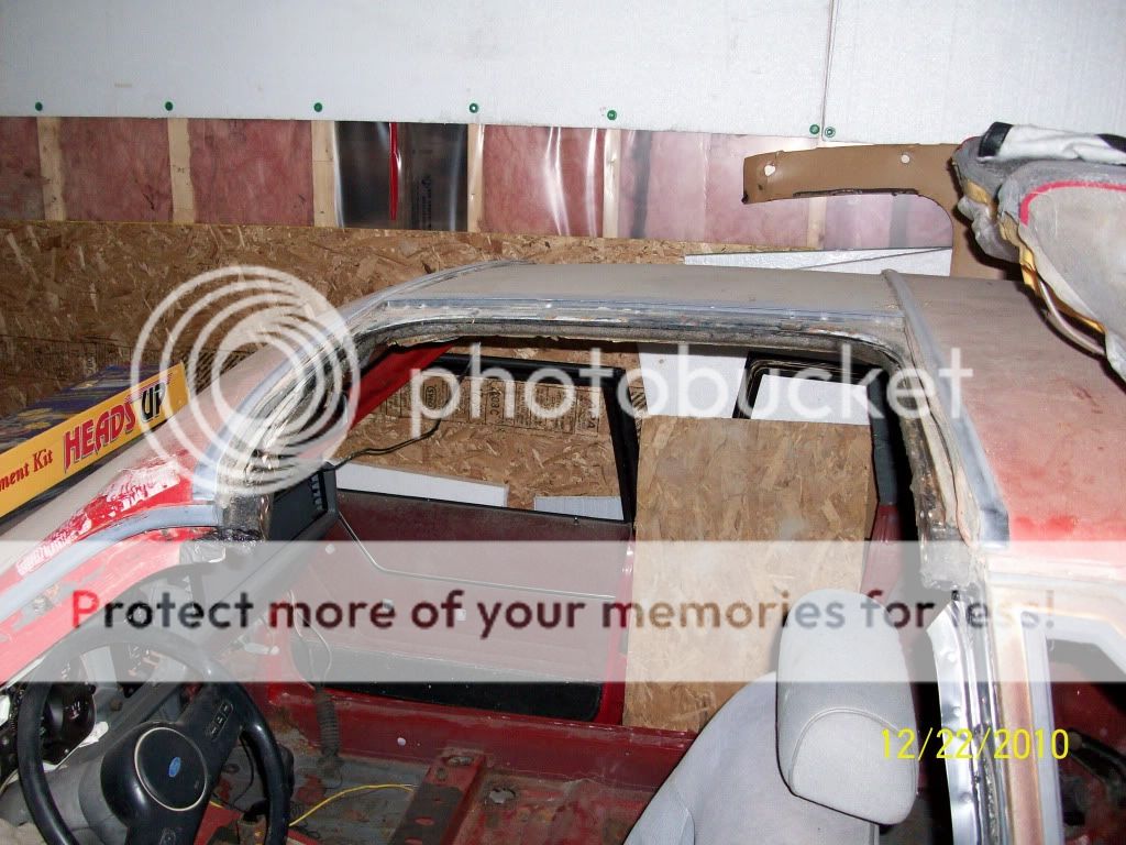

Here's a reference picture of my actual '86 GT roof with the T-top on, and then one with the glass top (and the weatherstripping) removed:
(Did I mention it's being restored?)
I transferred the T-top dimensions I had taken from this car, on to the roof of the build and, with trembling hands, started cutting. Fortunately, I didn't make any boo-boos, so the cut came out clean. Then I made a frame to sit under the roof and support the T-tops.
And here's the 1/24 scale copy of the real thing:
I then built the T-tops from clear styrene with the edges of the cut out roof section used as the edge of the T-top:
