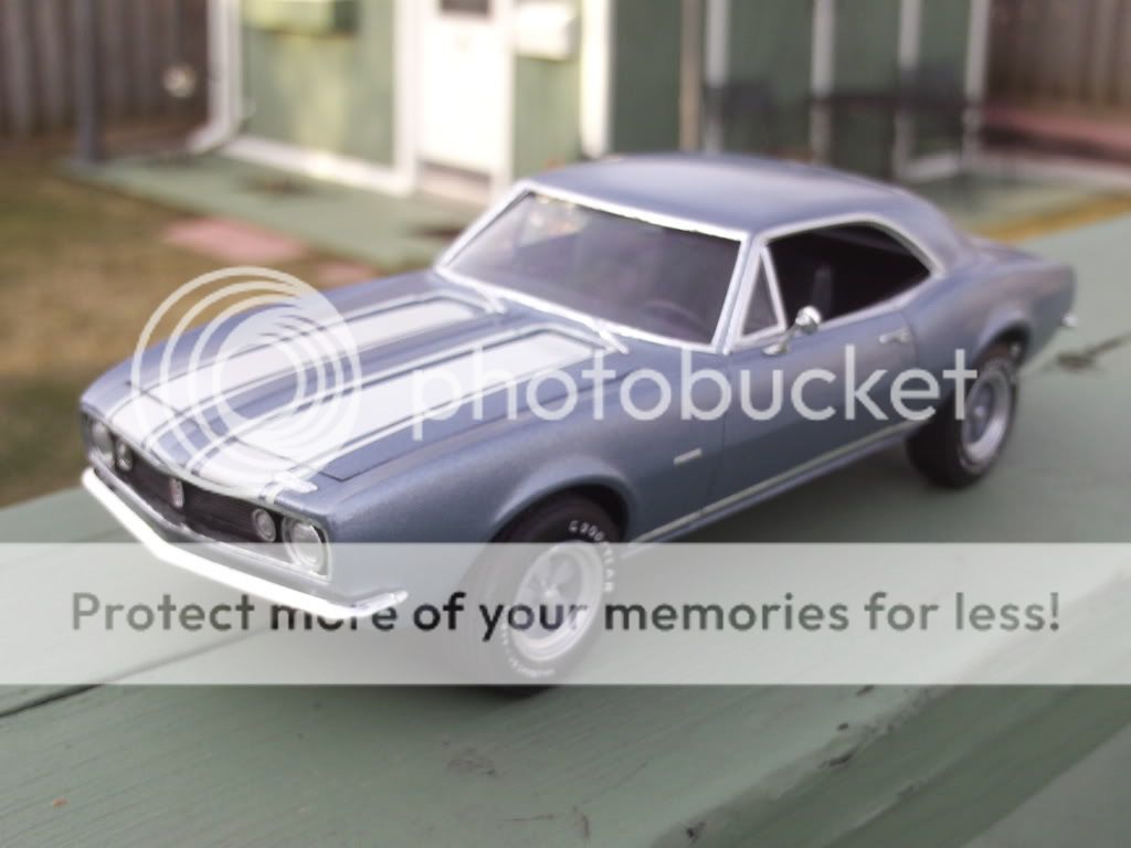

Nick Winter Posted May 15, 2011 Share Posted May 15, 2011 duplicolour primer. I agree, This Camaro has Duplicolor Primer, Duplicolor Paint's, Dplicolor Clear Nick Quote Link to comment Share on other sites More sharing options...
