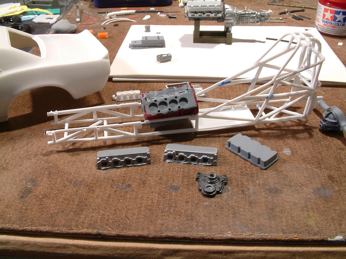

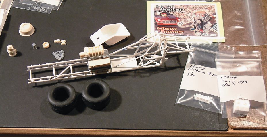

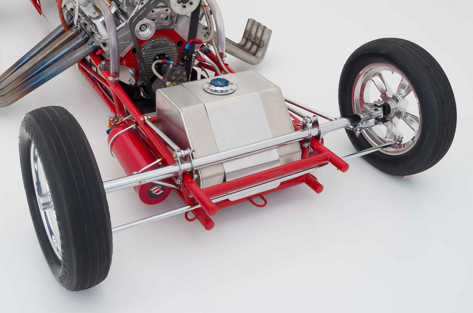

GoatGuy Posted May 26, 2014 Share Posted May 26, 2014 Last year a tribute car was finished for Bruce that he can use for exhibition and burnouts without using the original '68 Camaro funnycar. It was not built for nostalgia competition. I had the honor of taking photos of it a few weeks ago and started a model of it using a Competition Resins body which needs about 1/8" added to the bottom of both sides to match the measurements I took of the body, parts from a Revell car found on ebay for $10, the Ross Gibson Hemi Hunter Chevy engine, Slixx decals, Daisy rear wheels from Speed City resin, front wheels from Harts Parts resin, a 9" Ford rear from Competition resins and a Powerglide trans from them too. Quote Link to comment Share on other sites More sharing options...

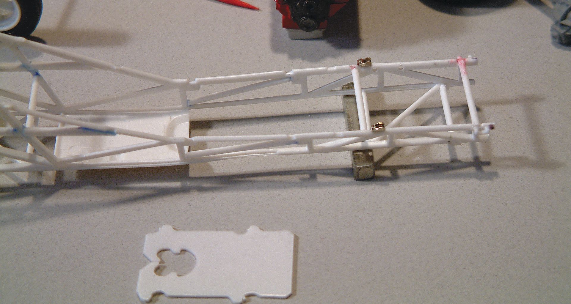

GoatGuy Posted May 26, 2014 Author Share Posted May 26, 2014 (edited) The tranny in the first photo will not be used. That came with the engine. Also used are injectors and fuel tank from Calnaga Castings. I had to shorten the Revell frame and restructure the back of it. I had to file down the injectors to match the size of the 1:1 unit which is 2.75" high. The window opening on the real car measures 14.5" top to bottom and the side from the bottom of the window to the bottom of the body is 28" so I will have to add about 1/8" to the bottom of each side. I really hope to finish this before I start another build. Ha. Almost forgot - the plastic bread wrapper clip is shown just to let you know they are to the best of my knowledge made of styrene and work great for making small parts needed. Thanks for looking. Edited May 26, 2014 by GoatGuy Quote Link to comment Share on other sites More sharing options...

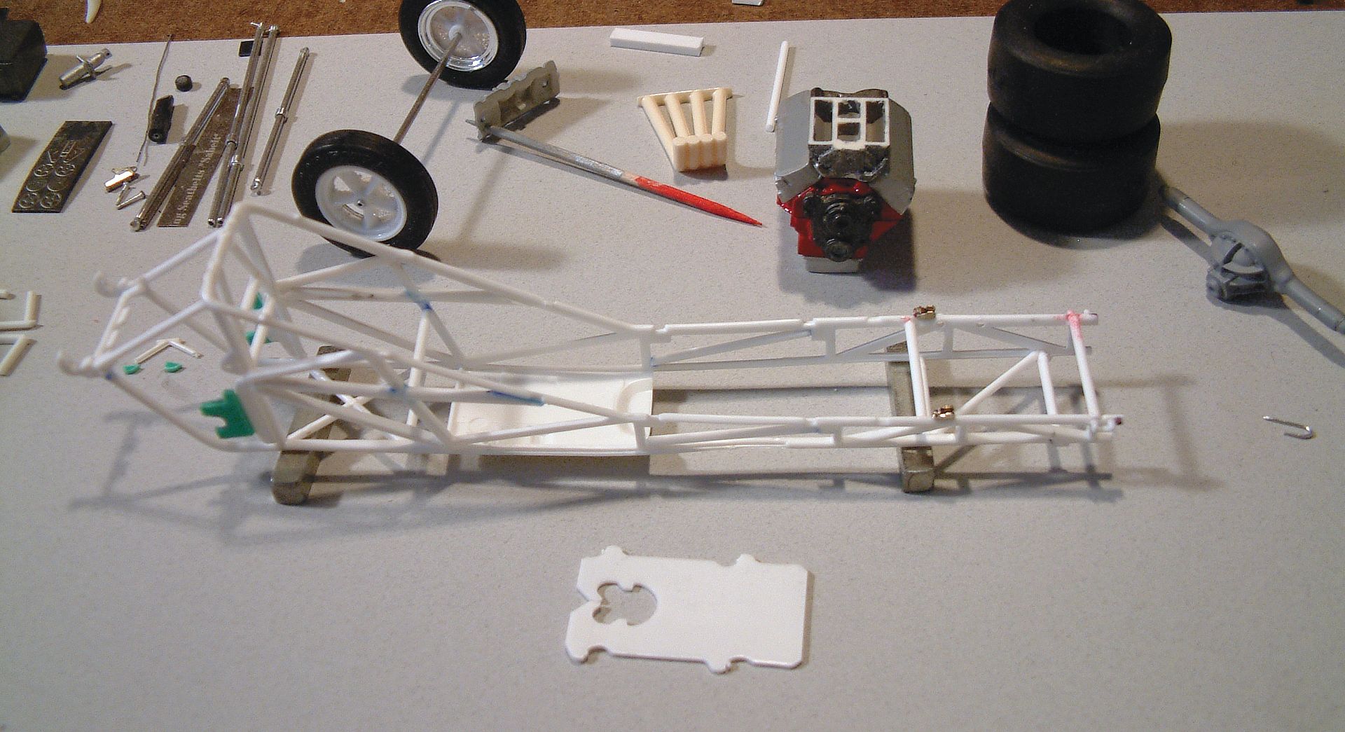

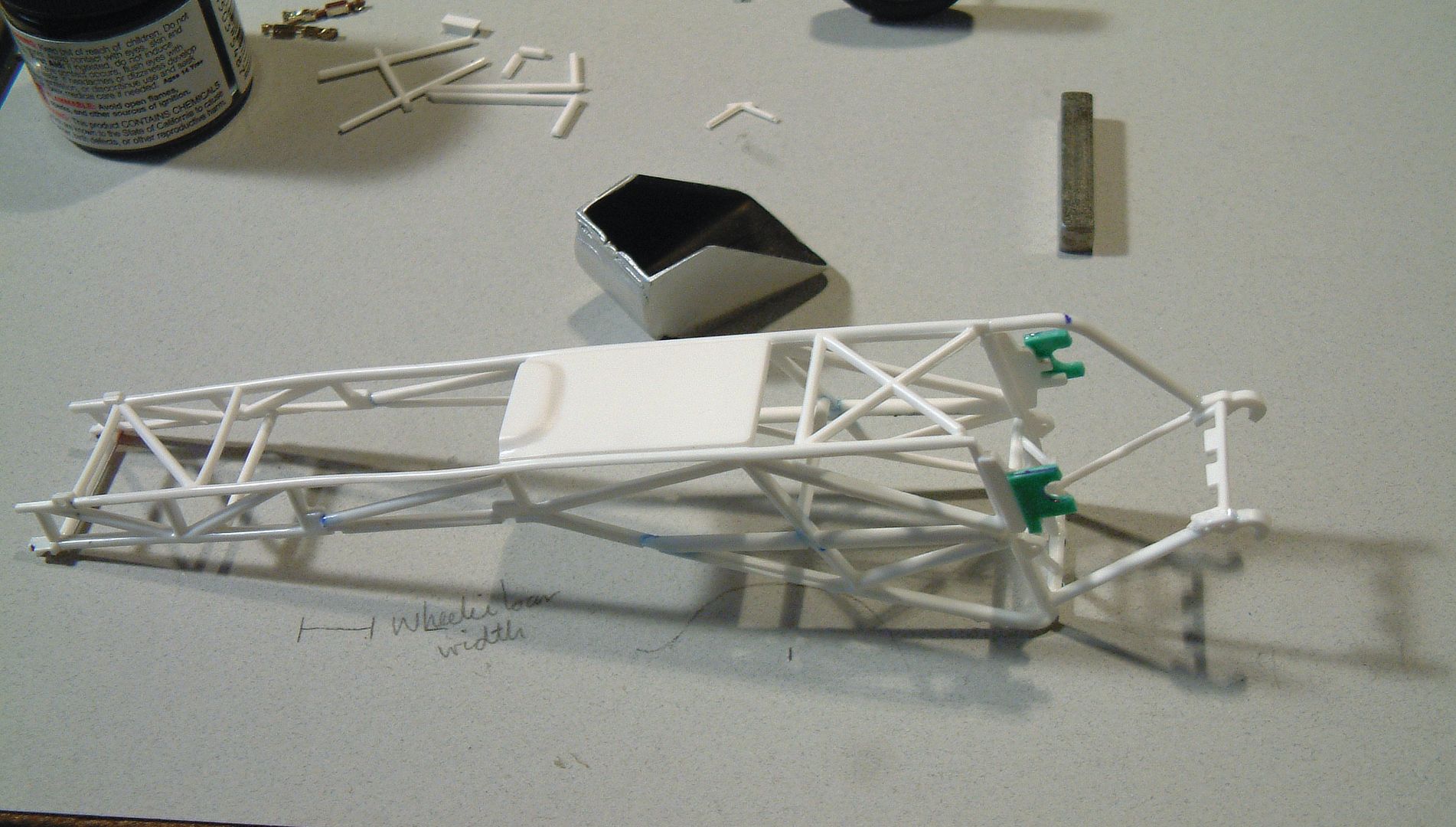

GoatGuy Posted May 26, 2014 Author Share Posted May 26, 2014 The seat had to be altered to match the 1:1 seat by cutting off the vertical bottom part which will be added separately. It and the seat are separated by a horizontal part of the frame. The small green pieces that will hold the rearend were made from one of the bread wrapper clips. The slicks were generously donated by my good friend John Alclad Teresi. There will be a tray behind the driver that holds the battery and an air tank for the driver. Bruce happened to be there the day I took photos and I showed him the parts I had assembled. He was showing me which ones were correct and the ones that weren't. He said the body looked very good. Quote Link to comment Share on other sites More sharing options...

1 bad55 stan Posted May 26, 2014 Share Posted May 26, 2014 Neat idea,any photos of the real car? Quote Link to comment Share on other sites More sharing options...

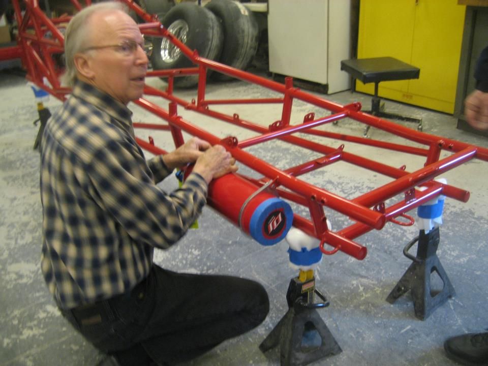

GoatGuy Posted May 26, 2014 Author Share Posted May 26, 2014 Here is Bruce attaching the fire bottles when the car was being built. Quote Link to comment Share on other sites More sharing options...

jwrass Posted May 27, 2014 Share Posted May 27, 2014 MCM, All I can say is AWESOME!!!! HUGE Bruce Larson fan back in the match race days of the 70s (Great Lakes Dragway Union Grove Wisconsin) Soon I too want to build a B.L. car. I Have the Heavy Hugger Revell Funny or the Model King Camaro to start as a platform. I have multiple decal sets for different cars B.L cars. I also want to do a Professor Kelly Chadwick build. I love the bread twist tie, I use those as well I think they work great!!! I will be watching this with much anticipation. What is the green material that will hold the 9"? Again VERY VERY NICE Jwrass Quote Link to comment Share on other sites More sharing options...
GoatGuy Posted May 27, 2014 Author Share Posted May 27, 2014 Thanks guys I appreciate it. James - the green plastic came from one of the bread clips. Quote Link to comment Share on other sites More sharing options...
jwrass Posted May 28, 2014 Share Posted May 28, 2014 Dave, You guys are so lucky in PA you get colored bread clips LOL. Please keep us posted!!!! You have Great Skills!!! Jimmy "RASS" Quote Link to comment Share on other sites More sharing options...
GoatGuy Posted June 1, 2014 Author Share Posted June 1, 2014 James, that made me laugh. I am always looking for small parts that can be used in building cars. The small PE looking tabs on the top of the frame rails were small electrical clips I salvaged from something being thrown out. They will be part of the front "suspension" if you can call it that. Thanks for looking. I'll have more posted later today. Have you ever been to Bruce's barn to see his cars or to the Dragfest in November? Quote Link to comment Share on other sites More sharing options...

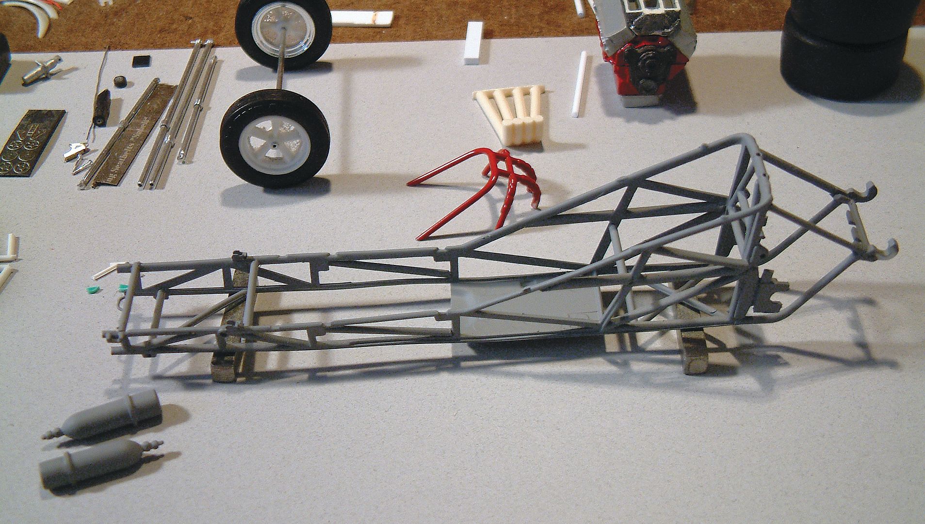

GoatGuy Posted June 1, 2014 Author Share Posted June 1, 2014 I got the frame in primer along with the fire bottles which will be rounded instead of having the Revell grooves in them. And the roll cage part of the frame is painted red awaiting the flat blk for the padding. I also added a pic I found of the completed car. Thanks for looking. Quote Link to comment Share on other sites More sharing options...
