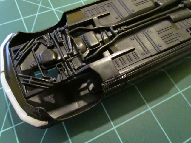

Started with this -

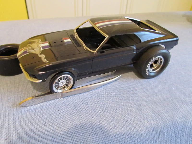

Broke out some old slicks and vintage slotted mags which I will be casting both in resin for future similar projects. And have billet slot car wheels for fronts. I'll be either adding a supercharger with 4 pot Hilborn injection or oversized Hillborn injection with tall stacks. Will do a quick straight axle up front. More to come!

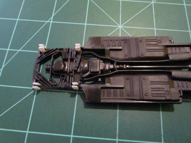

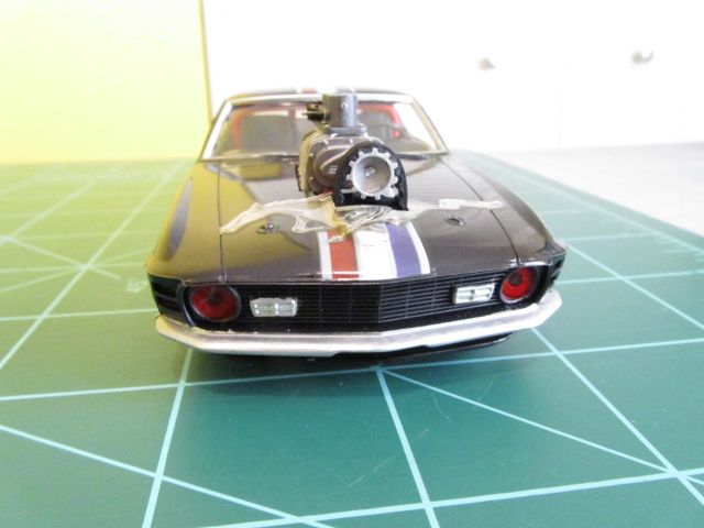

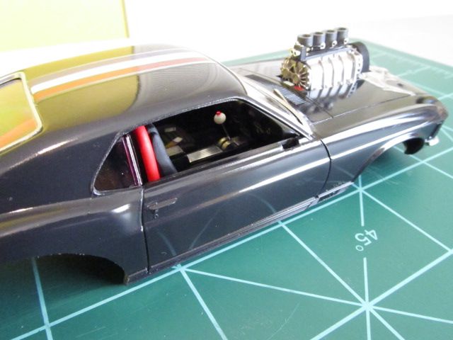

Here are some mock up's after making room for the monster slicks -

Thanks fellas. I found a nice supercharger in my stash that I may wind up going with but still not sure since I'm waiting for my tall injector stacks in the mail. Either way going to put the slicks, wheels, and blower in rubber this week so I have some extras. Think there will be more of these from me lol.

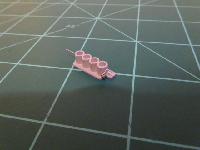

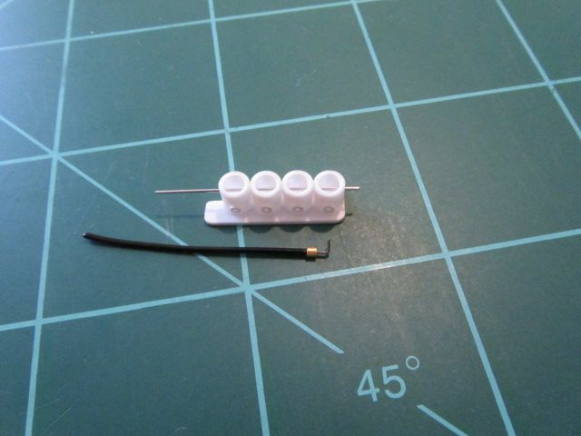

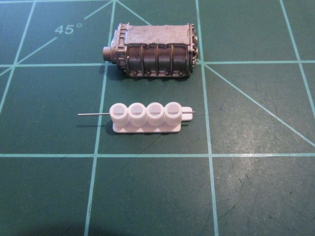

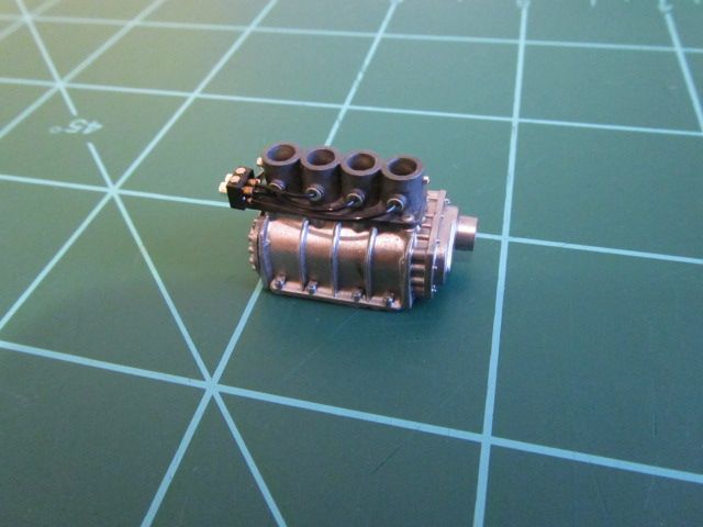

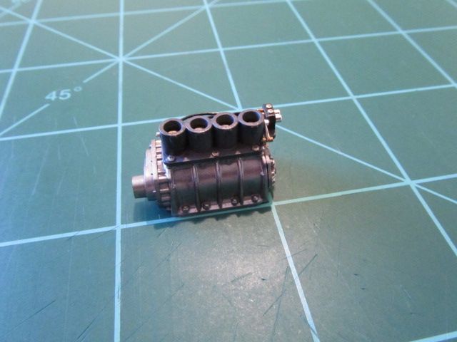

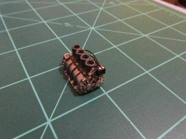

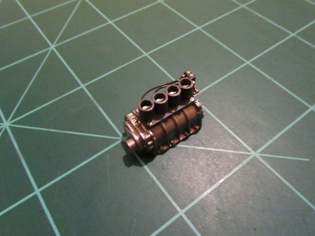

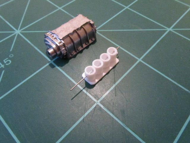

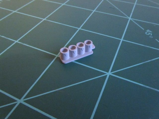

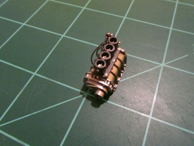

My resin blower cast in gun metal and making the Hilborn 4 pot from styrene.
Punching out the throttle butterfly's from brass sheet.
Added fuel inlets, some photo etched bits, and messing around with possible fuel line.
Hilborn in primer.
Throttle linkage mock up.

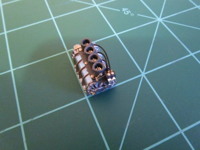

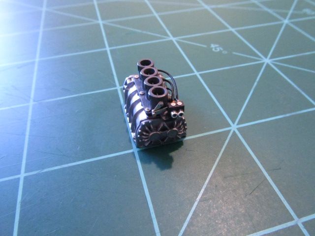

Here I jumped ahead and didn't take many pics in between lol. Made a fuel distribution block with brass inlets detailed with ProTech bolt heads. Linkage is made with some PE bits and held together using items from Scale Hardware and RB Motion. Although individual throttle plates did open and close I fixed them in position for fear of breakage.

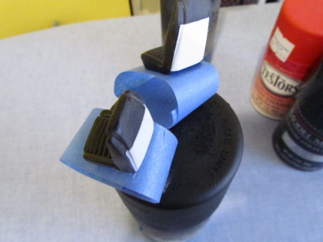

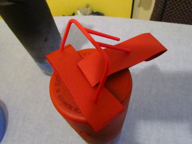

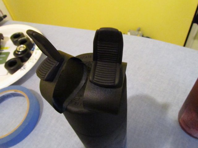

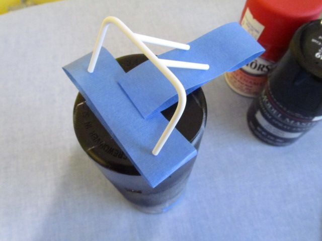

Quick roll bar and made seat backs from styrene as kit seats were unfinished and open.

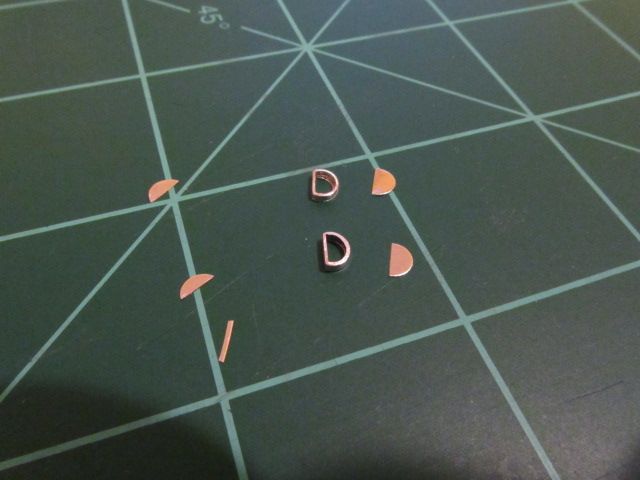

Here I needed a quick shifter gate. Used two slices of aluminum tube with a small section pressed flat on each. Then punched some aluminum discs and cut them in half so they were the same shape as the aluminum tube slices.

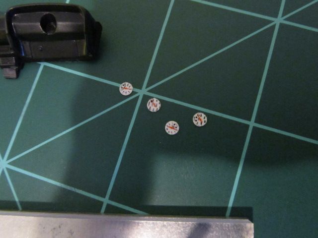

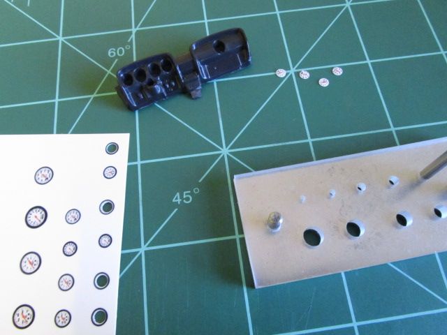

Gauge faces printed and punched out.

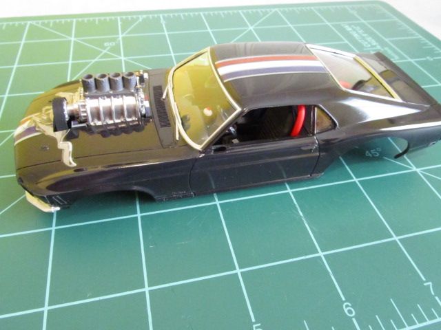

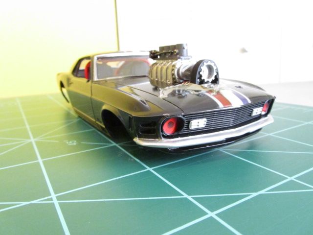

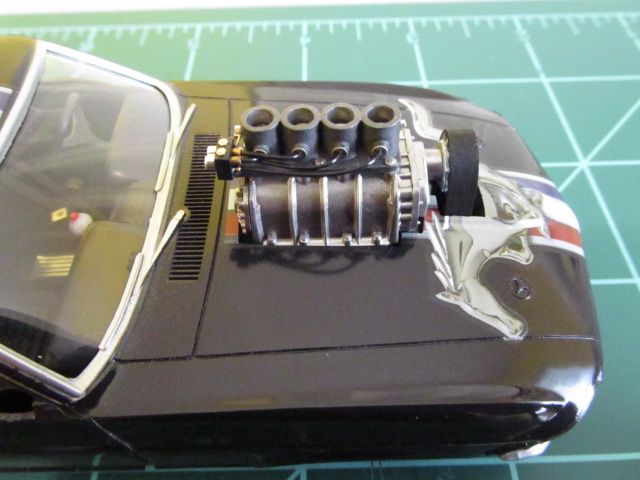

Installed interior, mounted blower, and scratch built cogged pulley which was cast in resin and mates up with real cogged belt. Also added clear red acetate for headlight covers.

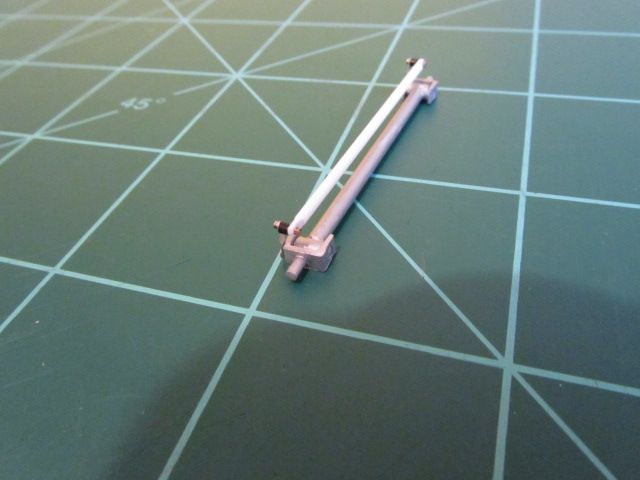

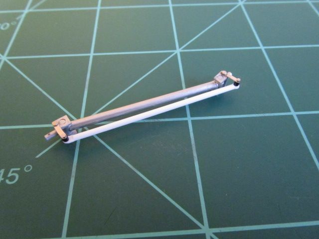

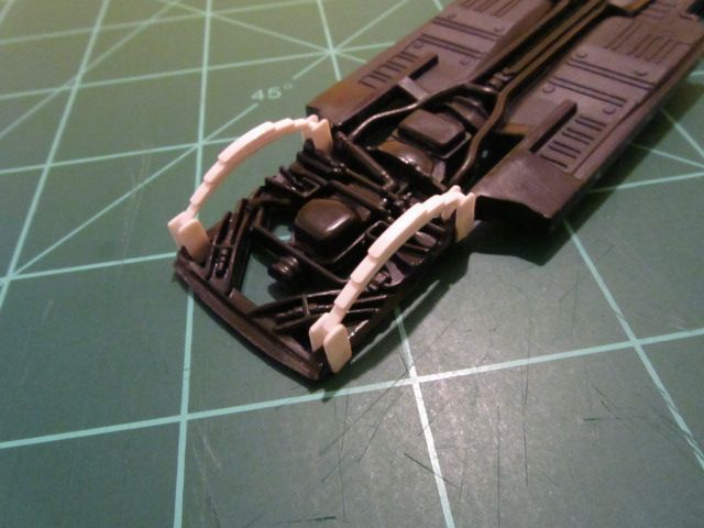

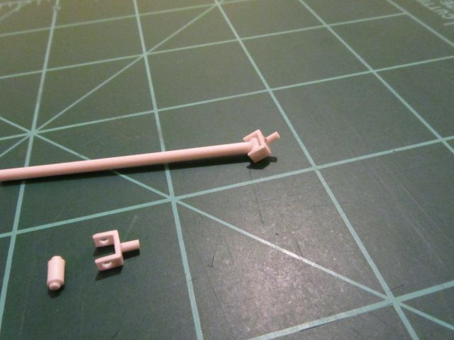

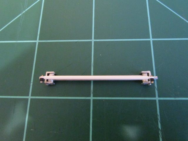

Axle and steering. Mostly styrene held together with Scale Hardware .5mm threaded hex bolts/nuts and a couple PE links. Assembly was very tricky as the parts were super delicate. Working with the .5mm hex bolts/nuts was tedious. Had to use 2 sets of tweezers to thread them together. Topped off the bolts with a tiny drop of epoxy to keep them from backing out.
