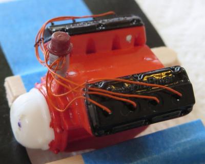

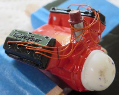

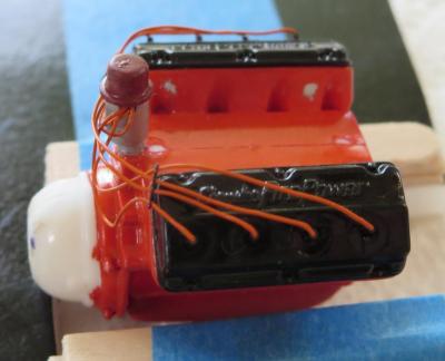

Ok, here's the engine wired, correct firing order, it should be anyway. Everything is from the kit except the wires, looms and boot material, those are from Detail Master. Thanks to everyone who posted in this thread! Bill, you are the man! This wouldn't have happened without your help, thanks!
post-12459-0-36772200-1401234040_thumb.j
post-12459-0-46998600-1401234063_thumb.j
post-12459-0-77675800-1401234078_thumb.j
