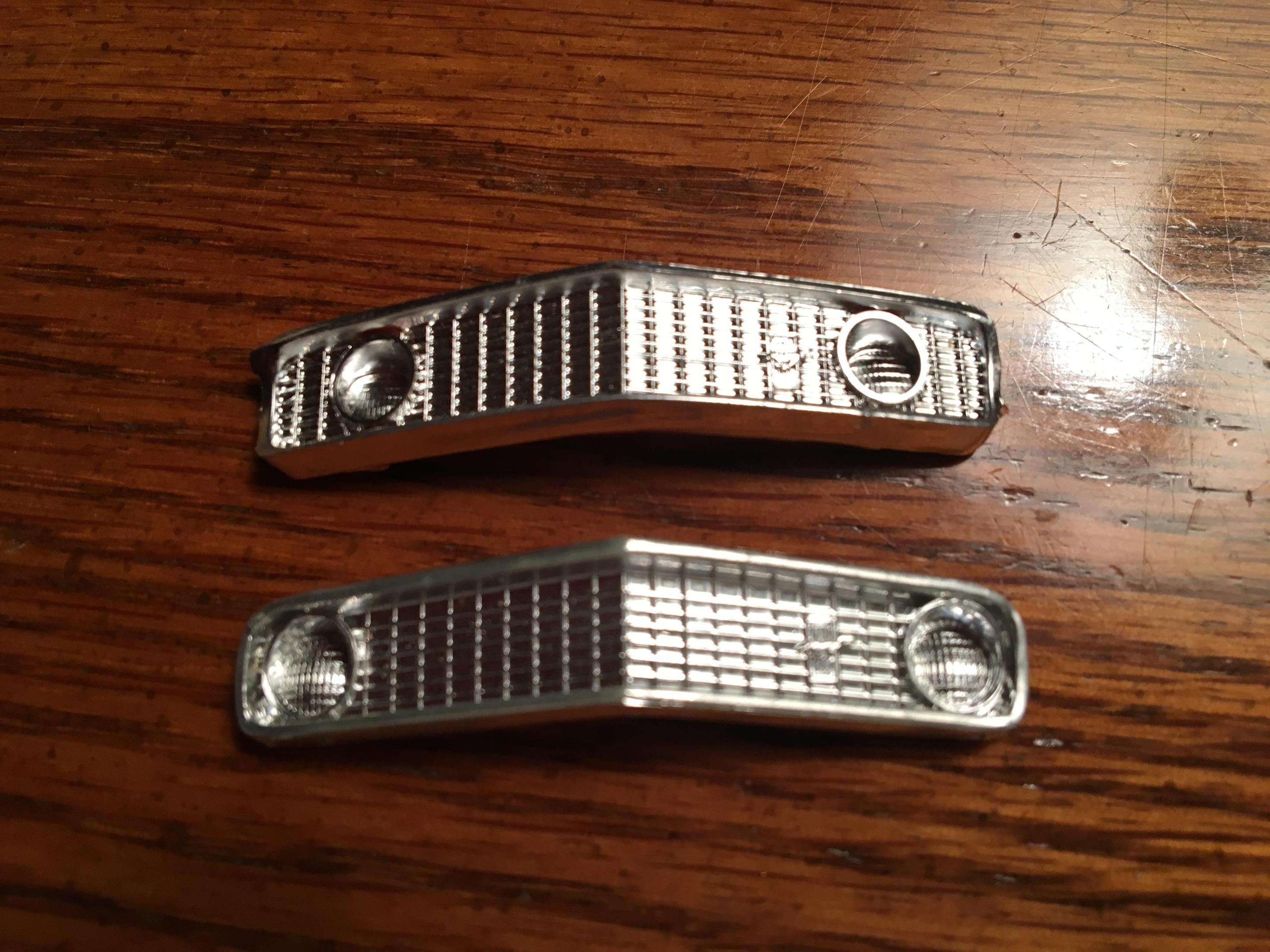

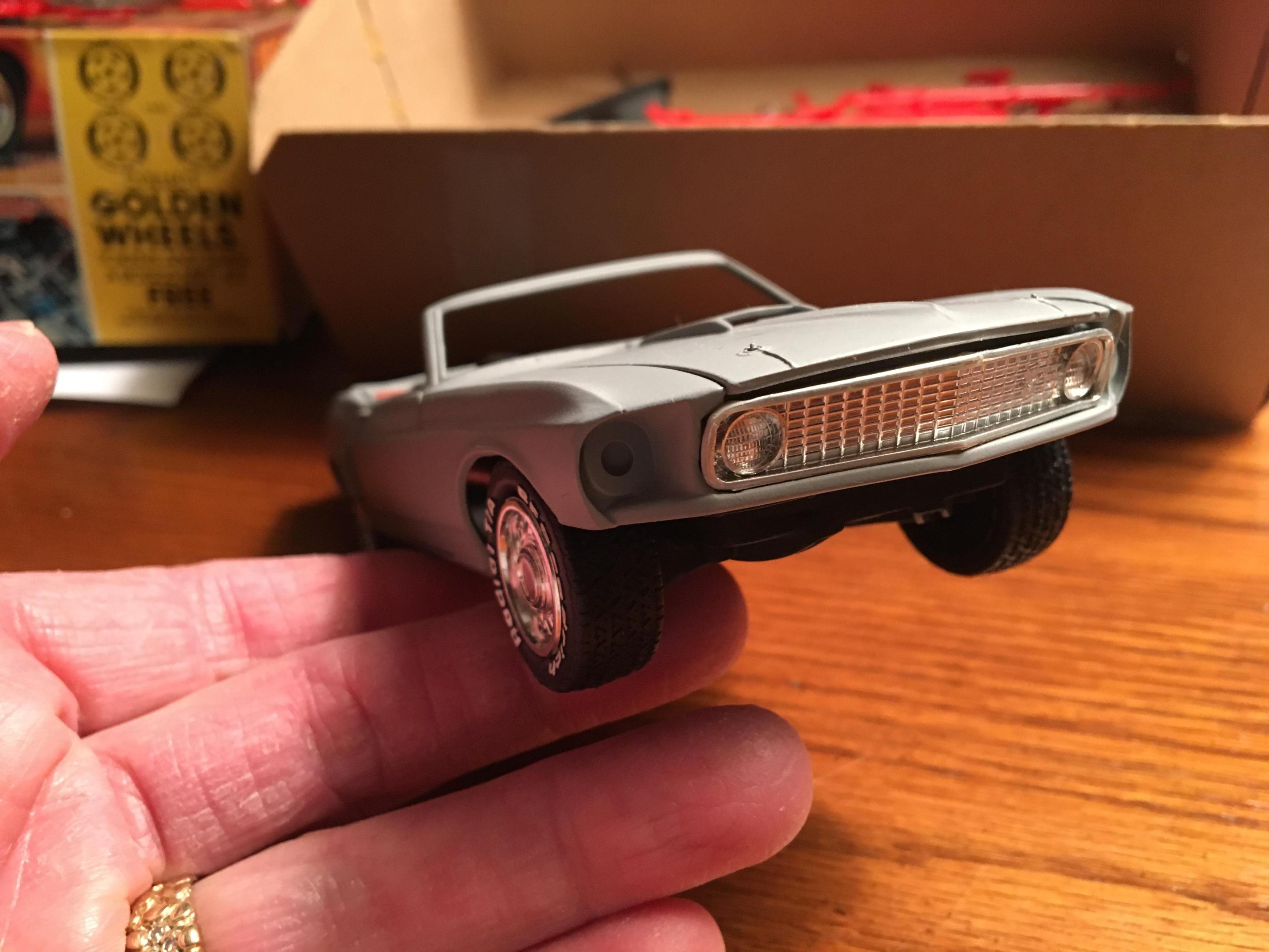

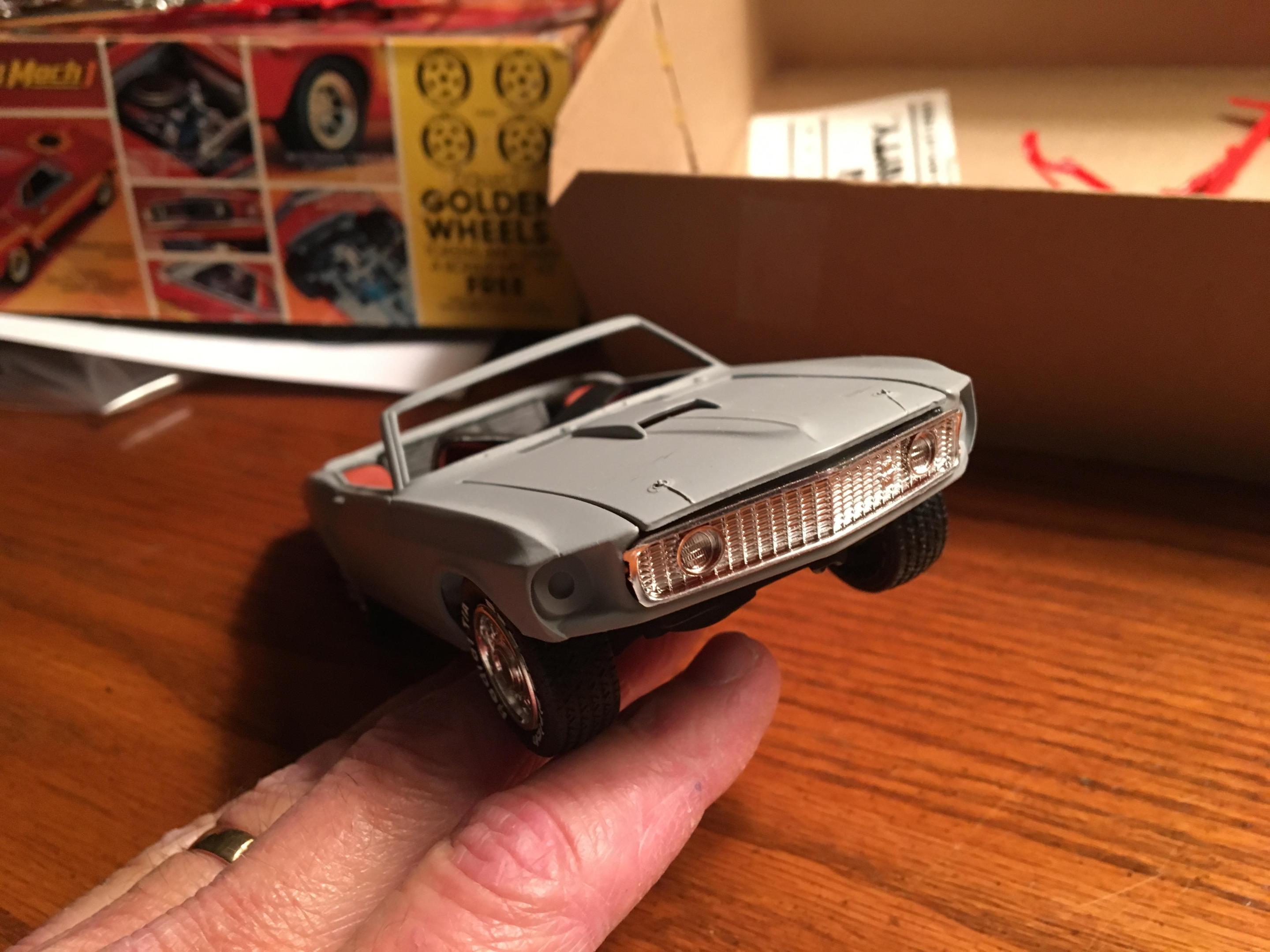

  3. Here is the difference between the AMT and MPC 69 Mustang grilles in the MPC Mustang.

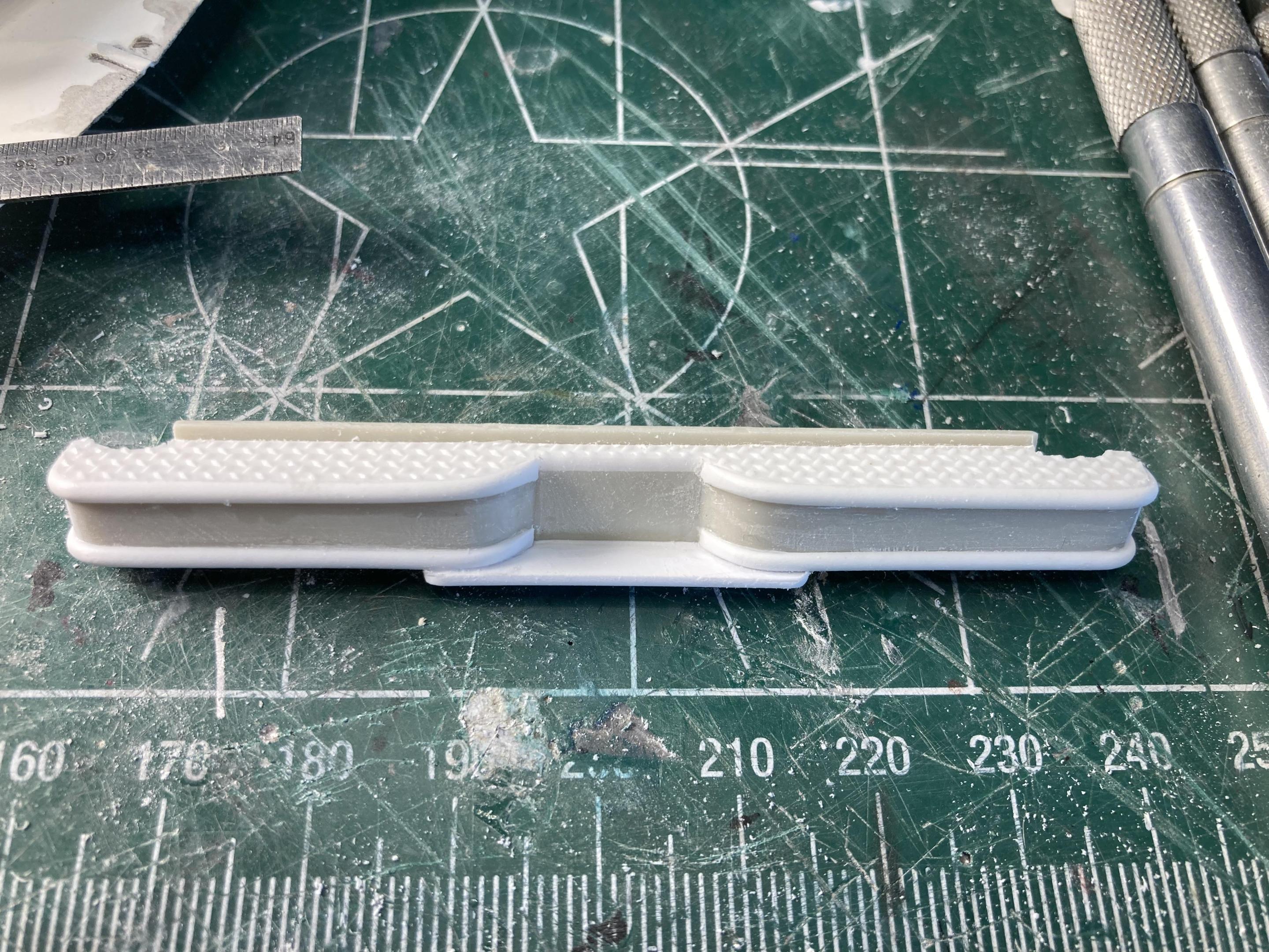

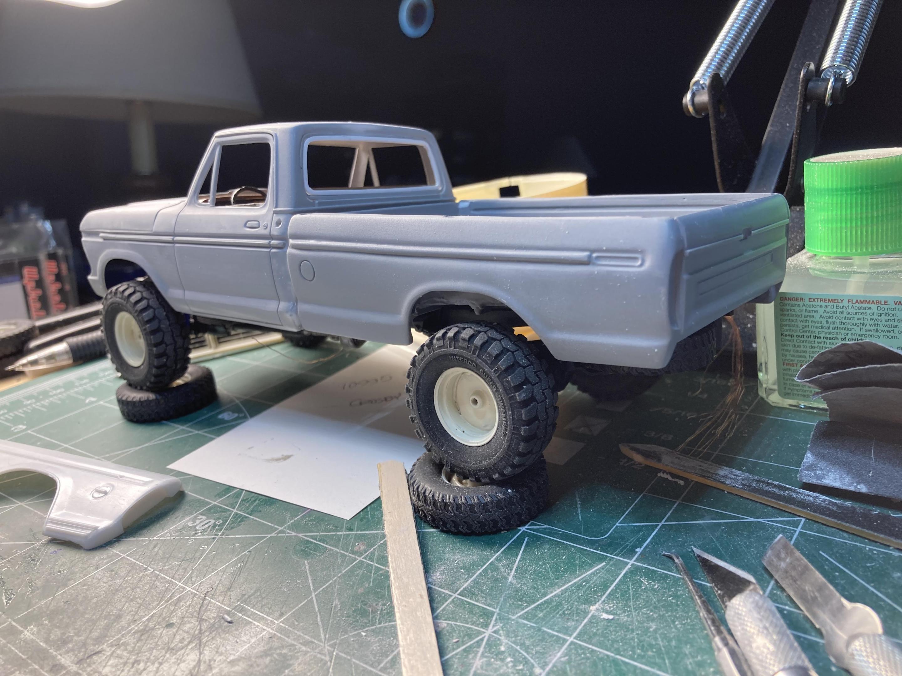

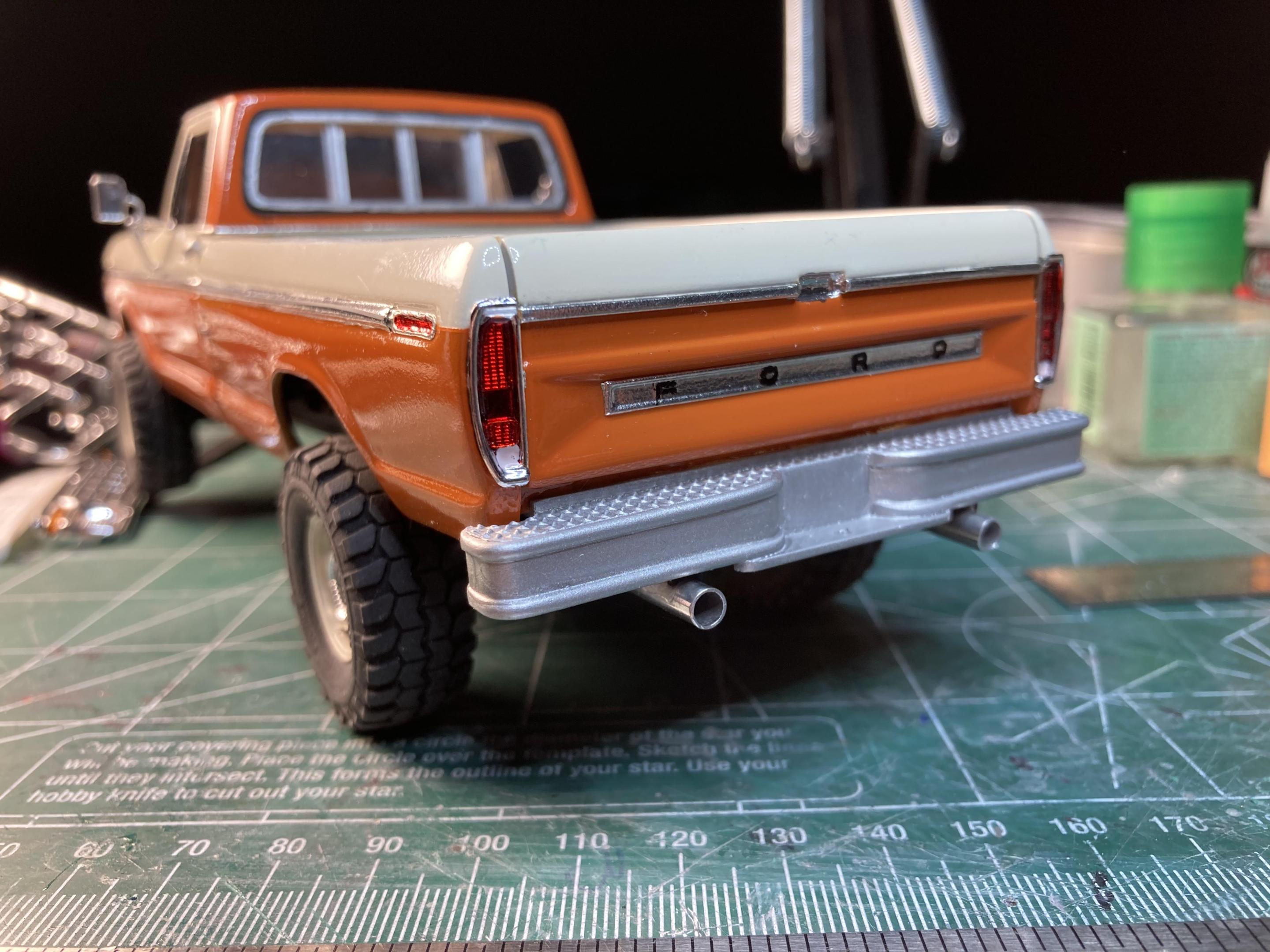

  6. The caster did not cast the stake pockets!! I drilled and carved them. This was a swap meet find resin bed that i bought several years ago. But Morgan Automotive Details is offering them now and they do have the stake pocket holes.

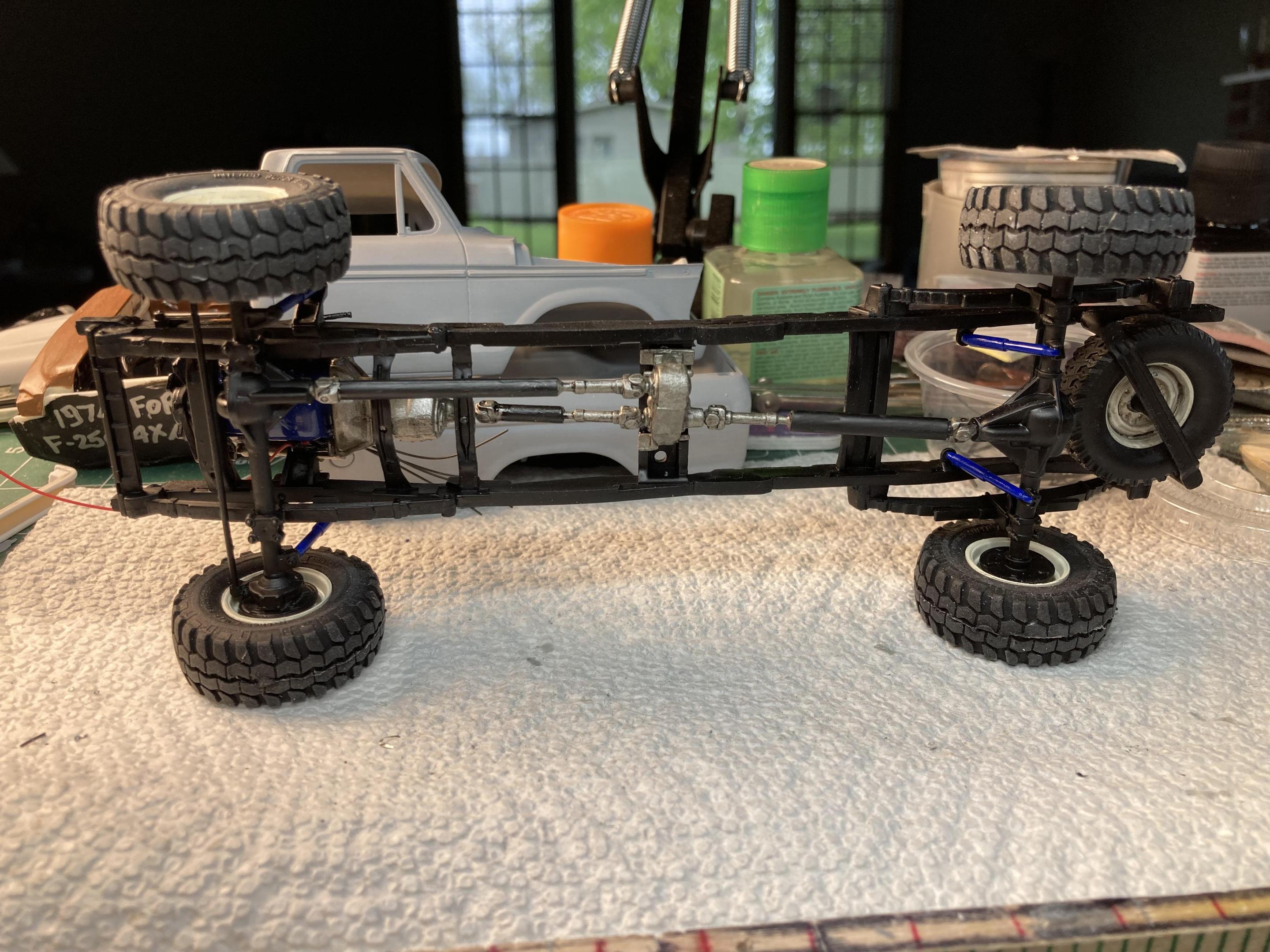

  7. They came with the Moebius Ford F-250 4x4 kit, they also come in the 2 wheel drive F-250 kit.

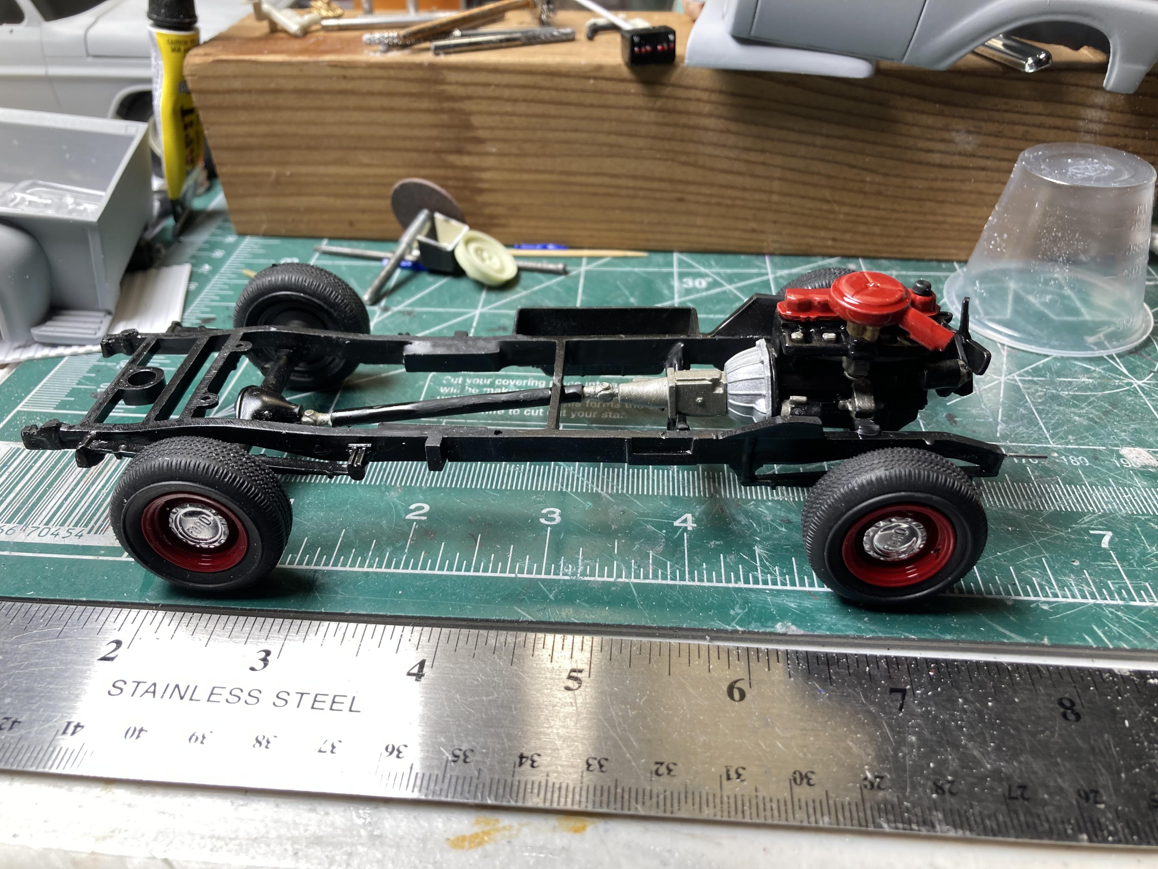

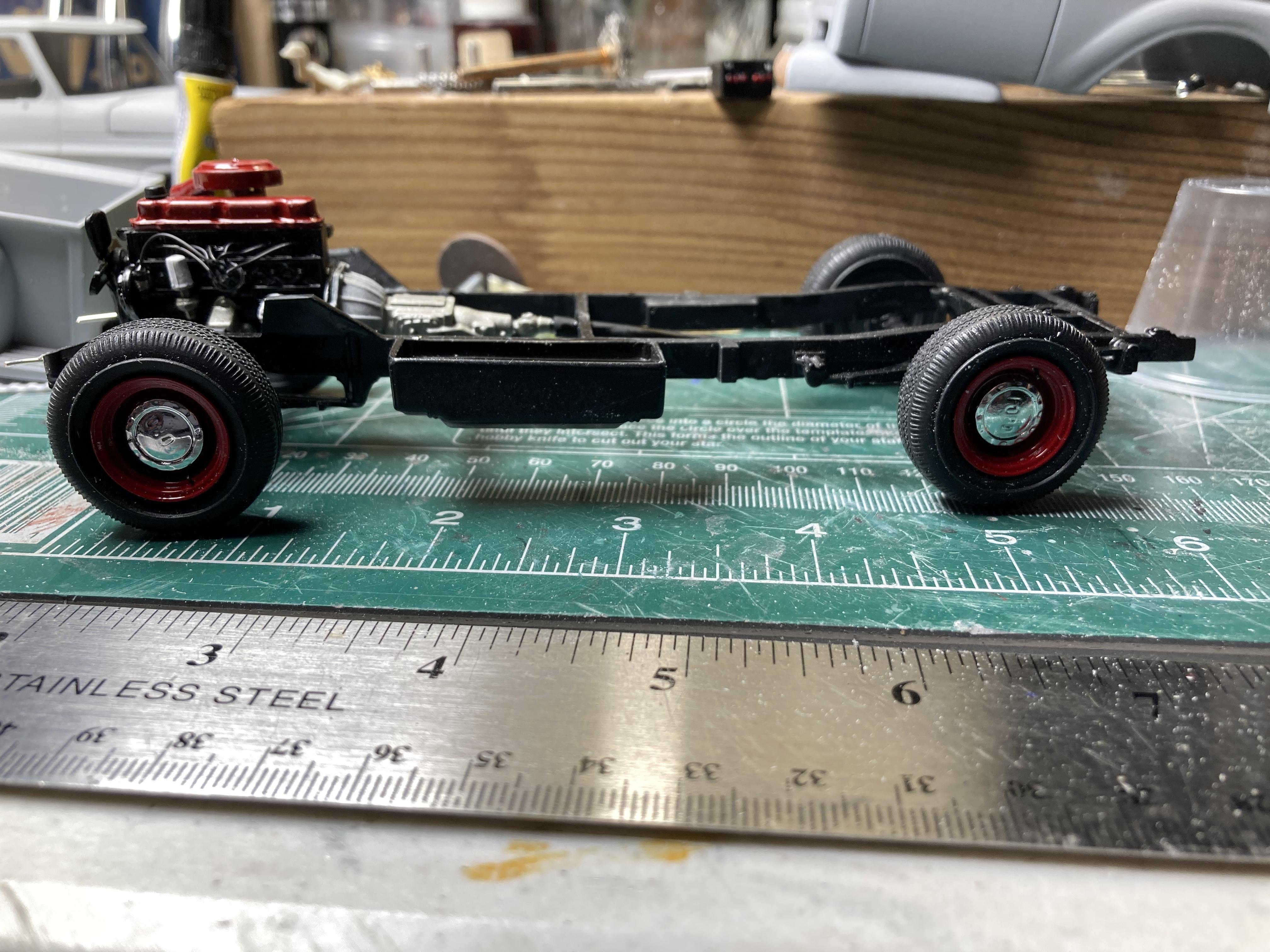

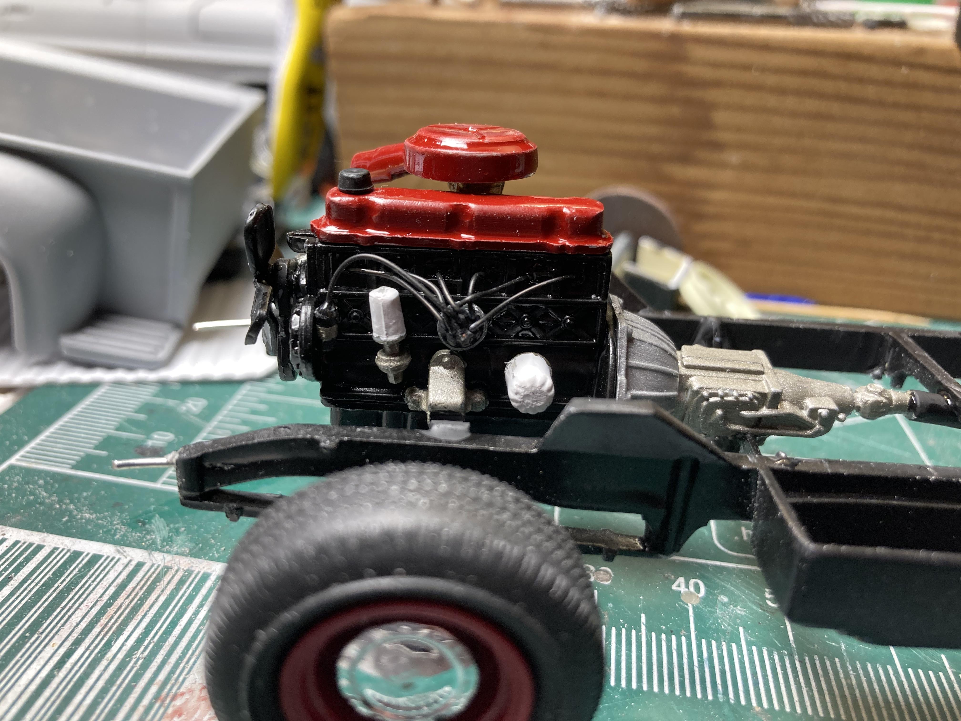

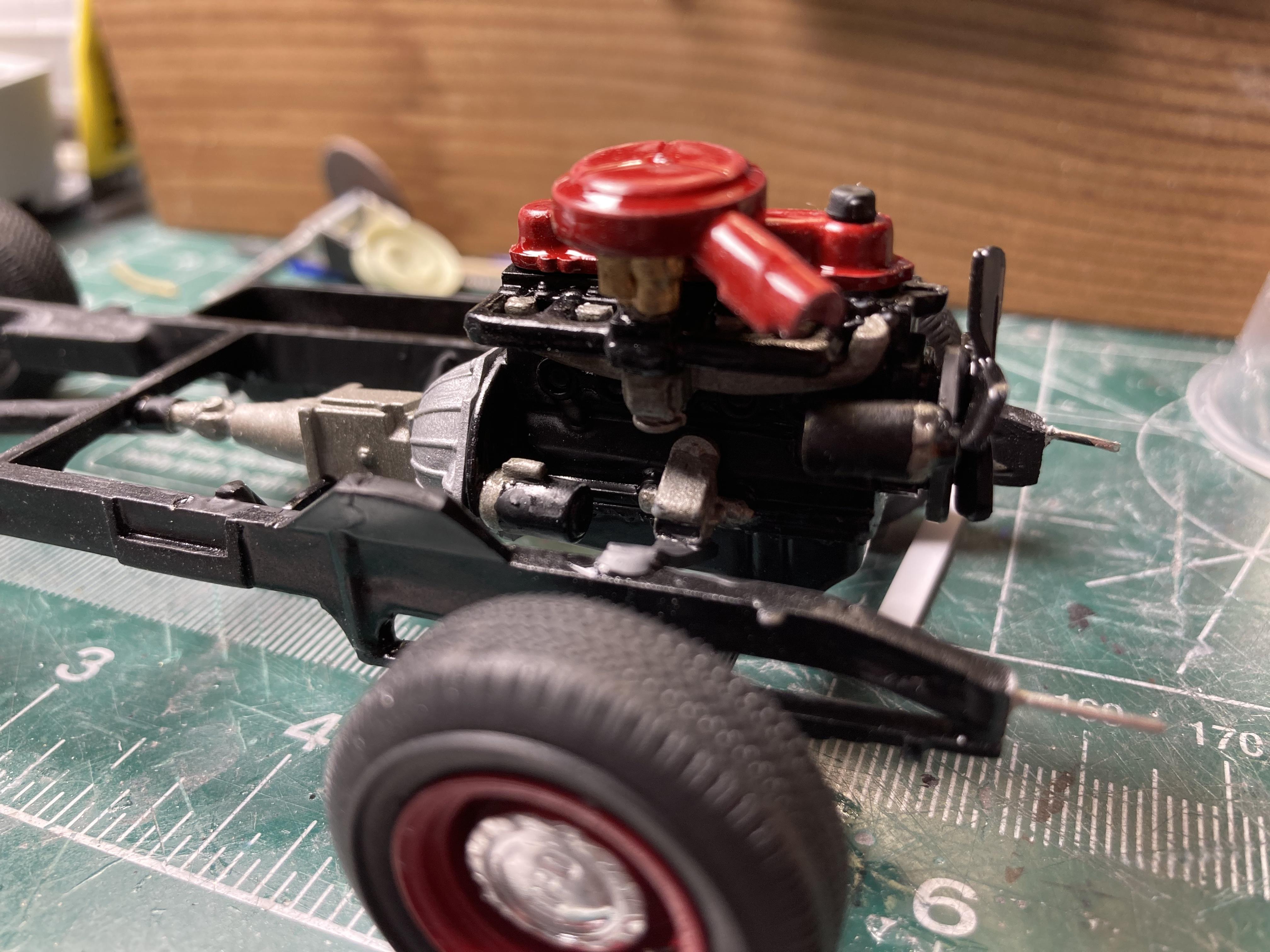

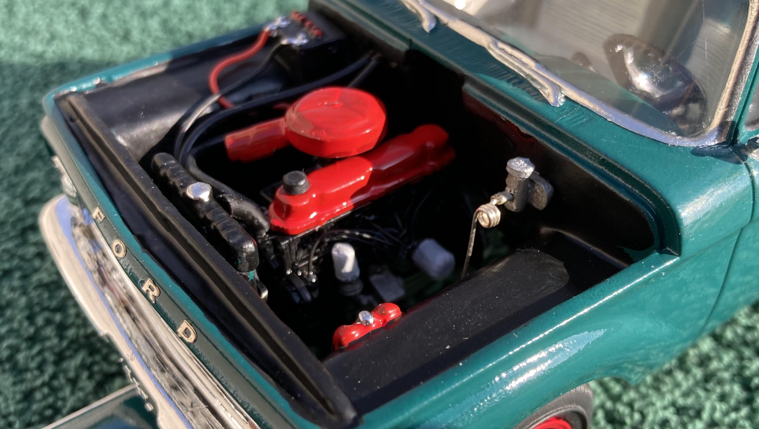

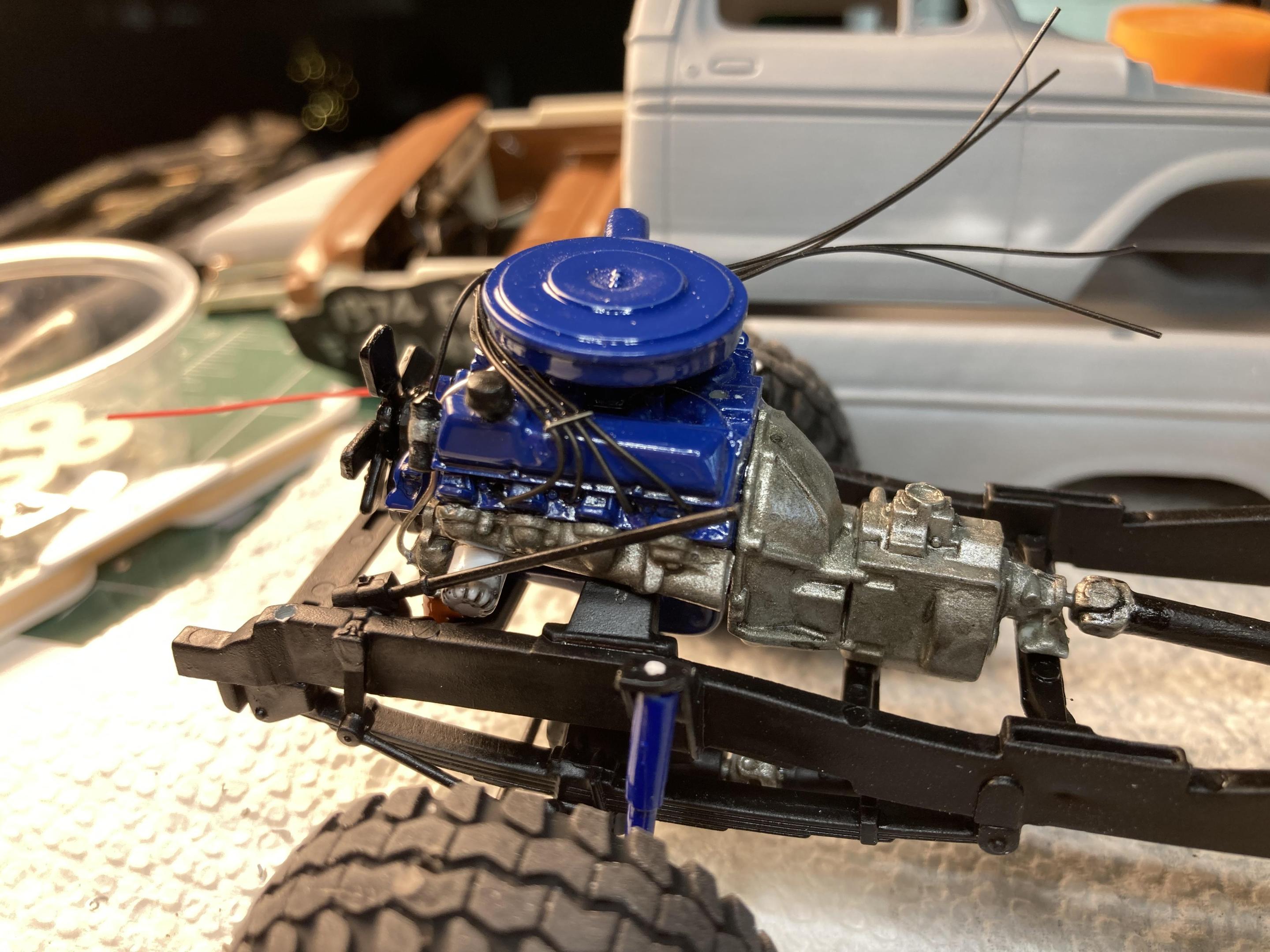

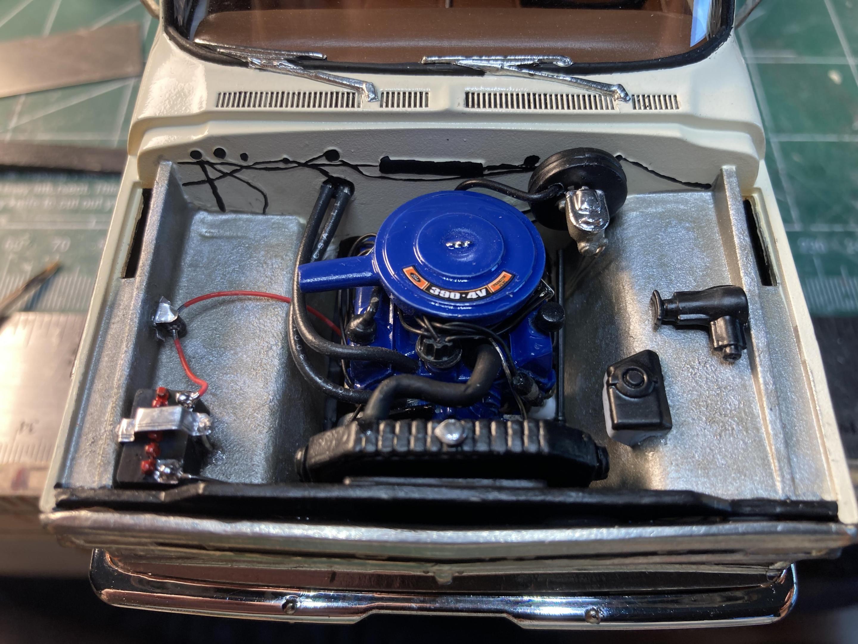

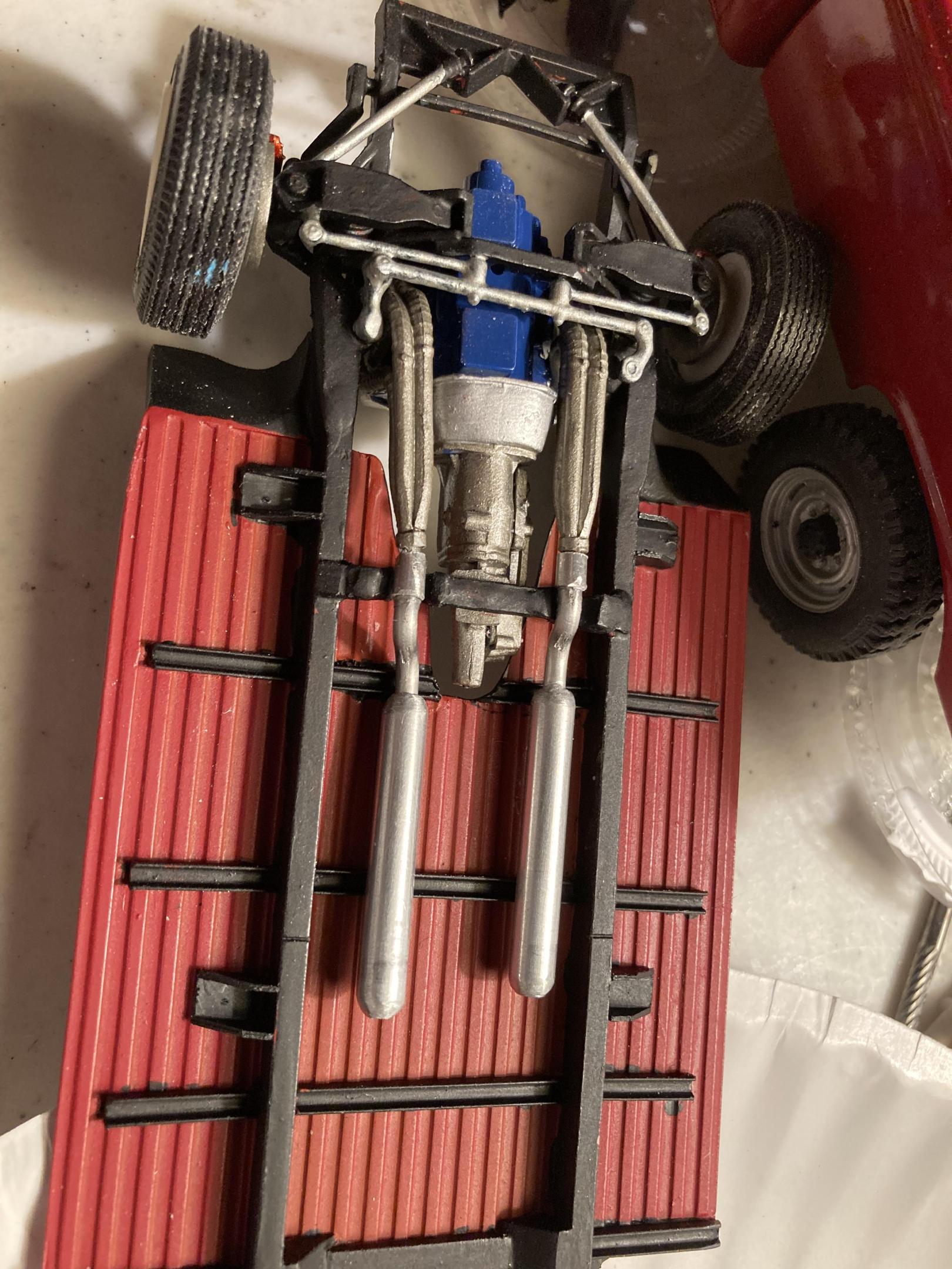

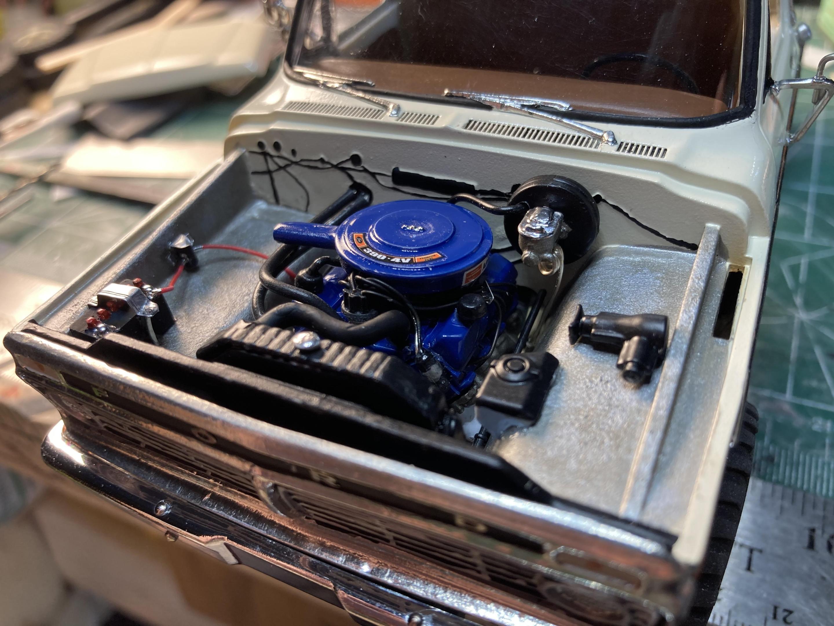

  8. Everything on the engine is from the Moebius kit except hoses and distributor. Distributor is from Morgan Automotive Detail. It is built as a 390, but basically can be almost any FE series engine. {352, 360, 428}

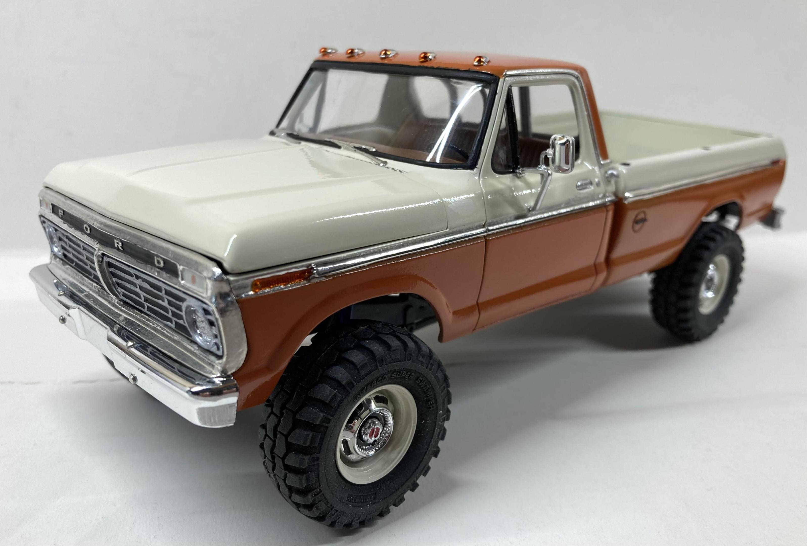

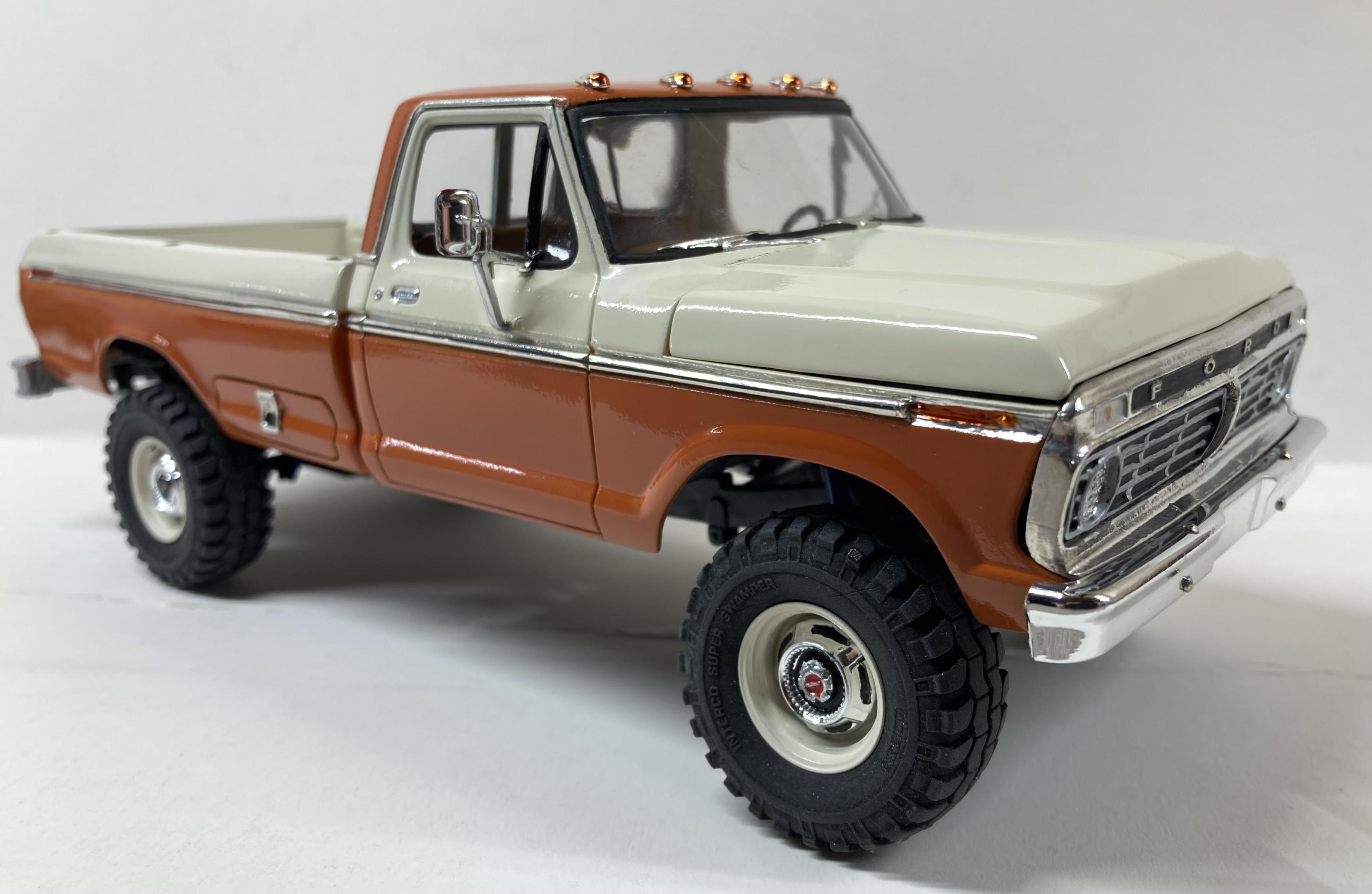

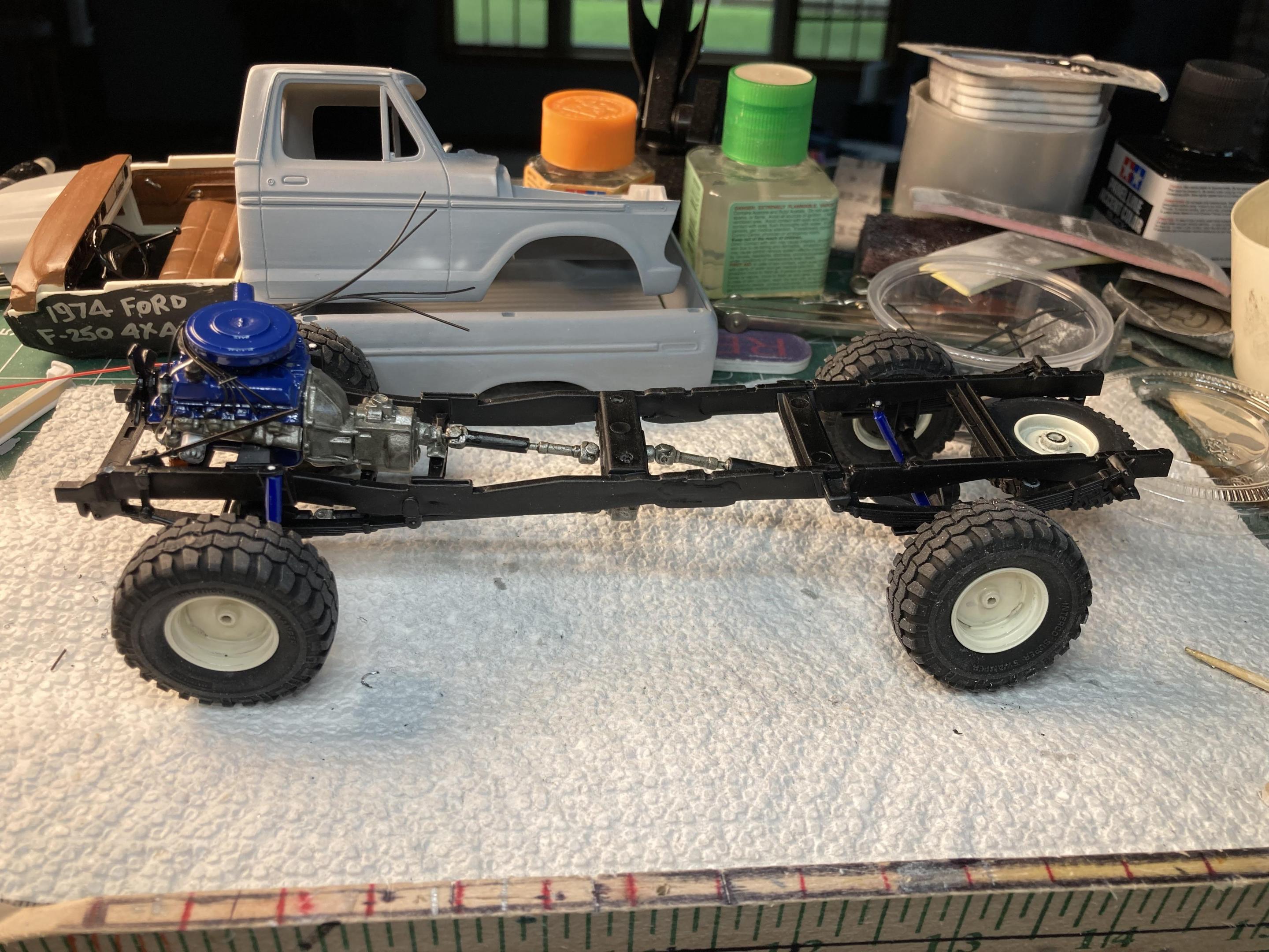

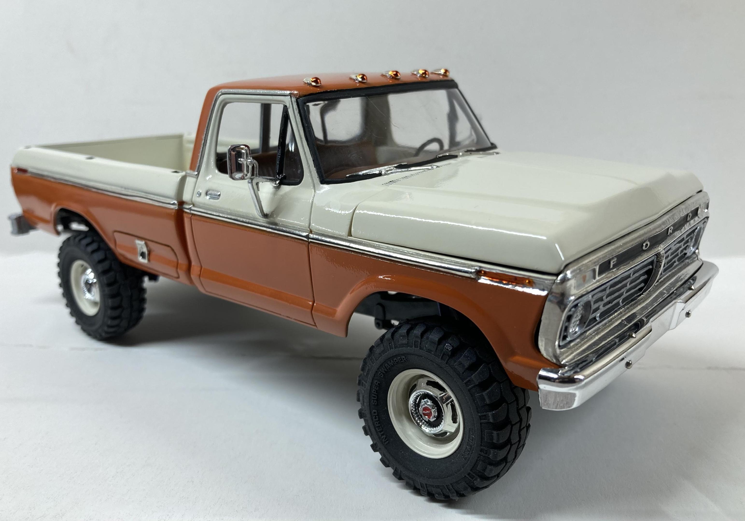

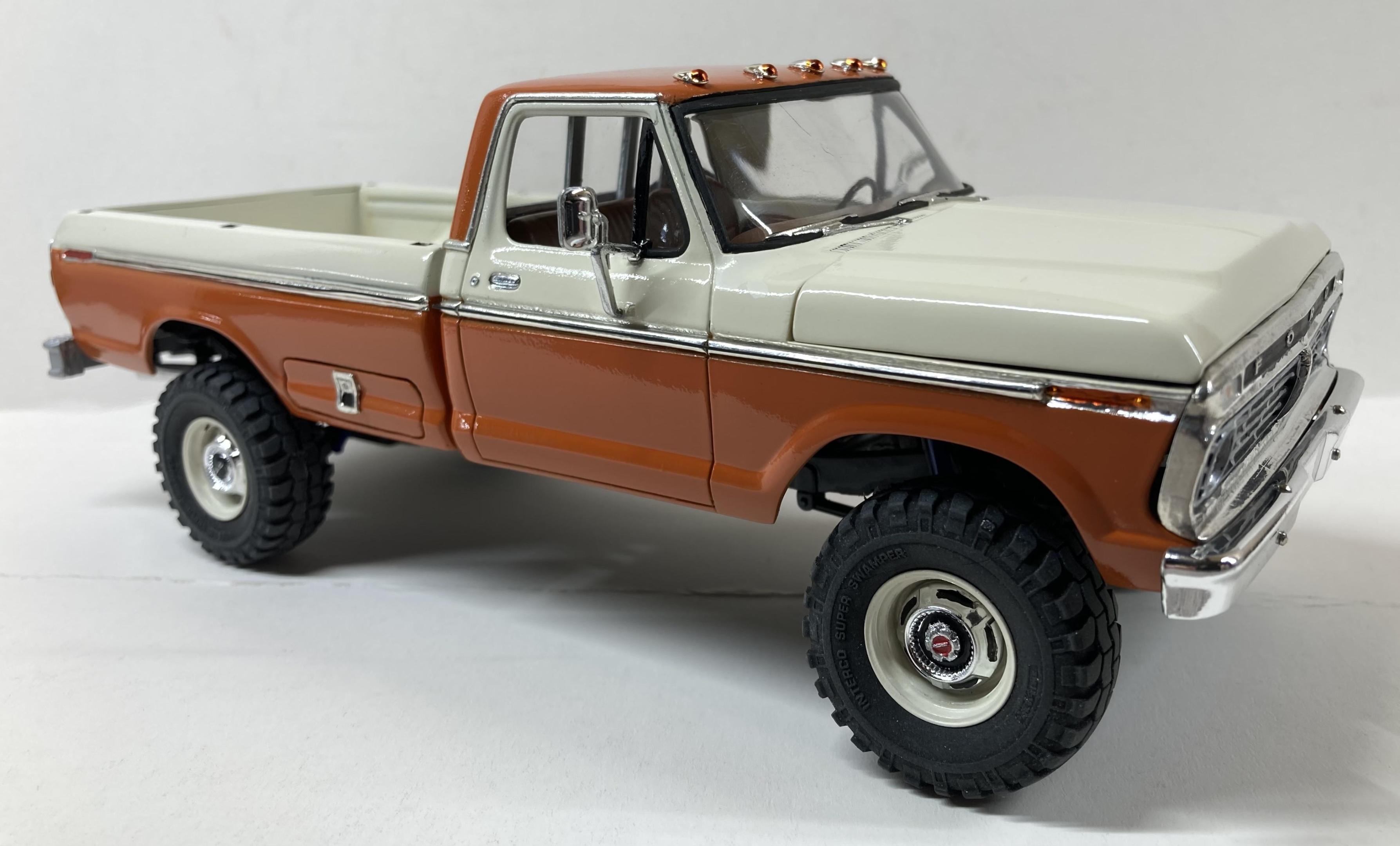

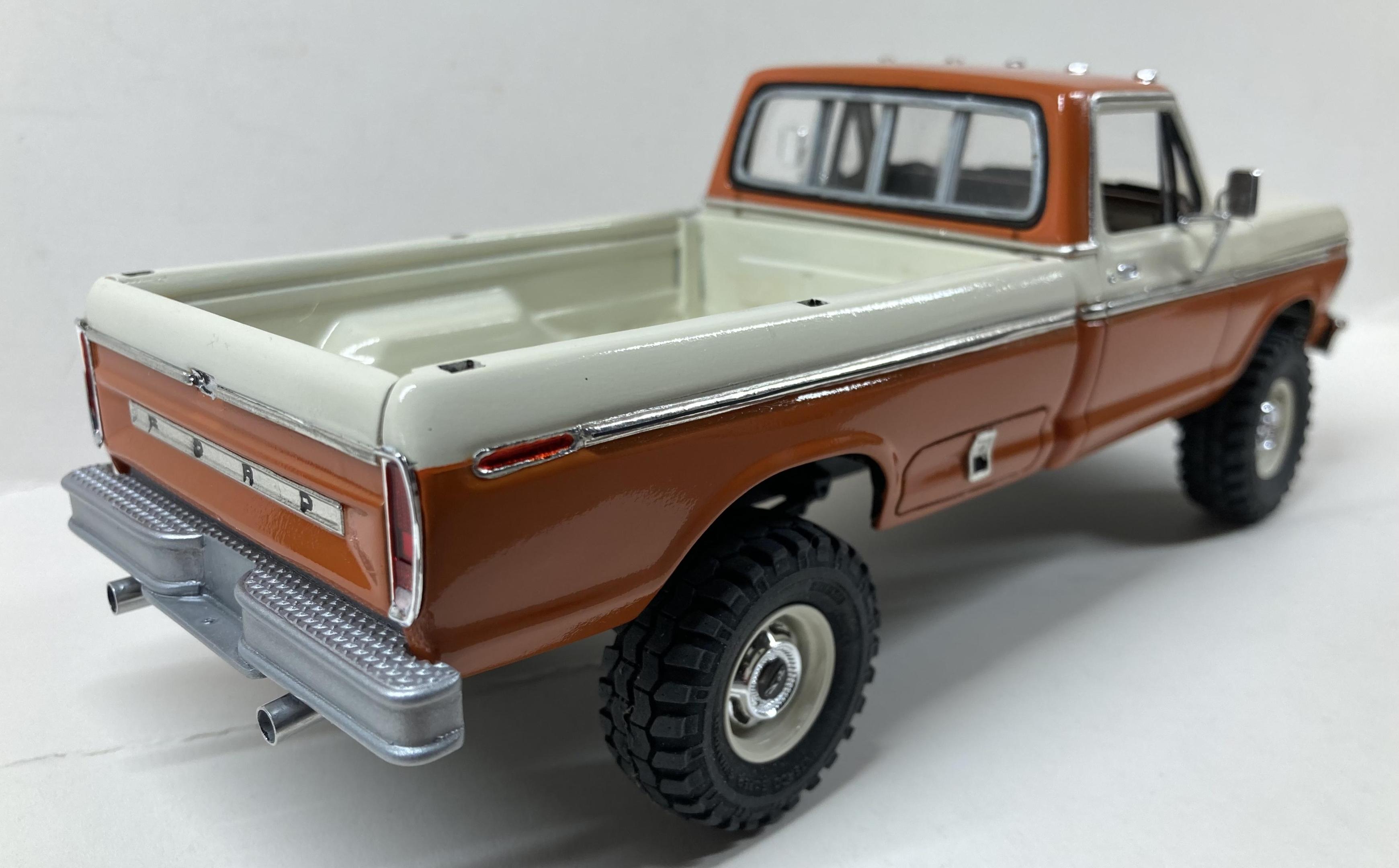

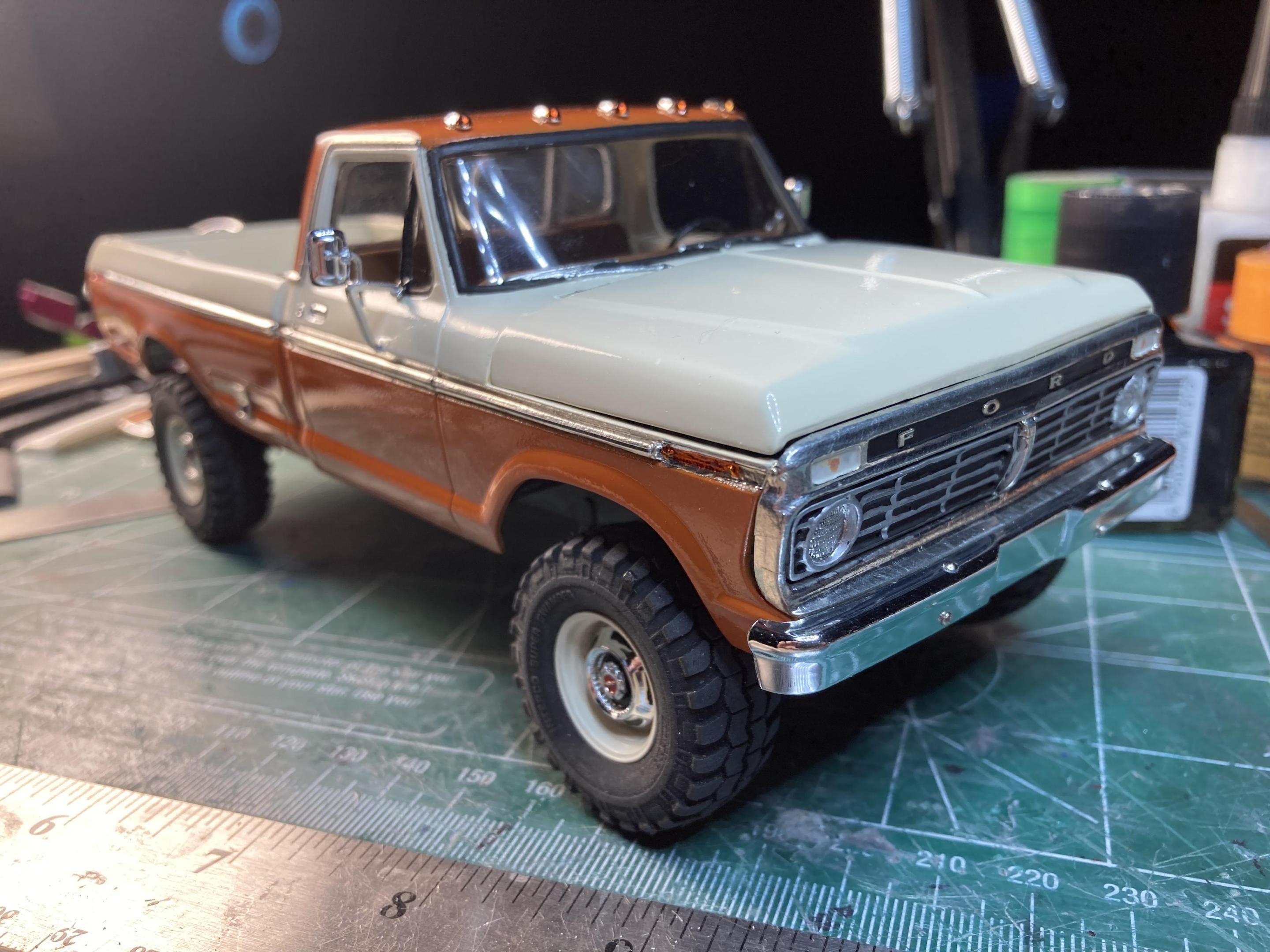

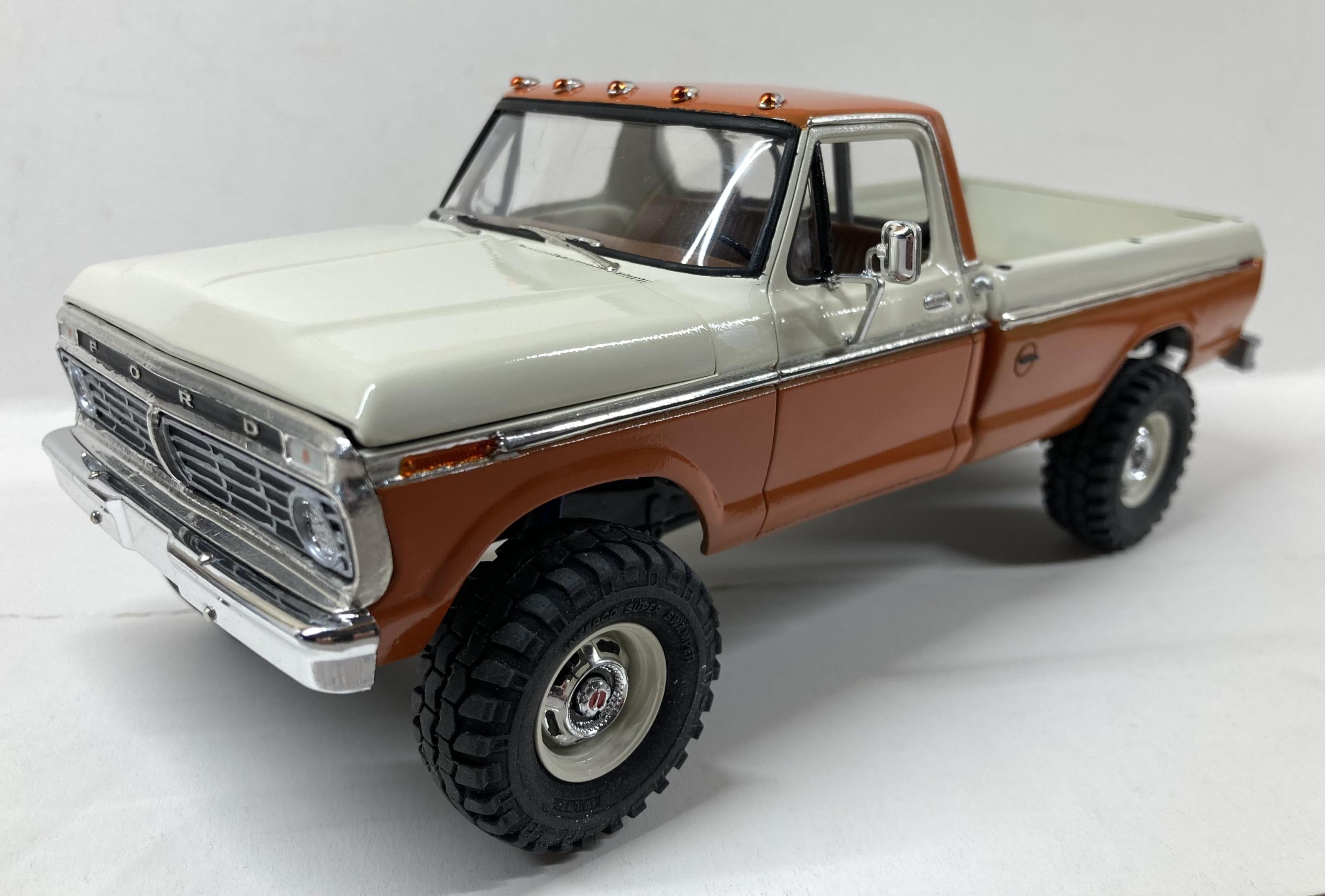

  9. 1978-79 AMT Firestone Ford pickup cab and interior, Moebius 1972 Ford F-250 4x4 frame, suspension and drivetrain. Unknown manufacturer resin standard wheelbase bed (swap meet find). My own casting of an original AMT 73-75 Ford pickup grille. I added the bedside toolbox. Fireball Modelworks wheels, tires and hubcaps.

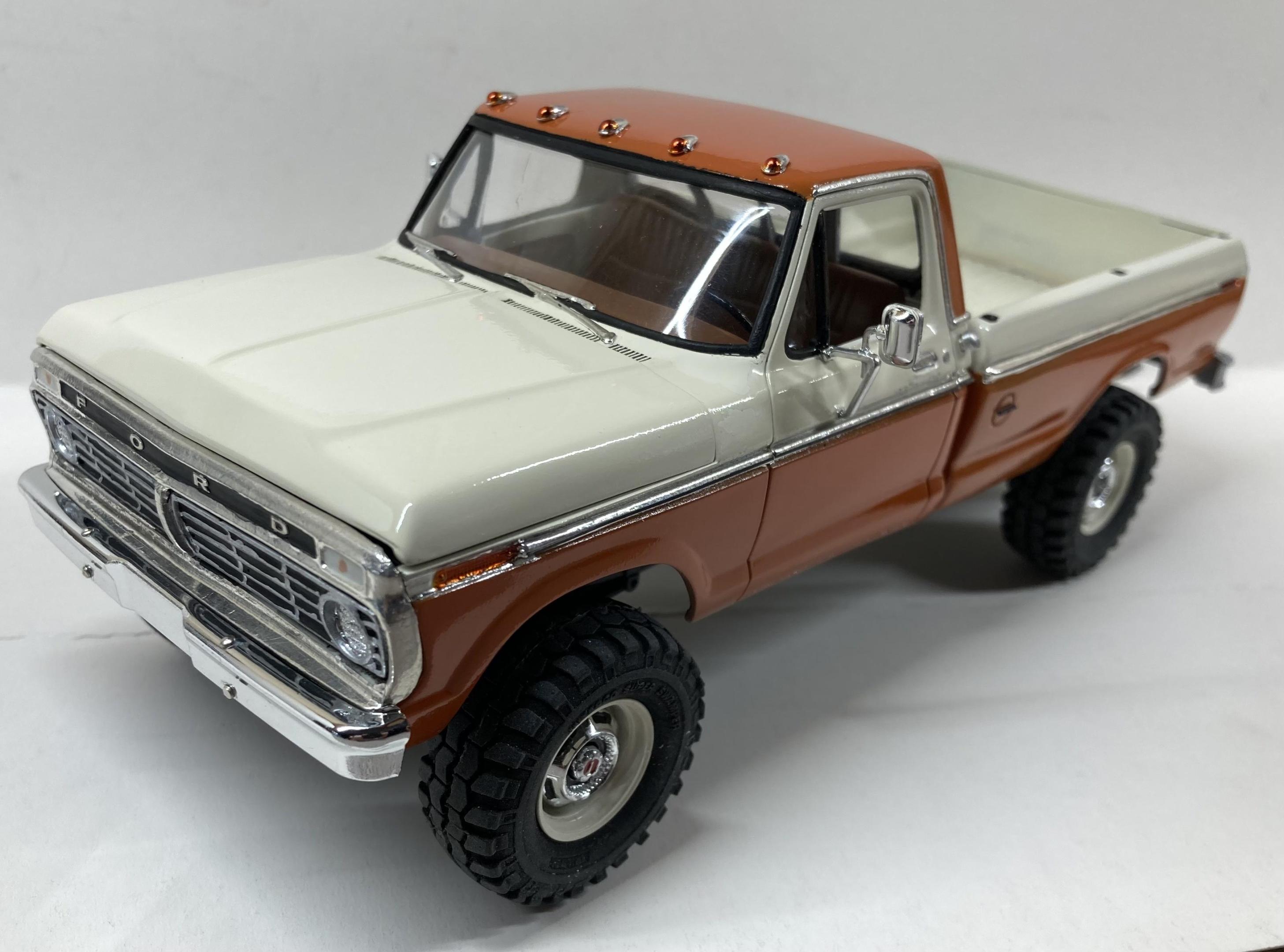

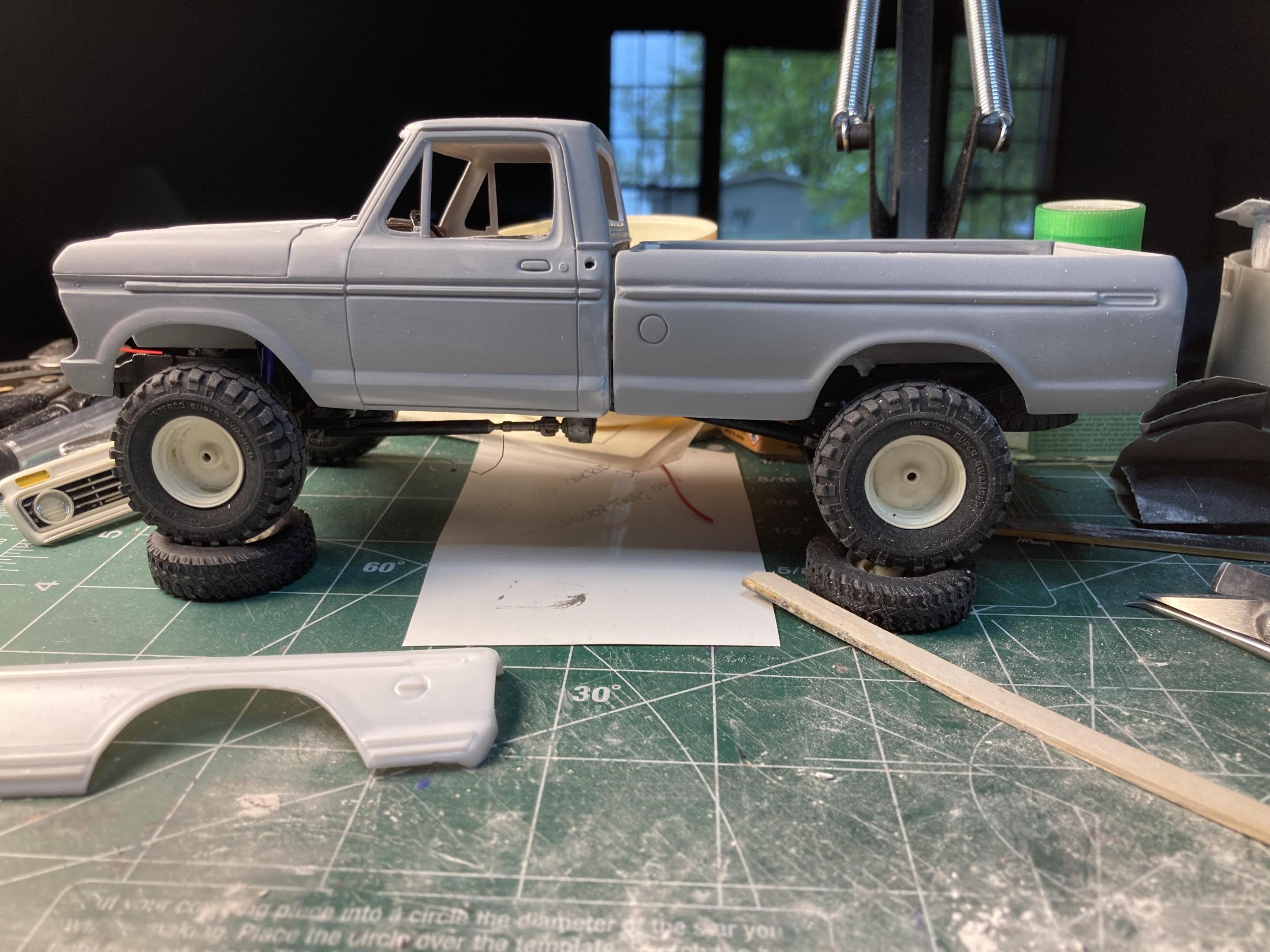

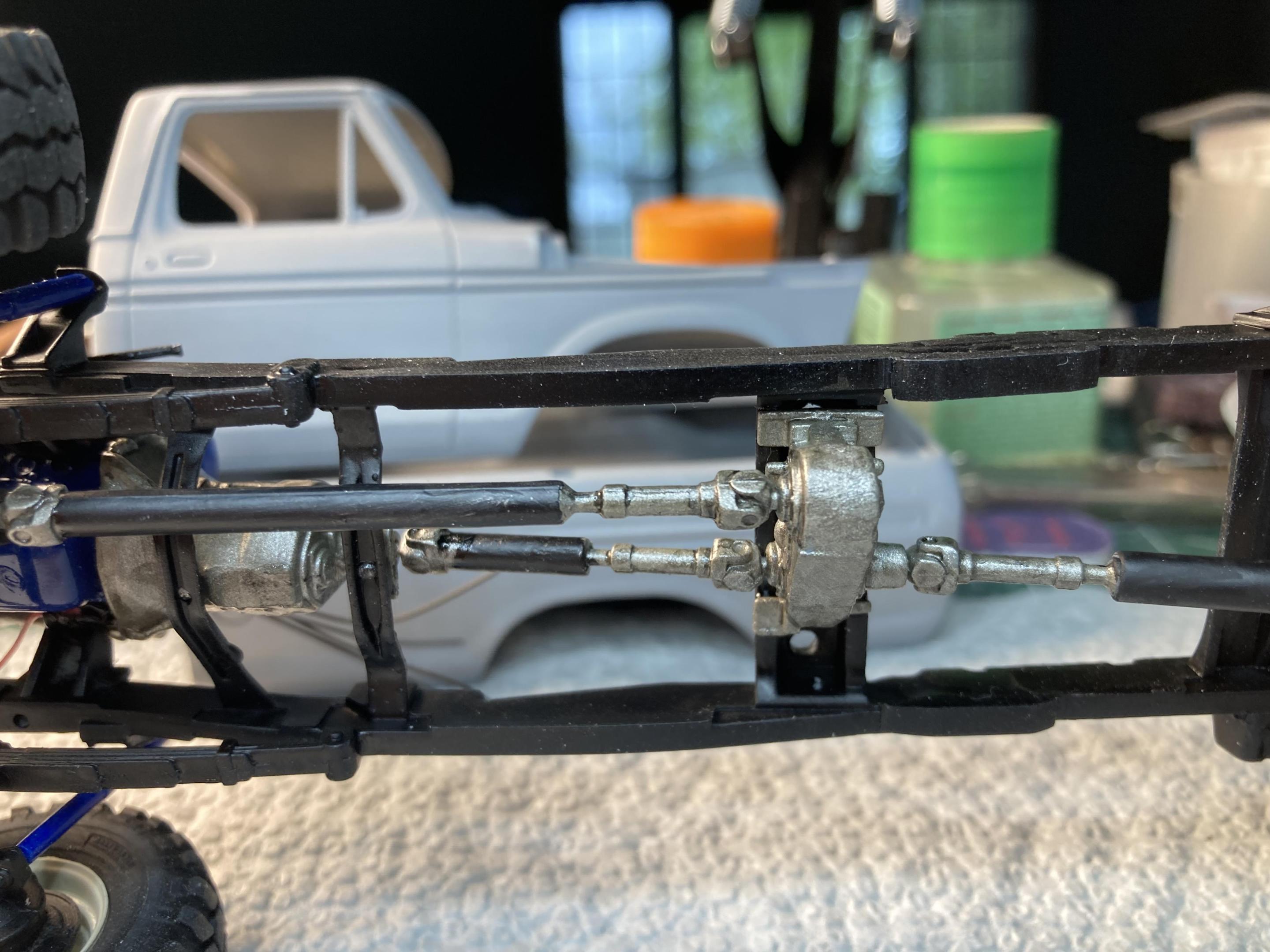

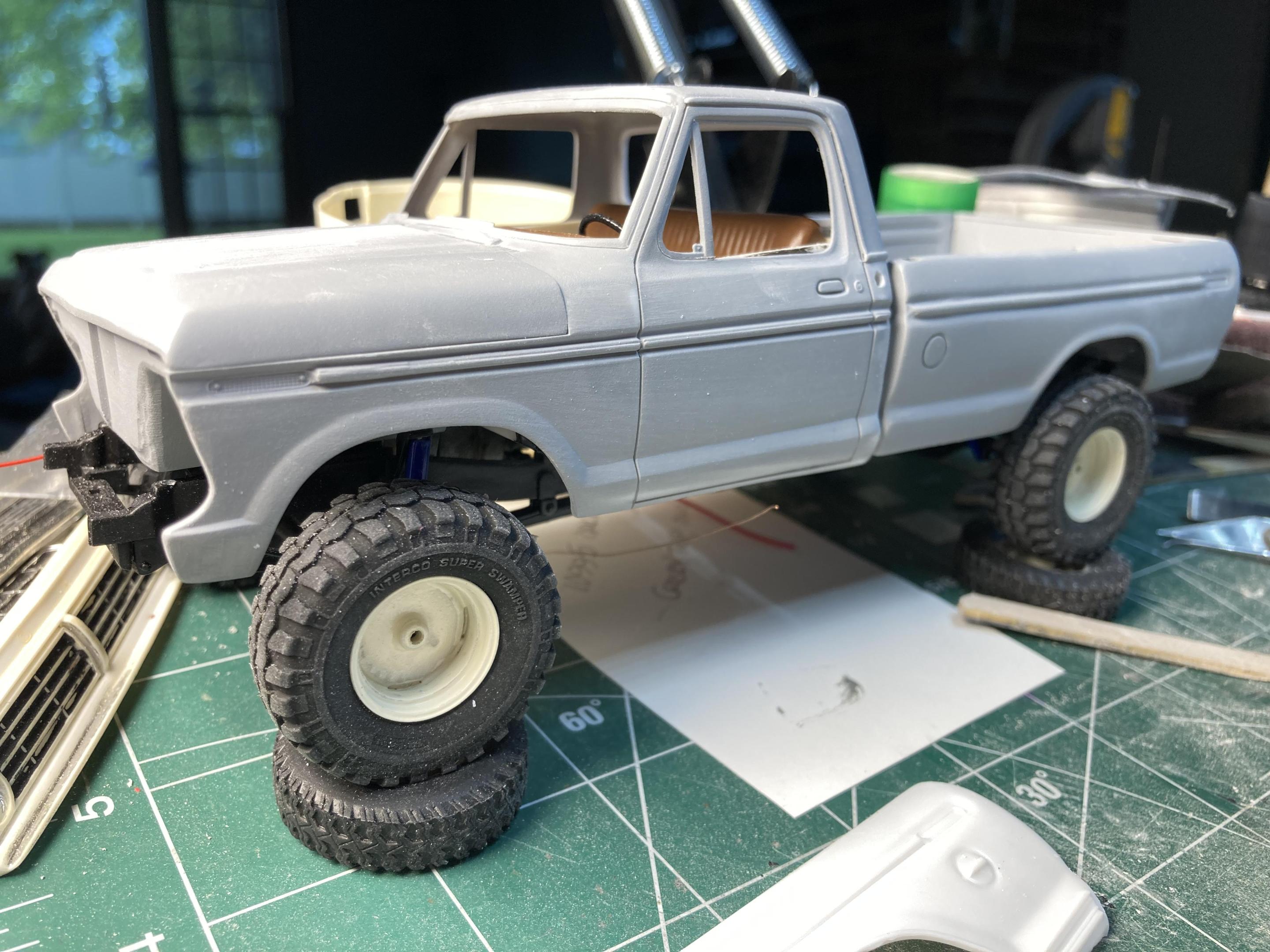

  10. AMT 1974 Ford F-250 4x4 mock-up. AMT Firestone pickup, unknown resin manufacturer correct standard wheelbase bed, stretched Moebius F250 4x4 frame and suspension and Fireball Modelworks wheels and tires.

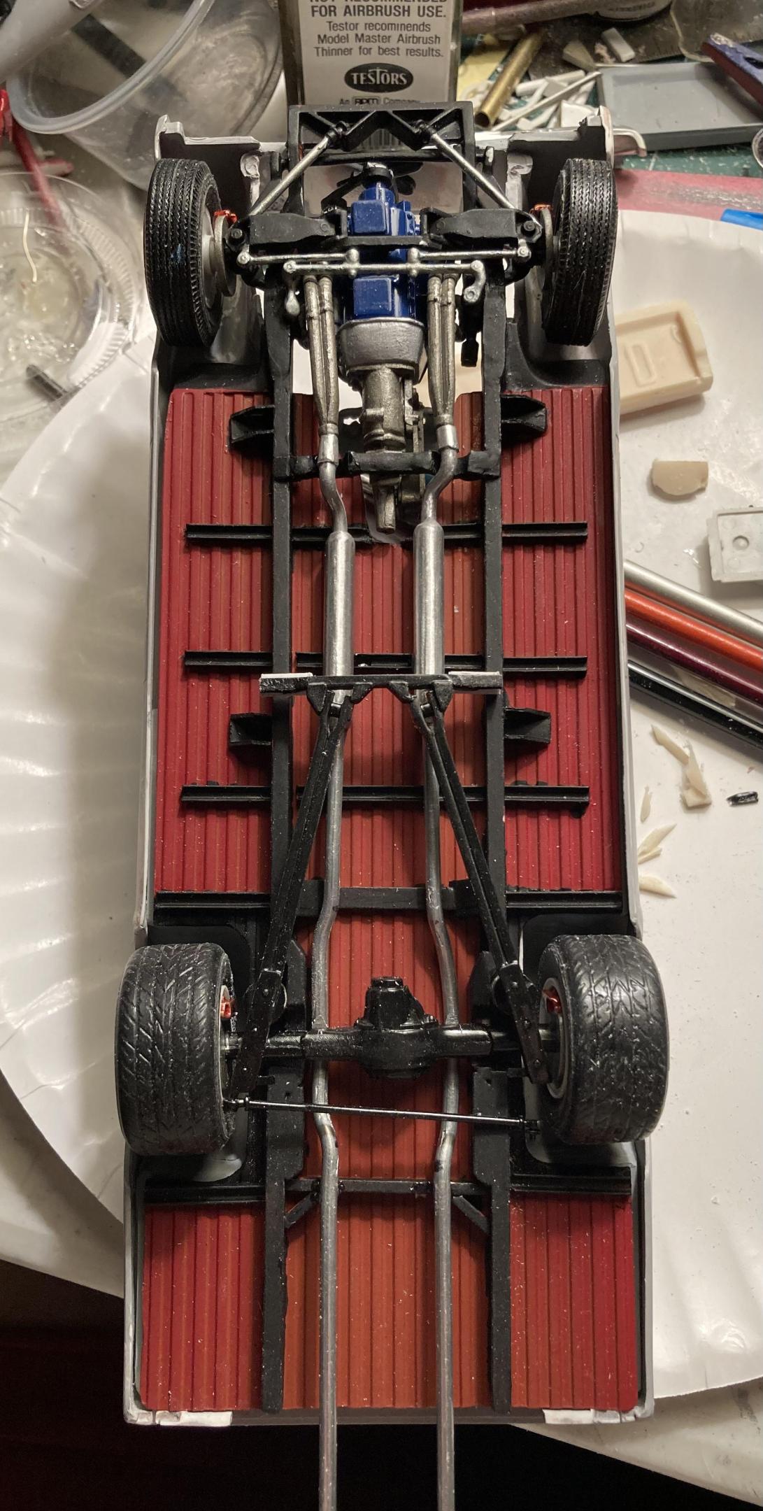

  13. I have tried brake fluid with a little success. It my go to is yellow can Easy-Off oven cleaner. It doesn’t seem to work as it used to! I’m sure formula changes due to environment. I have never tried any of the purple stuff. I’ve heard it works well. My 61 that I recently built basically uses the same floor pan/chassis as the 60. I scratch built a floor pan/ chassis for my 61 using styrene, strips, channel and shaped sheet. AMT Ford Thunderbird NASCAR front and rear suspension.
  14. It doesn’t have any detail! It has some locating tabs. All the details are on the frame/floor pan.

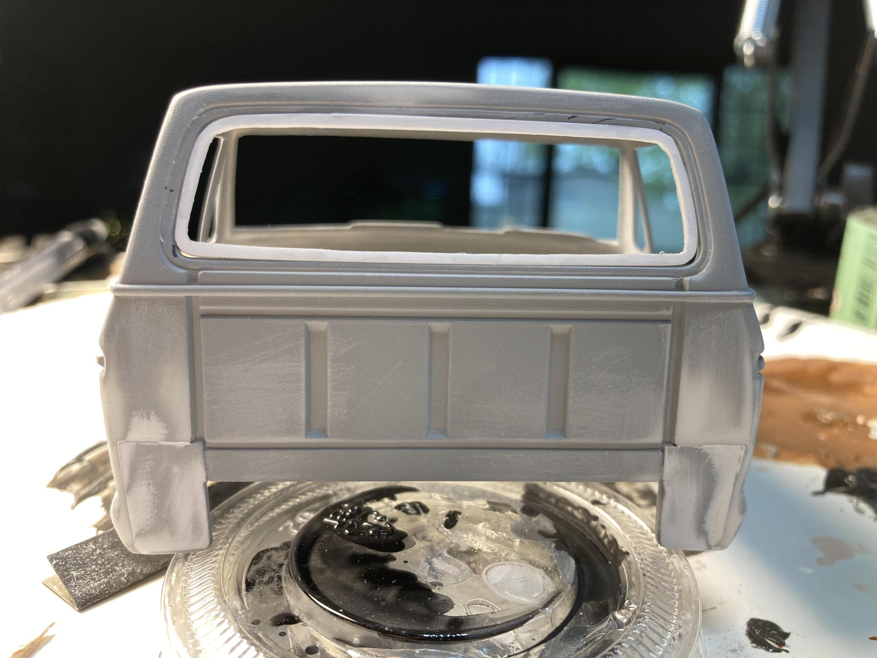

  16. Yes!! It will take several coats of primer and sanding to get the body smooth and straight. When the new 60 makes its debut, I may cast the tailgate for a smoother start. I think I will lose all the detail on the original trying to get it smooth.

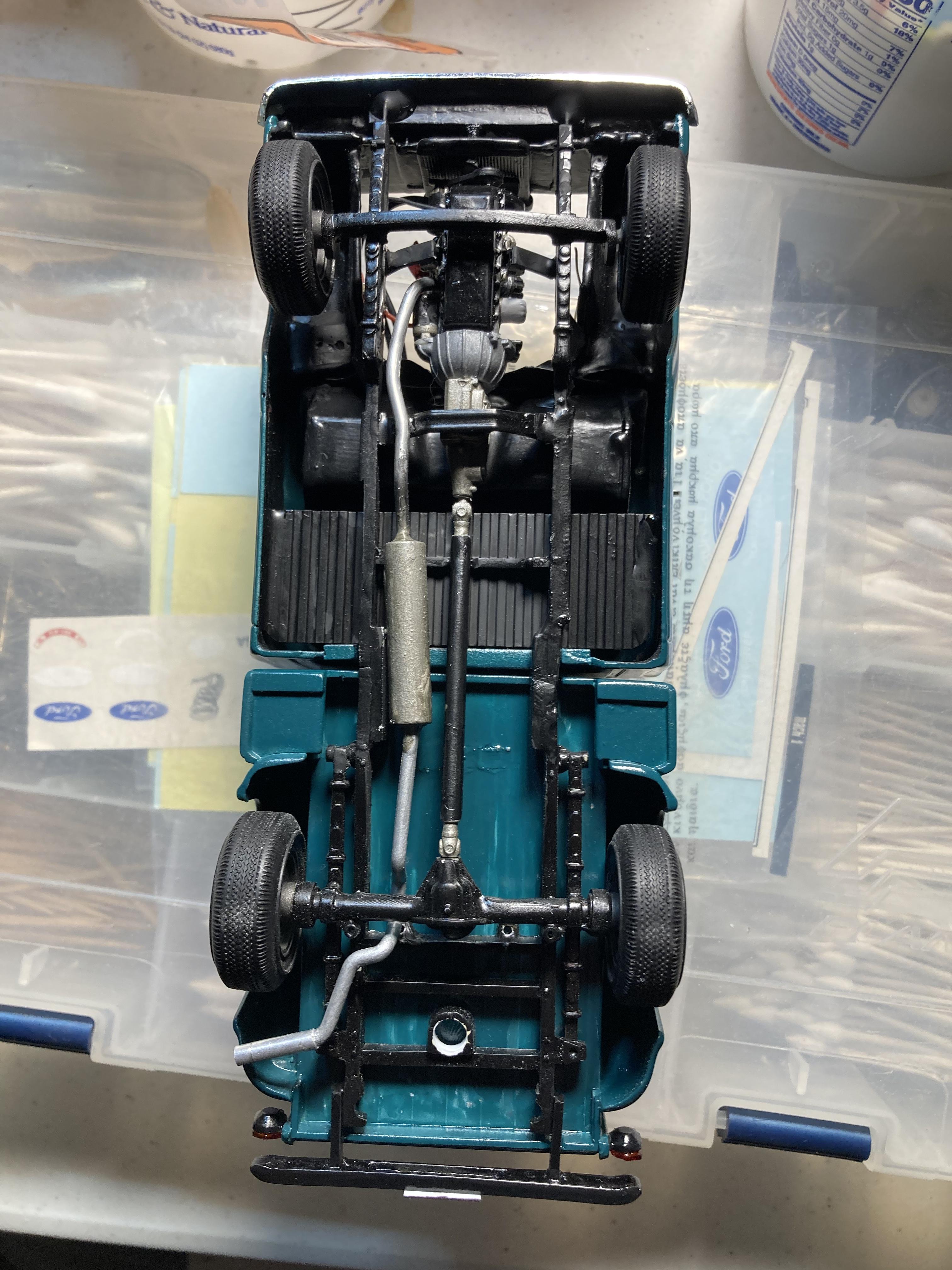

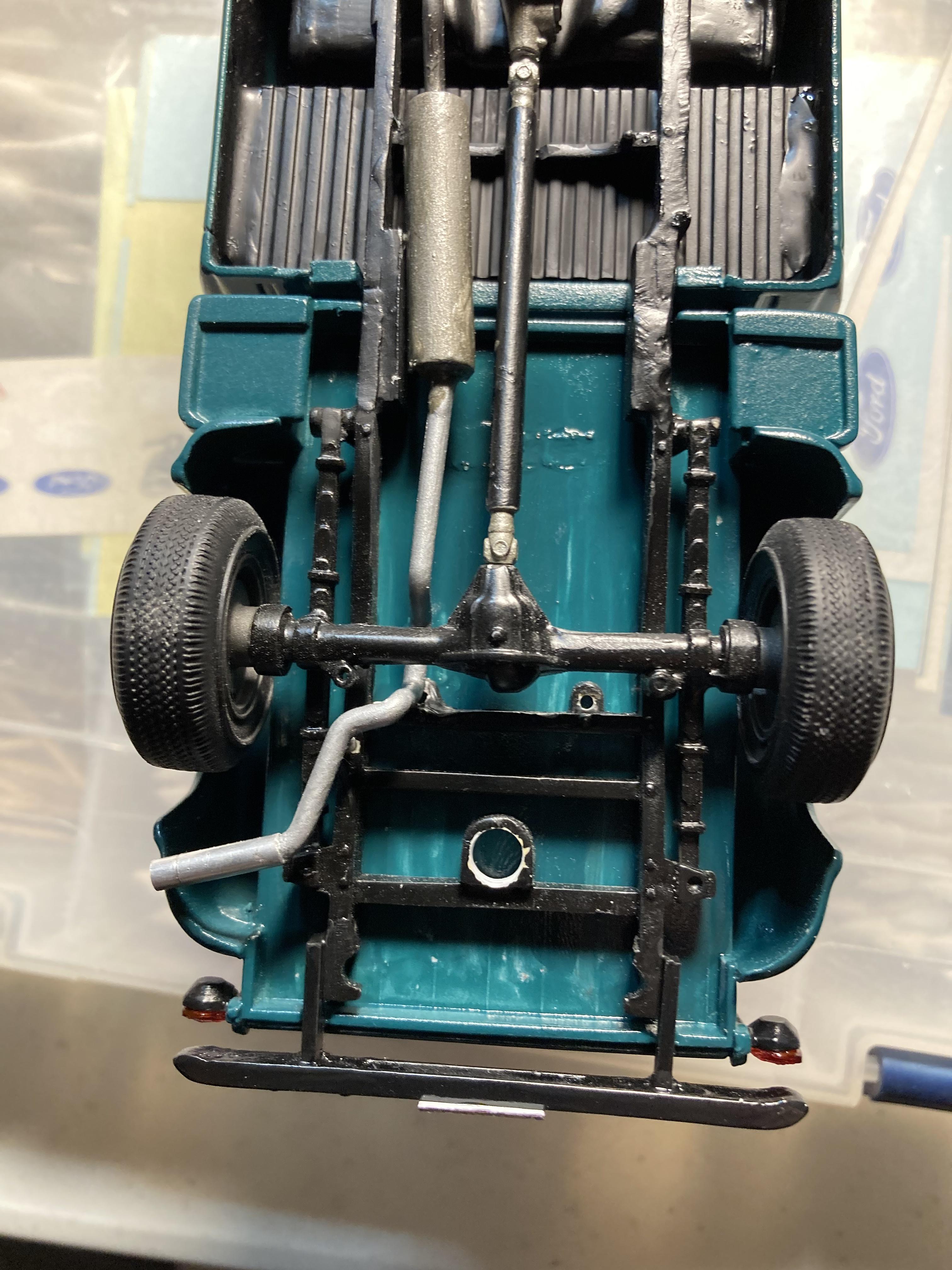

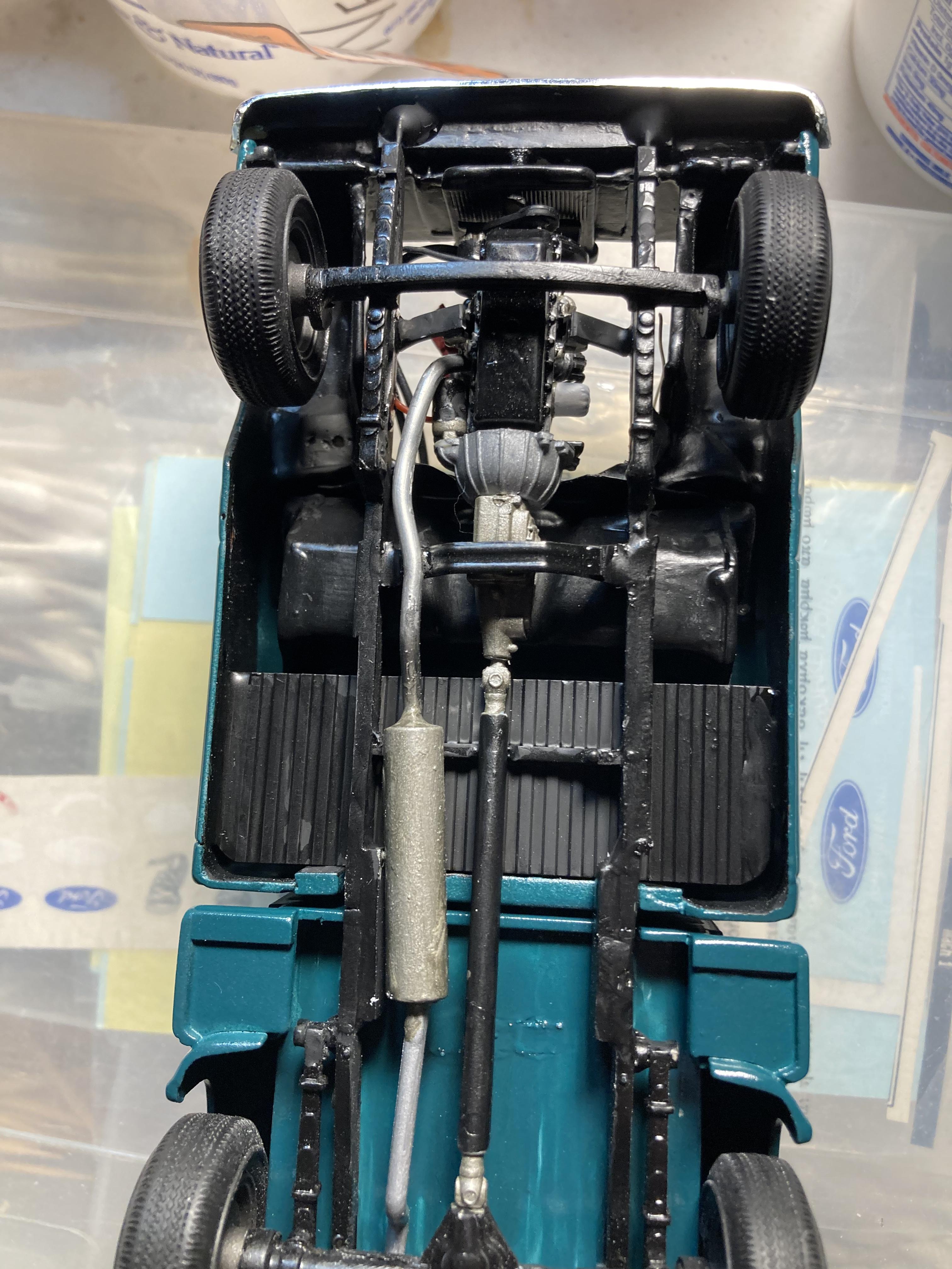

  17. Not sure what year the Mercury trucks were initially introduced, possibly around 1946. They were made in Canada alongside of their Ford counterparts until 1968. Kris Morgan of Morgan Automotive Details {MAD} Has the conversion kits for the 65-66 and 67-68 Mercury pickups in both Styleside and Stepside. If interested, you will have to PM him as they are not on his site.

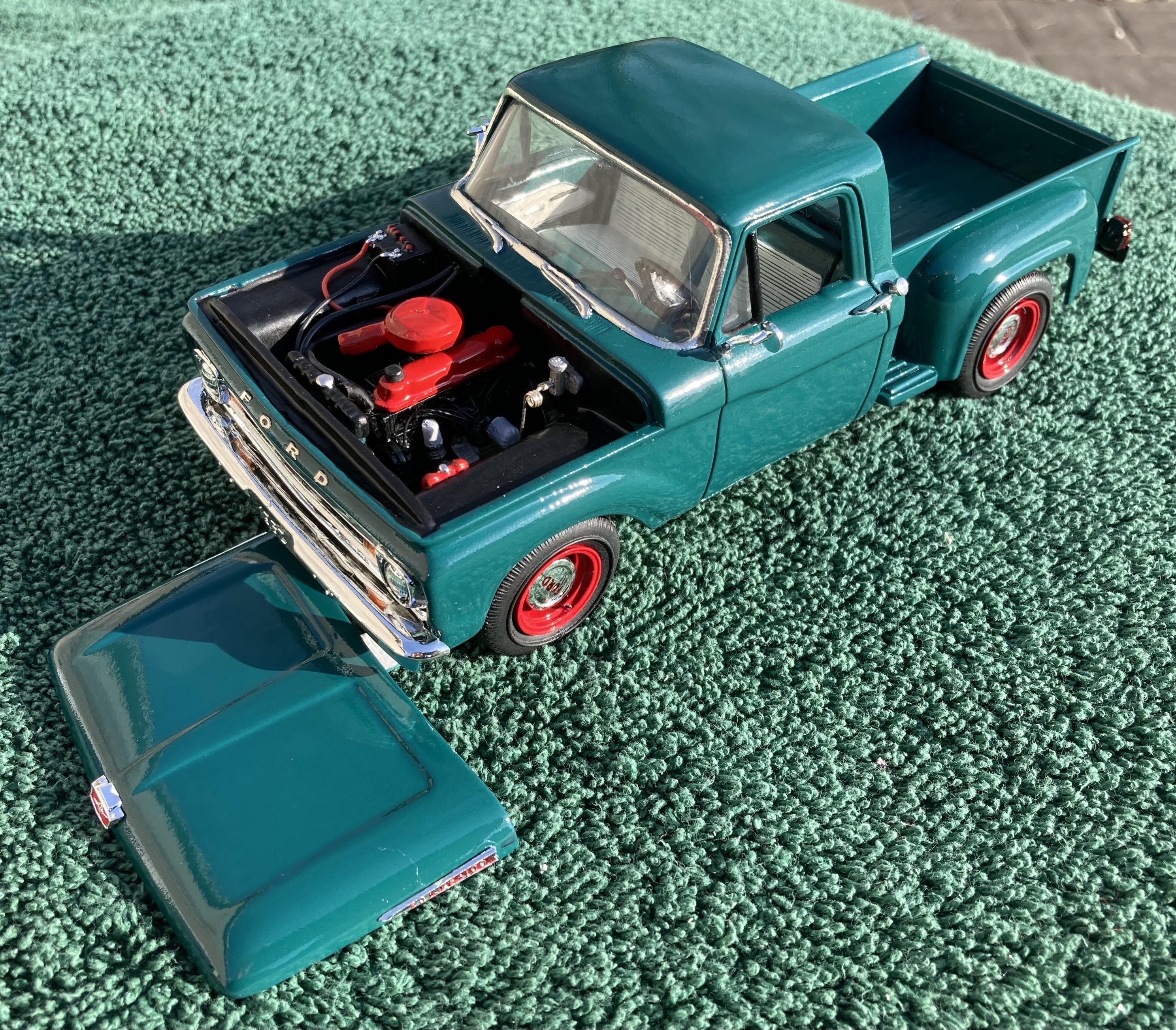

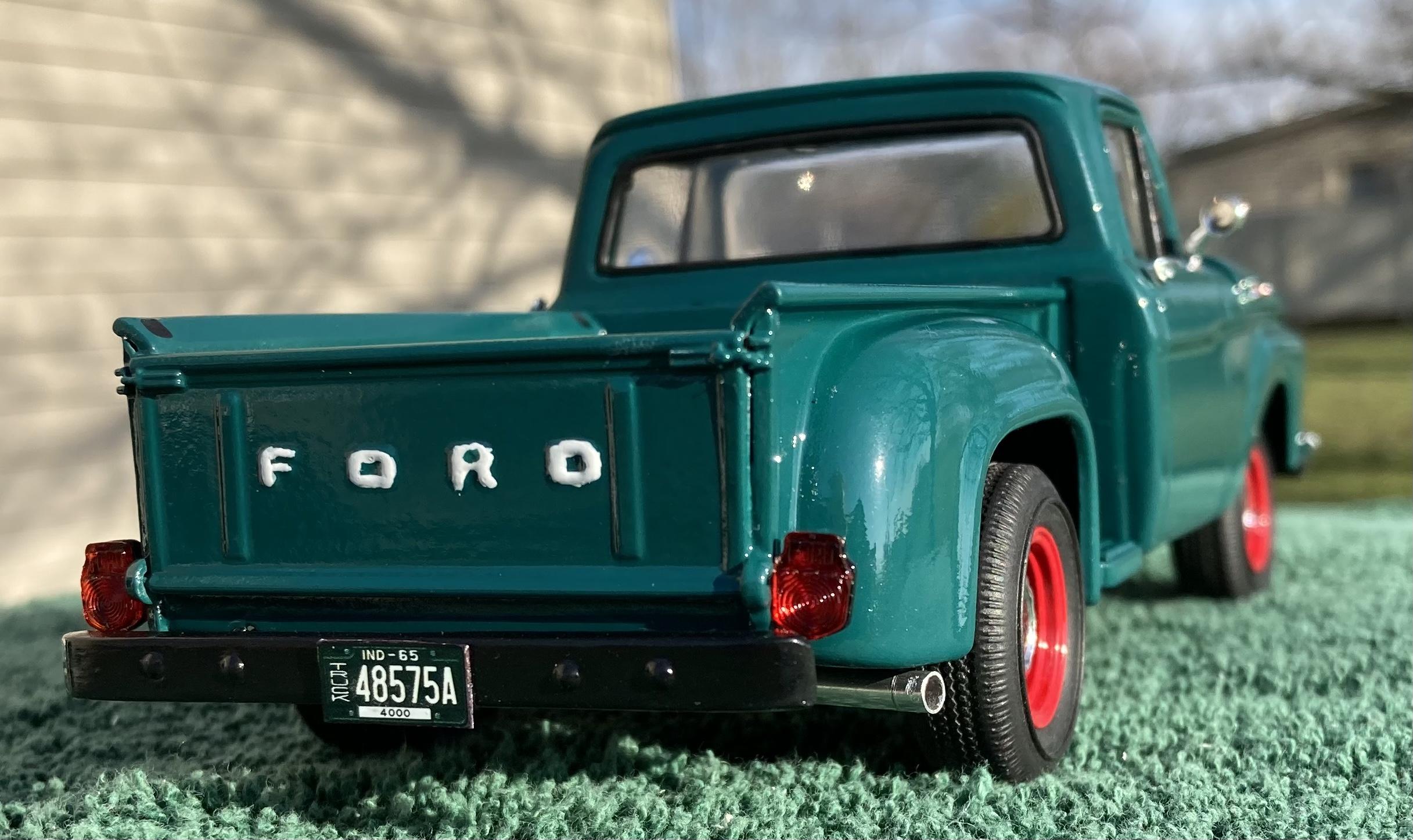

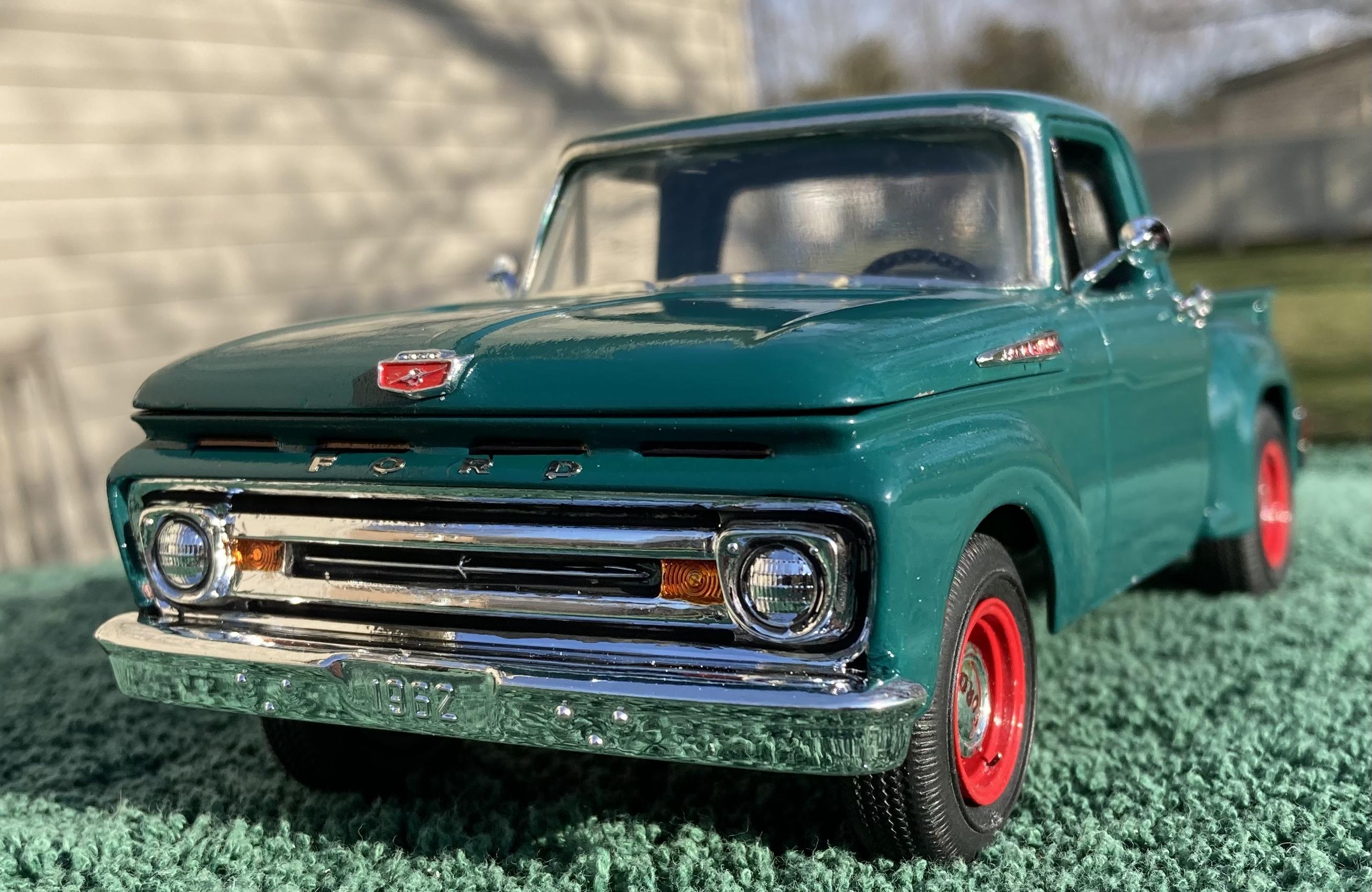

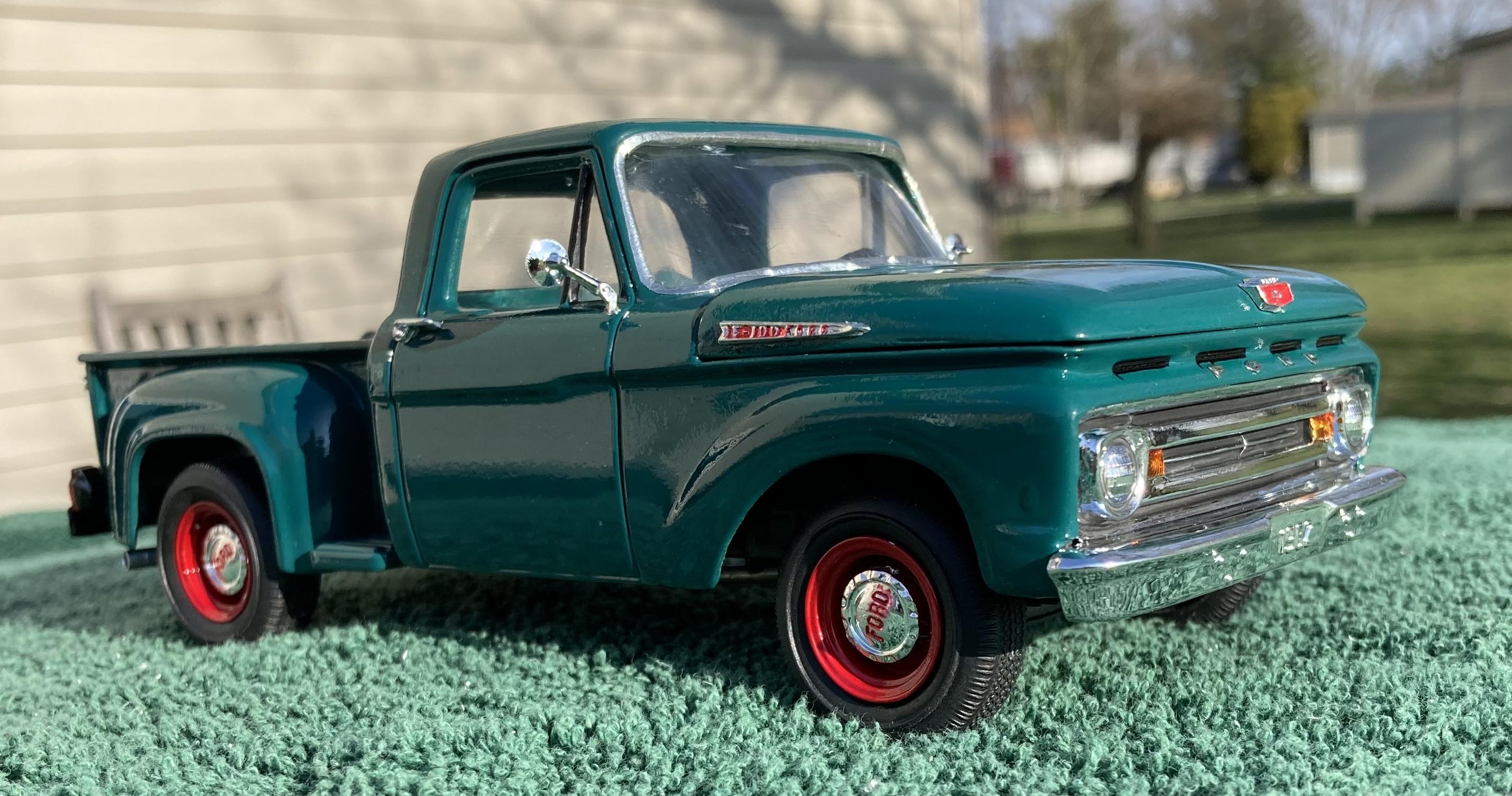

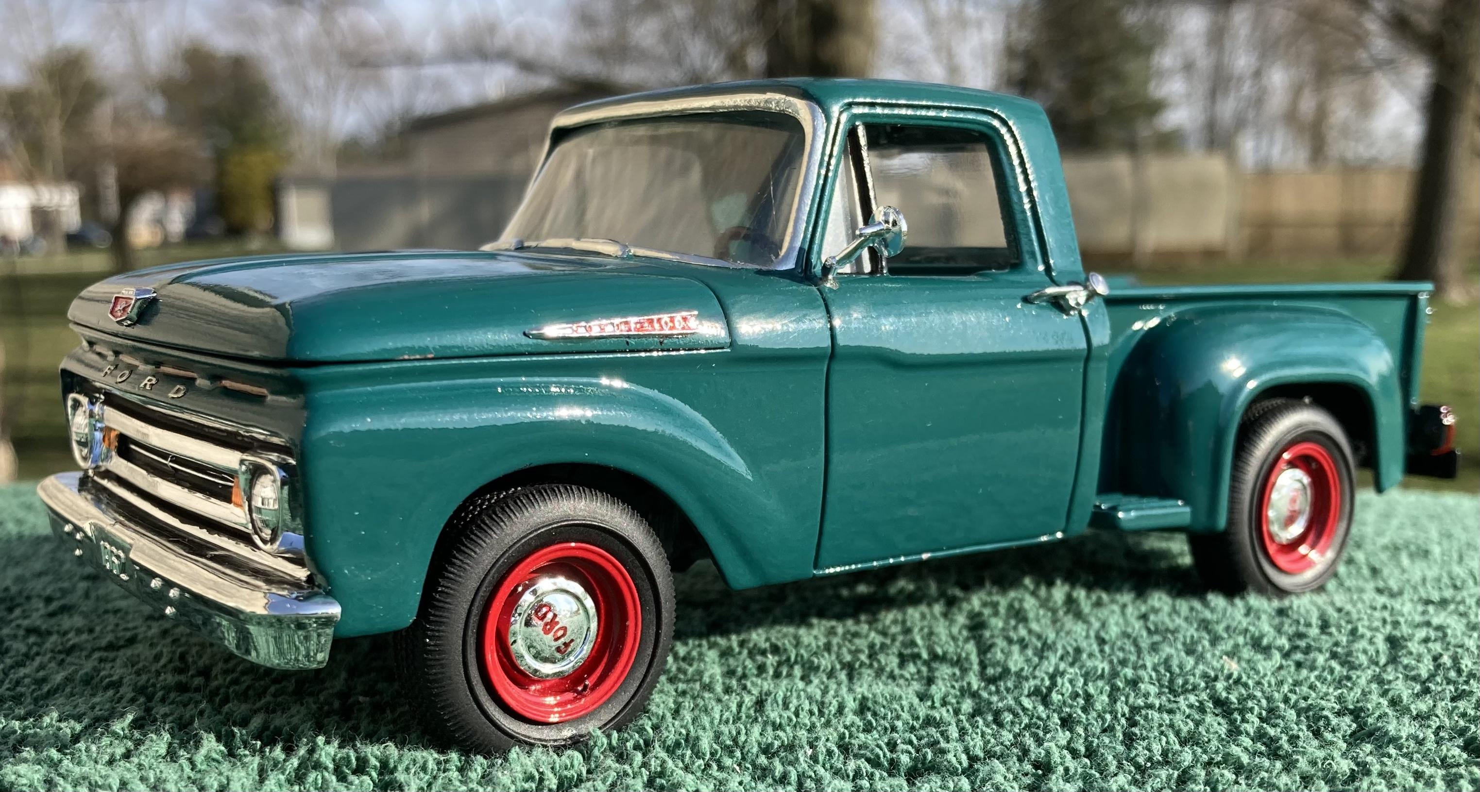

  20. This build is kind of a Frankenstein of parts. The cab is from Motor City Resin Casters, the bed and frame is from the AMT 1953 Ford Stepside, Moebius engine, front hood emblem and mirrors. Modelhaus grille, hood side emblems, wheels and hubcaps. Factory color of Holly green
