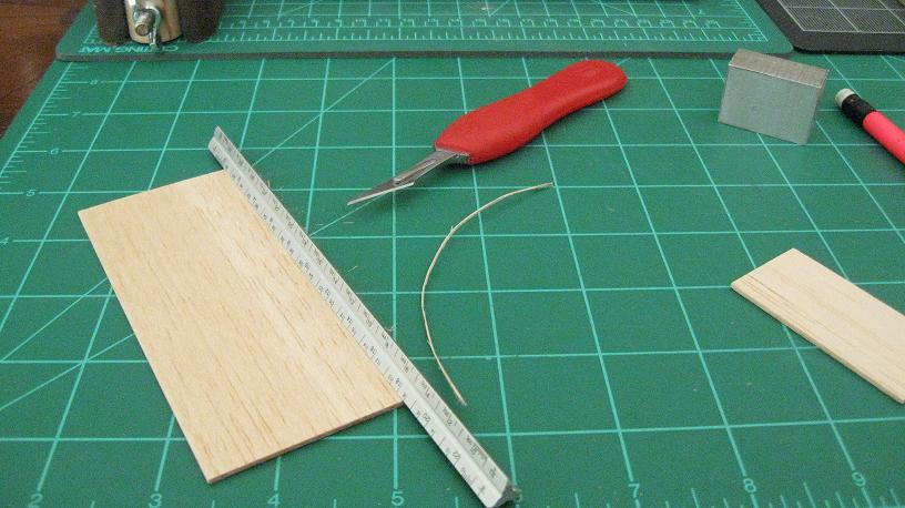

But I am itching to build a Locomobile, so w/2 kits of Ole 16, I believe I will give one ago w/what comes in the box.
I have been studying the plans/drawings, and I believe w/careful work.......a pretty cool rep of this type vehicle can be had out of the box, albeit not as nice as yours...........

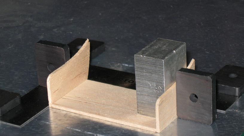

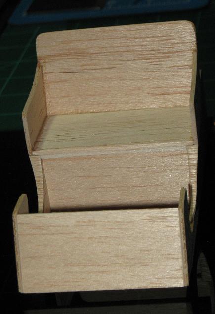

Not a criticism, but a question out of curiosity: Why did you glue the seats to the body structure before painting? Seems to me it would be easier to work with the seats separately -- paint, cushions, etc -- before gluing them.
No criticism taken friend, you are correct in your order of work, but after much thought and the having to line the seat w/the two curved body trim parts........of which was added after the seat was attached, I just thought it easier to glue seat frame to body. I have as of yet, made the seat that will insert into the frame. I also like to paint as much of the assembly as possible while building and this is a learning curve for me with these types kits. Sometimes what looks easier can lead to more head aches than it was worth for the ease of the effort. That's one of those things about modeling, after you finish a build and look it all over, about 1/2 of it would be done a different way........@ least it works that way for me. I built 2 Pocher kits @ same time years ago, both were the same type vehicle, one for me, one for a client.......even building @ same time, what I found did and did not work on one, I tried differently on the other.........amazingly, a lot of stuff was done differently and I to this day remember what made that assembly work smoother and if I built that same kit again, I would try new and other ways I guess. Thanks for the question and I hope I answered what you were asking. To anyone following this thread, ask away, and if you need to be critical, do so.......after all, we want the same results, knowledge of what and why to a completed project.

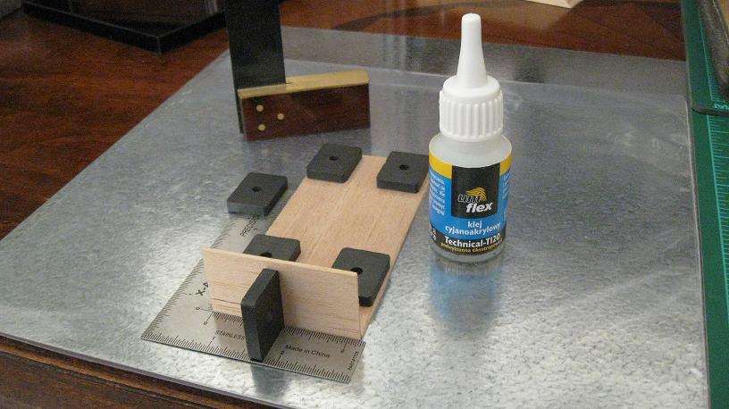

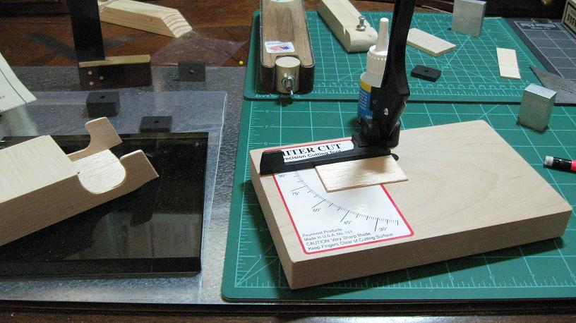

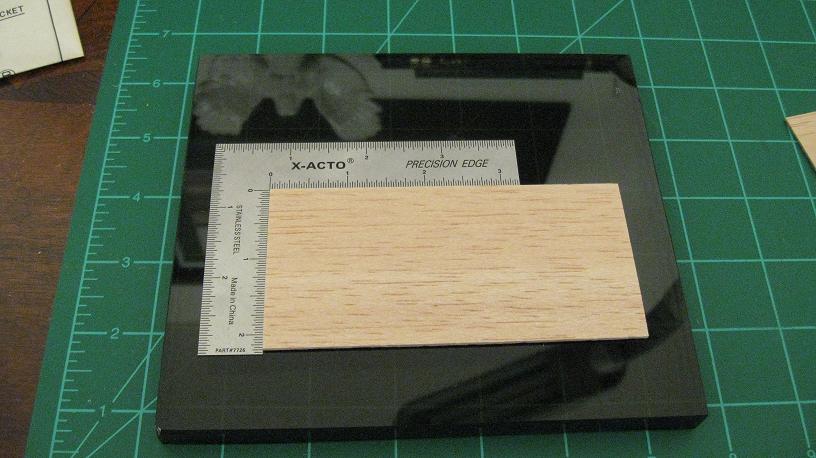

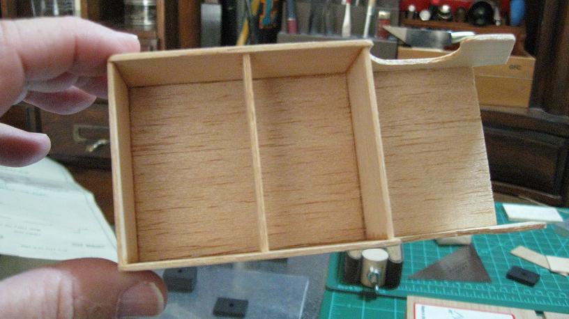

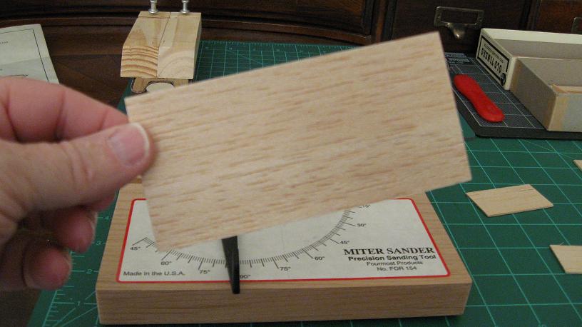

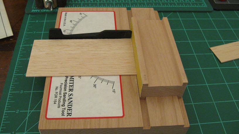

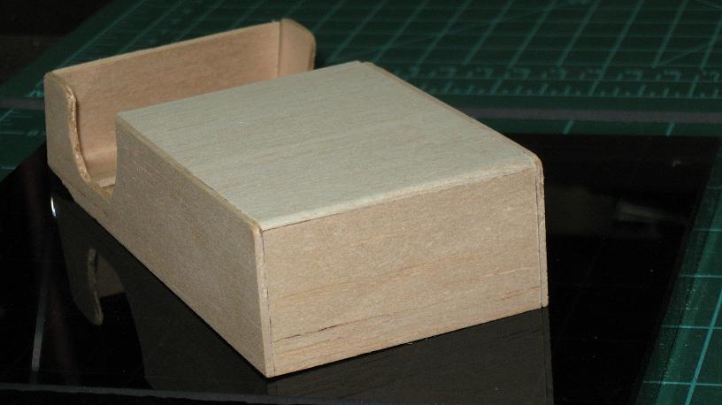

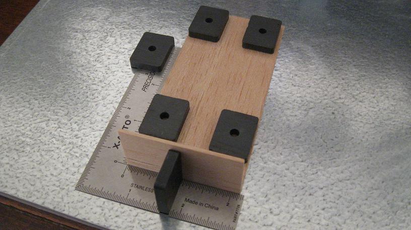

Progress on the little Packard.........do not for a min. think those little box's of a few sheets of wood, card, wire and plastic parts is a weekend project.......well I guess they could be if one was to just throw one together! Fit and re-fit of parts insure they were square and flat against ea. other. Dug out a couple of my ole ship building tools to make this task easier. I bought these years ago, and I have never regretted I did.......Fourmost Miter Sander, Miter Cut and Miter Saw......if you work w/wood, these are a must and I have used them w/sheet plastic as well. I also used another wood building tool, Easy Built Models Magnetic Build Board w/mags.........
if you ever do use, you will find all sorts of uses for it. What you see was about 4 hours work of squaring and truing up all the parts that make the carrage/body. I also posted I was tring to figure what glue to use.......I used uni-flex Technical-T120, this is a CA from Poland f/working with wood, metal, plastic and card........good stuff. Does not bleed thru wood. So I will let the photos speak from here. Still some work w/sanding block and a few parts to complete the body.......over all, well pleased with how this turned out. Oh yea, the 1st Grade Balsa was a pleasure to work with.
