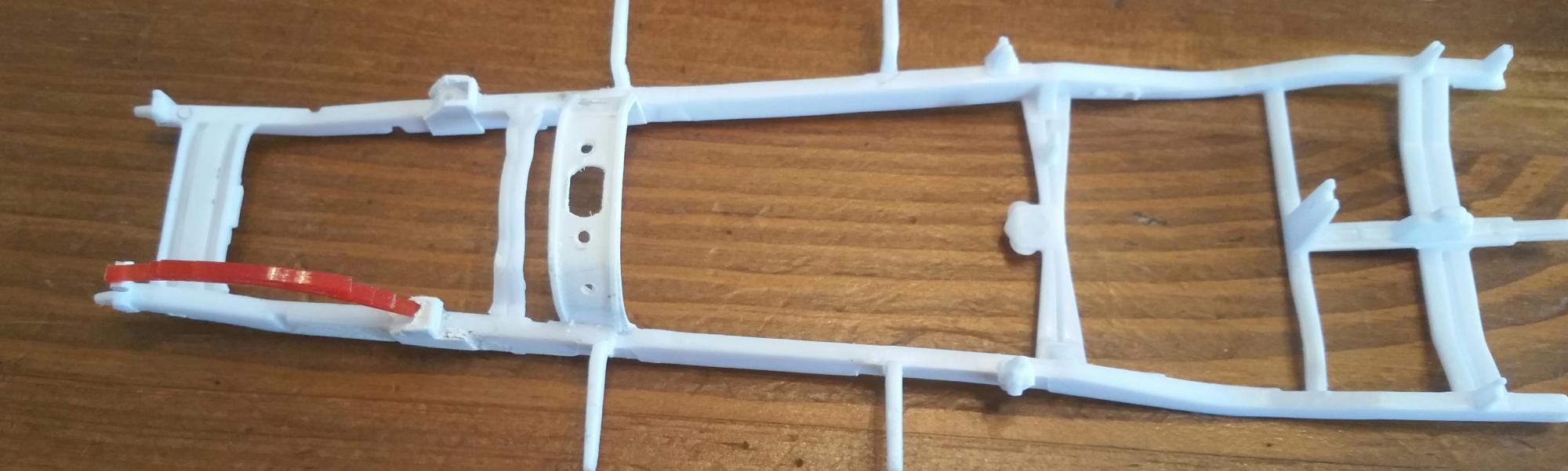

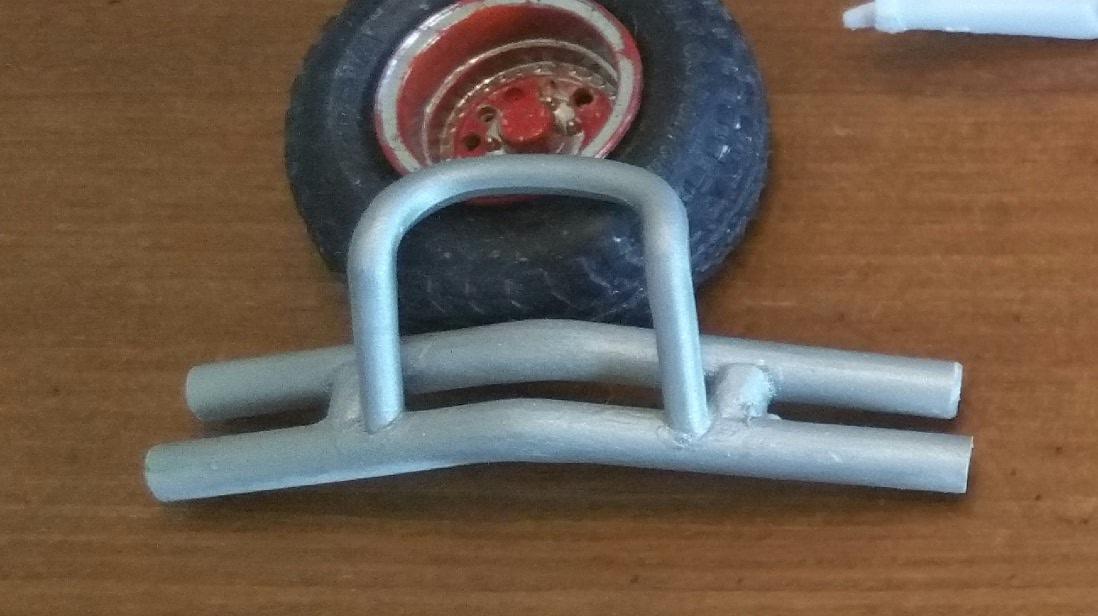

  2. The original center cross member had to be removed and a new one fabricated using styrene sheet and thin strips. I boxed in the rear spring hangers to beef them up and allow the springs to hang lower then stock and in line with the front shackles, I still need to clean them up a bit. To acomadate the front drive shaft and for wheel drive I created the transfer case by stacking and shaping sheet styrene, I also modified a donner part for the rear. Evergreen rod were used to create the front bumper.

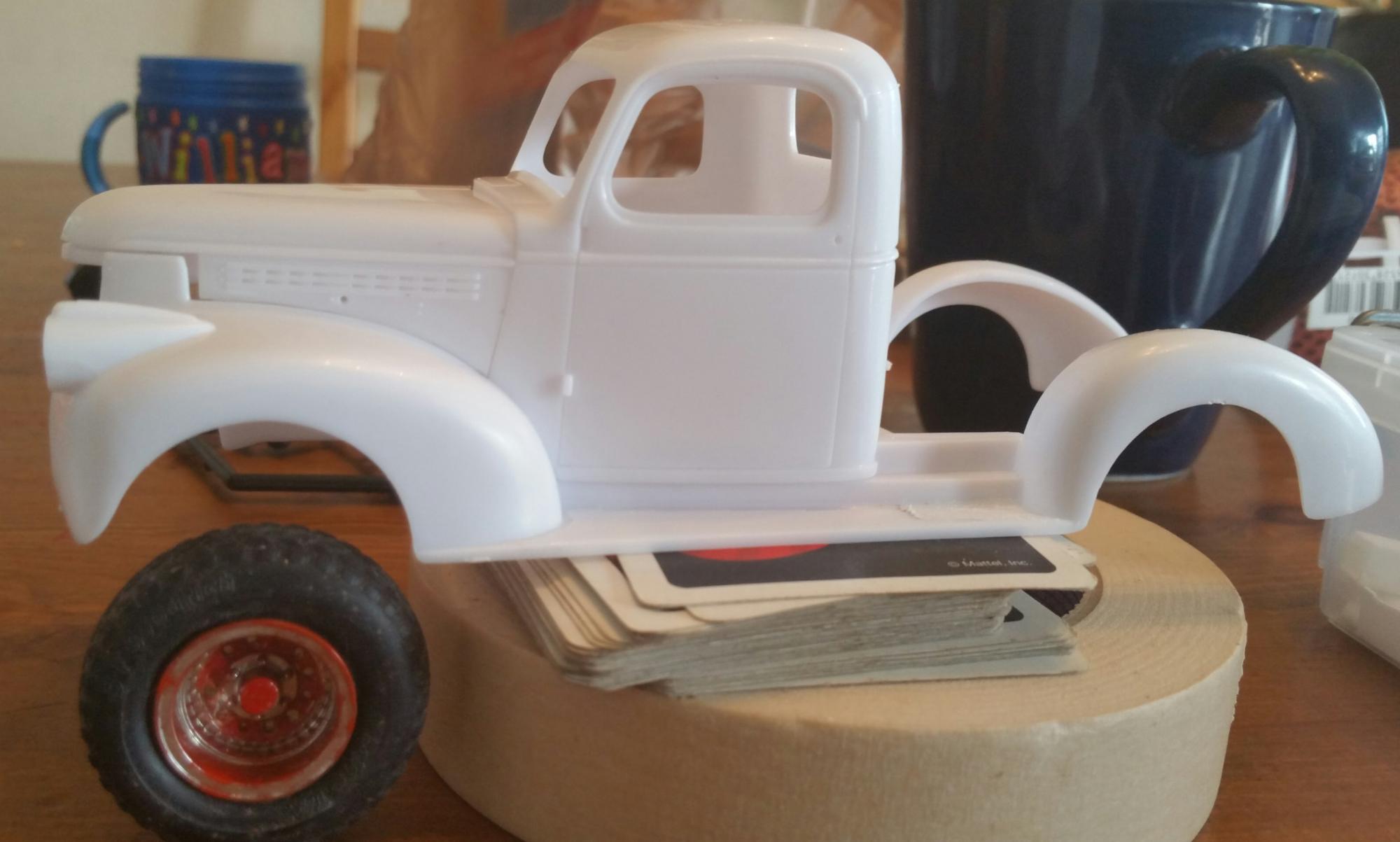

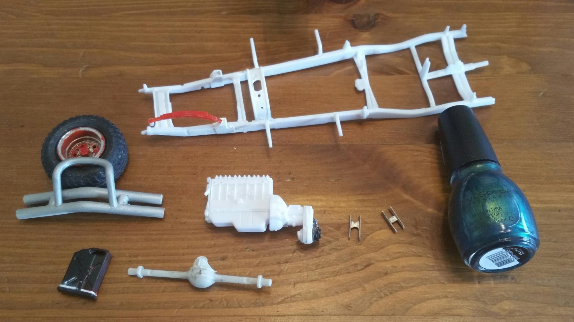

  3. So I started this one about a month ago and just now got pics to post. I'm doing a custom 4x4 conversion with a solid able swap. Custom parts so far. Front tube bumper, custom transfer case, front leaf springs, transfer case bracket and lift shackles. Still to come Rear leafs, rear bumper, drive shafts, and probably much more.

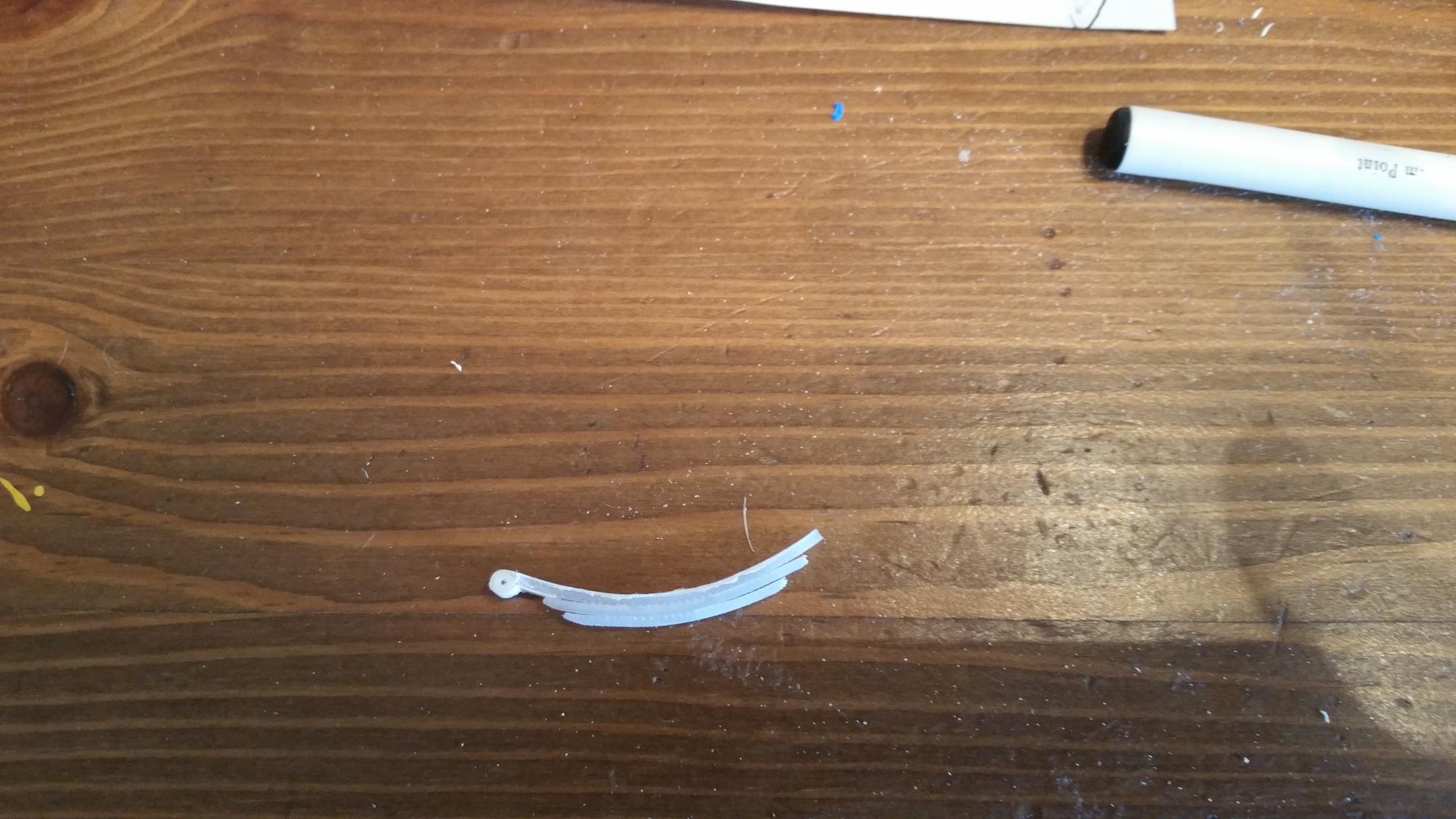

  7. Is looking amazing. I'm a major jeep freak so I do have one critique. Please know I mean no disrespect with my critique. It look like you extended the spring perches to gain your lift while retaining the stock springs. I would like to suggest creating new springs with a greater arch to get your lift. I created this one from a couple zip ties, a thin sheet of evergreen and an evergreen rod. 1. To arch the zip tie punch it between your thumb and pointing finger with your thumb nail against the smooth side of the zip tie and pull the tie through your fingers. This will give the zip tie a nice arch. The more times you do it the greater the arch. Make three or four of them for one spring. 2. Give each one a light sanding this will help paint stick better. 3. On your main spring glue the rod to the end. (I found it was easier to leave the rod lower to do this and trim off the excess when the glue set. ) 4. Use your thin sheet (as thin as you can get so it's more like paper than plastic. ) to line the top main spring and wrap around the rod. This is to give your spring an eyelit to mount to your spring hanger. For the hammer use two strips of plastic or if you have I beam strips trim out the center creating an H in it. The spring in the picture is the scale equivalent of a 3 inch lift spring. On the truck I'm working on I have it mounting to a 1 inch hanger and am doing a spring over design on the axle for a lift off around 6 inches. Not site if this will help or not but if it does I'm glad I could help.

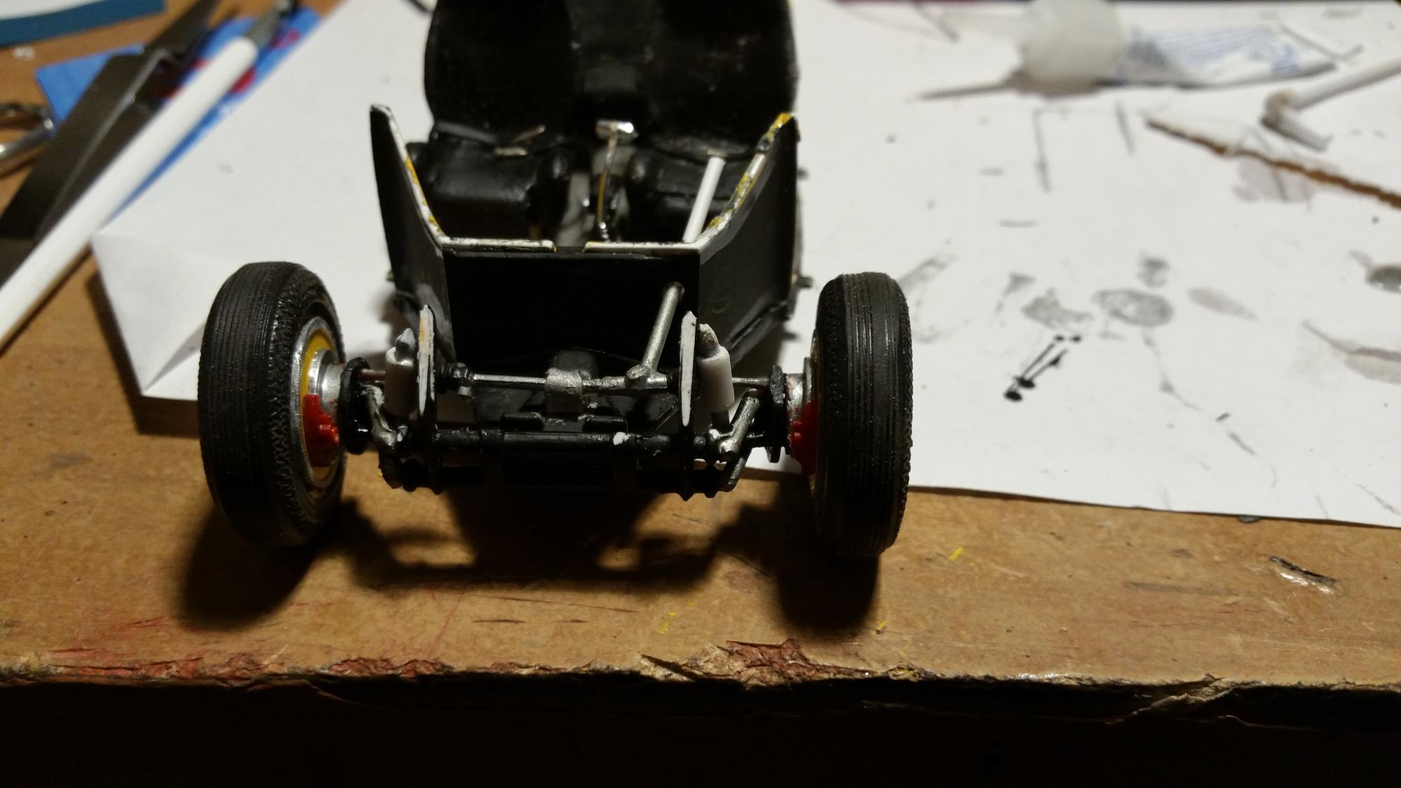

  9. Okay so I'm going to try a test to see if I can get my photos posted bare with this HTML class. Value is [URL=http://s359.pho Okay so looks like this way I only one pic per post do still trying.but this is the mock the front skid plate and guardfront end with steering arms and shocks added
