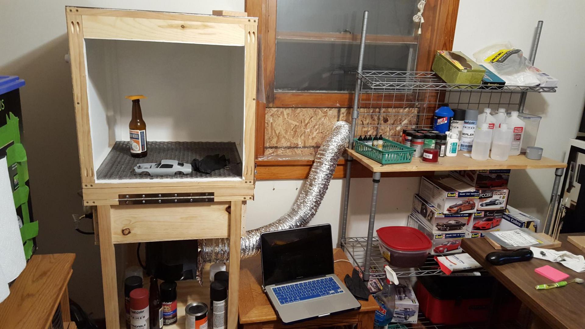

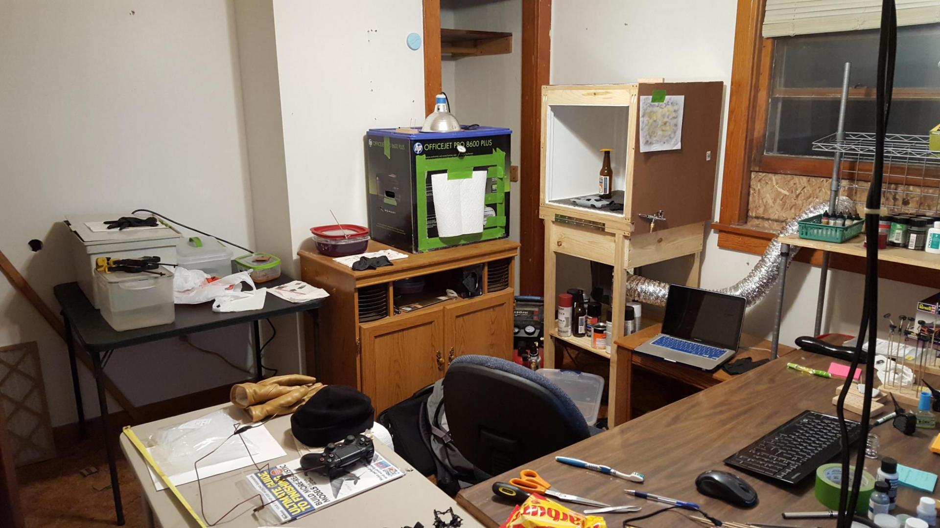

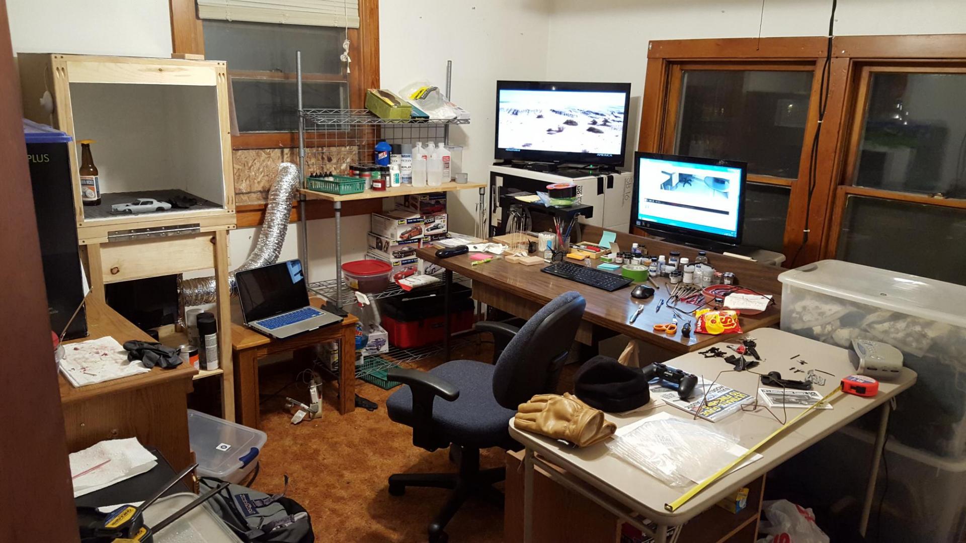

  2. here is my workshop, finally finished building the spray booth after getting tired of breathing in the fumes....pretty happy with it. The small containers on the table are water, one is my sanding tub with a small pump and hose, one with water and soap, another with just clean water. I have no water near this room, so have to have containers for everything. The box next to the paint booth is a drying box =( Turned out pretty good i thought

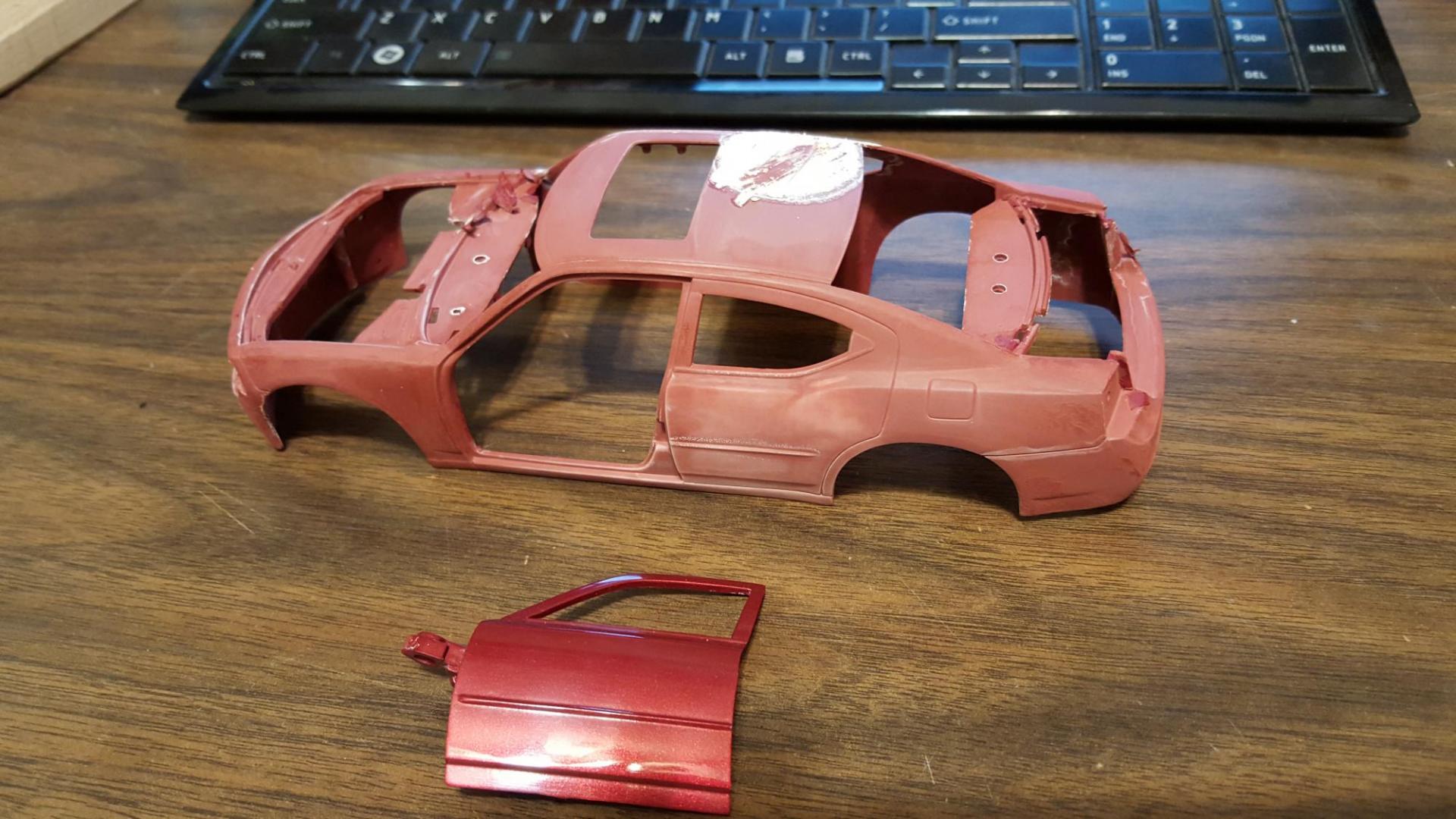

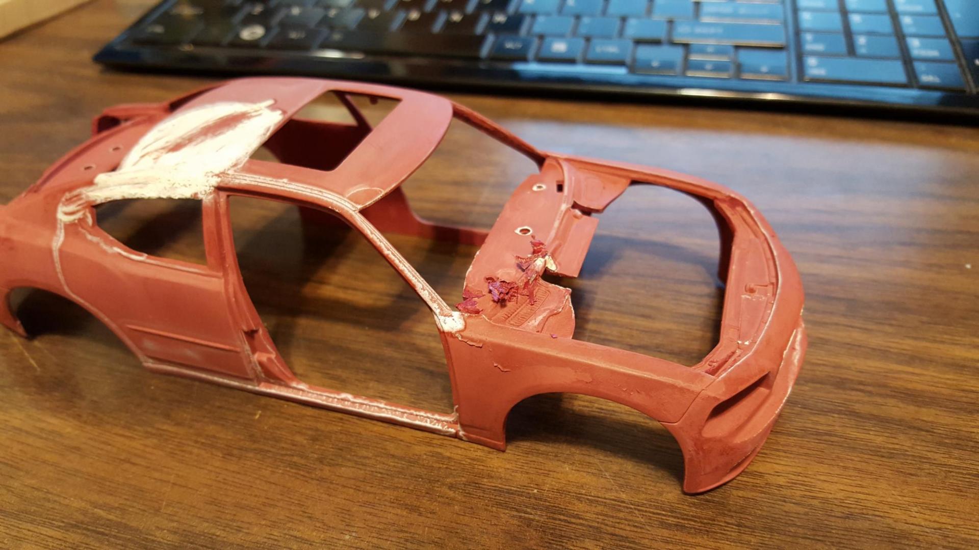

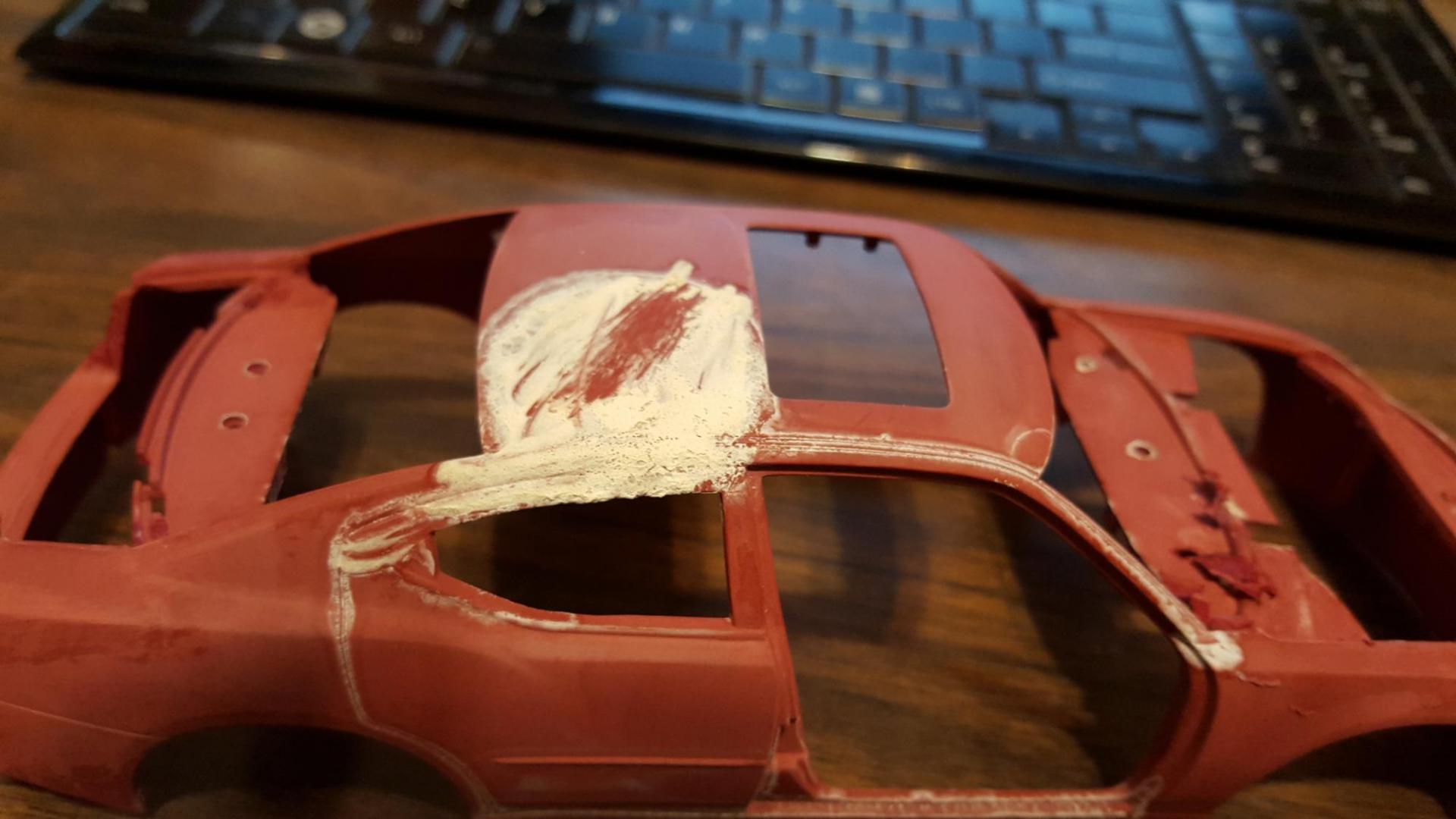

  3. I wish i could get the same results some of you get, this last body is really giving me trouble. I messed up the body and the hood on this charger, left it in Super clean for about 3 weeks, eventually it managed to get through the paint, but its barely touching the primer. I had it soaking int 91% alcohol for a few days and it didnt even discolor it, Same with Brake fluid. I still have the hood soaking in it. The white blotch on top was an Easy off test. Didnt even get a speck off after rubbing it. I ended up just ordering a new body and hood. But it would be nice to figure out how to clean this up.
