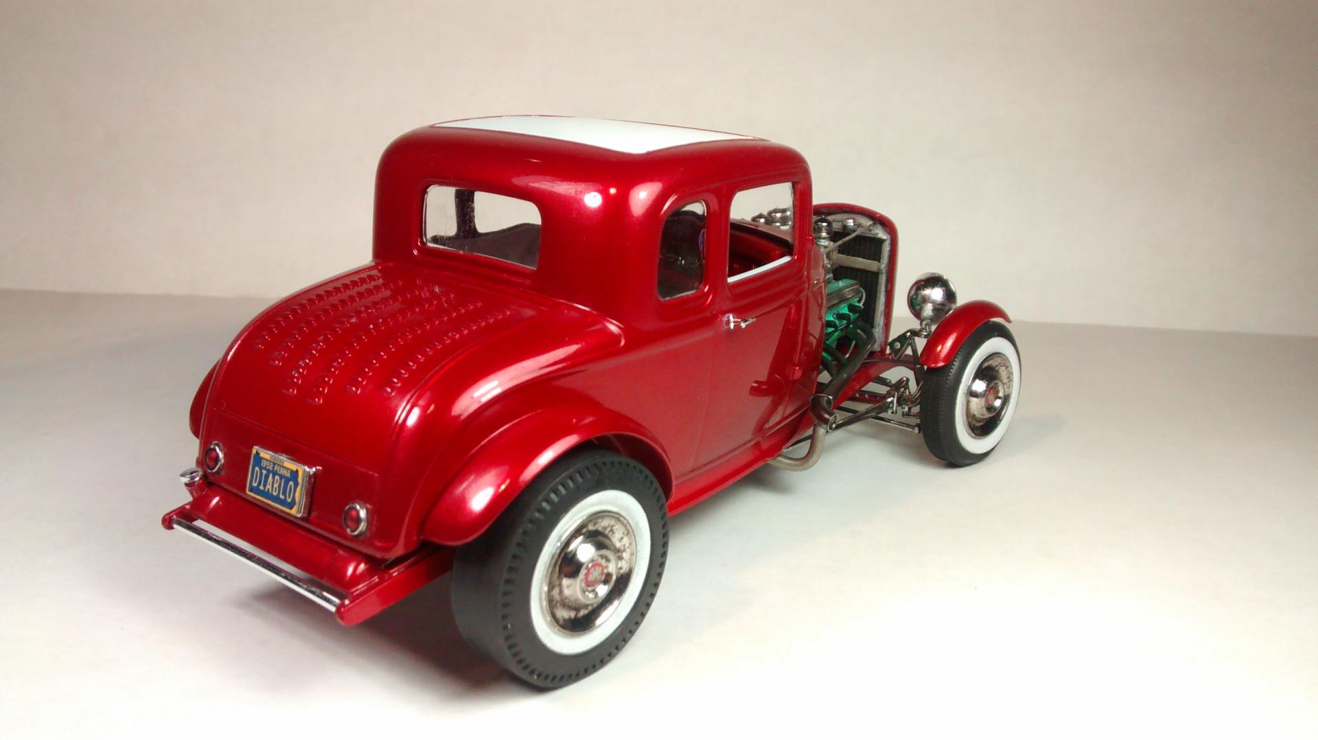

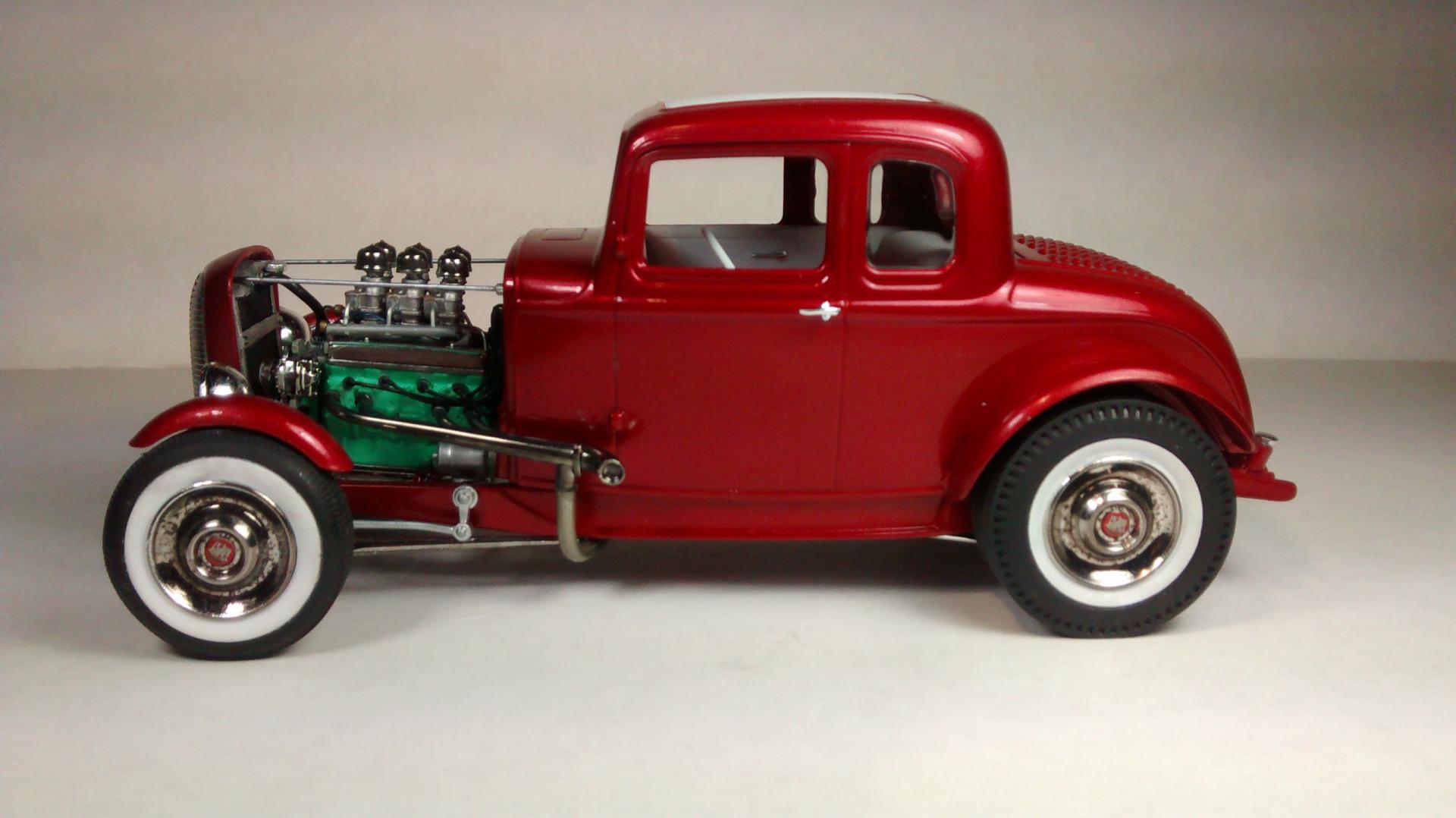

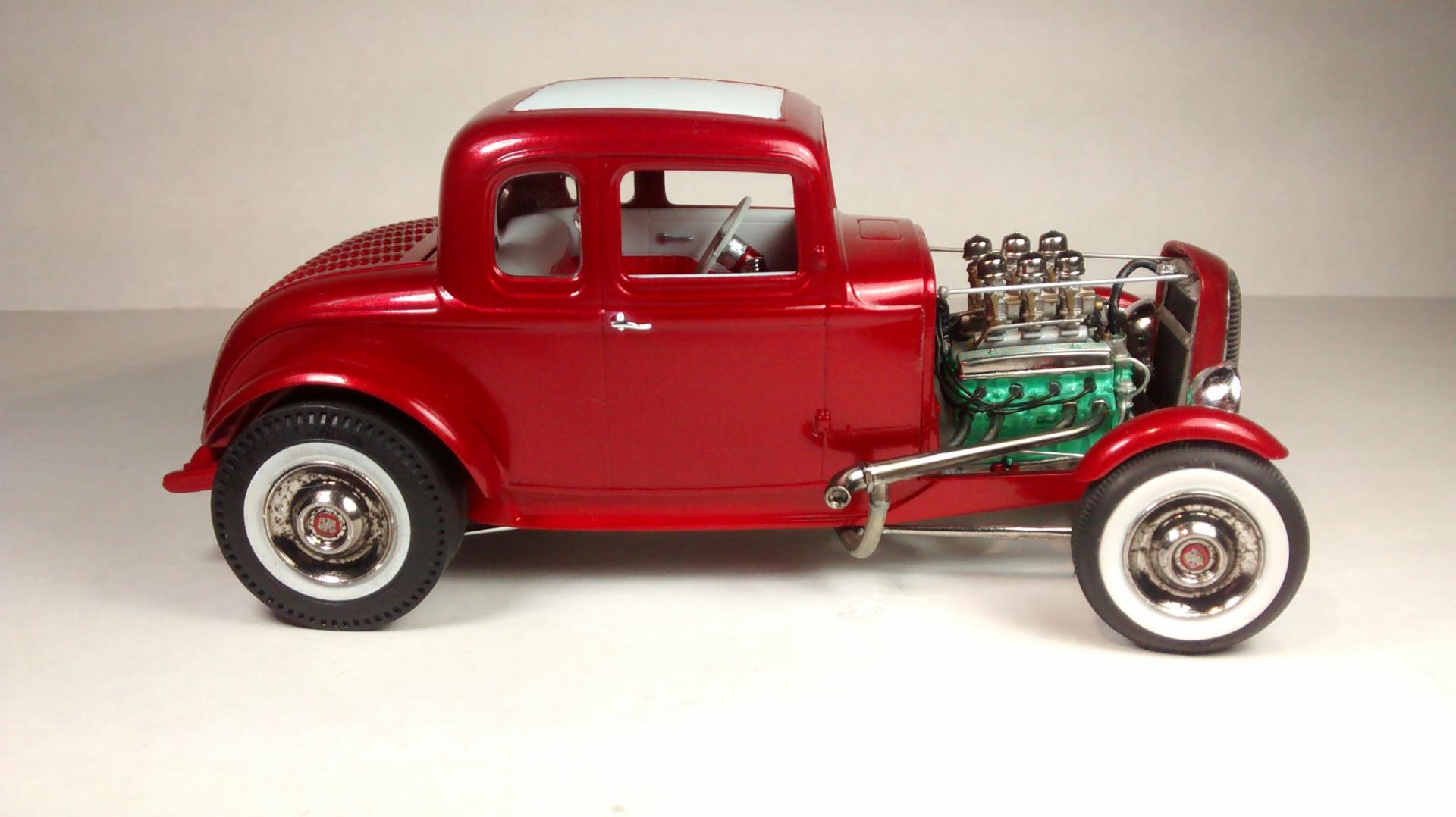

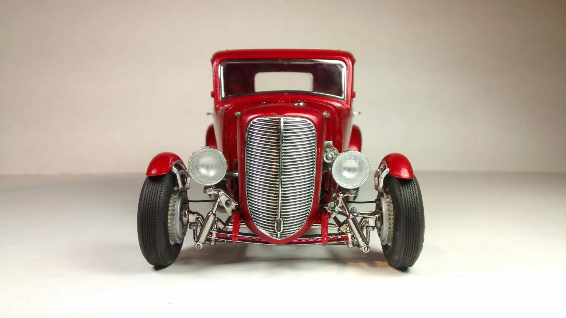

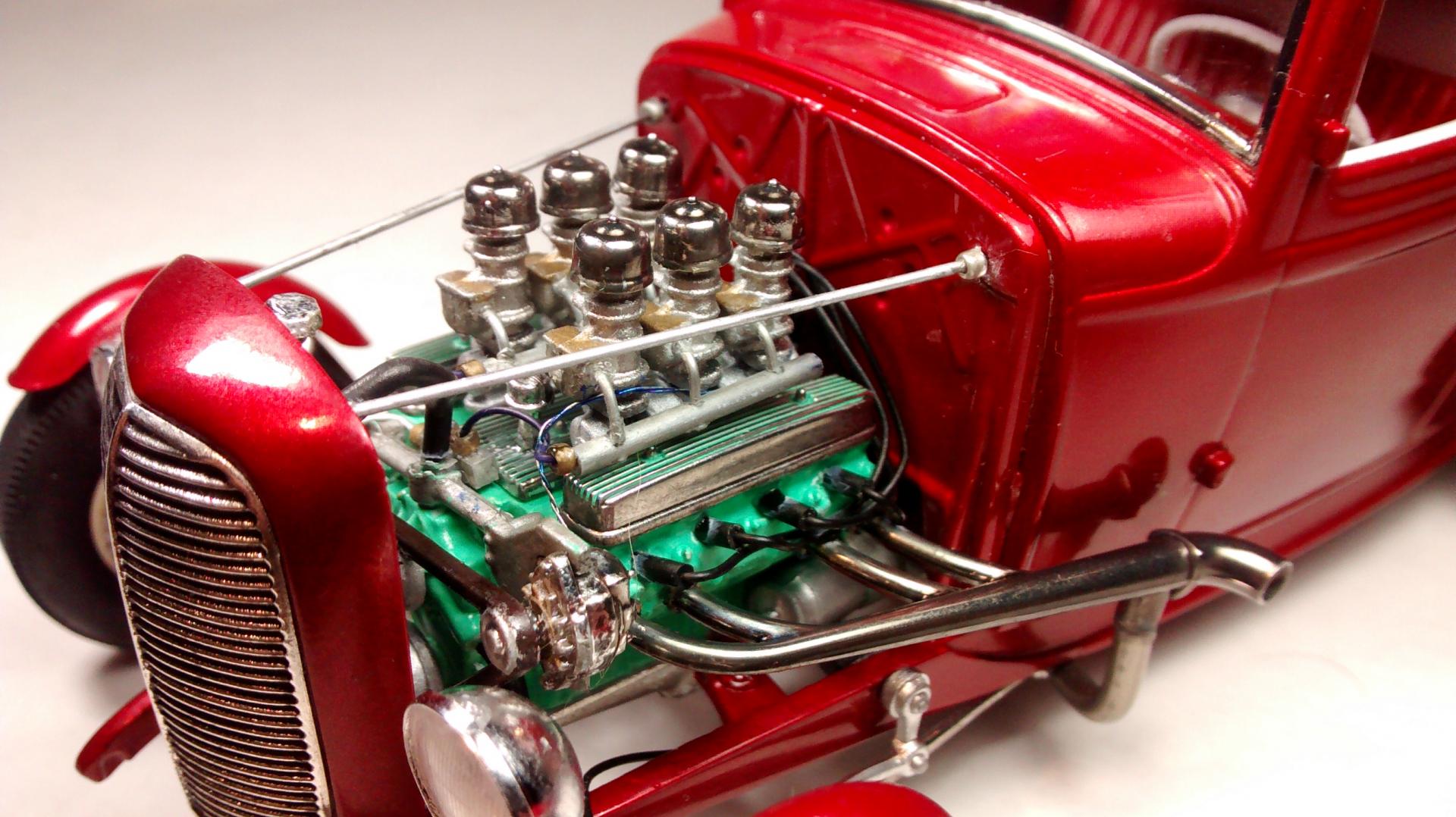

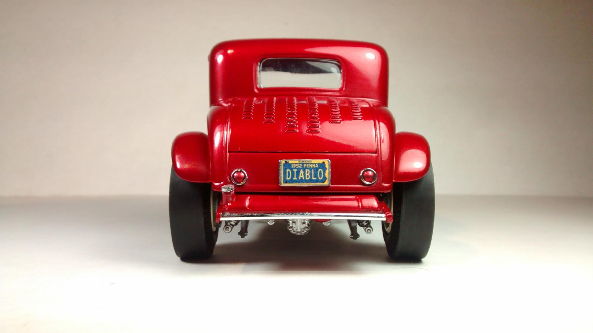

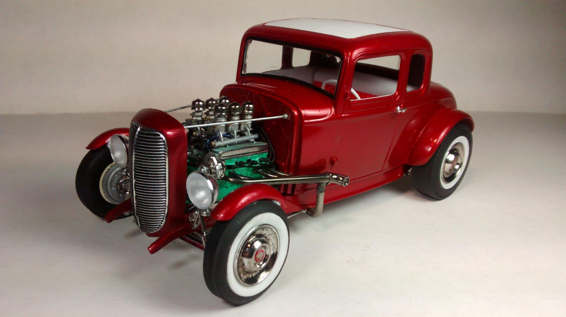

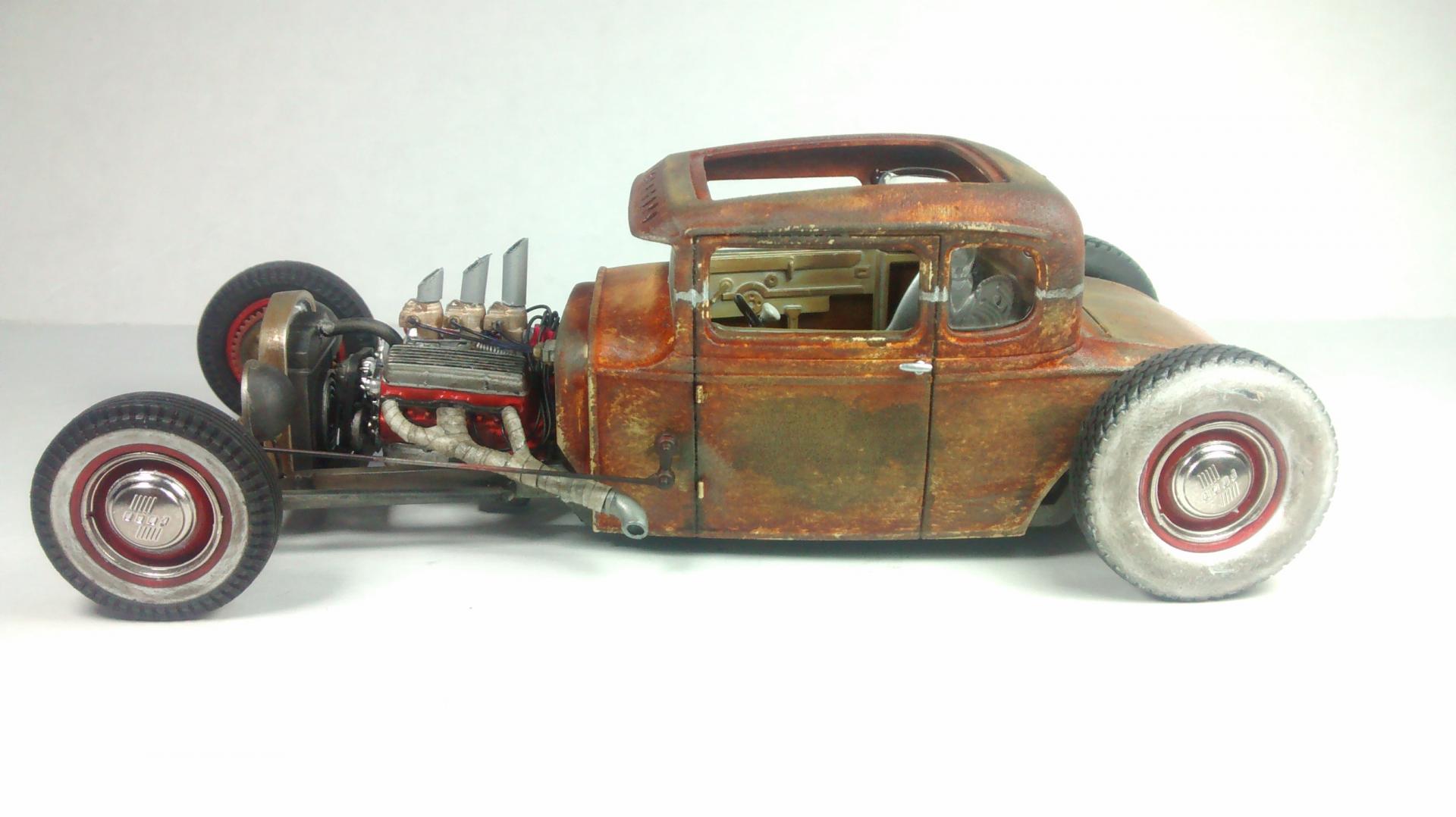

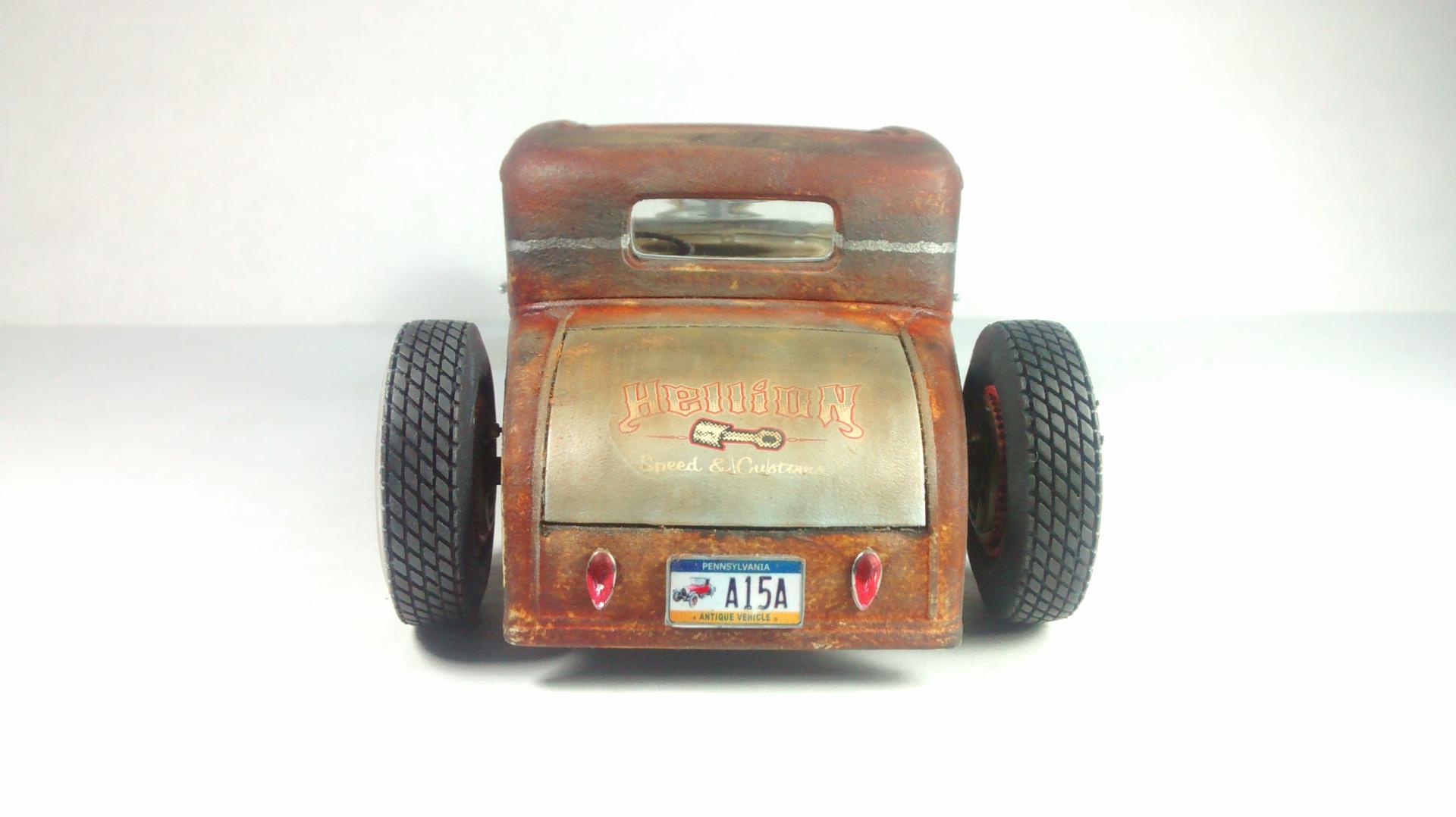

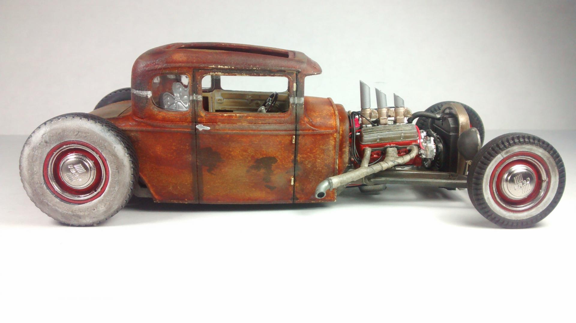

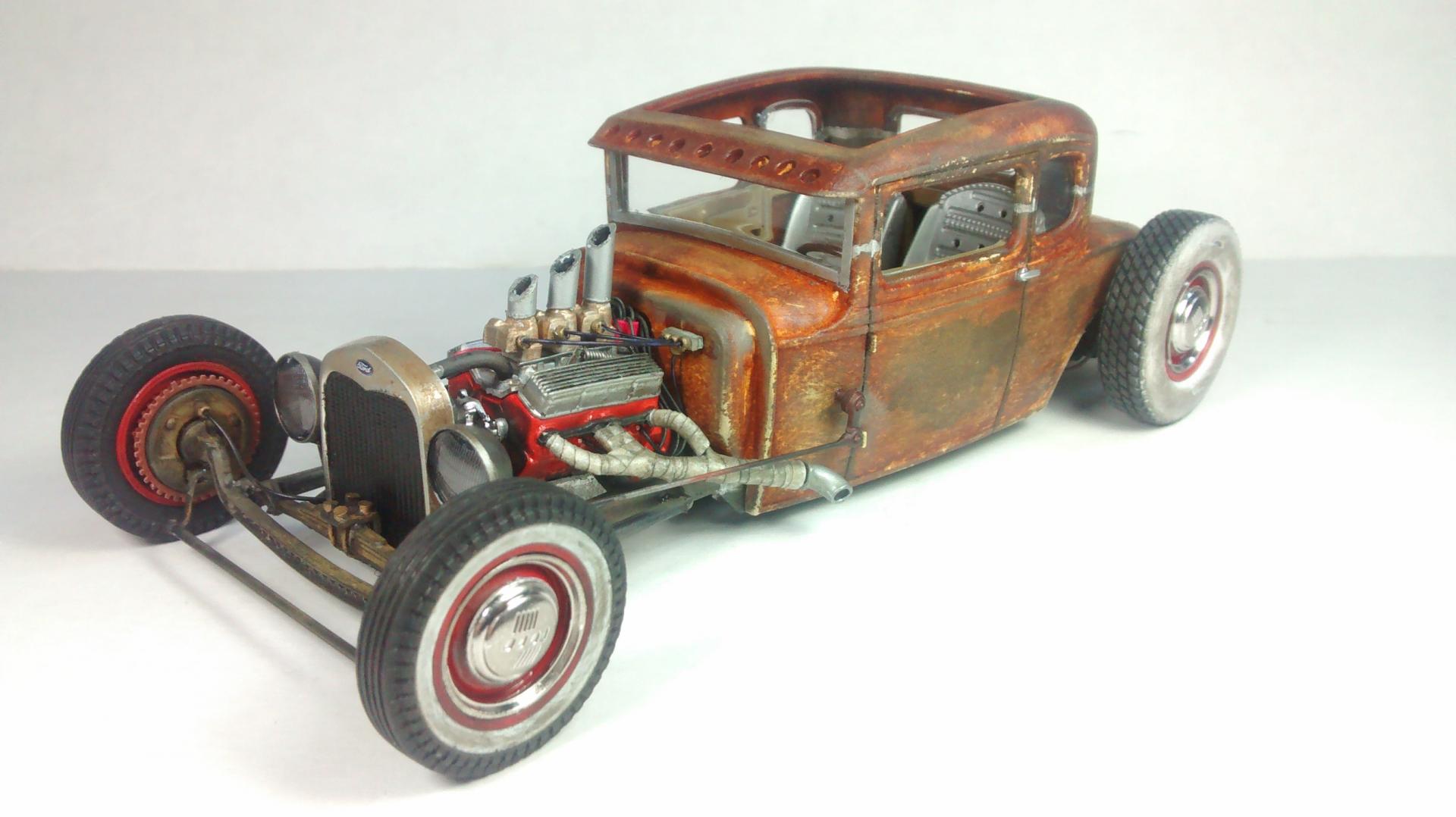

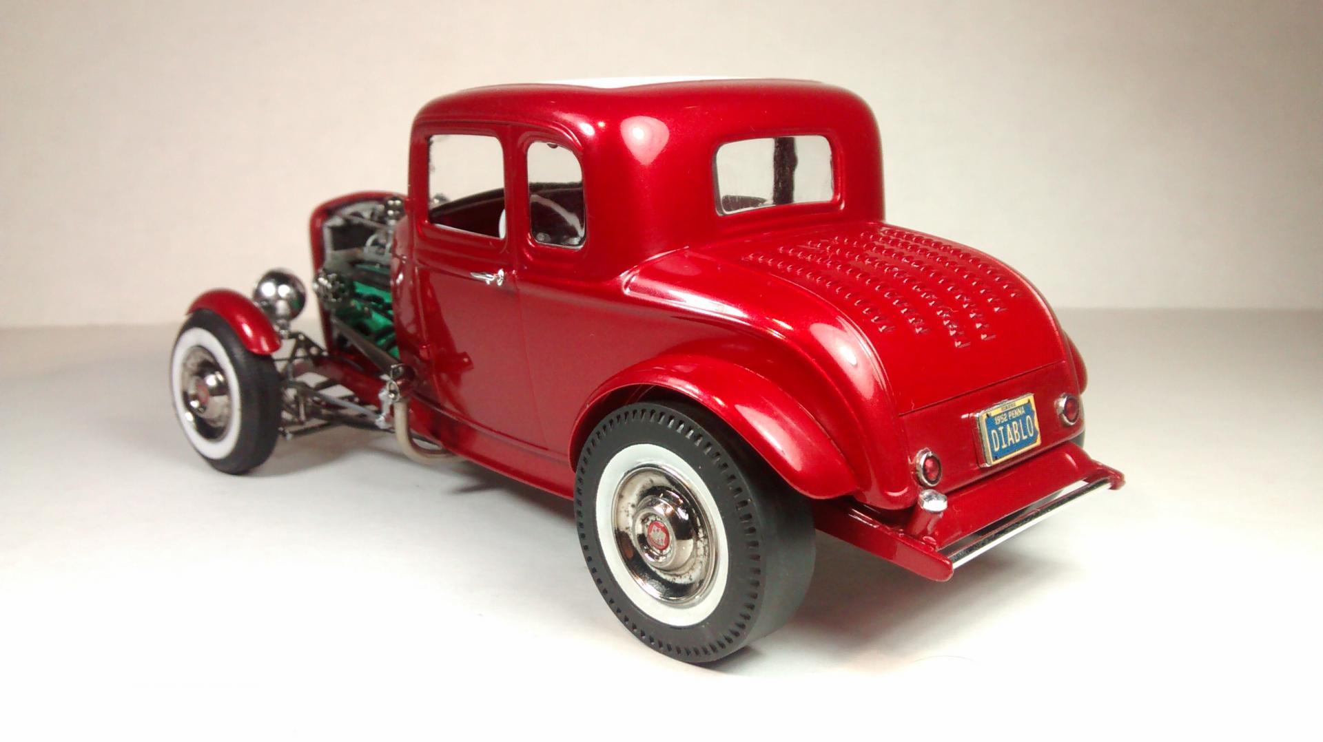

Here's one I've been working on off and on for a little while. The base for this one was the Revell 32 Five Window. The front suspension and engine were sourced from the Revell 29 Roadster. Surprisingly enough, with the relocation of the motor mounts and some trimming here and there, most of these parts fit pretty well. The only hang up I had was mounting the engine a bit too high, leading to the down tubes on the exhaust not fitting at all, but two pieces of solder and a little bending solved that pretty quick. The fenders and stock firewall come from the Stacey David Rat Roaster. The grill is a lightly modified piece from a 37 Ford pickup. In my decently sized parts box, I couldn't find any steel wheels that would work for me. I settled on some spare Caddy caps from a 49 Merc kit, which I ended up being pretty happy with after all. The rear slicks are AMT parts pack pieces. The distributor was drilled and wired, and the carbs were plumbed. I don't know if it's entirely accurate, but I wasn't sure how six carbs with a front mounted fuel pump are fed, so a distribution block was added to feed the two fuel rails. The carbs in the kit appear to have molded in linkage, so I just glued a piece of wire in to connect them and called it a day. The last little touch was to get rid of the rear that came with the kit and swap in a quick change from a Paddy Wagon kit. The is Ford Toreador Red Metallic over a Torch Red base, topped off with Testors Wet Look. Thanks for looking!

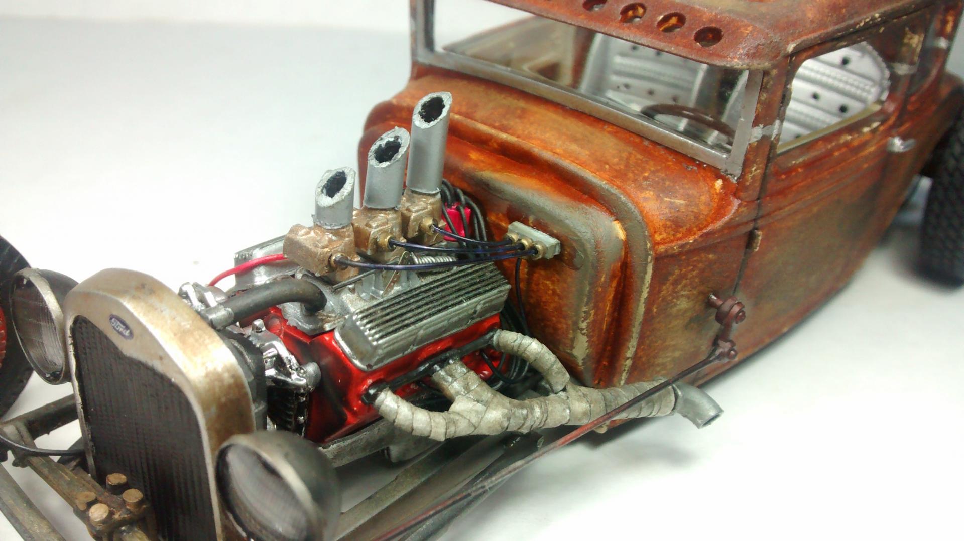

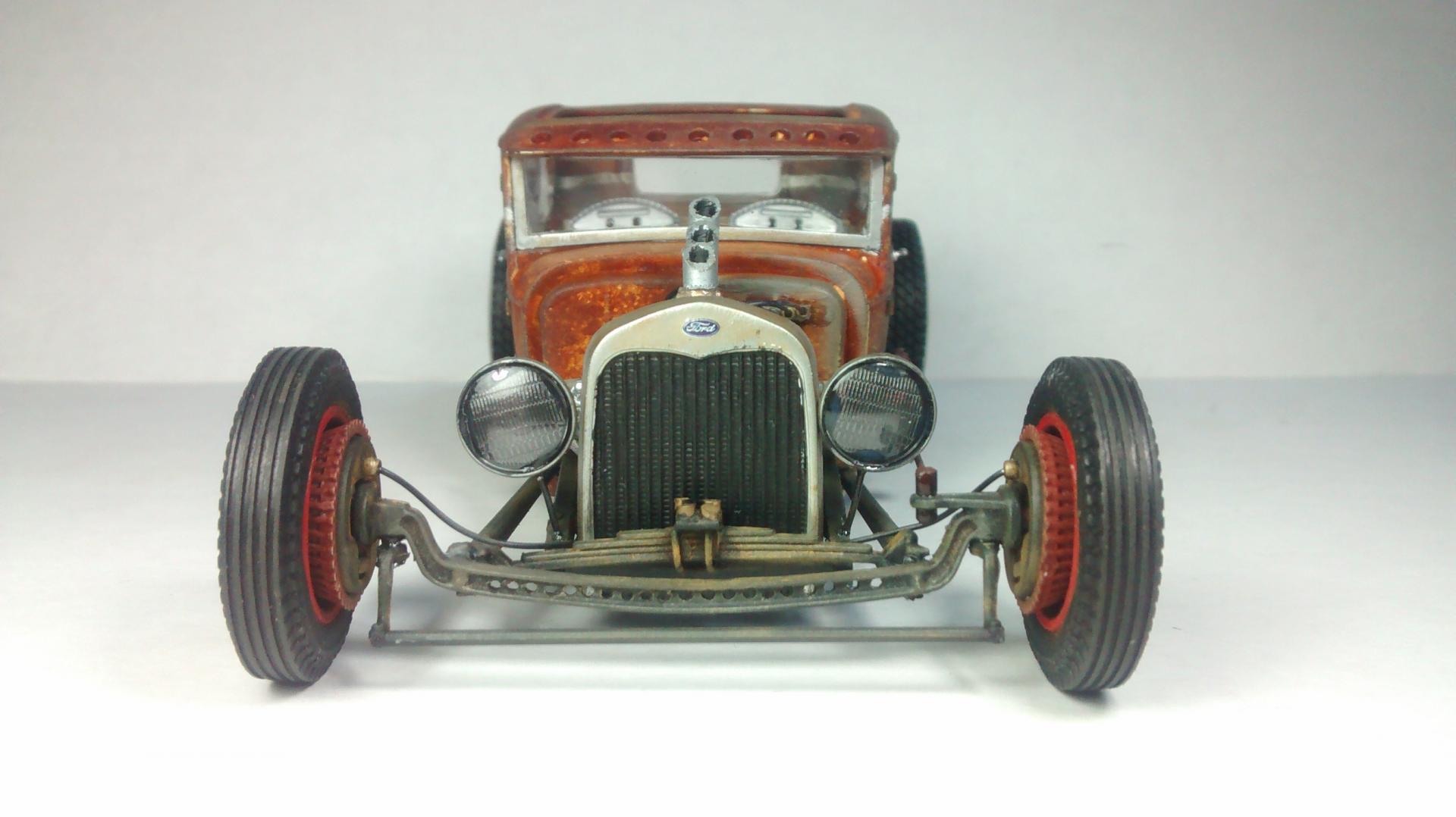

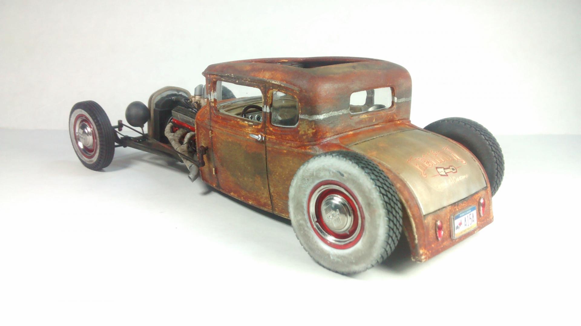

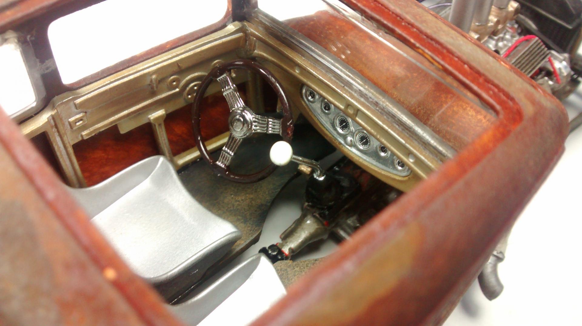

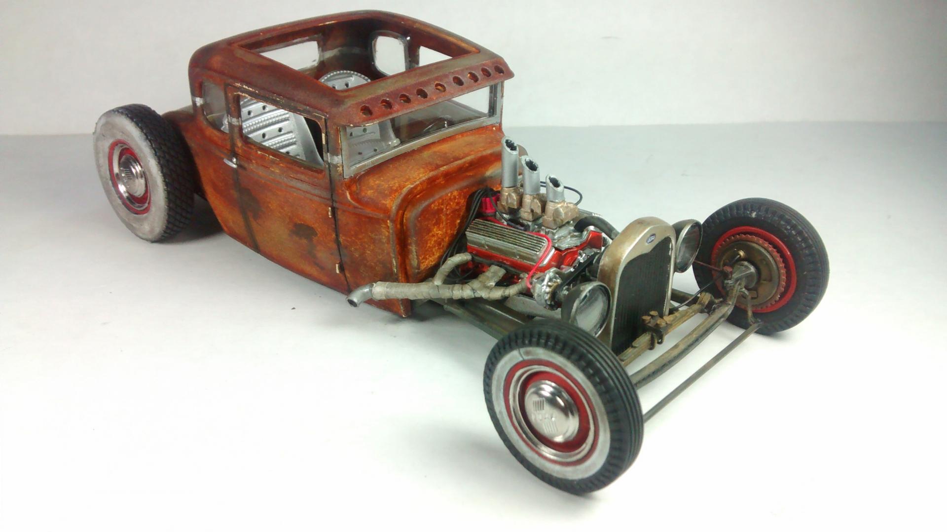

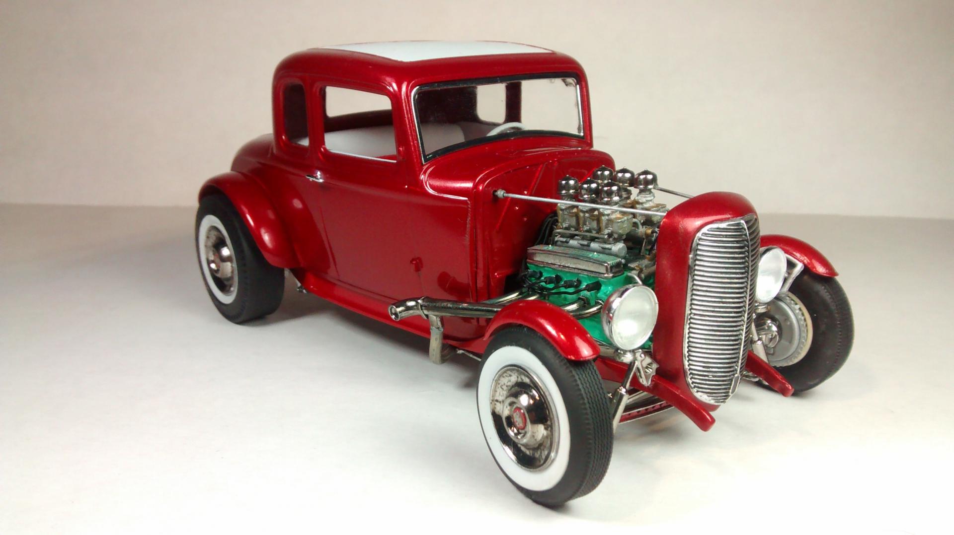

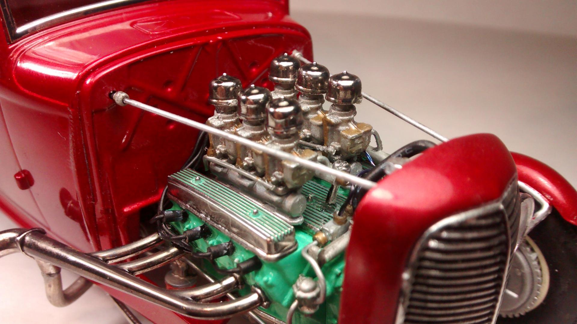

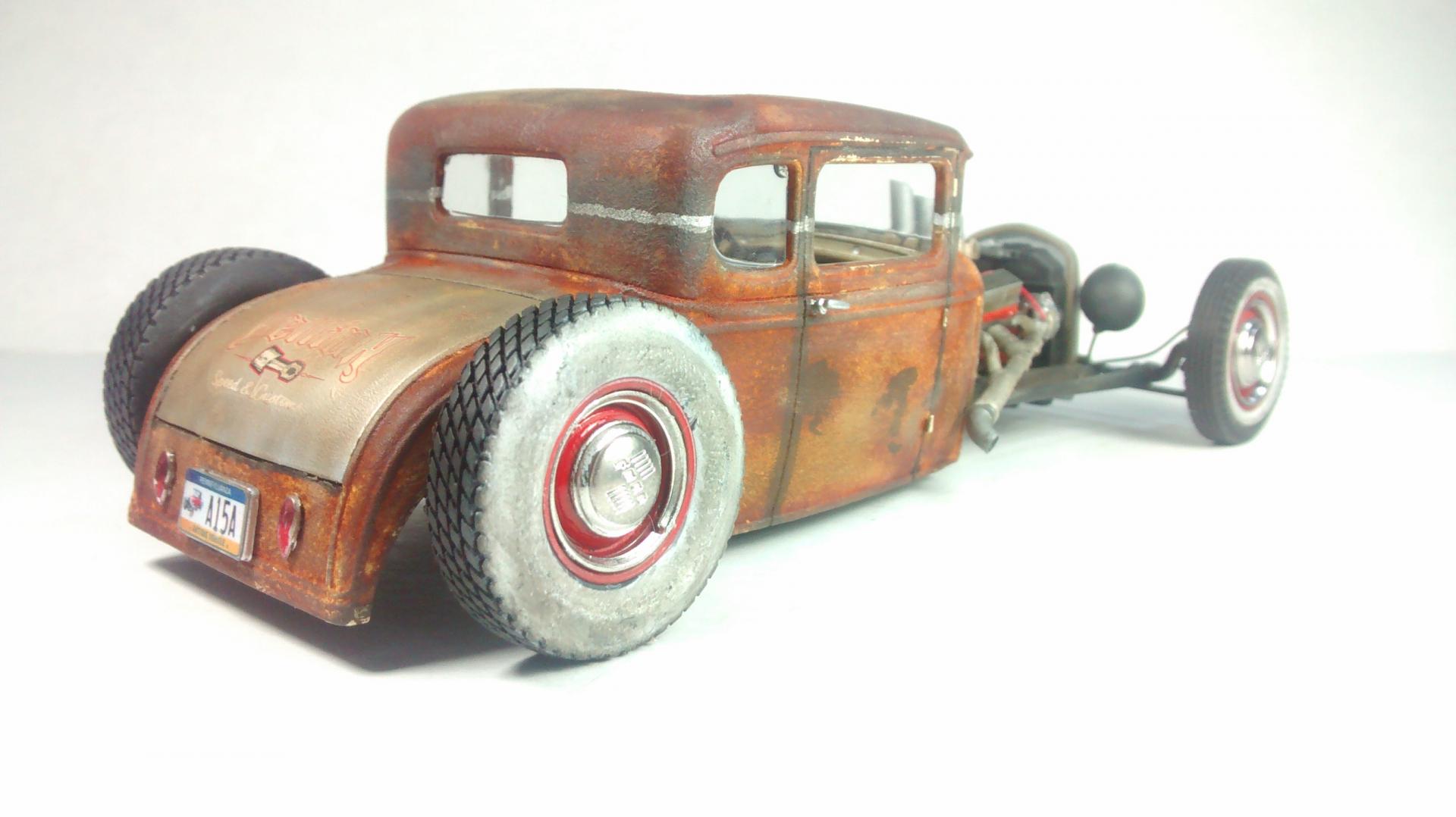

It's been a little while since I've posted, mostly due to Photobucket annoying me to no end. Thank God for the new format here that allows me to let them fade into the past where they belong. Anyway, I recently completed this 30 Ford. The frame was double z'd with the suspension mounted suicide style up front. With this kit allowing you to build a channeled version OOB, the work to get the super low look that seems to be in vogue nowadays is actually really straight forward and easy. I decided to use the skeleton interior, but wanted the transmission and driveshaft exposed. Having to cut the floor in half to do this complicated things a bit, but it was still pretty easy to achieve. With the tranny exposed, I thought it would be a good idea to scratch up some shift linkage. It's almost impossible to see, but at least I know it's there lol. The engine was wired and plumbed, and some masking tape was wrapped around the exhaust to simulate heat tape. A couple pieces of plastic tube were cut for carb stacks. The whitewall decals had me climbing the wall, so I sprayed them with some Duplicolor primer, forgetting solvent paints don't dry on vinyl or rubber very well. It ended up being a happy mistake, though, as the paint doing funky things while handling somehow gave them a nice weathered look and saved me some work. The body received some holes in the sun visor and a healthy dose of rust. Well, that's about it. Thanks for looking!
