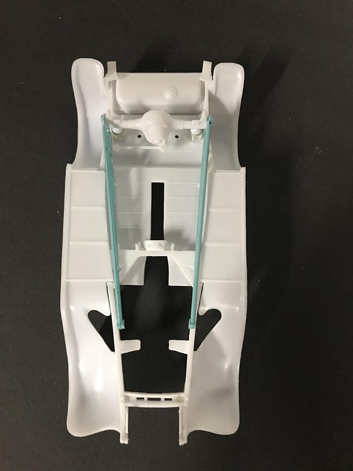

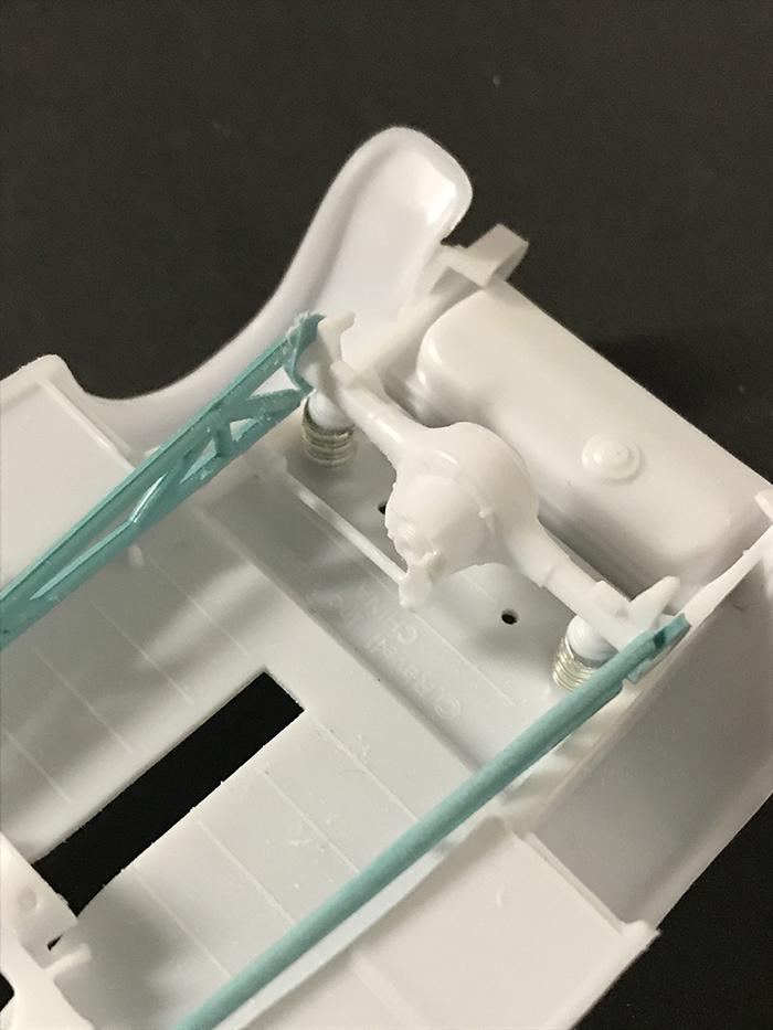

AN UPDATE! After a couple years away from the bench I'm back on this project and feeling pretty good about it! Since I last posted I sorted out all the suspension components. Up front I'm using the dropped tube axle from the Revell 32 which required a significant blocking of the leaf spring to get the ride height I wanted. I built some front shocks and a tie rod out of styrene. Split wishbones are from the Revell 29 Ford. I made some brackets to attach the front bones and rear ladder bars. Out back the Ford 9 inch is supported by coil springs from the parts box and shocks from the AMT 41 Willys with ladder bars from the Revell SW&C Willys. I replaced the super long tail on the Y block trans with a 4 speed from a mid 60s Mustang Gt kit. (Thanks Dennis) and cut down the long oil filter to clear the steering box. I'm really happy with the ride height and how everything is fitting together.

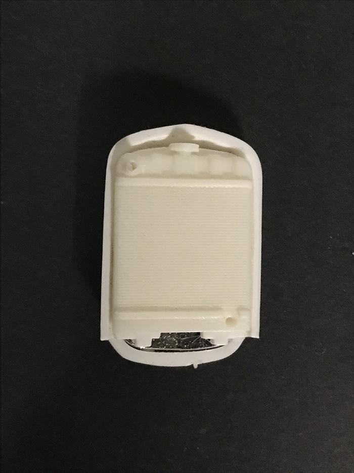

I made a panhard bar by using one of the rear trailing arms from the 57 Ford gasser kit and "welded" it to the front of the rear end. The other end will be attached to the frame in final assembly. I also cut the axles to accept the ladder bars and mocked them up. They will be shortened and mounted to the same bracket the front bones are mounted to, so I'll need to figure out the front end placement before finalizing the ladder bars. The radiator from the AMT Willys gasser was a great fit in the 32 grill shell. I just needed to sand the front to a desired thickness to make it appear recessed into the shell.
