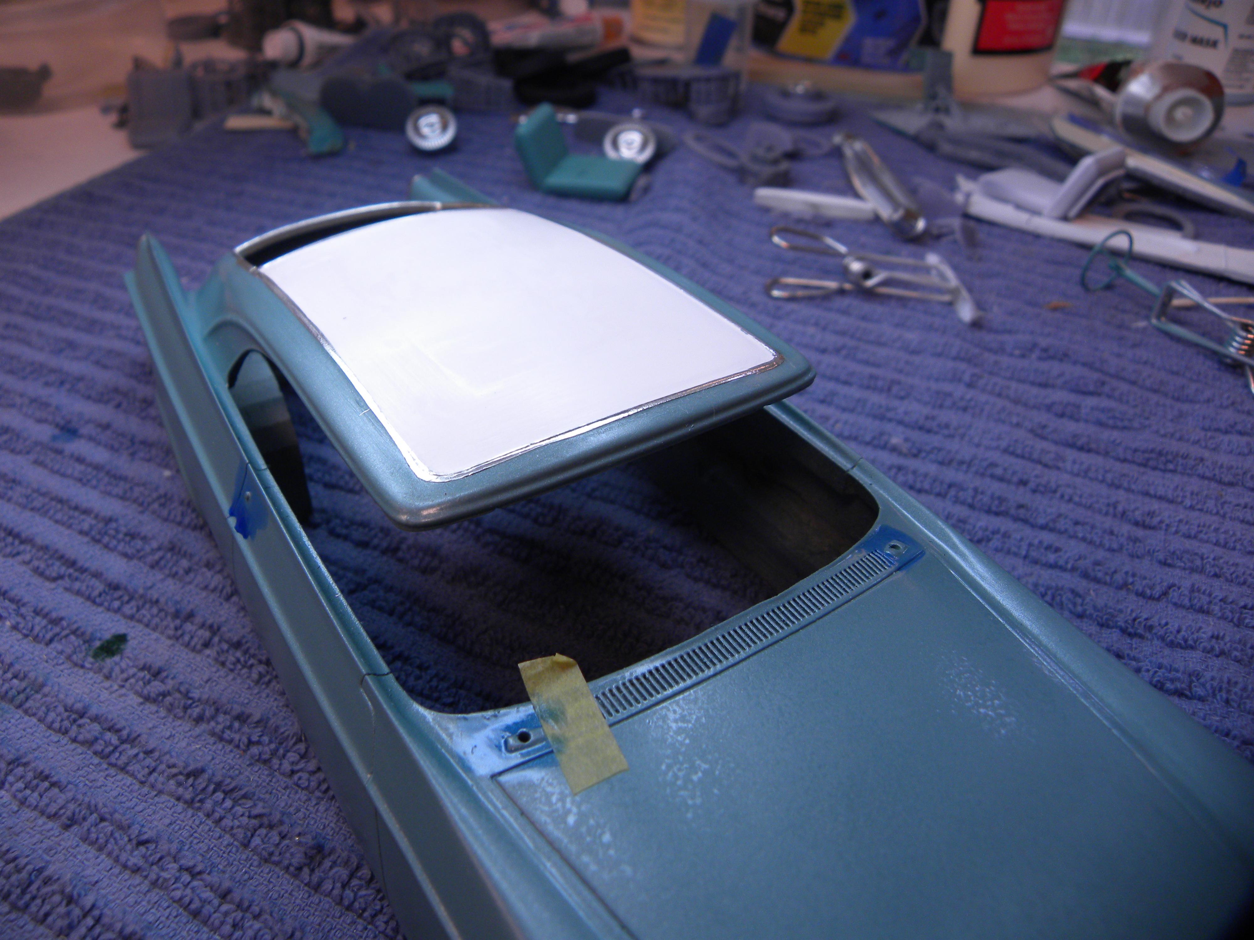

  11. Removing the masking.
  12. Masking.
  13. Yes!
