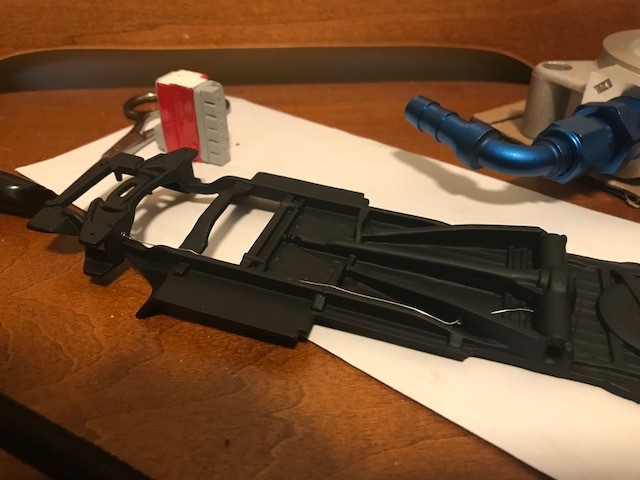

  1. Been a minute since I have made any progress being the holidays are super busy, however, back at this and excited to move forward. Working on getting the engine painted. The resin motor was anything but smooth and took a lot of sanding/fine tuning to get it where I wanted it. Its much improved now. I have added my SS brake line, front to rear, and painted the block. Allowing the paint to dry before moving forward.

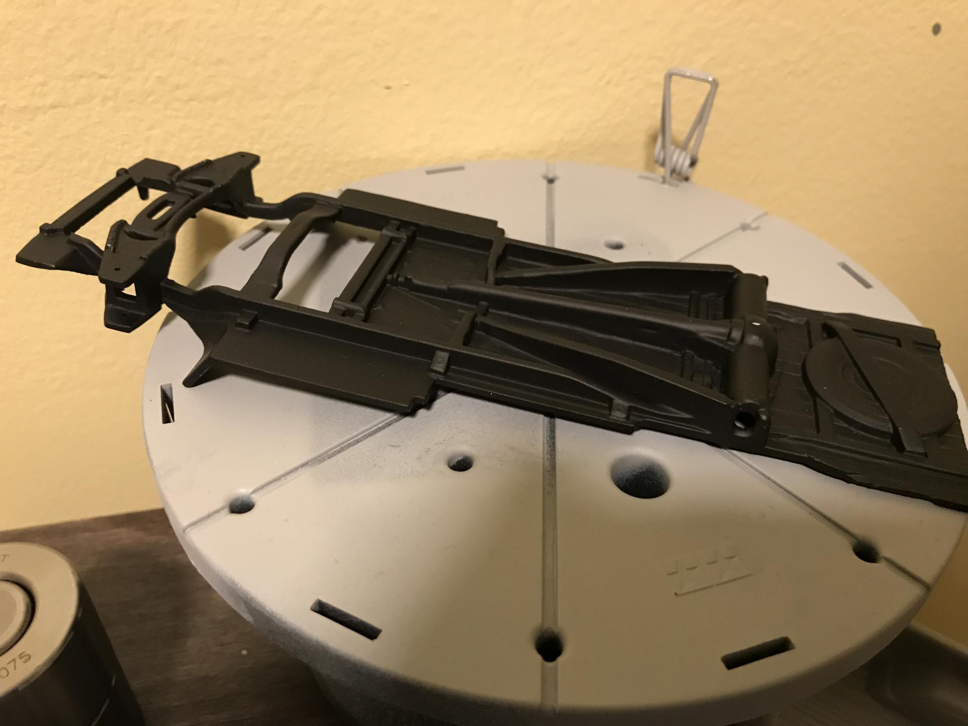

  3. Not much progress as of late. Have been super busy, working on my 1:1 vehicles, and the holidays. The frame has its final coat of matte black I will most likely tape off the control arm cross member and the trailing arms and paint those gloss black for a bit of contrast.

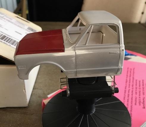

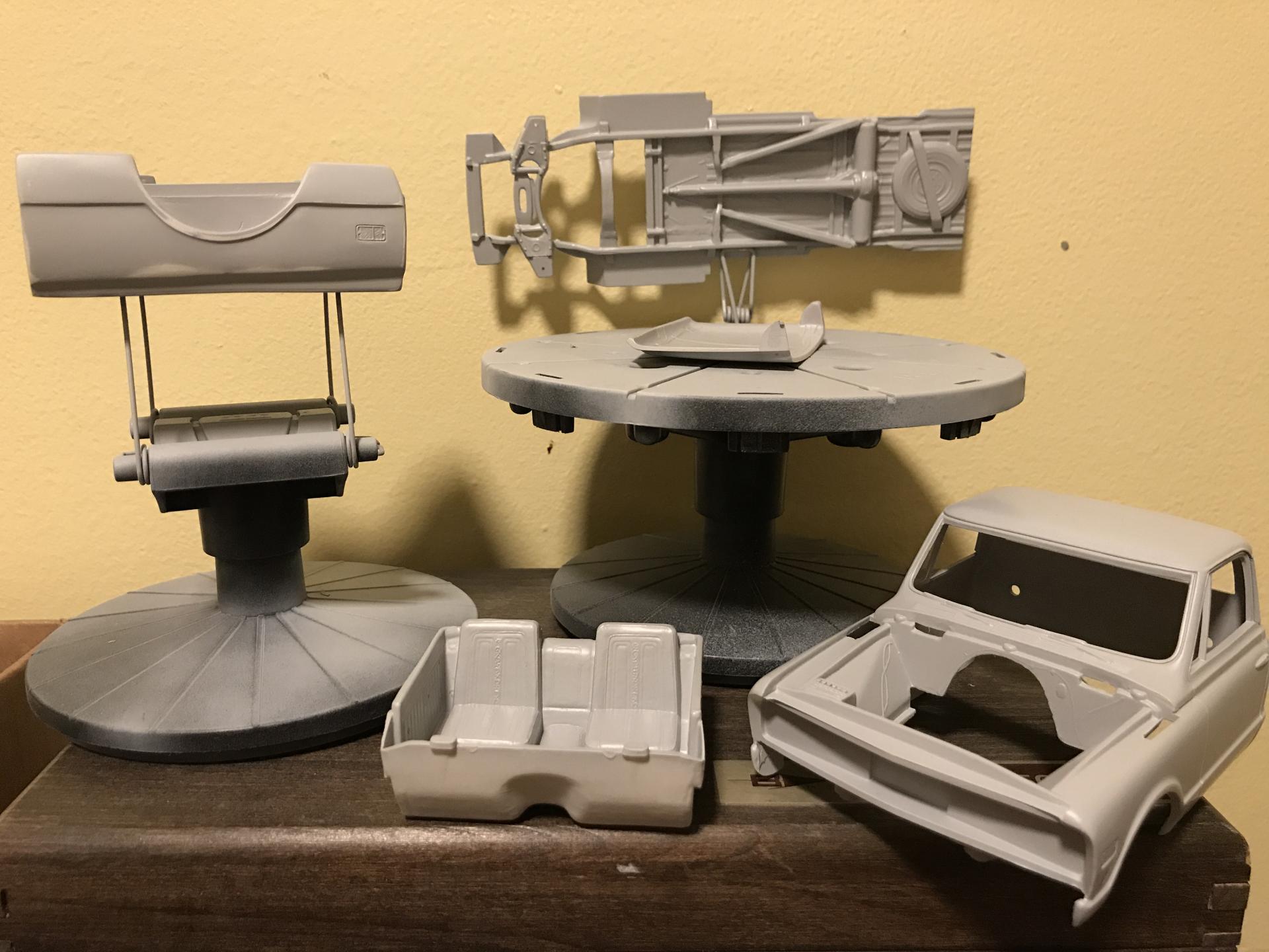

  8. I have gotten the chassis, cab, bed and interior all primed. I have also primed the cummins, however the resin is a bit porous so trying to get a few more coats of primer laid down. I am going to lay down one final coat of white primer next. I am undecided on the color at this point.

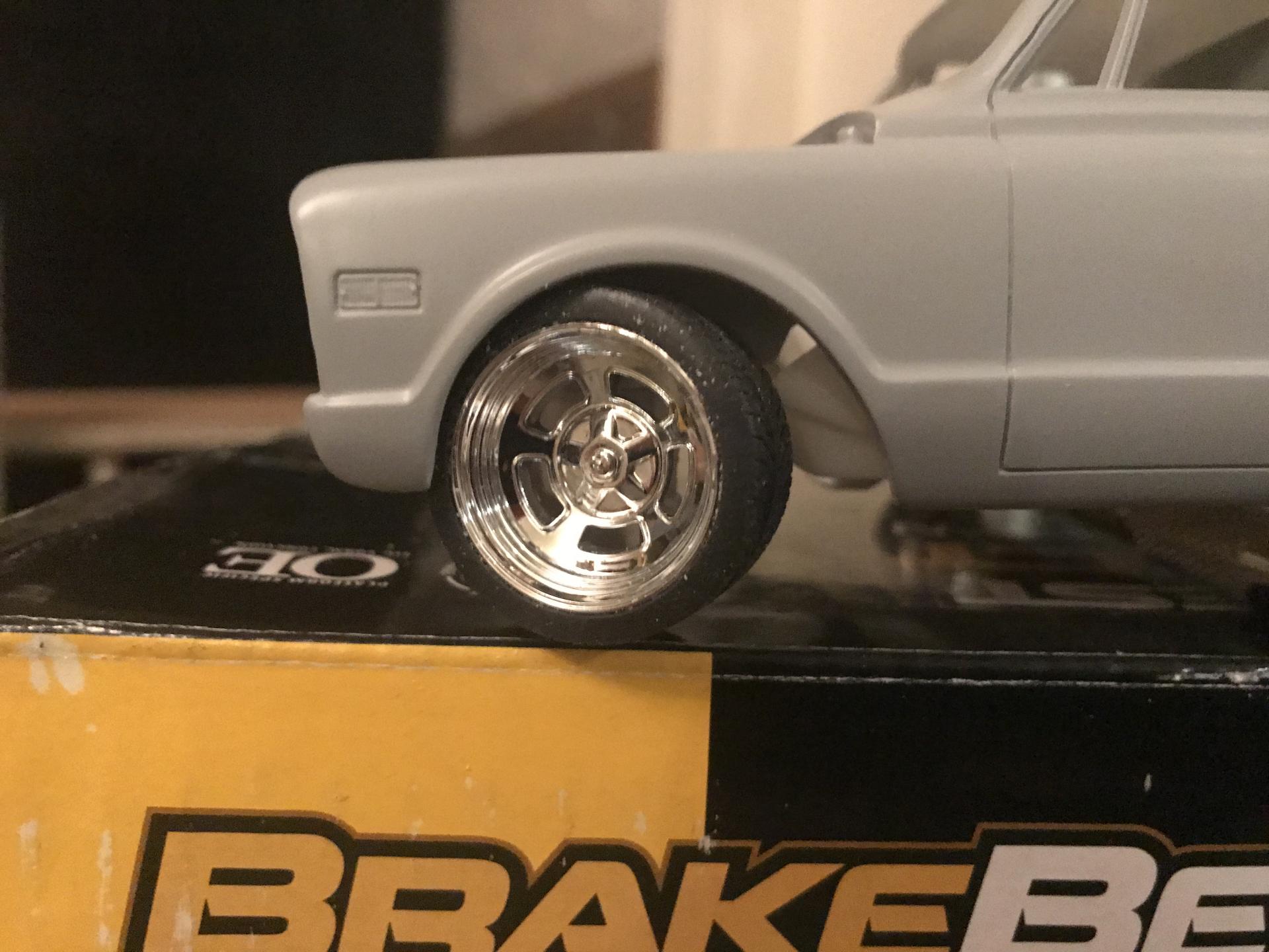

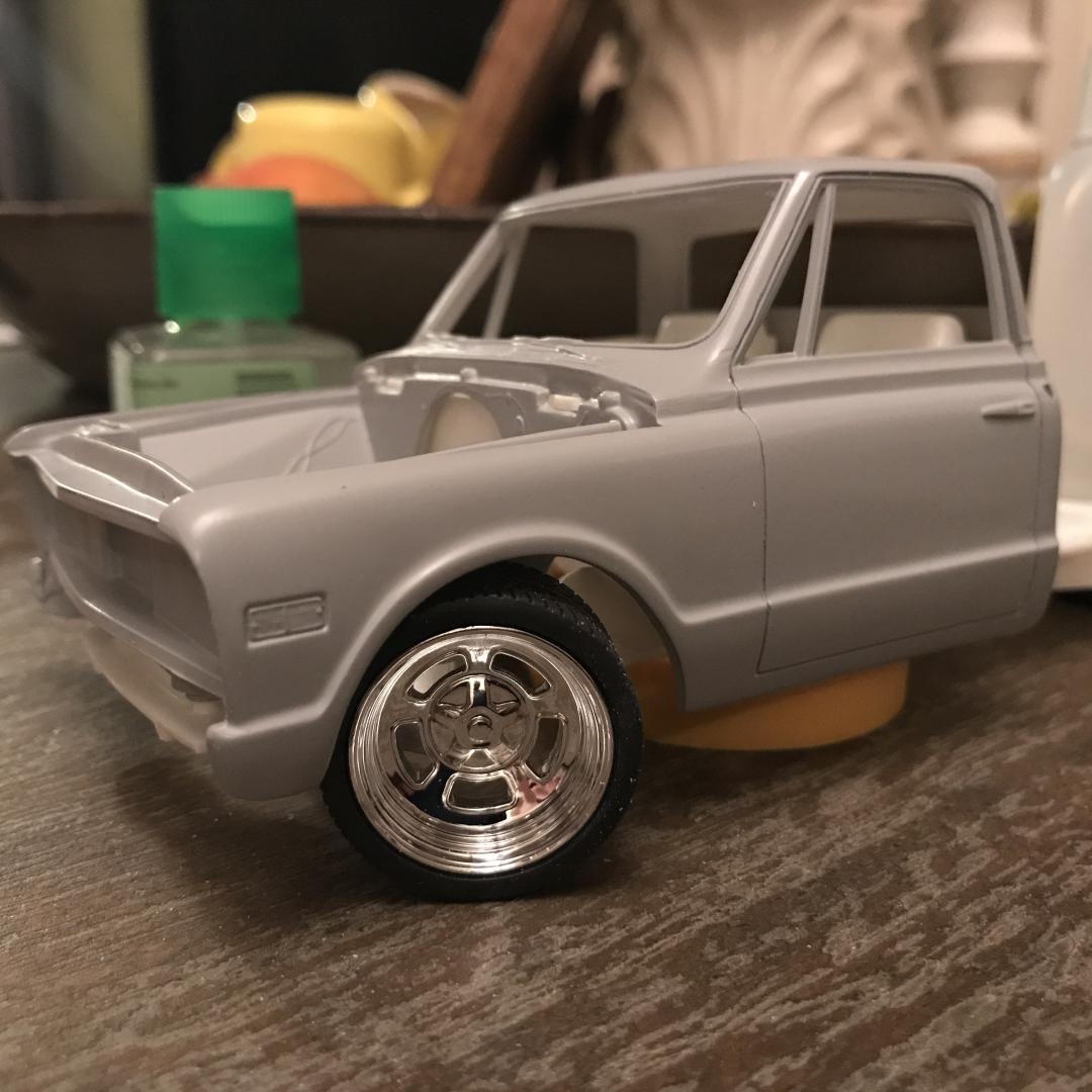

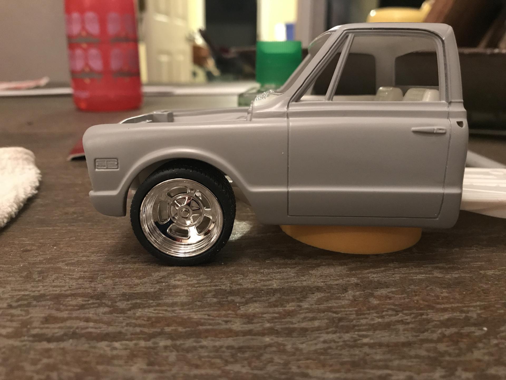

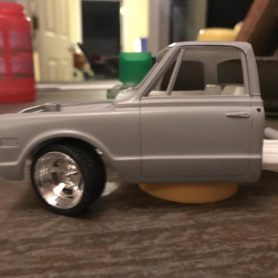

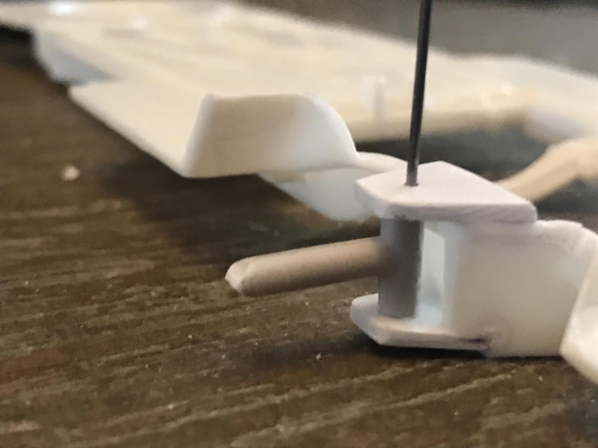

  13. I made new spindles to lower the ride height. Looks much better, also corrected camber/castor a bit as the 1st set of spindles were a little off. These are Pegasus 23 wheels

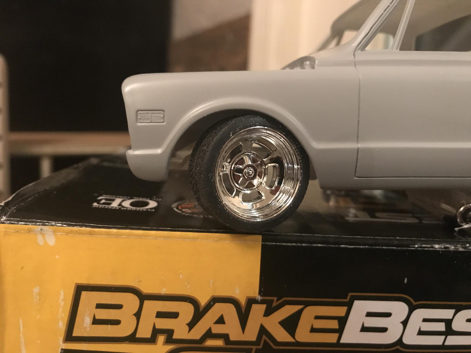

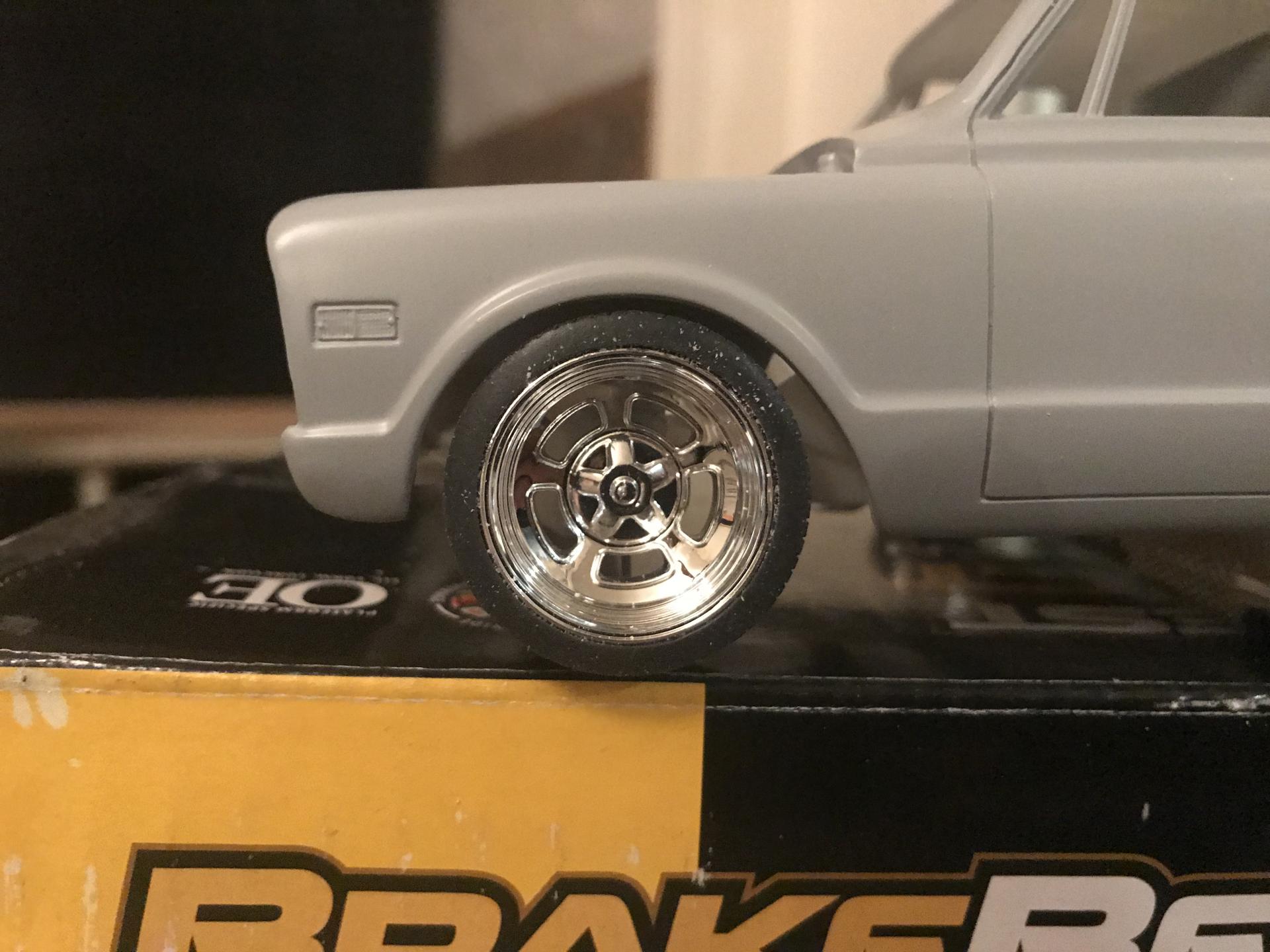

  14. Thanks sir. I have not glued anything yet. I better double check my ride height and make sure it's not sitting too high. I think where it sits now is pretty close to the wheel opening. That's the good thing about mocking it up, allows for corrections.
  15. This is the general stance I am after. Much lower and it renders the front end non posable.

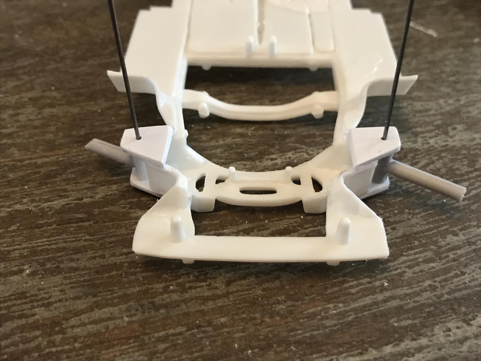

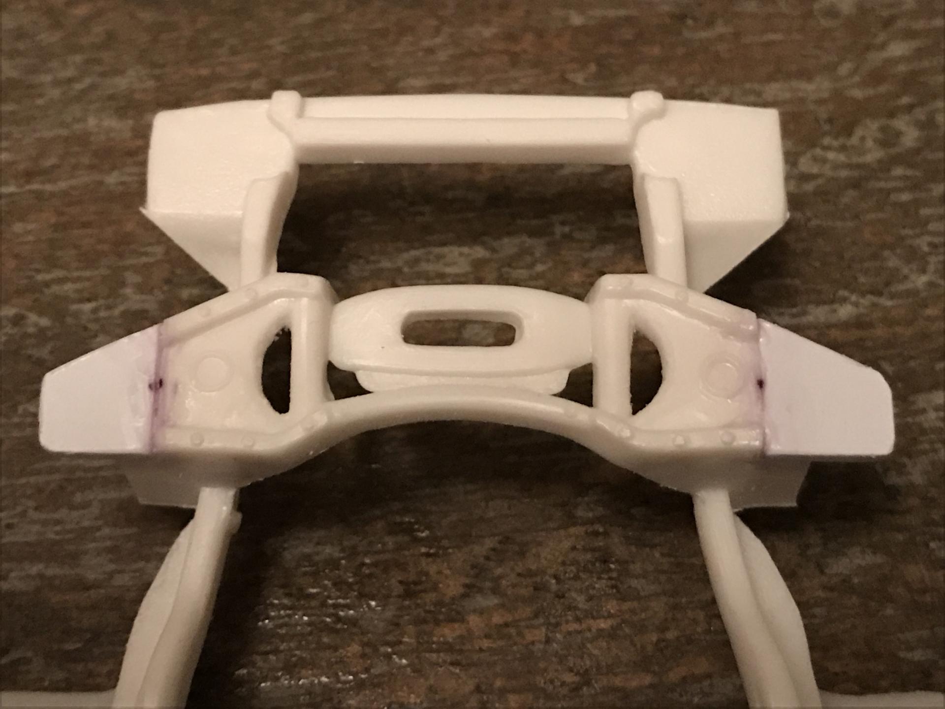

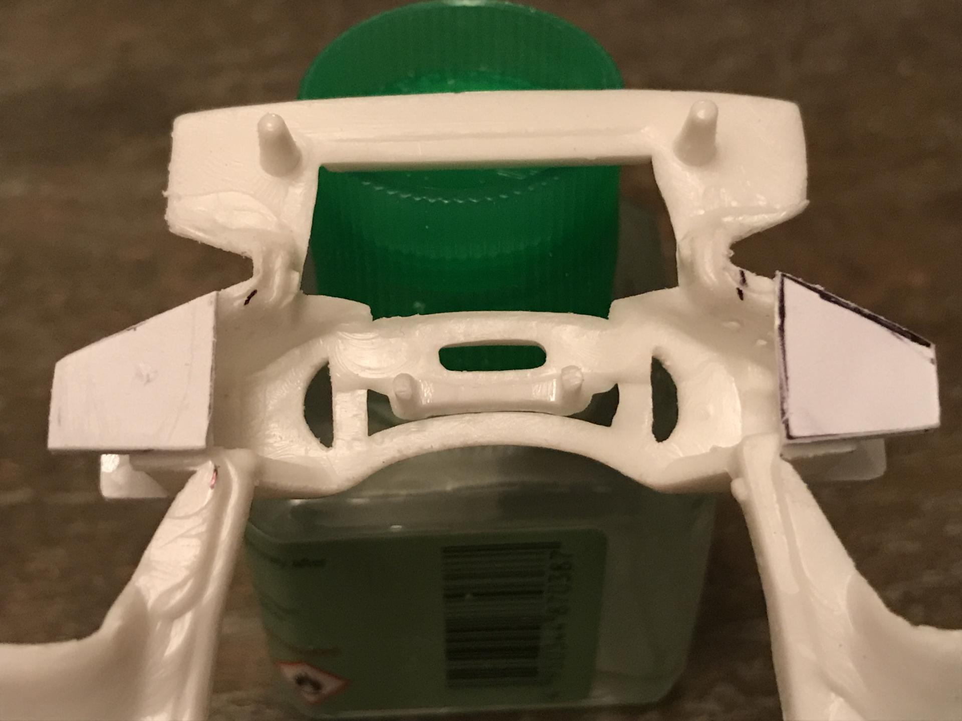

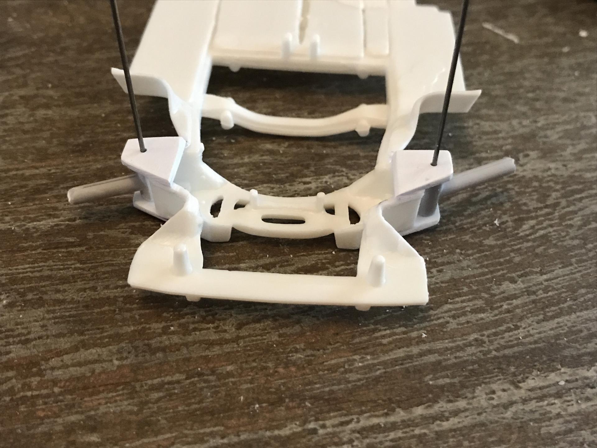

  16. I have begun work on the posable front end. @Can-Con helped me with a few pictures of his recently completed C10. I am following his general idea on the front end. I will be making the spindles next and the center link. I think I can detail the control arms a little better as well.

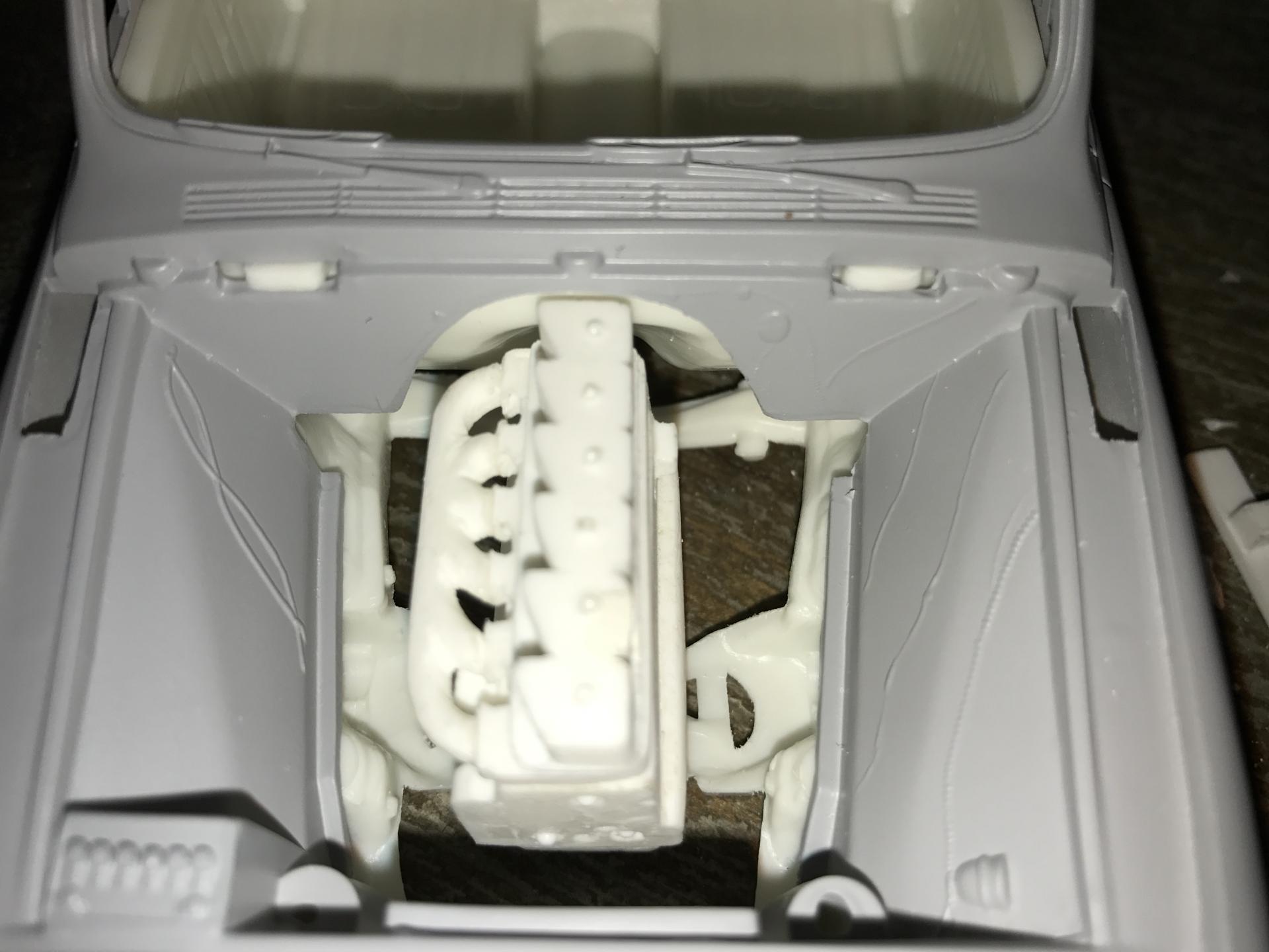

  20. The inline 6 Cummins fits well actually, and shouldn't have any trouble making an intercooler fit. I did turn the oil pan to rear sump configuration, the fit is much better that way

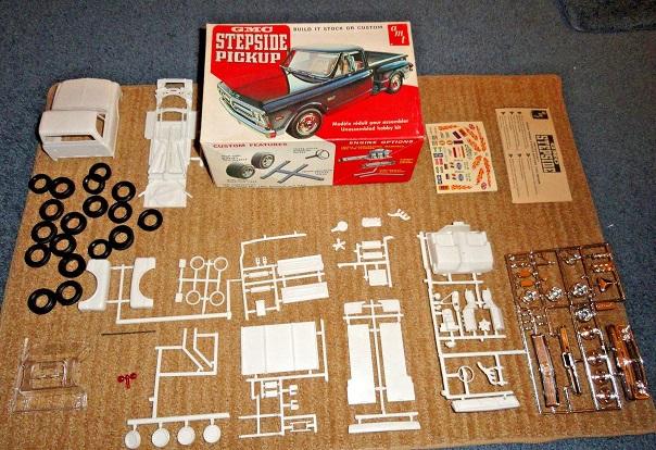

  21. thanks. A dually would be a cool build. These kits are expensive. I paid 60 for the one in the very first picture off eBay. The body is pretty straight.

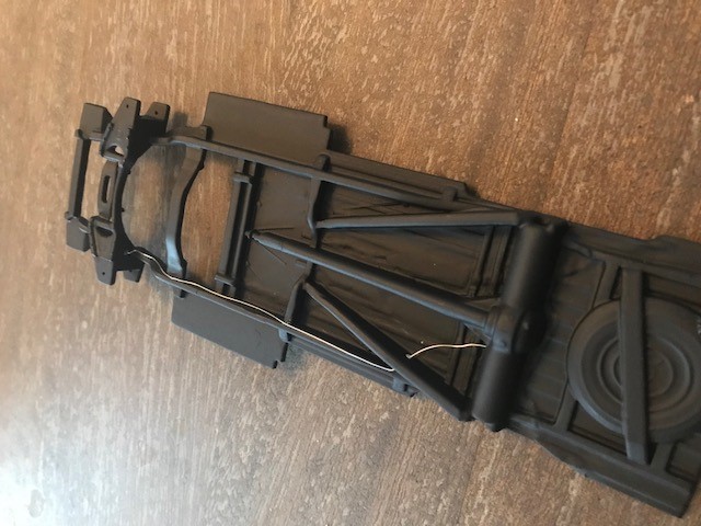

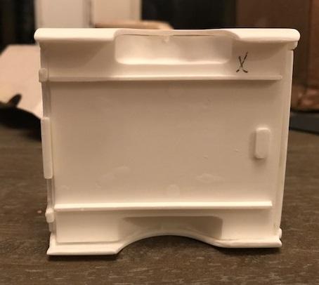

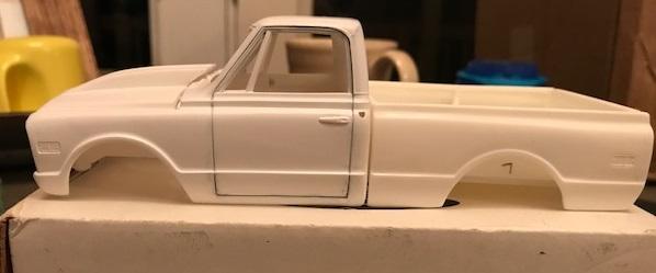

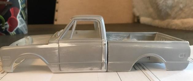

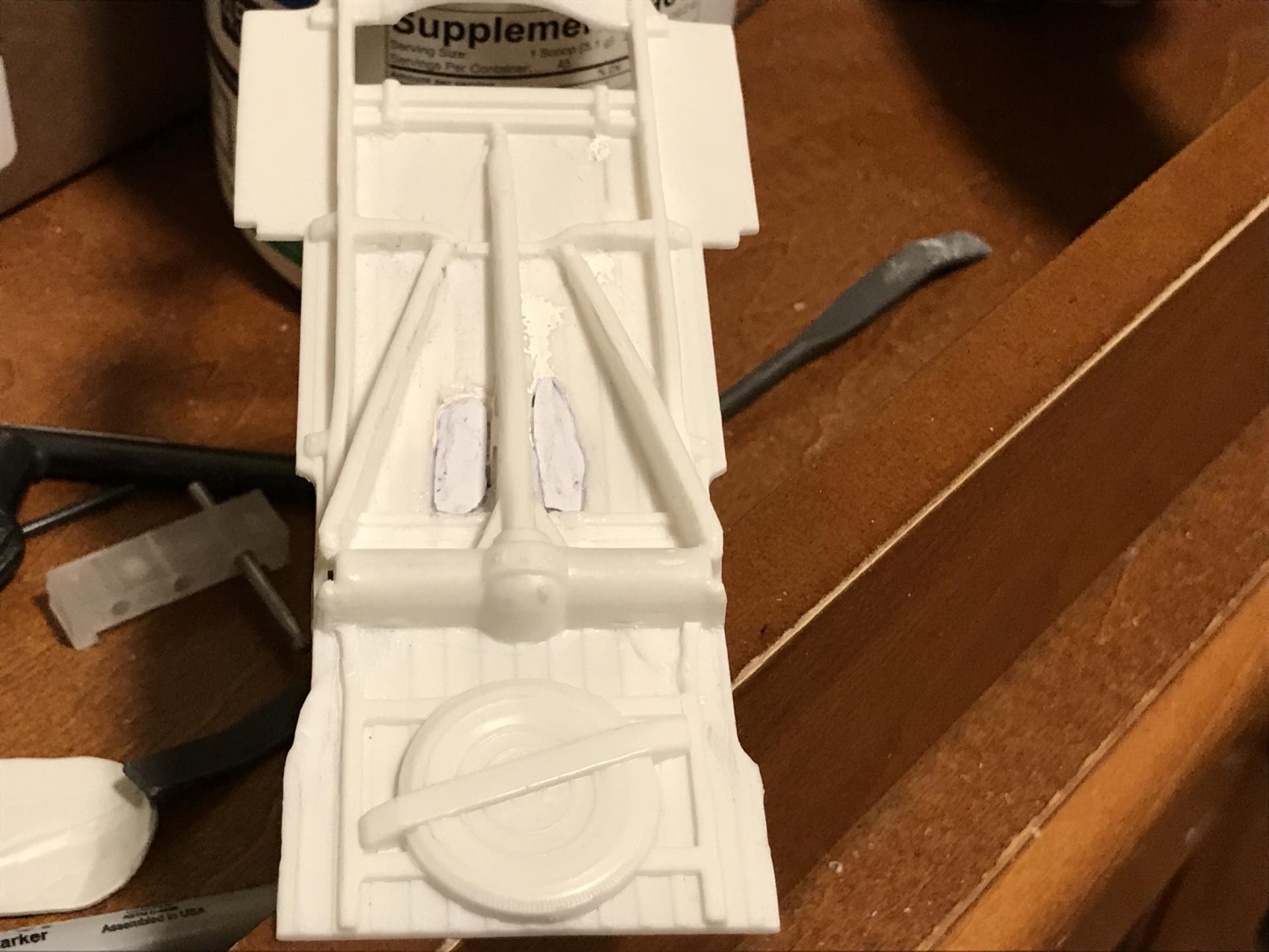

  22. This is my attempt at a 68 SWB Chevy truck, using the AMT kit as a starter. I have the bed from Bandit and am happy with the fit and ease of assembly. I have a Cummins motor from Trailer trash kustoms that I will be attempting to stuff under the hood. I know its not a likely build in reality as it is a 1/2 ton frame and the Cummins motor is simply too heavy for a stock 1/2 ton frame, but none the less would make an awesome 1:1 truck done right. The Cummins motor is a front sump oil pan so clearance could be an issue, we shall see. If the Cummins doesnt work out, I will be putting in an LS motor of some sort. So far I have only gotten the cab and bed prepared and layed down some primer, checking body work. I have attempted to enhance the body lines (Doors and Drip Rail) and applied Tamiya Black Body line accent color. I have opted for a stock 67-68 hood versus the cowl hood for now, as aesthetically it looks much better. I want the front wheels to be posable as well. This will be a slow build as I want to take my time and bring out as much detail as possible. Any suggestions are welcome.
