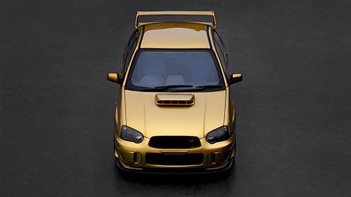

  1. "Nano Gold" WRX The rest later...someday...
  2. People appreciate only what they are interested in and see only what they want to see. Therefore, they do not see the difference between these. But here's 40-60 hours ... building and sharpening. And everyone passed by this model, but I believe that I have almost completed the main task of modeling - the model is perceived as a real car. But nothing can be done, as they say - "You can't be cute by force." I hope it’s clear, because I don’t speak English.
