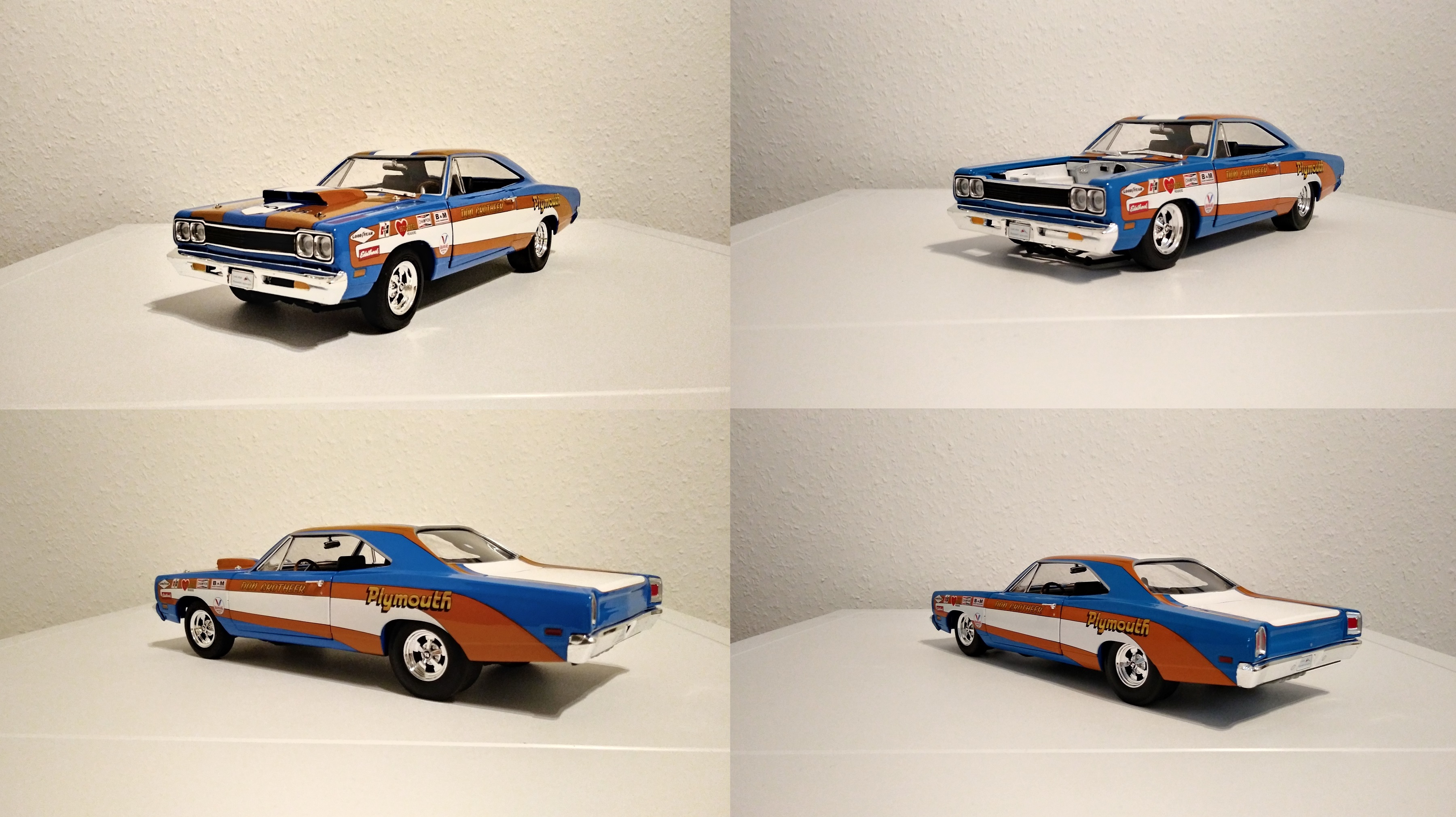

Continue here with the hood. The old chunky hood pins were removed and spackled. After painting in silk matt black, new hood pins were installed from the Tremonia Racing Set. -

The polish was done with the proven Meguars 3-Step products. Several passes were applied by steps 1 and 2. Only at Step 3 one passage was enough. All in all it took about 6 hours but it was worth the effort. And if you consider that I have painted only from the tin, the result can be seen. -

This was followed by 3 layers of silver and 4 layers of clearcoat. Then everything was allowed to dry for 7 days and the actual work was done: sanding and polishing. All grinding operations were wet. Starting with 2500, then 3000 and final 5000 sandpaper. The surface now looks dull and milky but that's exactly how it should be. -

I used today's day off to complete the paint job. Two layers of primer were used, each wet sanded with 3,000 and 5,000 sandpaper. -

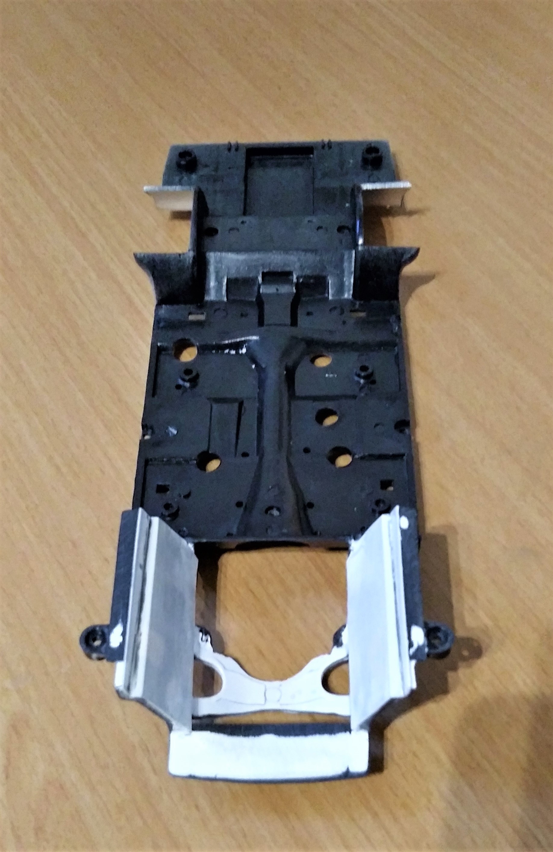

I started with the sidewalls, which were straightened. The spare wheel was flown out and the bracket was sanded off. The new side walls and bottom plate are made of 0.5mm polystyrene plates. After plenty of sanding, the floor was flocked, everything thoroughly sanded, primed and painted. -

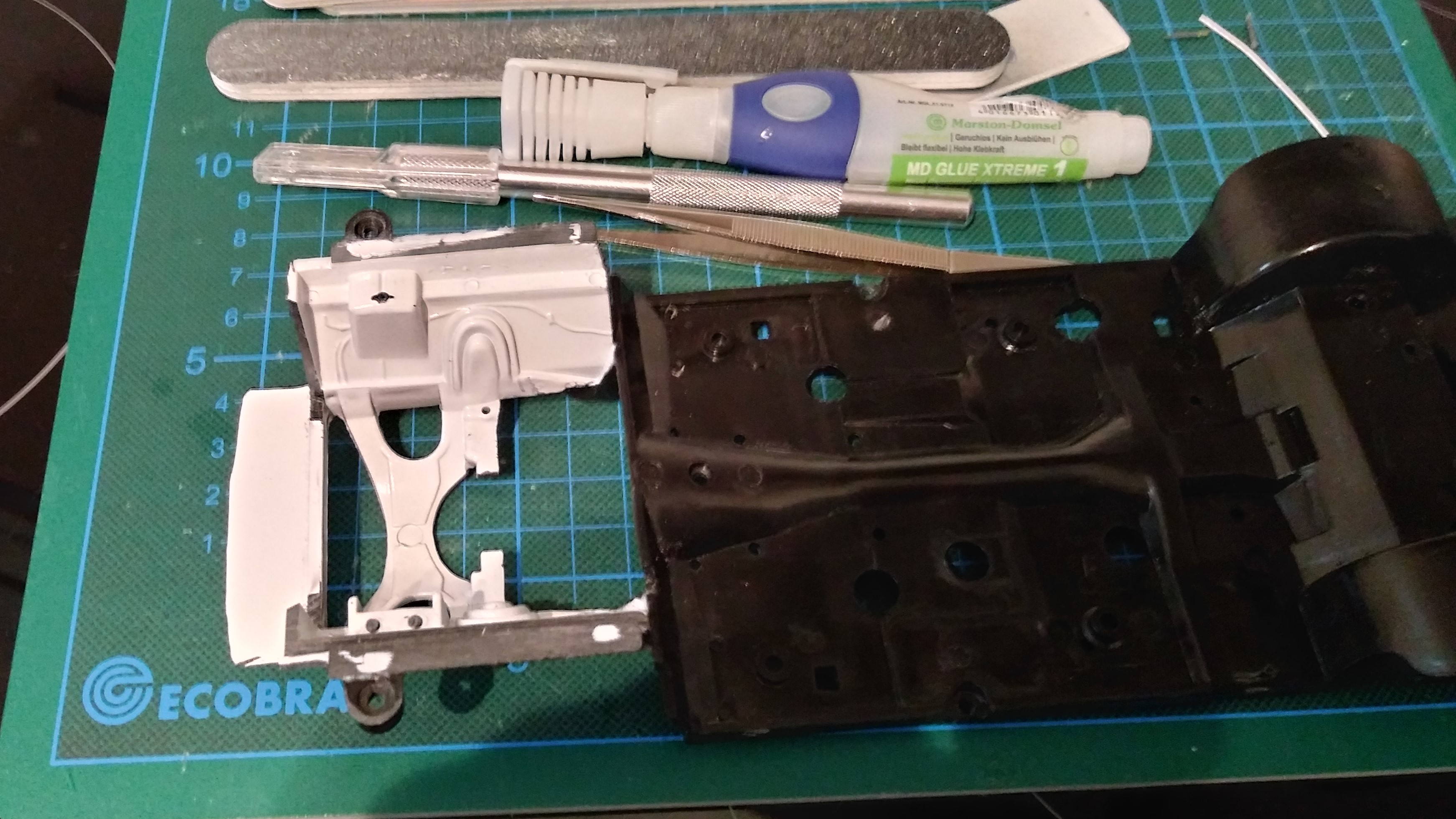

The engine bay has been completely redesigned. The original looked very modest and poorly made. The sidewalls were cleared of the battery holder and the fountain solution tank. Then everything was sanded smooth and covered with 0.5 mm polystyrene plates. Finally, the areas of the strut tower were also made from polystyrene. In the middle there was an M1.2 thread: -

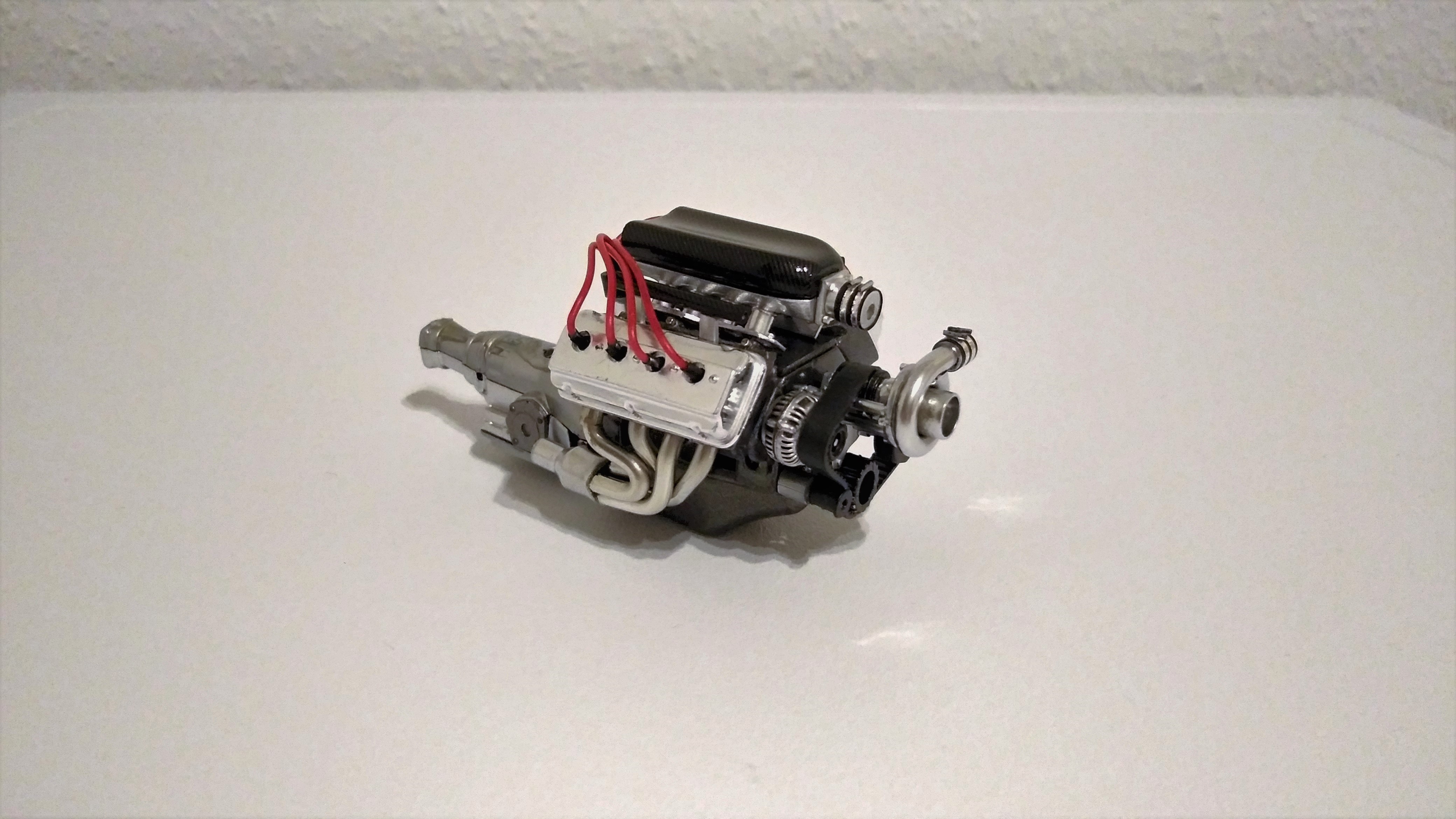

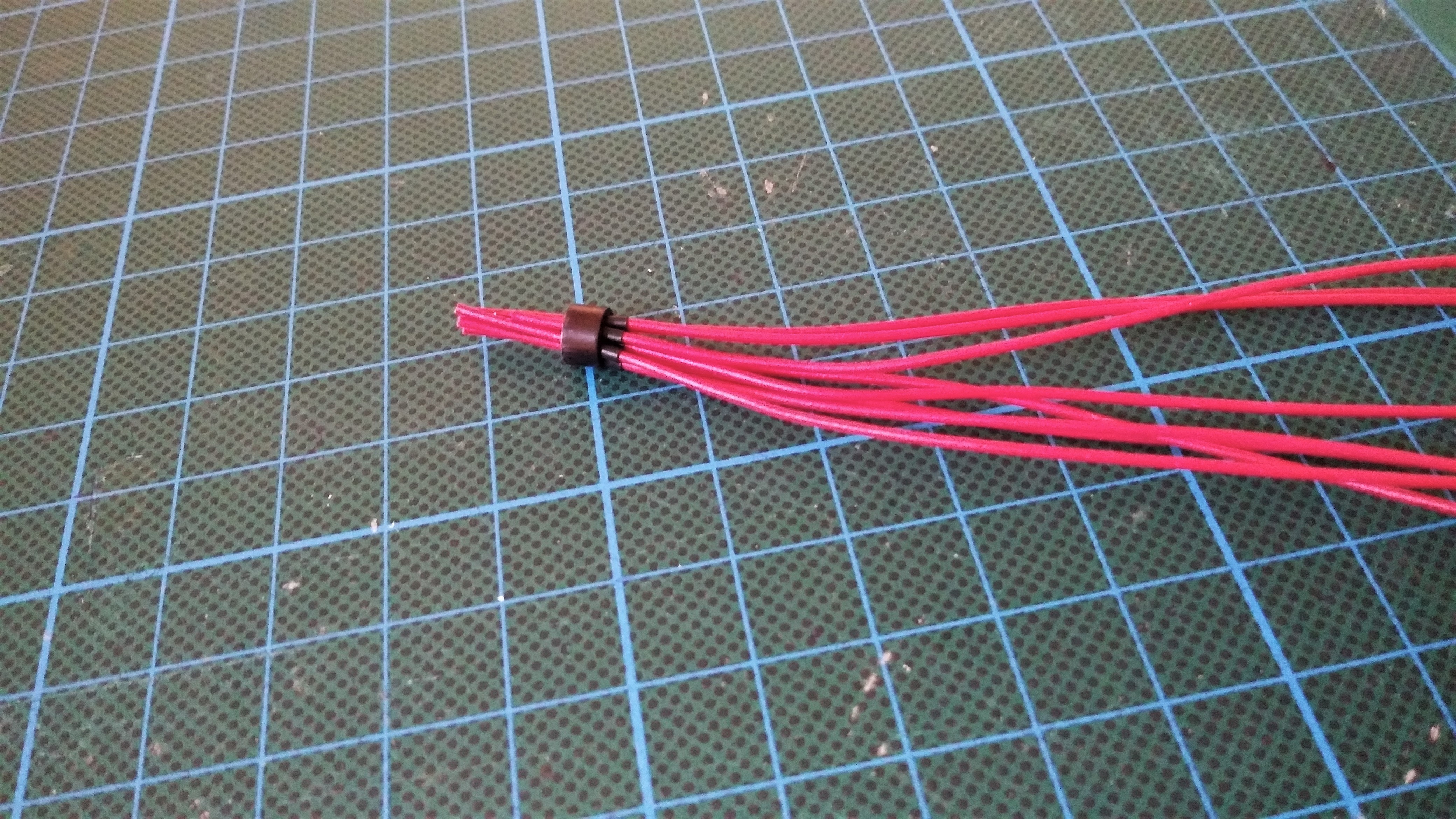

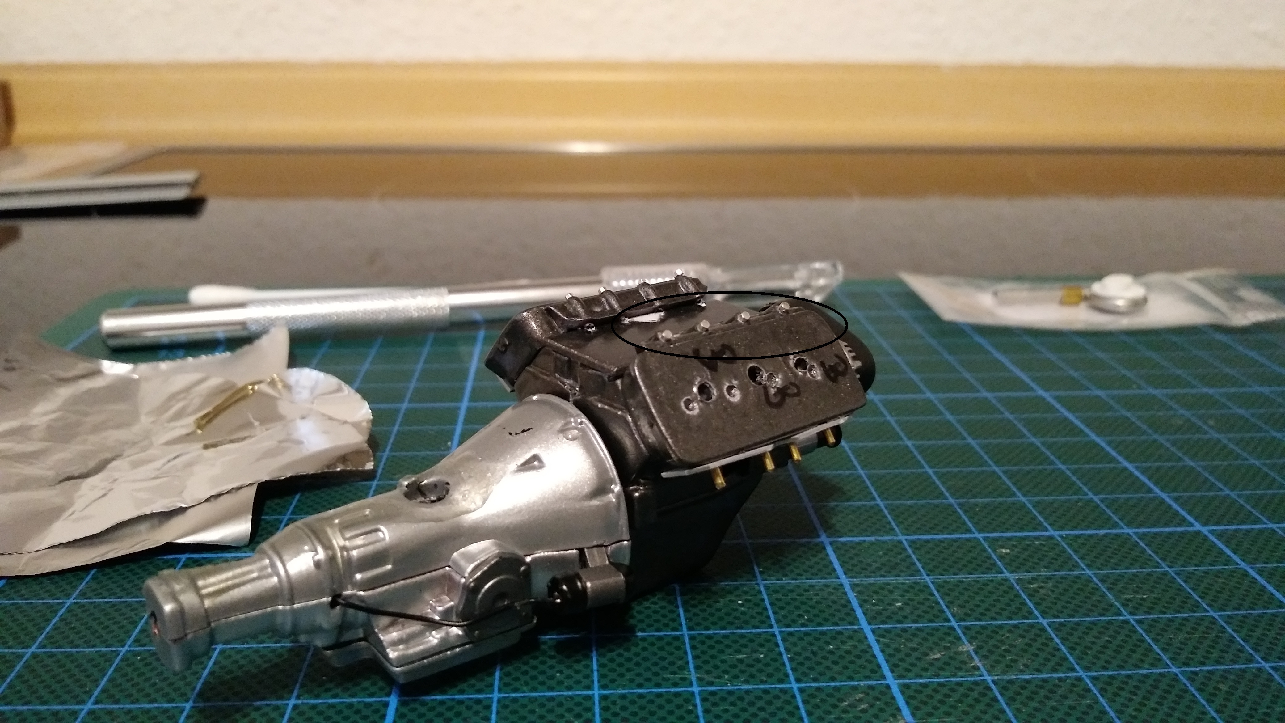

The engine has largely finished today. I have built a new ignition coil including cables. The ignition plugs are made of insulating tape (so it does not come loose: apply a small amount of superglue on the ends). -

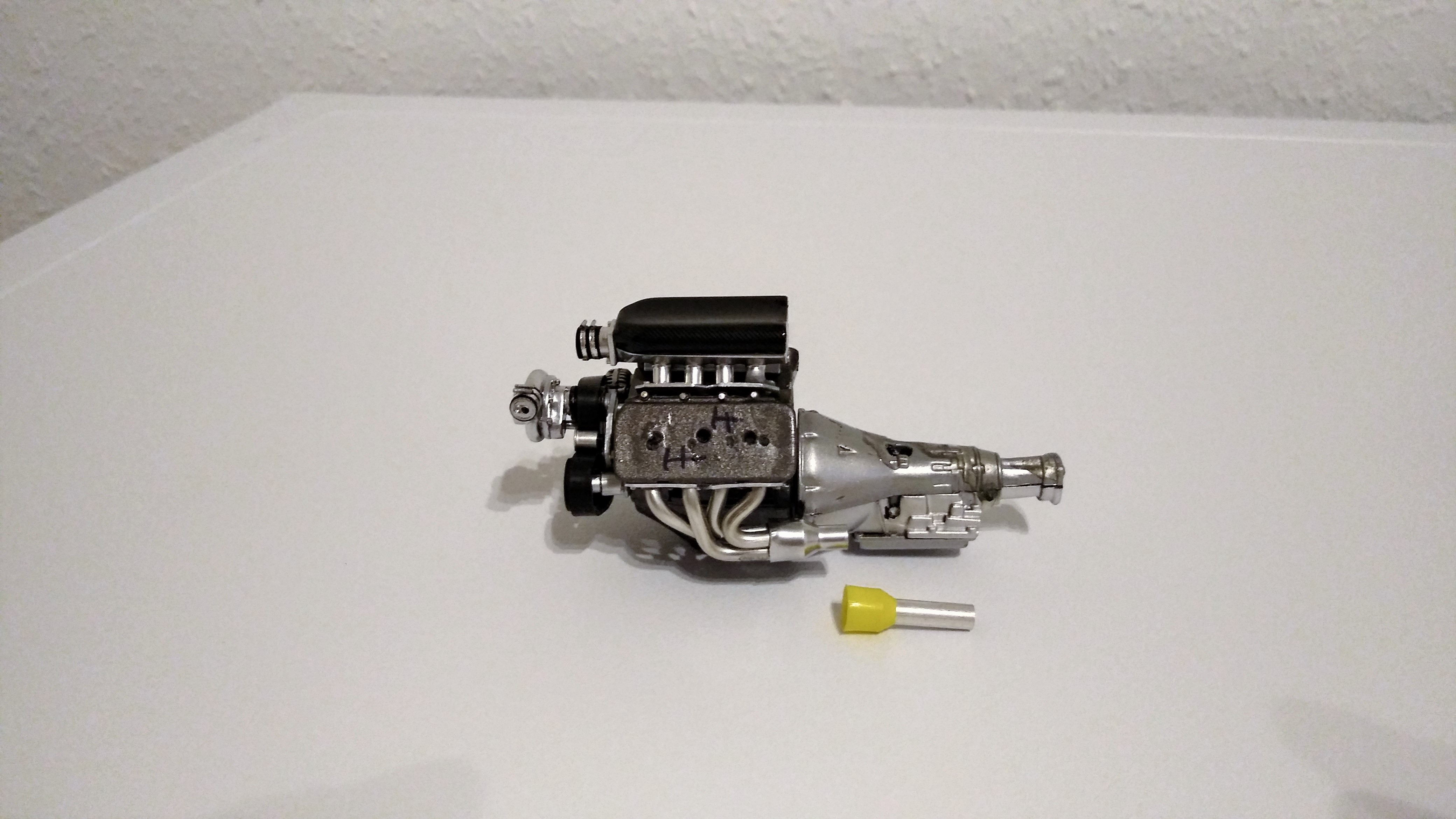

After the fourth start and 3 evenings, the manifolds are now under the cylinder heads. The procedure or materials are the same as for the Viper engine: the pipes consist of 3mm fitting solder and the collector of a wire end ferrule. I'm not completely satisfied with the result, but everything stays that way now. -

I`m using decal foil from Belkits, Softer and top coat from MrHobby. -

The Pro Charger had time to dry overnight and was installed today. The throttle valve unit was also mounted to the air intake housing (again with M0.6 screws). The hose clamps consist of a strip of insulating tape, bare metal foil and wire. -

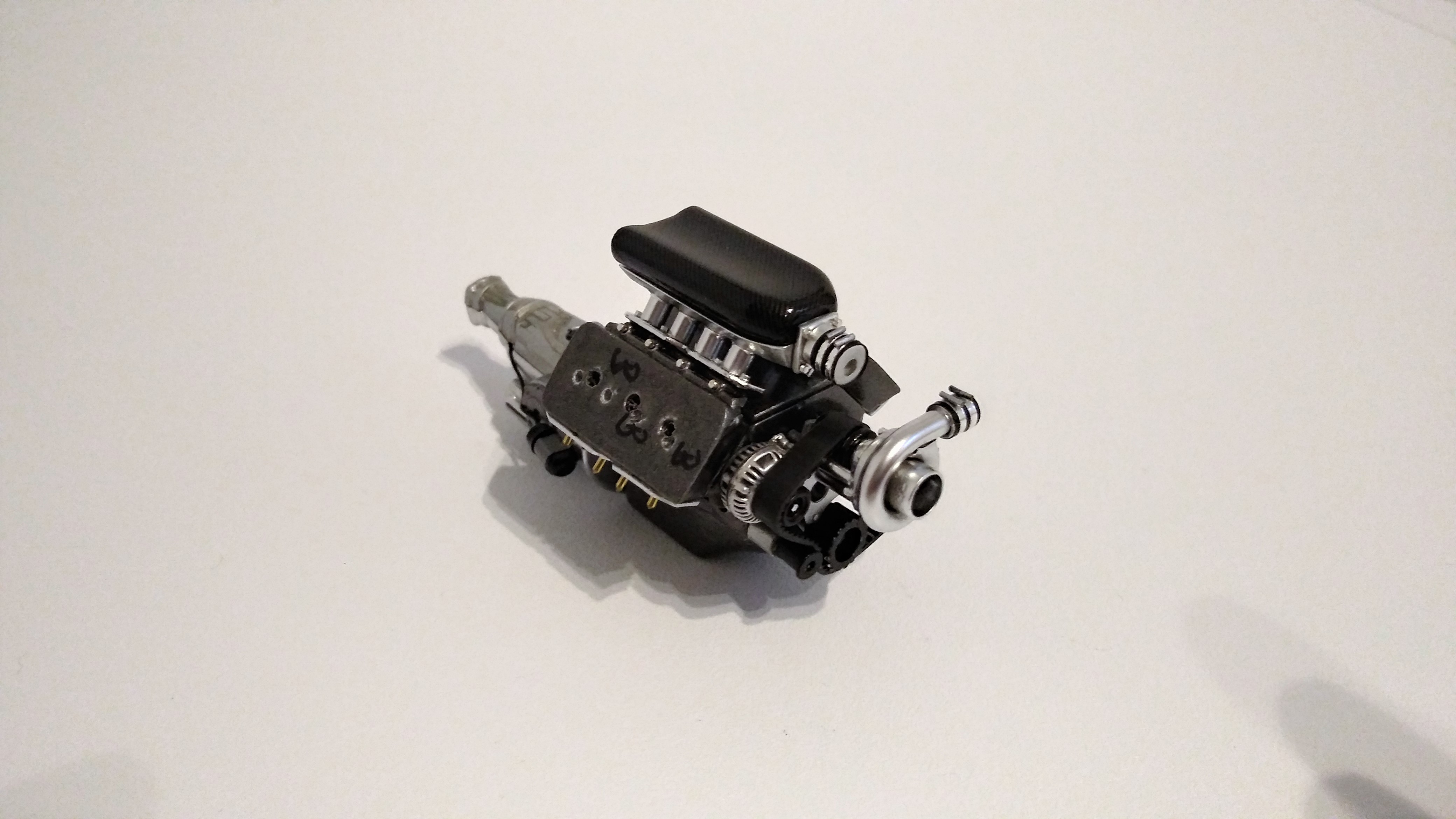

The base plates of the air intake pipes were then equipped with the 0.6mm screws. Subsequently, the air pipes were painted in polished aluminum and the air intake housing attached. -

The cylinder heads have also received on the top and bottom of the small M0.6 screws. To see how small the screws are, I put a cotton swab next to it.
