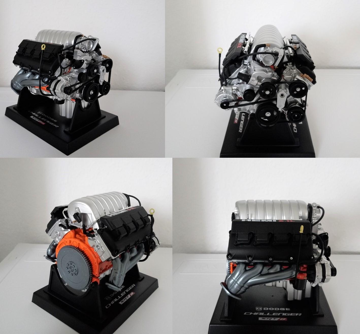

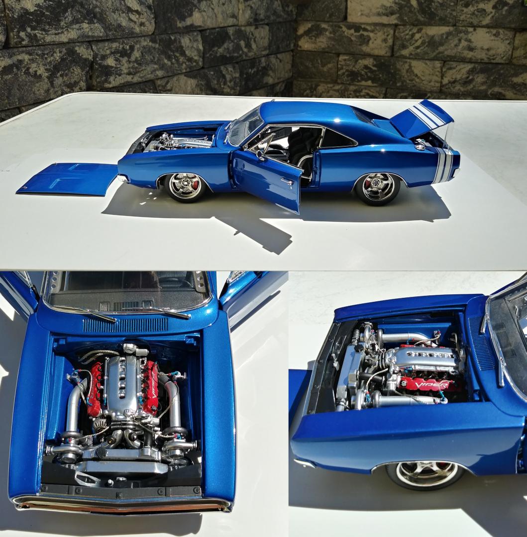

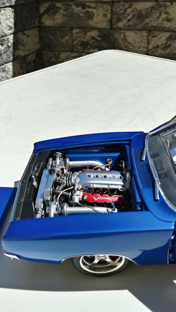

Hello everybody, After a long absence, it is time to present my latest build, with which I have fulfilled my personal model building dream. Anyone who knows my conversions will surely know that my passion is American classic cars with modern engines. For my project, my choice was the 6.1 liter Hemi from the manufacturer Liberty Classics (as a Mopar fan, I was very happy ) Various companies such as Steve Morris Engines, Nelson Racing Engines etc. served me as a model for the turbo conversion. In real life, my finished engine could be in an engine manufacturer's or tuner's showroom. In terms of the level of detail, I tried to go as broad and deep as possible, which sometimes succeeded more or less well because I work without technical assistance such as 3D printing or a lathe. With a bulding time of over 5 months, this was my most time-consuming conversion to date, which was a lot of fun for me (and my eyes) due to the large scale. Below you can see pictures before and after the build.

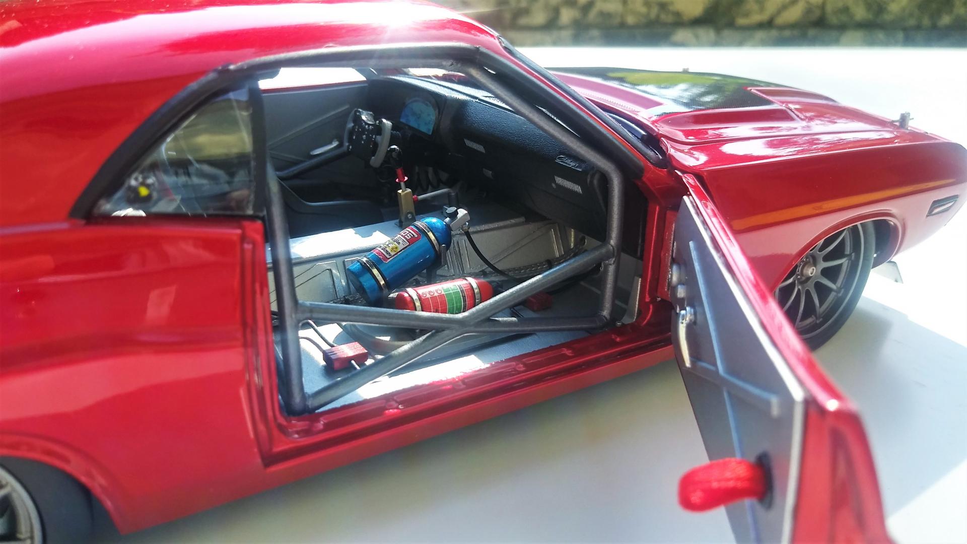

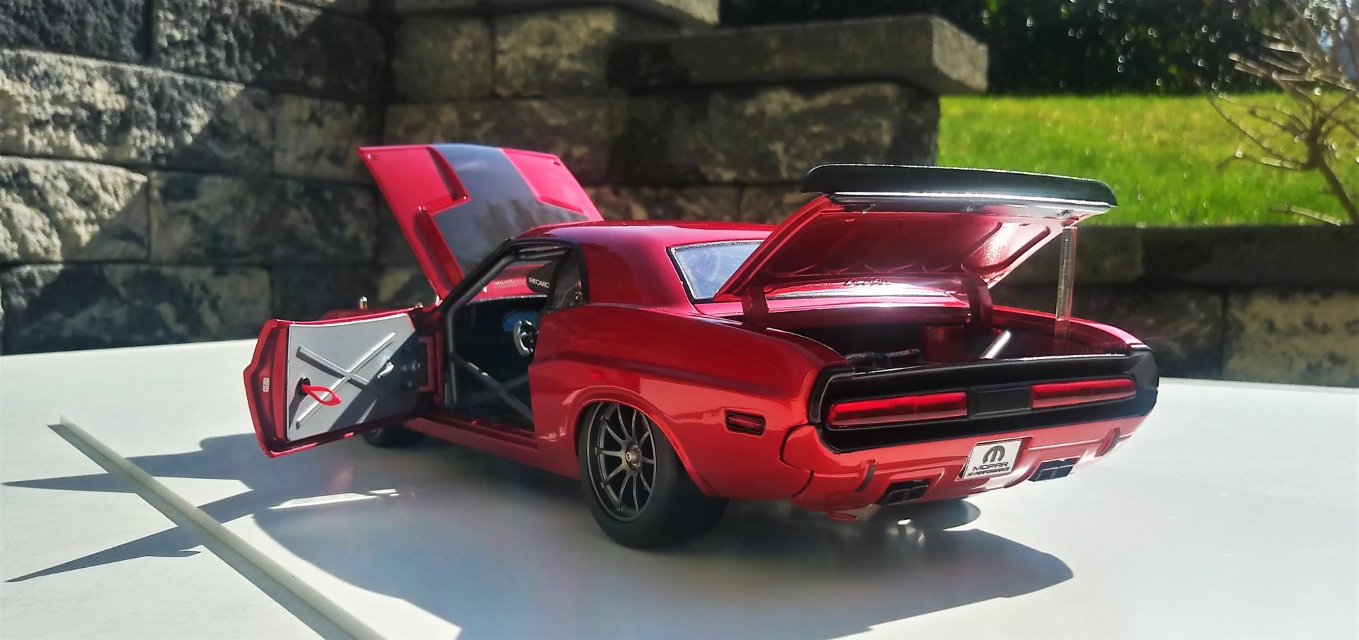

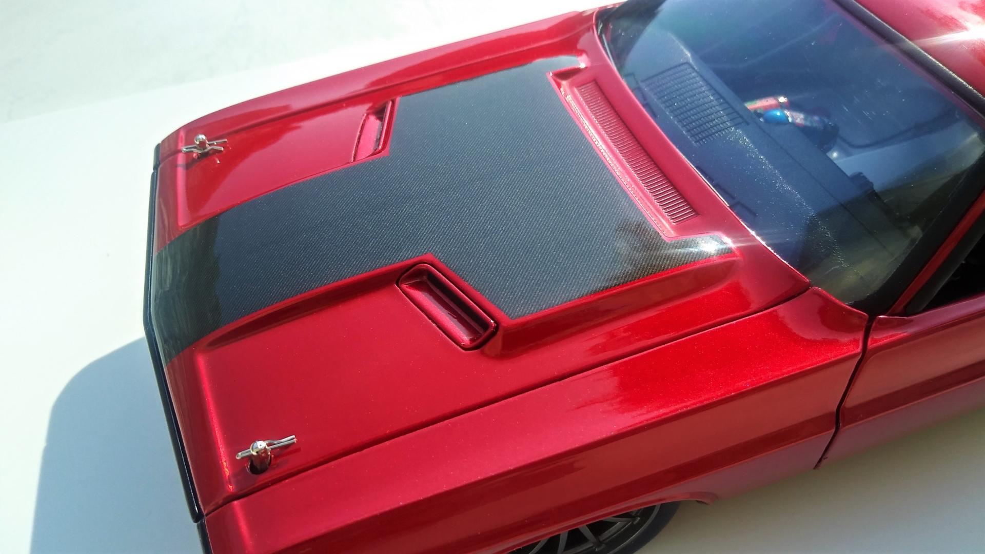

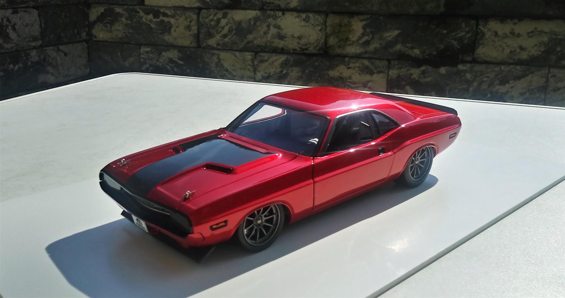

After 3 months of building, this project ist completed just in time for the sunny weekend. The idea behind the model was to rebuild a classic (Mopar) muscle car with modern racing technology or to bring attachments, materials and components on the current state of the art, however, the optics should largely correspond to the then time. The conversion report can be found here (its a german forum but you don`t have to register to read the articles): https://www.modelcarforum.de/showthread.php?t=39193

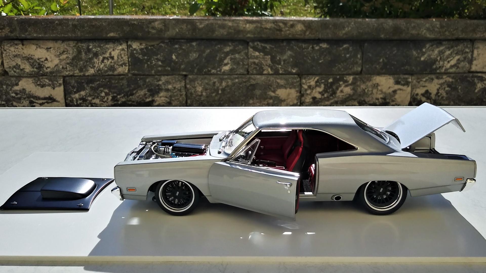

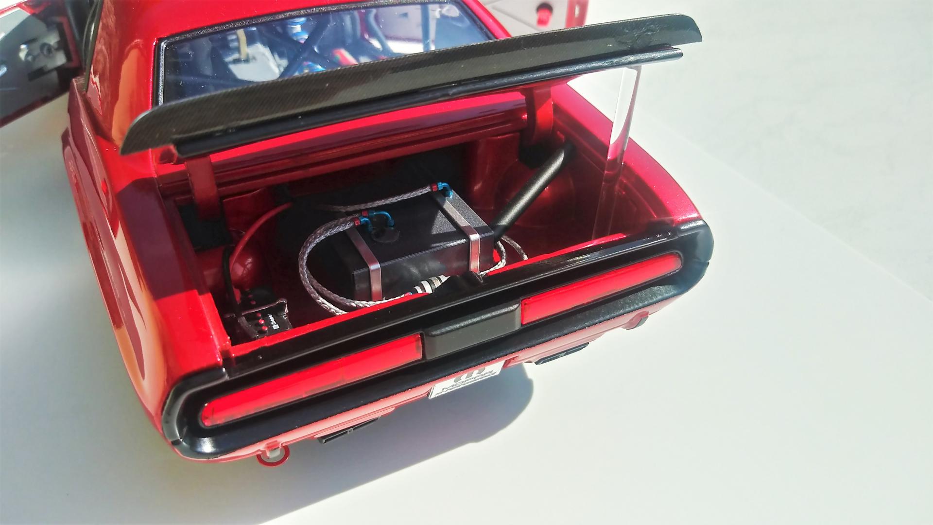

This small rocket has been finished since the end of December and slept in the showcase until today. After seeing the sun in the last few days, I was able to make pictures of the finished model outdoors in the sunshine. The real role models and the associated conversion report can be found here (its a german forum but you don`t have to register to read the articles): https://www.modelcarforum.de/showthread.php?t=38903

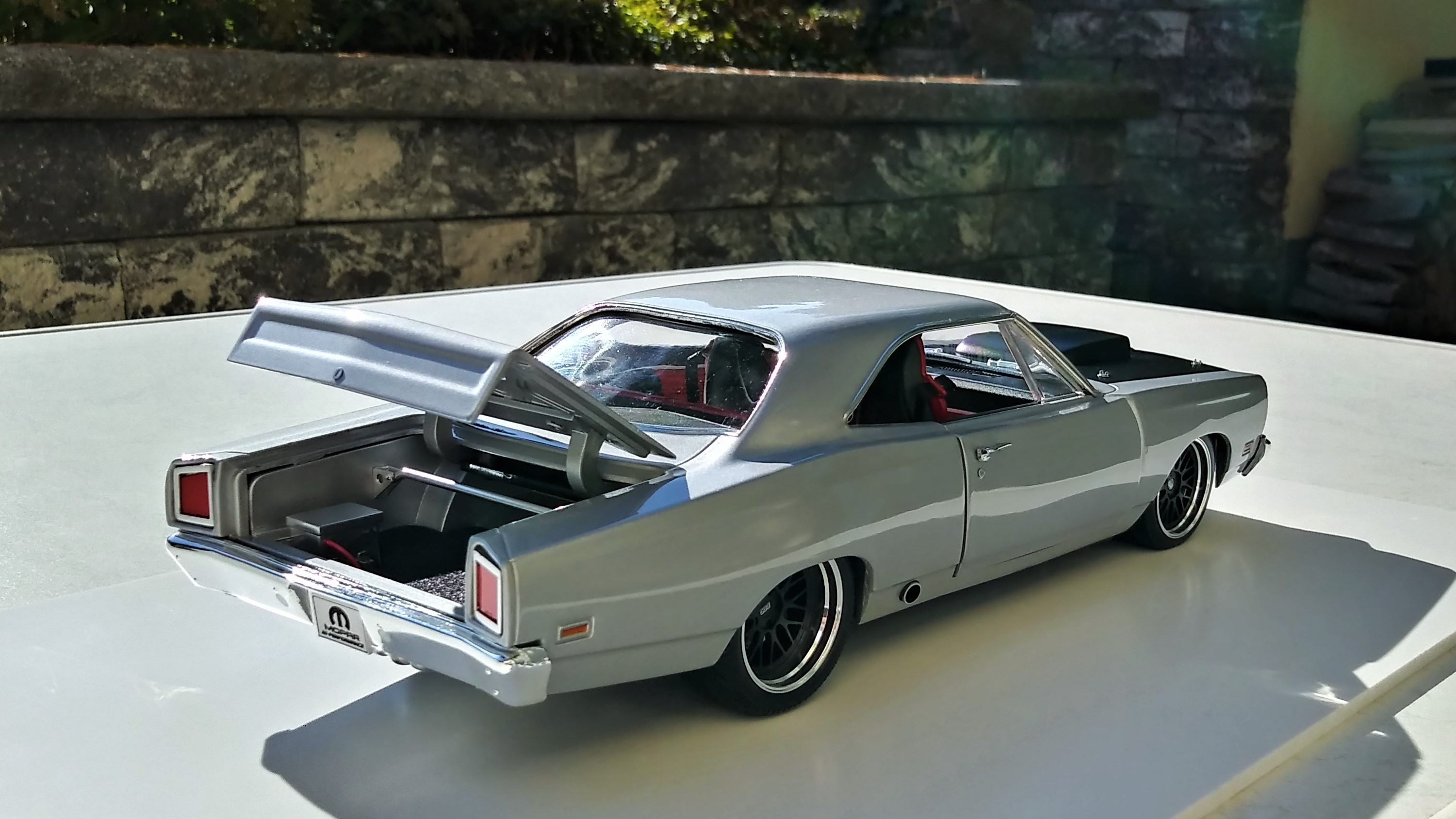

After almost 3 months of building, this project is finally finished The model was the 1969 Plymouth Roadrunner from AutoWorld. All in all, this conversion was really fun for me, even if the quality of the original vehicle leaves a lot to be desired. You can find the complete conversion report here: I start with a picture that shows the original condition and then some pictures of the reconstruction.
1969 Plymouth Roadrunner pro charged

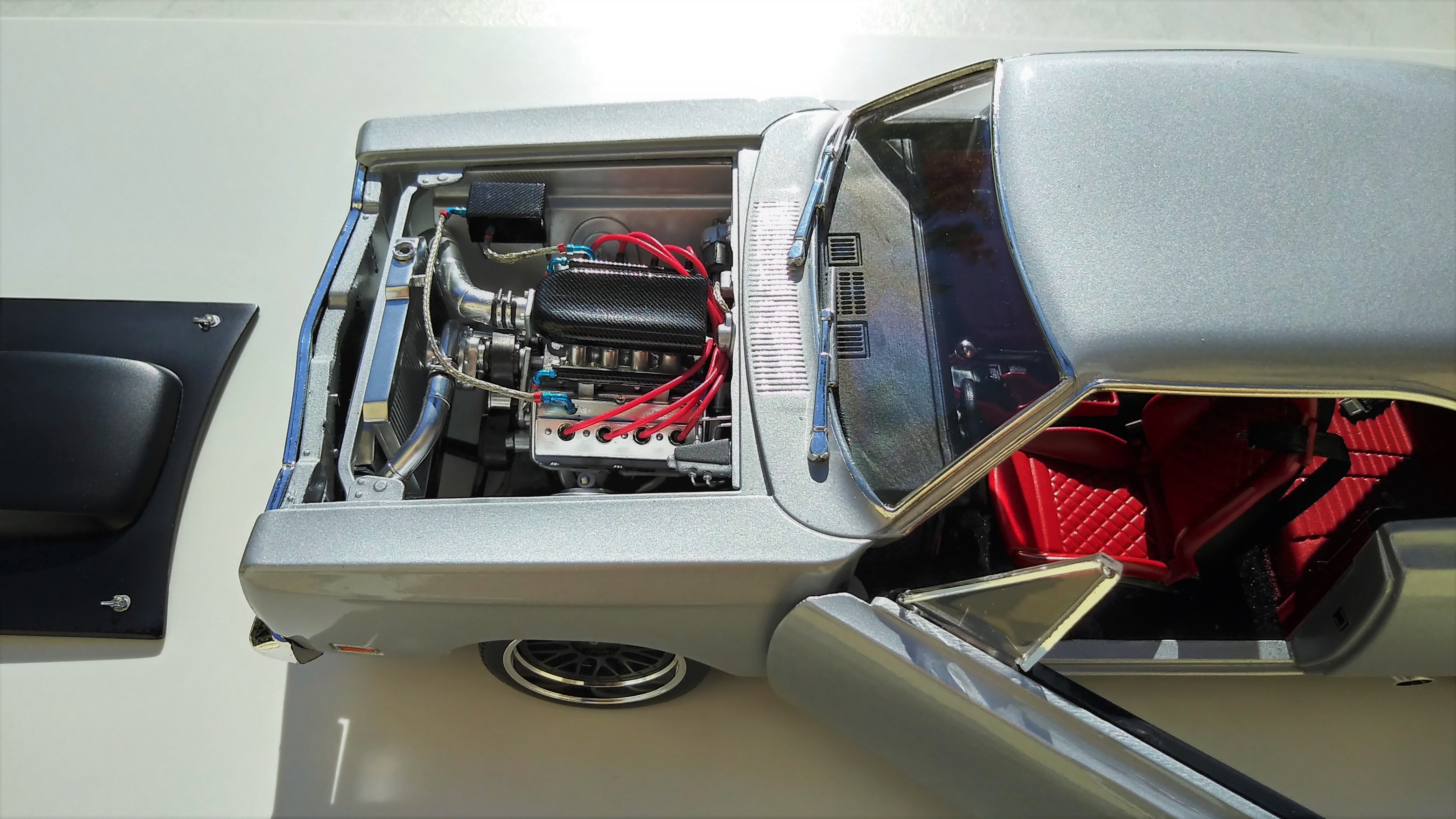

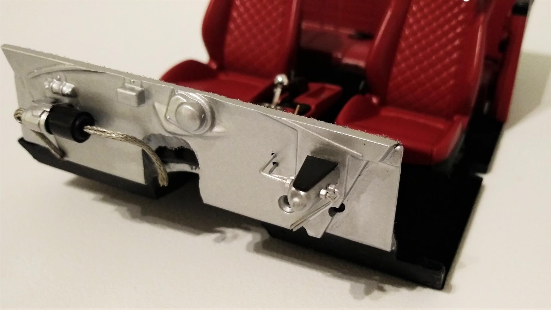

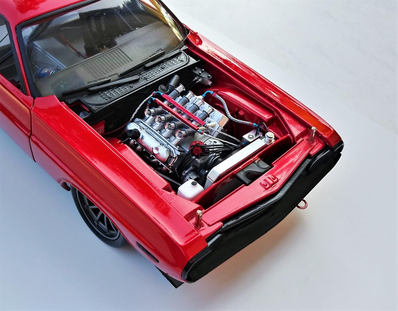

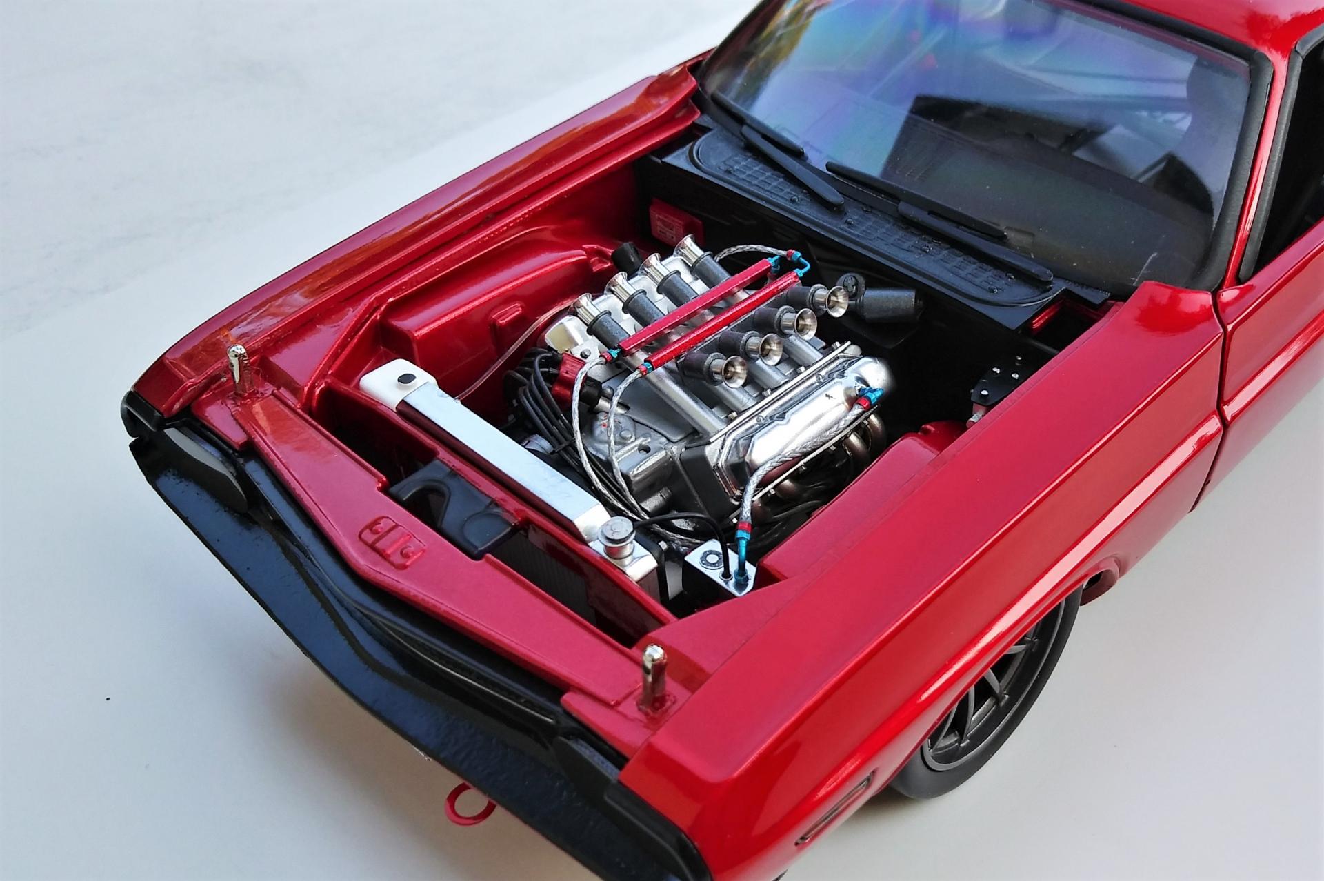

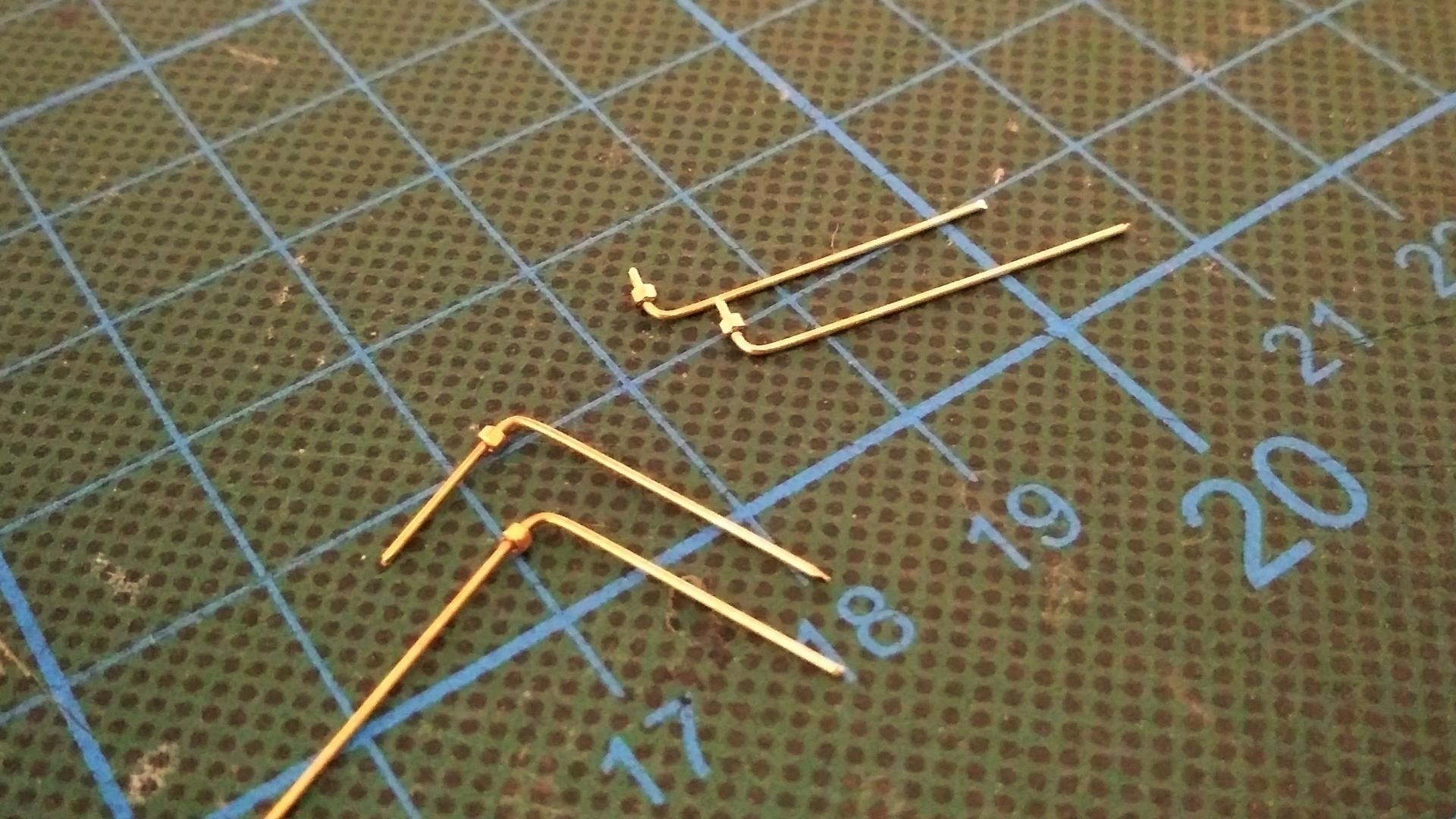

The last details in the engine bay are ready. From nuts M0,8 and brass rods 0,5mm I simulated the hydraulic lines of the brake booster. Even a massive fuel pump has taken place at the firewall. -

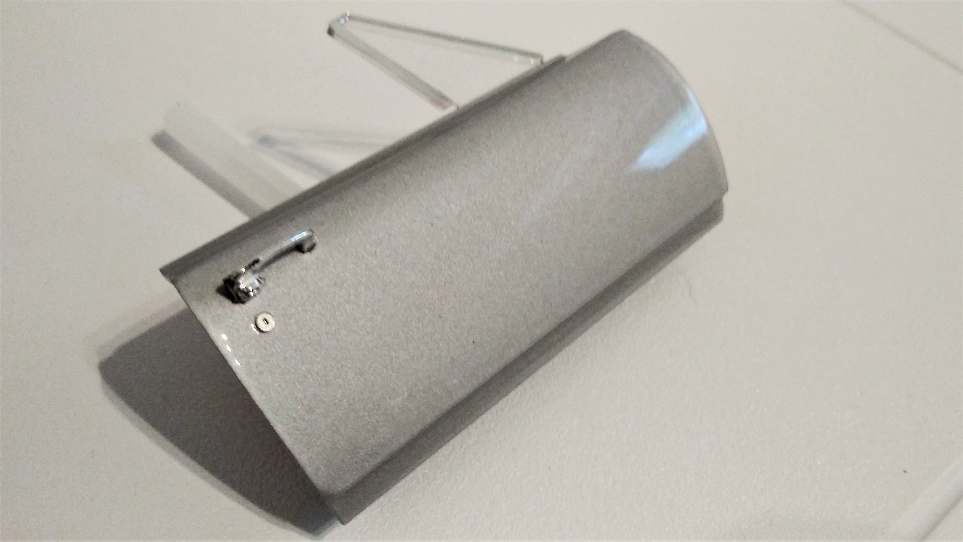

Next, the window frames were recreated with bare metal foil. The side indicators were made of small pieces of this foil, which were colored with Tamiya Clear Orange. At the BMF I used the variant New Improved Chrome. This is much better compared to the Ultra Bright Chrome.
