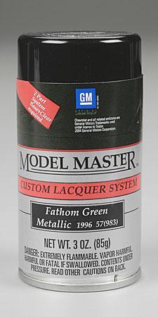

  5. OK I'm back for more questions. I found Testors MM Fathom Green Metallic (p/n 28120) and know that it's Acrylic Lacquer. I also found Testors MM British Green Metallic (p/n 2916) and know that it's just Enamel with no Acrylic. Which do you think is the darker color over white/black primer ? Do you think it's easier to work with a Acrylic Lacquer or straight Enamel as far as curing time and gloss finish ? I understand I can, after the paint cures, use Predge over it. I will be putting either paint over Rust-Oleum 2X primer, which is Acrylic Enamel. Thanks for any advice on this.

  11. I just received the answer from Rustoleum Here it is: Hi Richard, Thank you for contacting Rust-Oleum Product Support. Thank you for your interest in our Rust-Oleum products. Because you are using one of the lacquer spray paints a recommendation would be to use the Extreme lacquer in the 3 ounce spray by Testors. It would be the Blazing Black. The part number is 1832MT. We do not have a primer in the lacquer finishes. But you certainly could use the Blazing Black and then apply the Fathom Green Metallic.
  12. Thanks, really good to know. PS DupliColor is made by Rustoleum also.
  13. I just emailed Testors, which I found out it is owned by Rustoleum. I asked them what combo I should use and am waiting for their answer. I will let you know what they say. This is the paint I want to use.
