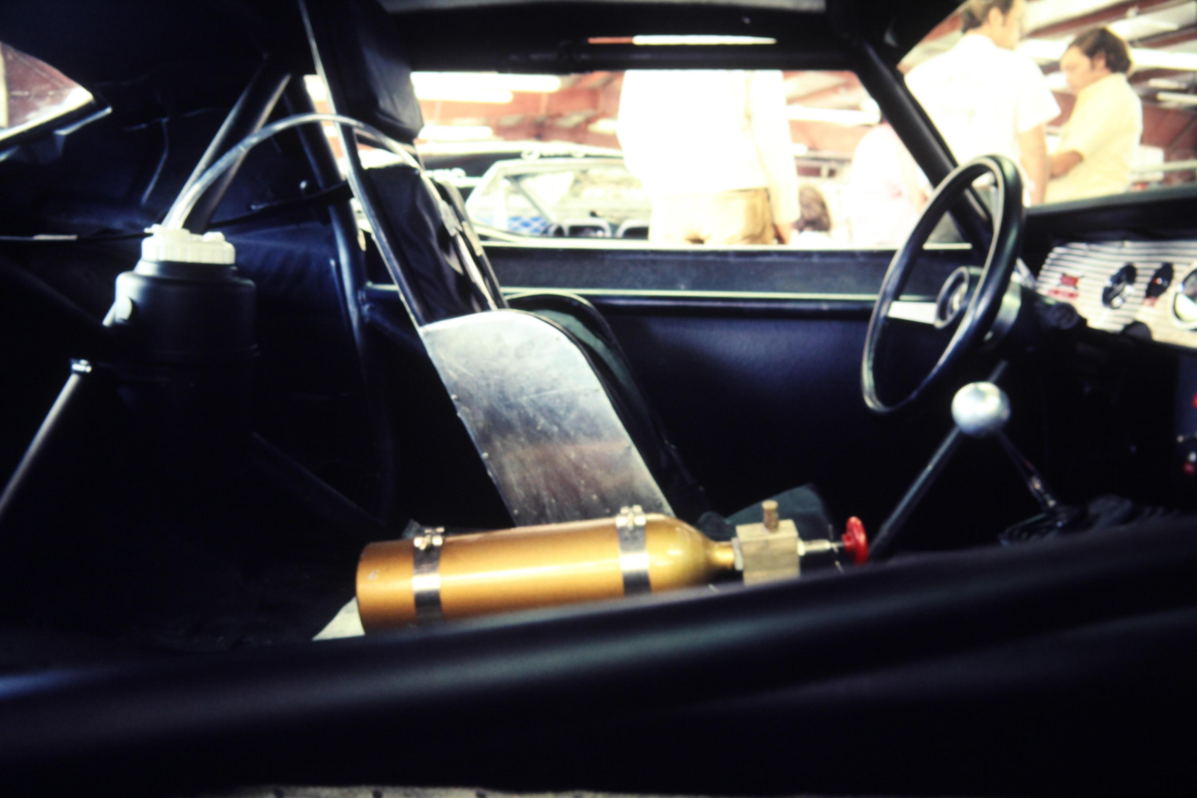

In reply to Swede70's comments about the seat on the Tempest, I don't have a picture handy, but here is a picture of the 1972 Firebird showing the seat that was built by Herb Adams from steel tubing and sheet aluminum with simple padding made of foam that was covered with black vinyl upholstery material. The original Tempest seat was very similar.
