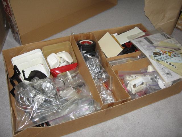

Got a great parts stash of Big T parts from an estate sale. To my surprise, it included most of the Drag Race accessory set and the bonus, a Competition engine from the Chevrolet V8 Engine kit. Looks like there's enough to do a variation of the Big Drag. Shows that the stuff's out there. Dan

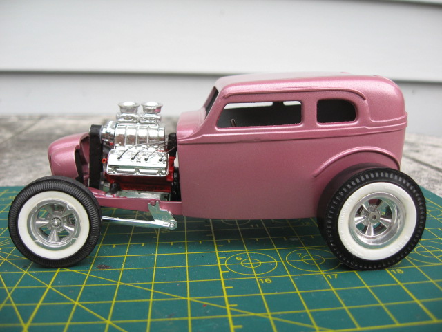

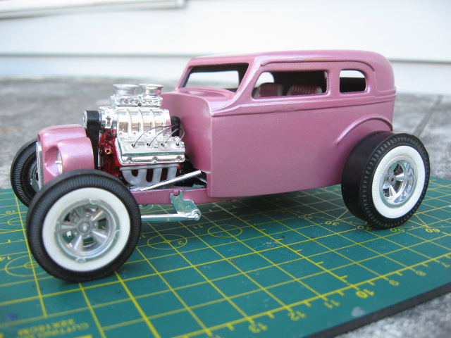

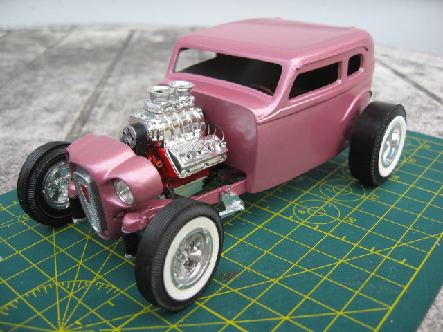

Finished off with these last details. - trimmed a windshield from .020" PETG clear plastic with a painted flat black surround and spot glued in with UV-cured glue - simulated front springs with thin solder wire - attached light lenses at the back and a licence plate and holder (unknown origin) l Still can't find the L'il Coffin suspension shock absorbers so will adapt some from the parts bin. Pleased with the results after such a long time. Dan

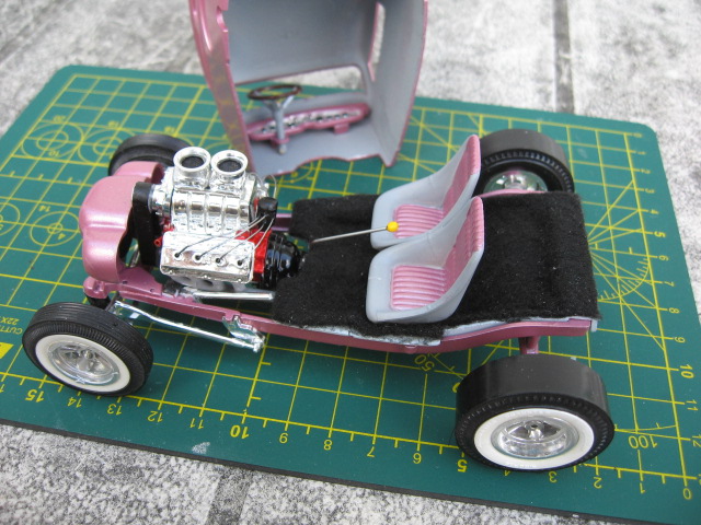

Covered the interior tray floor with adhesive-backed black felt from the local craft store. Seats, dash and steering wheel are of unknown origin but look appropriate. Gear shift is .032 piano wire and UV-cured adhesive at the end painted yellow. The steering linkage interfered with the exhaust header (unknown origin) and engine mount but worked out after some grinding and hot knife work. I'm missing some of the original L'il Coffin's front and rear suspension pieces but I think what's there is good enough for me. Pretty much done. I'm really pleased the 50 year stored parts are together and represent what was in my thoughts so long ago. Now to build a slot car version. Dan

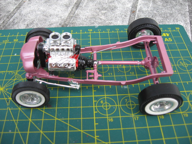

Got some paint on. Sprayed Tamiya TS-59 Light Pearl Red onto the body, grille, chassis, rear axle and drive shaft. Details done in red, gray, silver and flat black Tamiya brush paint. . Missing a number of front and rear suspension pieces from the L'il Coffin's chassis but this'll do for now. More engine work and then we're onto the interior. Coming along well. Dan

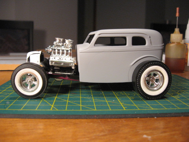

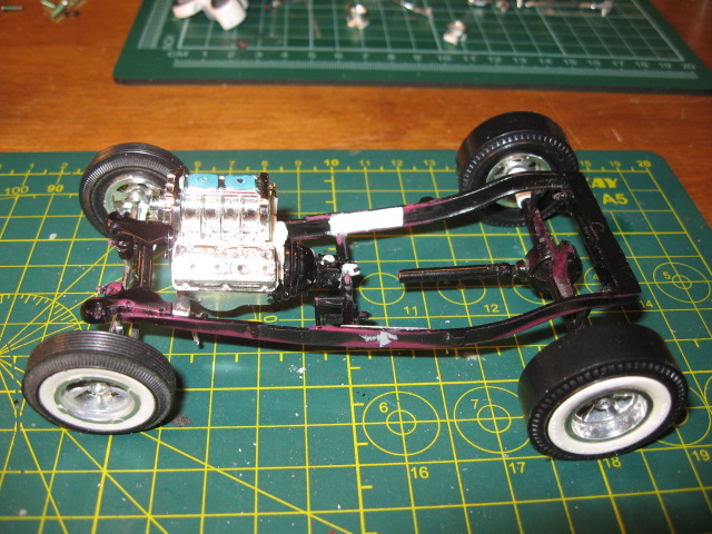

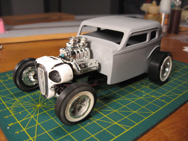

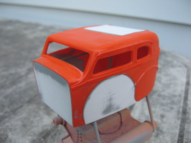

I've always wanted to build the Bantam coupe street rod as featured in Dennis Doty's article in Car Model magazine, November 1967. So after almost 50 years, I retrieved what parts I had collected from so many decades ago and started. First up was filling in the optional coupe body's (Monogram Sizzler dragster kit) wheel arches, firewall and roof with .040" sheet styrene. After many cycles of filing/sanding/spray primer, I got a reasonable body. I'm more of a slot car builder these days, so this was prepared as a master for a silicone slosh cast mold too. I've got visions of a bunch of these running on my three-lane wood track. The chassis as suggested by the article is from the old Monogram L'il Coffin show rod shortened 1/2" not the 3/4" as in the article build. Needed that extra length to fit my chosen motor, a Hemi of unknown origin. Body's test fitted and the stance is good for me. I modified the custom quad-lit grille from the AMT Willys/32 Ford kit into a dual for fit and a better look in my view. I haven't built a static car model in decades, so am pretty pleased with the progress so far. Dan in Canada
