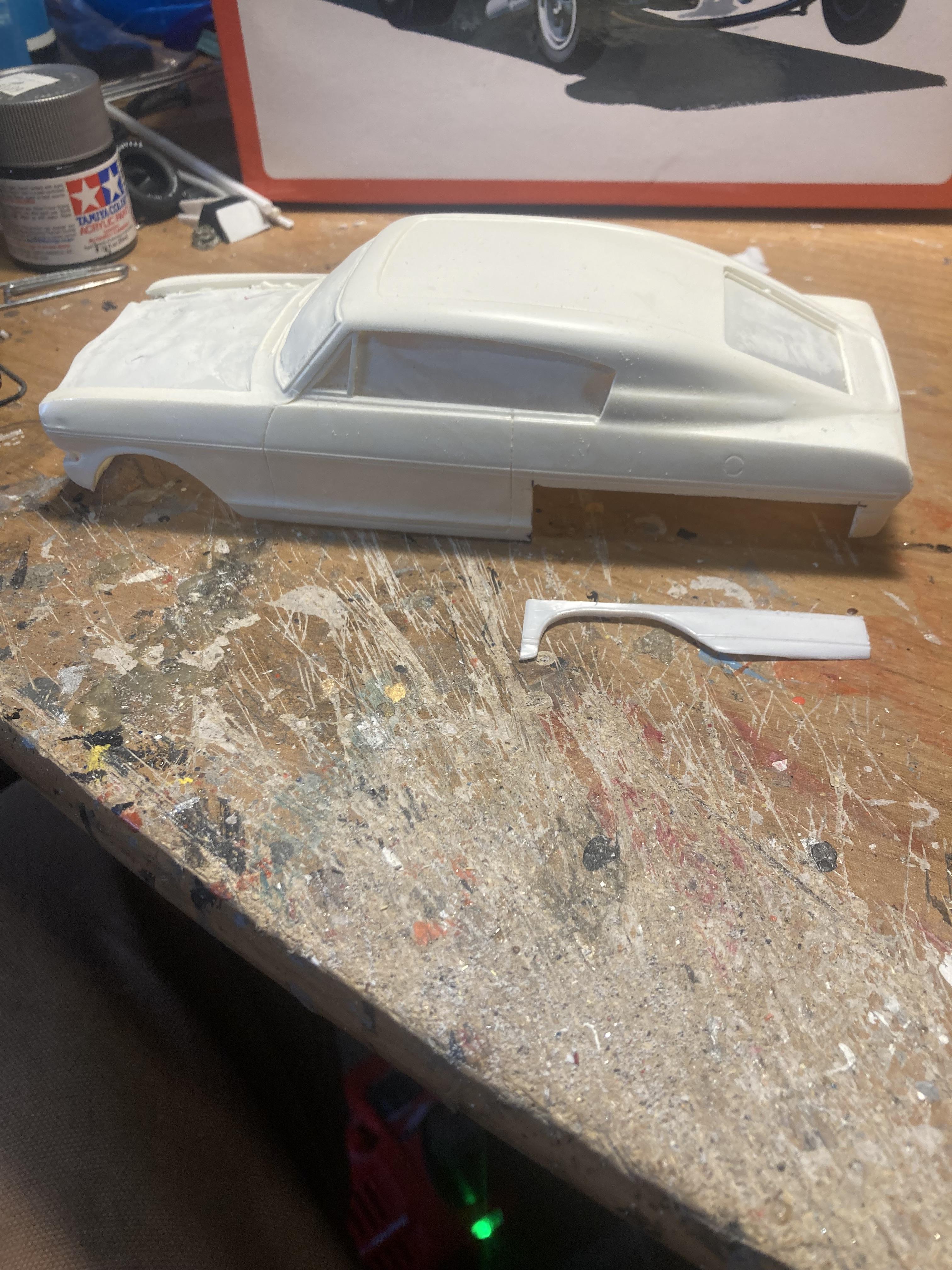

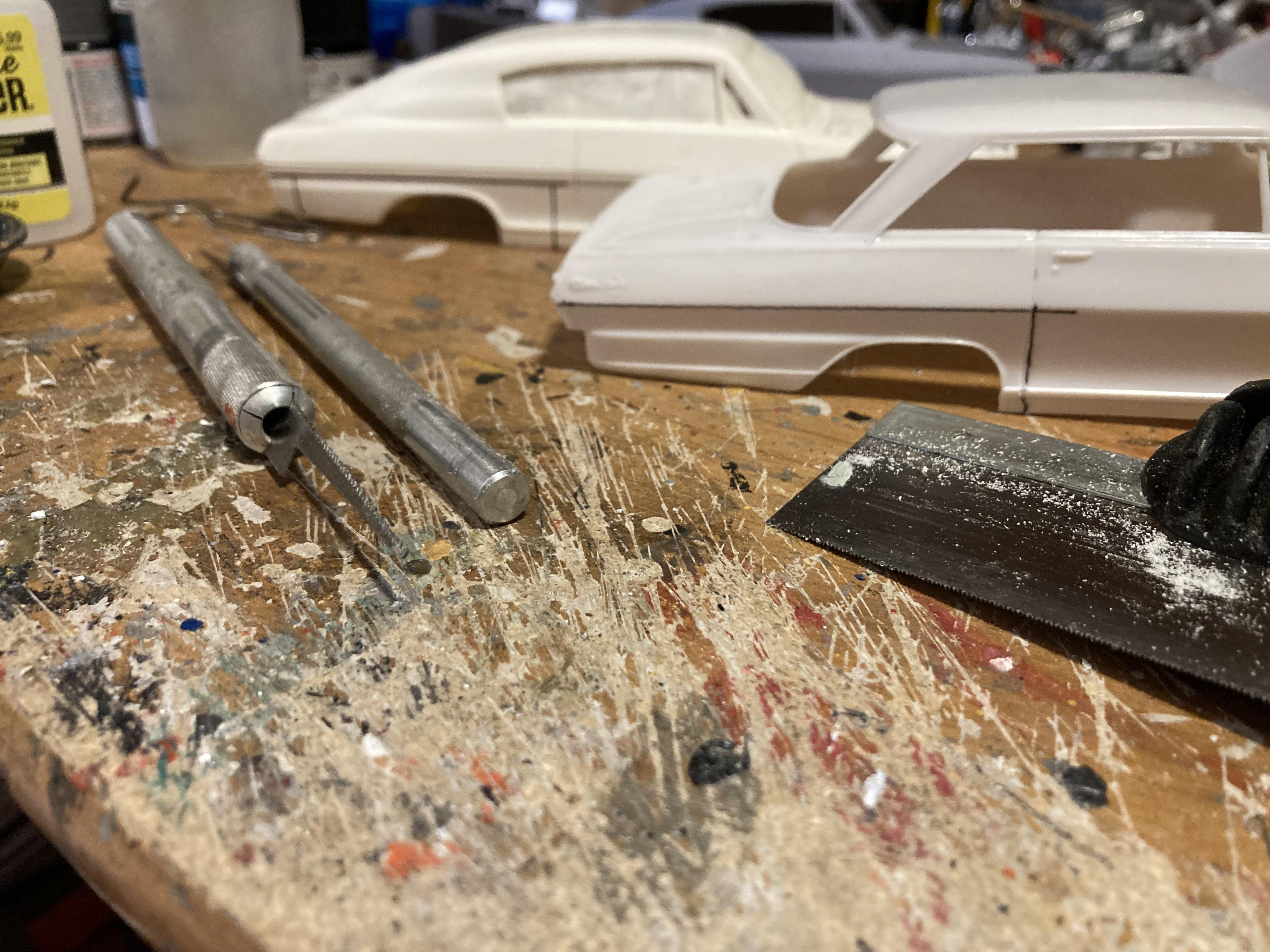

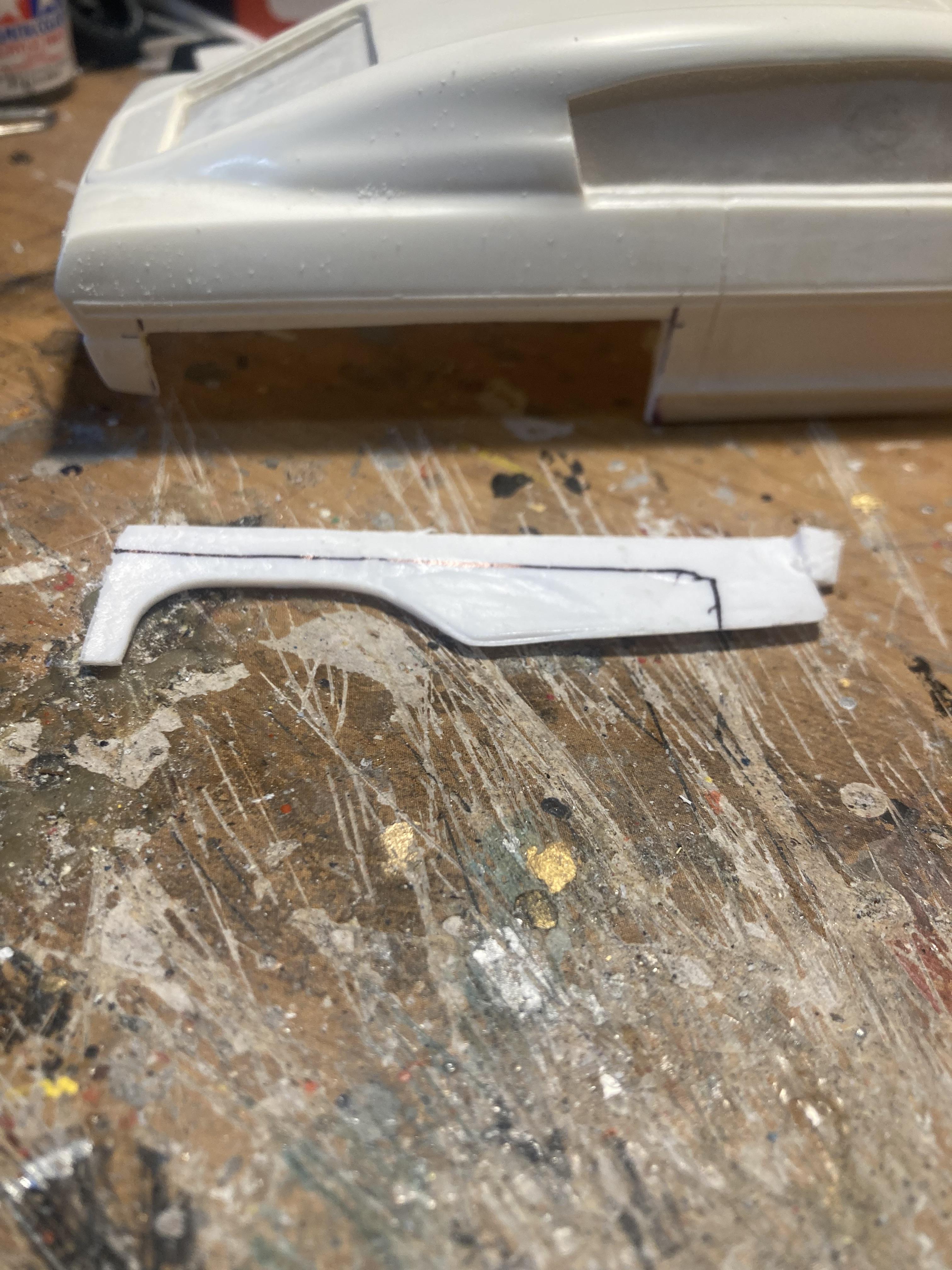

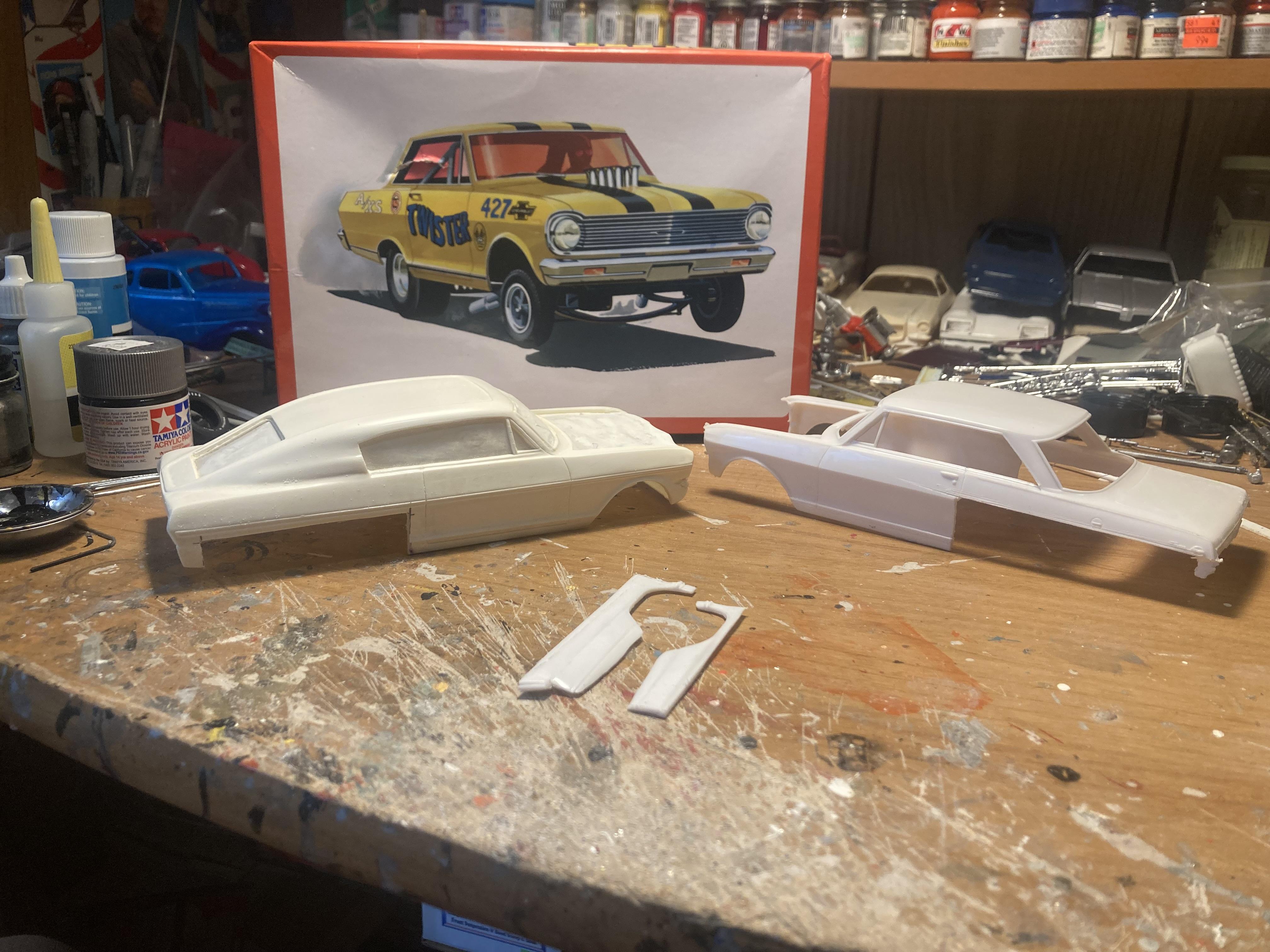

  4. When I cut out the quarter panels off the AMT donor body I cut them out bigger than what they needed to be . So that trace them out to fit the smaller cut outs of the resin fastback body . When I cut them i cut to the outside of my line then file fit them to the opening. When doing this you want a very tight and precise fit to eliminate as much filler and sanding as possible. When fitting the quarter panels determine the desired wheel base and make sure the chassis fits. I sand the joints down from 180 grit to 600 grit with my magnifying glasses on . Then I give it a good heavy coat of filler primer then and filler were needed. Then sand the whole body down starting with 600 finishing with 1500 grit. Once I’m done sanding it will be sprayed with Tamyia gloss black straight from the rattle can.IMG_4269.jpeg.df9b3e9188b1918aafa3125e72ad4354.jpegIMG_4273.jpeg.eb9231dedd15fe6c413c790e31baf2cb.jpegIMG_4276.jpeg.7d346dbad517b2292ec57e310dc3c46a.jpegIMG_4270.jpeg.220b4a0c606dc4a13d681638dbc31972.jpegIMG_4274.jpeg.99e58b6c293c2a6c14a2994c7d67818b.jpegIMG_4275.jpeg.76030f844c4605168ad2df8f5a70e76d.jpegIMG_4277.jpeg.11b59a810847876d7922d0ebd18ca6d5.jpegIMG_4278.jpeg.50eb40a1210a4b5f616db1a2851c02d6.jpegIMG_4279.jpeg.d18e0d0744da3d12950b93a2c1bc2440.jpegIMG_4280.jpeg.a3c851c1a25c44e10727e7a96ea59f38.jpeg

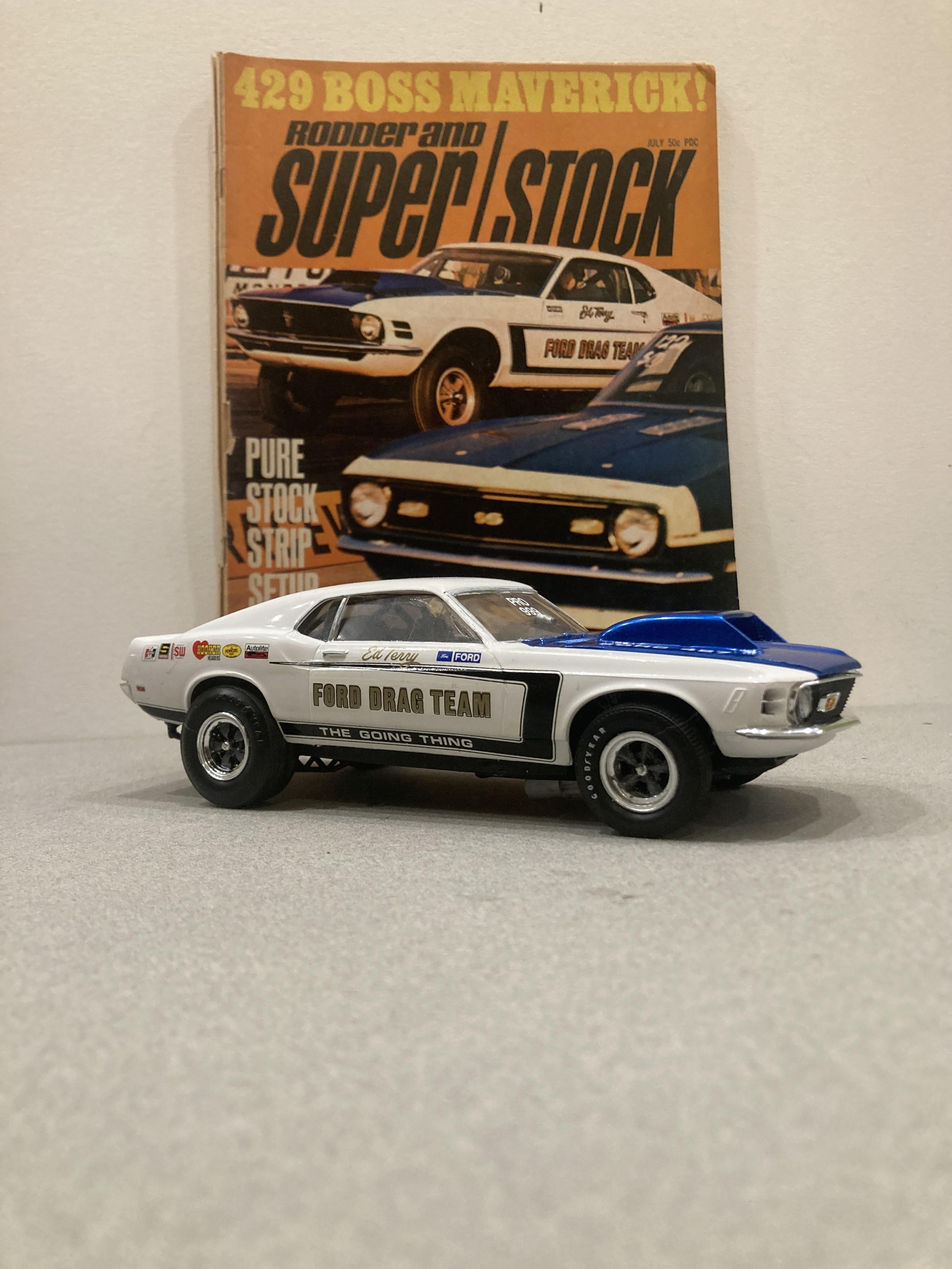

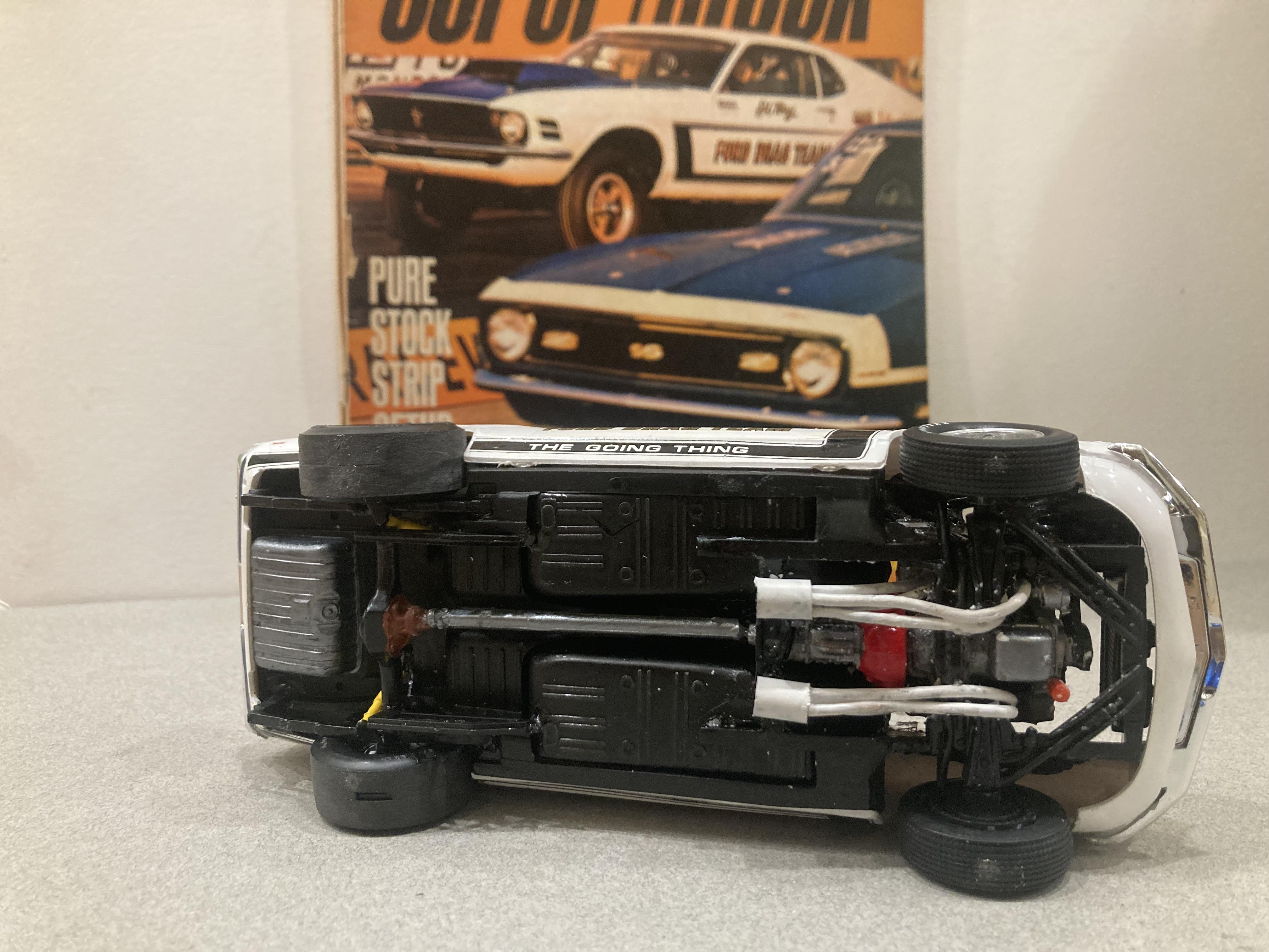

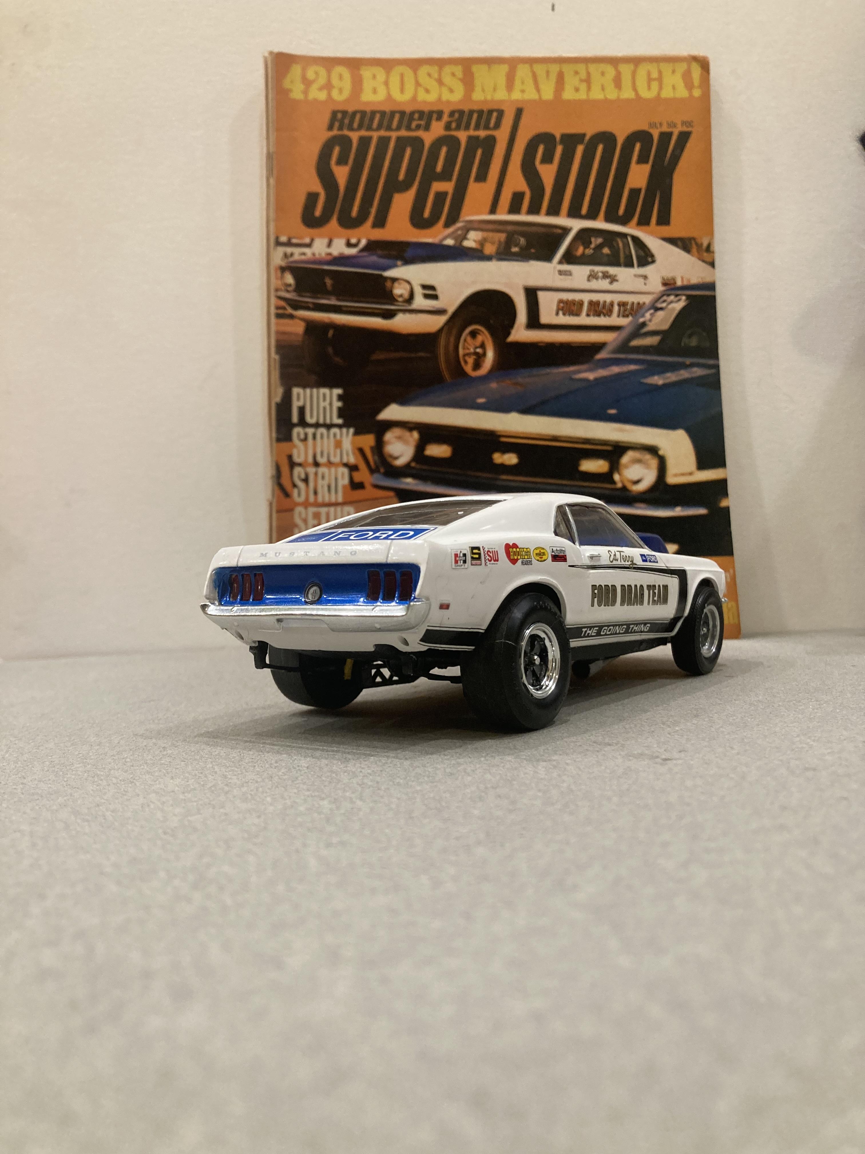

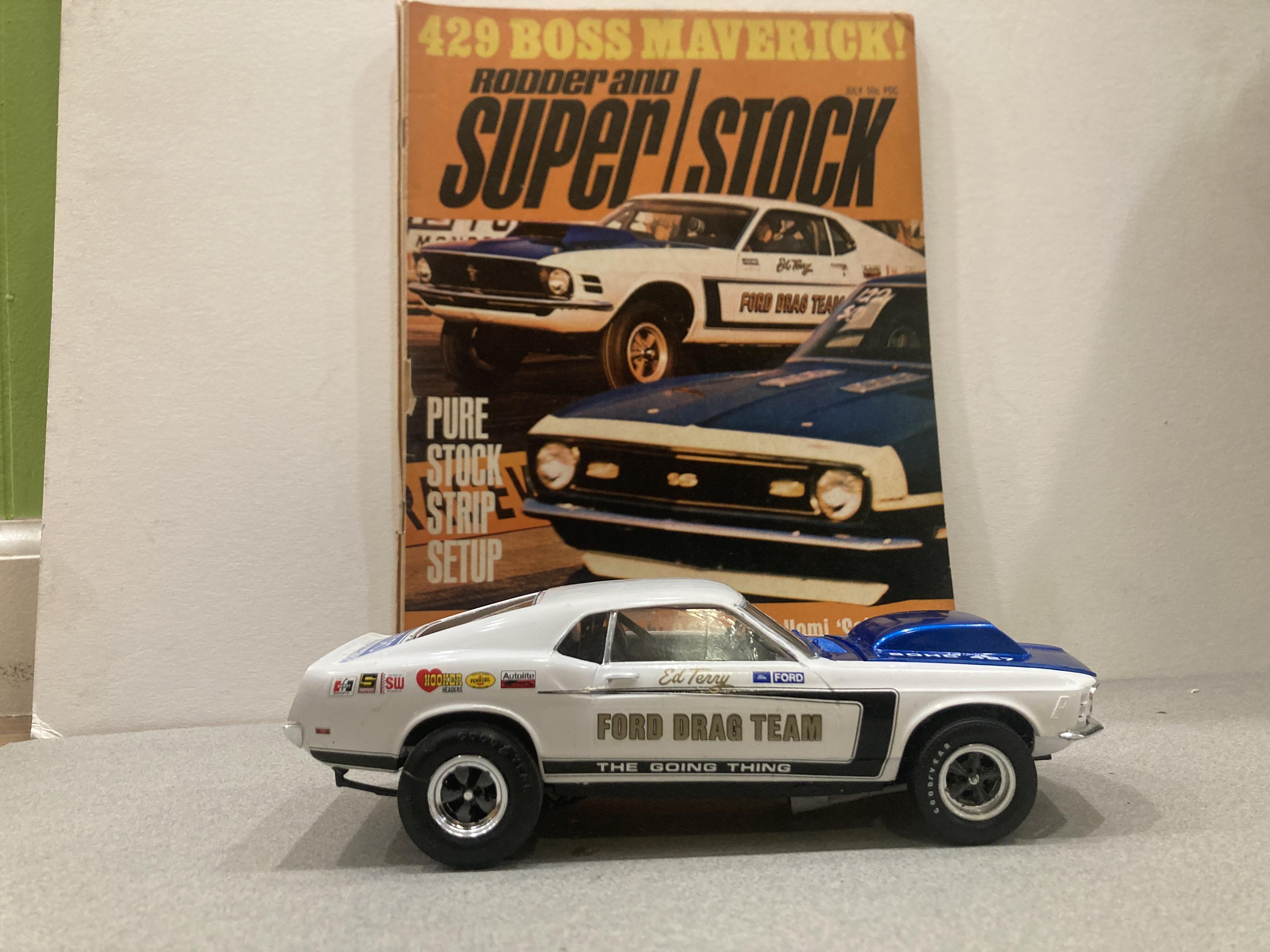

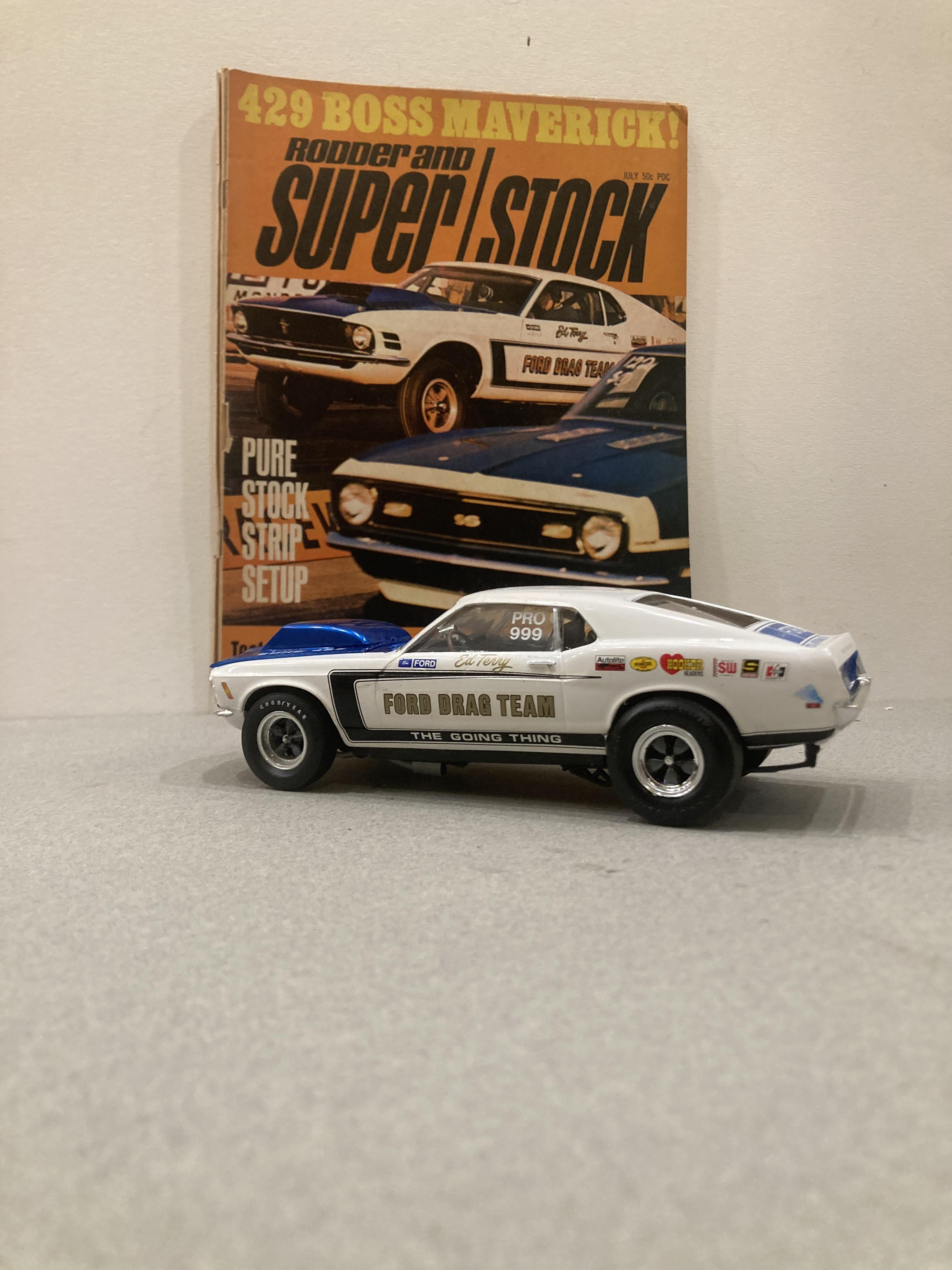

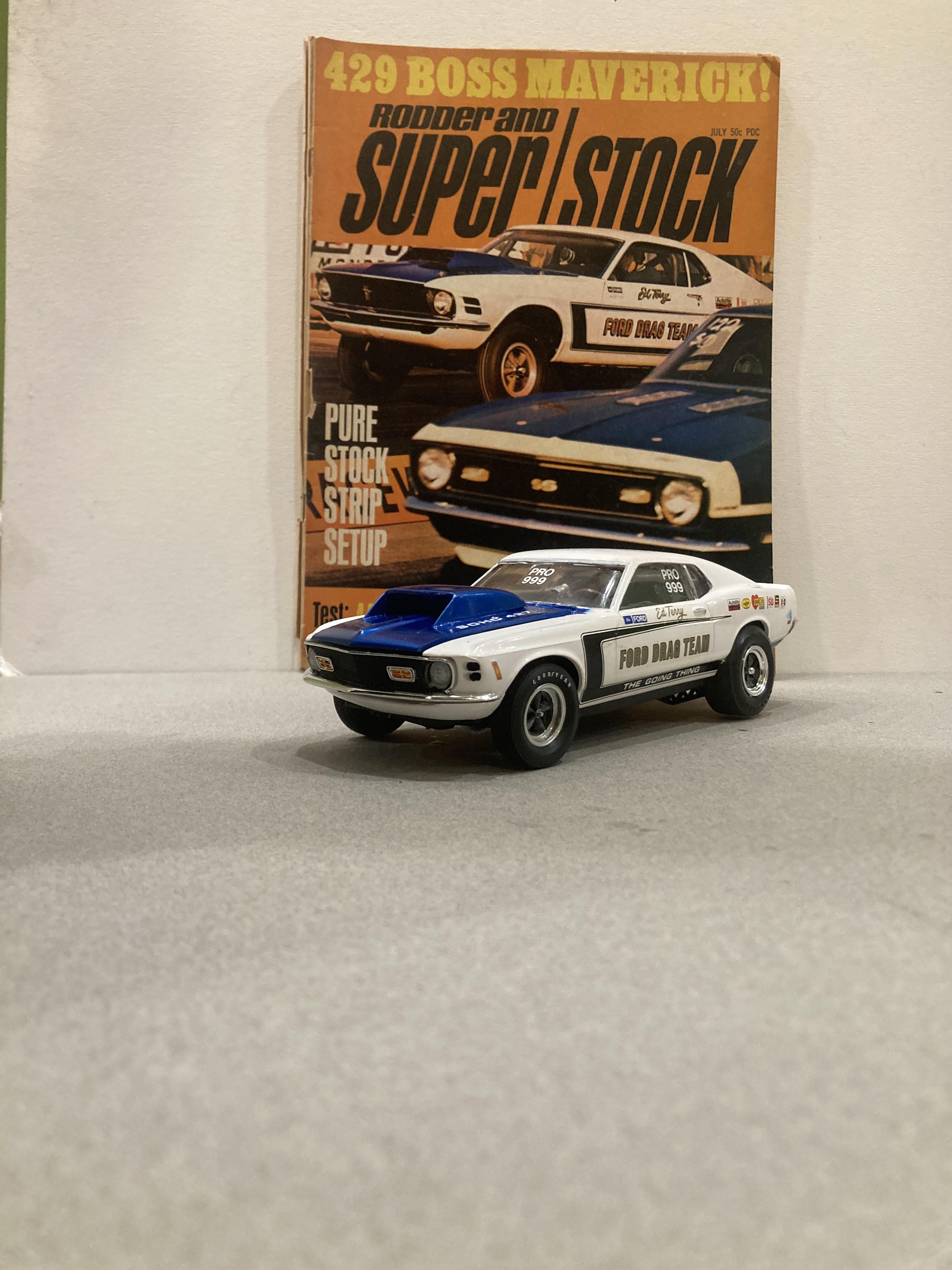

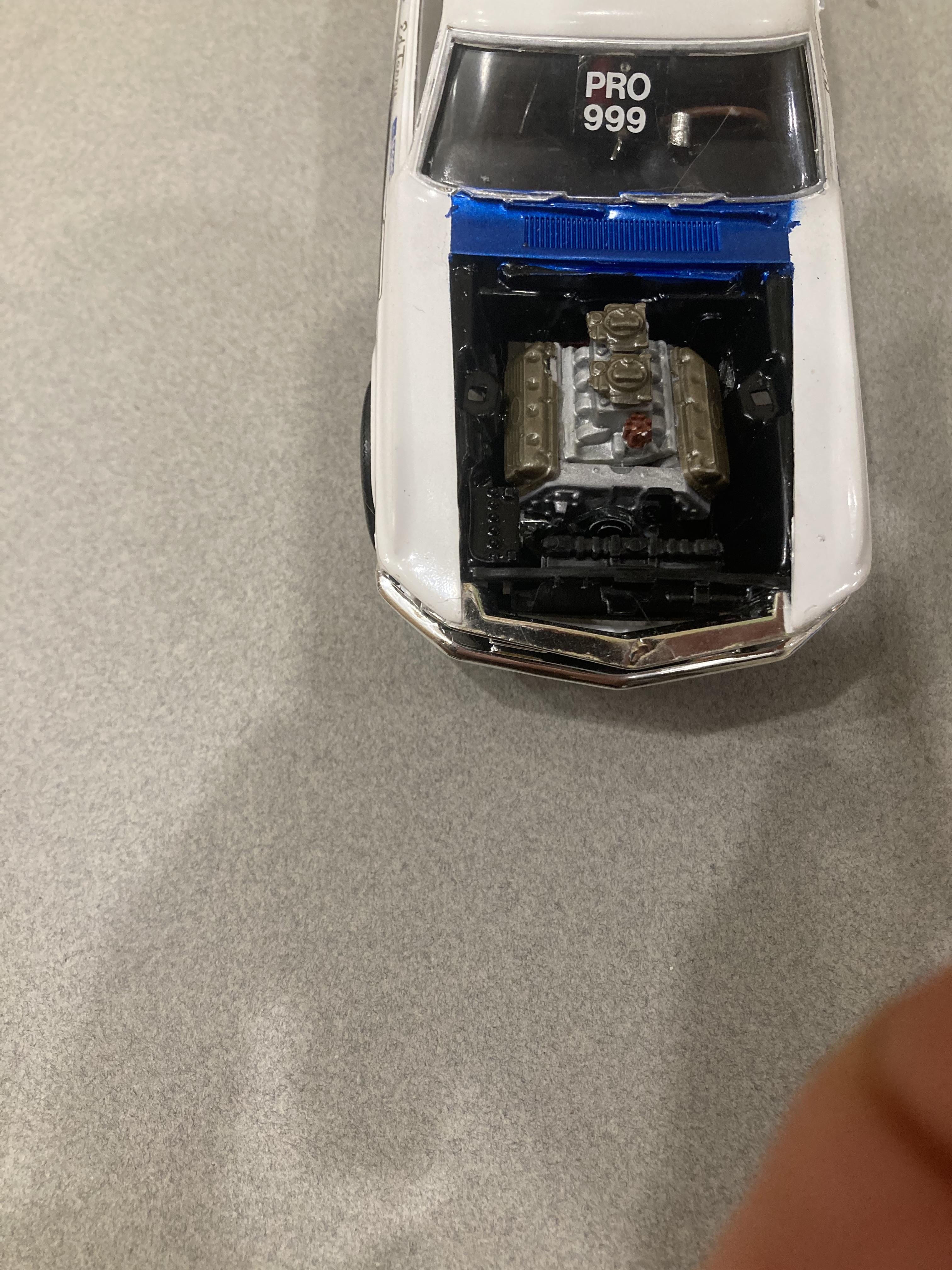

  5. This is a combination of basically three kits along with some parts box items.
    AMT MACH WON : body , long block with heads
    AMT 1971 Mustang : intake manifold and carbs , fire extinguisher, console cover , front tires , hood scoop
    Revell Boss 302 : chassis, interior, glass , engine bay, wheel backs , rear tail light panel / valance, back bumper , distributor , fan belt +altenator
    AMT Old Pro Nova : slicks , ladder bars
    AMT 1963 Impala : rear wheels
    MPC MALCO GASSER MUSTANG: front engine cover , valve covers , oil pan , coil
    random parts box items include : front wheels,  drive shaft
    scratch built items: headers made from solder and aluminum tubing, side windows from clear sheet styrene , rear spring shackles from styrene square stock
    paint: tamyia ts-26 white three coats it sprays real thin, ts-19 metallic blue, black on the chassis and interior is krylon satin
    decals : the black c strips ford drag team , Ed terry script, small ford logo on door , sohc 427 hood decals are old Fred cady that I’d been saving for some 35 years, however you can order new ones from Jim heller he sells on eBay. Deck lid ford logo Jim heller , left over from my Torino build, small sponsor decals on the quarter panels are slixx from the Hubert Platt set . Other small decals side marker lights etc. are from the Mach won and revell boss 302
    this magazine issue is kinda tough to find for some reason. This was a really fun build as there is a perfect storm of model kits , and the decals out right now to make it happen. I’m going to get started on the Platt match race 69 and 70 pro stock mustangs next . Until next time thanks for looking , and stay tuned I’ve got some really cool stuff coming up ,Mike IMG_4526.thumb.jpeg.6f6658f01811d81067a913a4d414753a.jpegIMG_4521.thumb.jpeg.b873f6a0acf8c7fb7b05c586695609f9.jpegIMG_4522.thumb.jpeg.3427fd685ee8992666ef49ea10a0bde6.jpegIMG_4520.thumb.jpeg.011ff1e7a5b1905872cd5a0ebe97659d.jpegIMG_4523.thumb.jpeg.19cccbf7cdffda3ec5592be3191af622.jpegIMG_4524.thumb.jpeg.e97b9036fa156b6bc5a9f92d46b4247b.jpegIMG_4525.thumb.jpeg.70241e2b01ea46195be803db5cdd712c.jpeg
