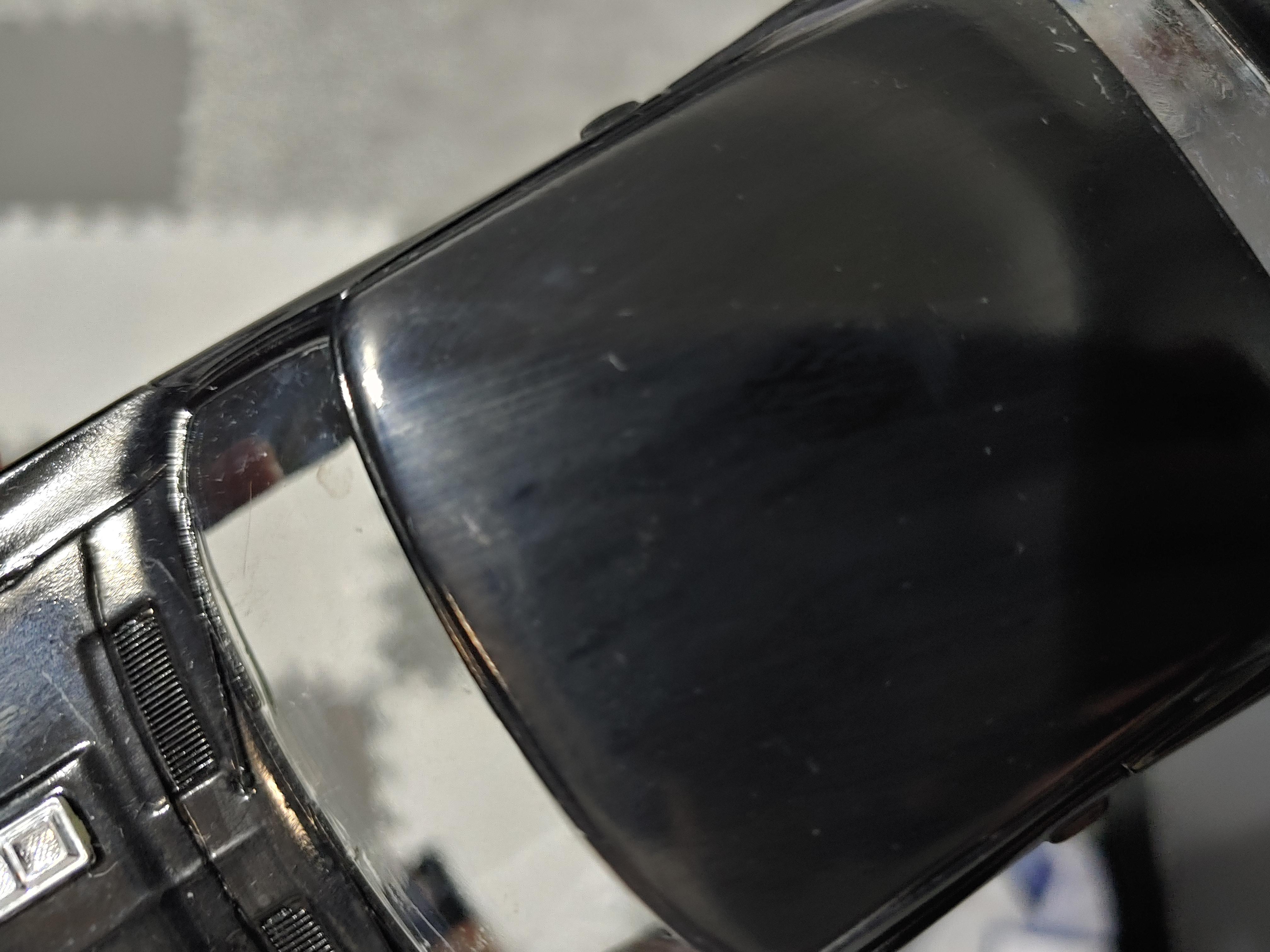

  13. Good News everyone. I tried the PlastX. I got 90% of the glue and streaks off. The roof looks really good. It did leave a slight polish cloud. I will likely try again later to really buff it out.
  14. Awesome, I'll pick up a bottle of PlastX on my lunch break and give it a try. Fingers crossed.

  16. Ok. What's the best process? Wet sand with a really fine grit sand paper, then rub in the compound?
  17. Would just rubbing Meguir's PlastX on the car with a cloth fix this? I can pick up some tomorrow.

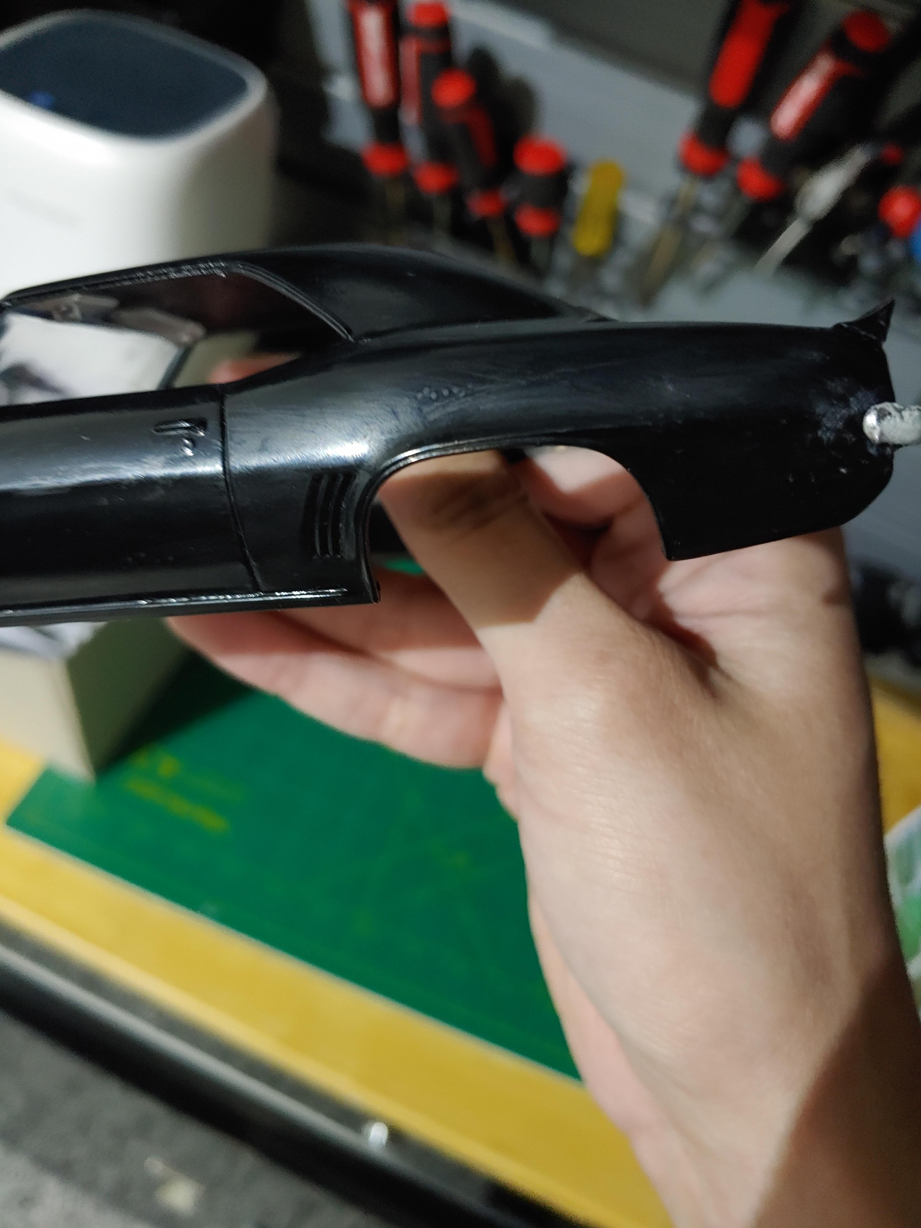

  19. I tried both. Sadly no improvement.
  20. It's the Tamiya Clear Parts Glue. What type of polshing compound should I use? Would the Tamiya Finish work?
  21. Last week I finished a 1969 Camaro SS body. I cleared with Tamiya lacquer. I let the paint set for a week. Today, I went to do the windshields and bumpers. I saw a video online of a guy gluing windshields and bumpers, he used a damp paper towel to wipe any excess. I did the same but I got water streaks on the rear quarter panel. I tried wetting the roof of the car with water and wiping it with a microfiber cloth and also got water streaks. Is there any fix for this? Or did water just ruin a perfect paint job...
