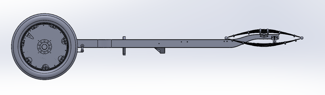

  9. And the rear wheels are on.... And an overall shot.... Had to tweak the Rear Axle and Brakes to work with the wheels, but it was no big issue... Will probably have to tweak them again in the future... Have to make everything fit where it is supposed to fit.... Anyway, ONWARDS!!!! {chuckle}

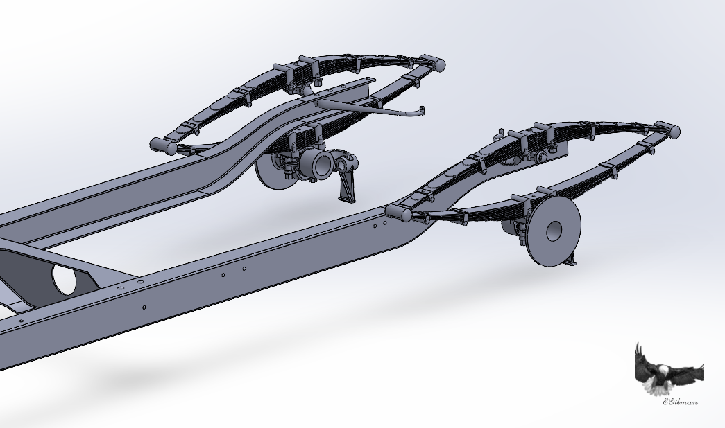

  10. Ok latest update... Was thinking that I could just add the previous brake design with just a little bit of tweaking... Well it didn't exactly work out that way... I could adjust the brake shoes to the correct locations but the rods and levers had to be redesigned.... This is what came out of it... Rear Brake Assembly... Mounted to the Differential Carrier... And within the Rear Suspension Package... You can plainly see where the control levers are back in their natural "off" position and yes the overcenter preventers are there as well... I guess next up would be the Rear Wheels.... Then the Brake/Shift Handles and brake actuating rods.... Onwards!!!

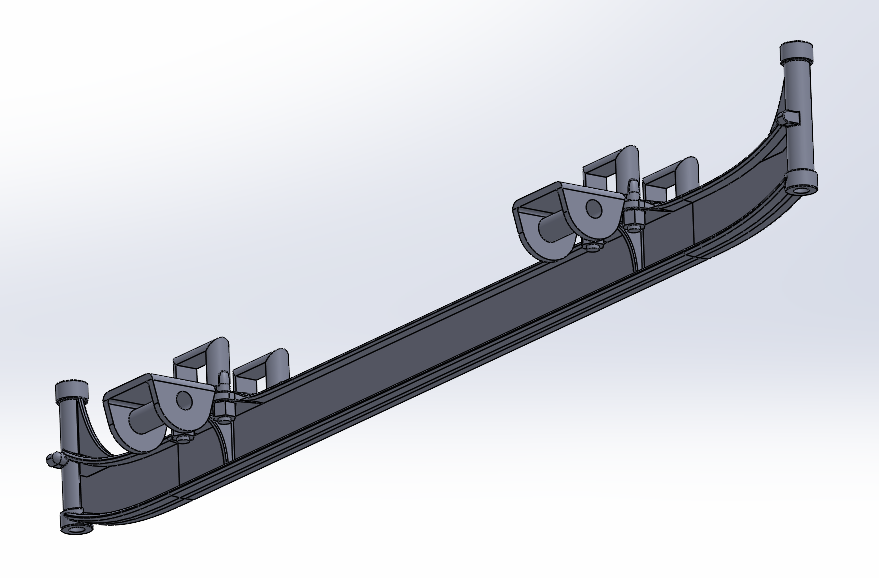

  11. Why thank you John!!! It was another little brain burner till I got it understood.... Yeah the internet is pretty sparse when it comes to these automobiles... Anyway the Truss Rods and Braces are done now.... This completes the rear suspension... Next up, getting her some Brakes and Rear Wheels.... The brakes shouldn't take too long as I was pretty close on the last iteration and just need to add some missing details, and the Wheels are done already like the front wheels, but need the brakes to locate them in the model... Onwards....

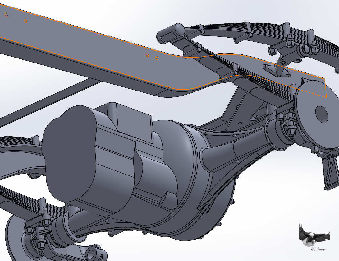

  13. Well it's been an interesting few days.... It's time for another update.... I know in my last posting I was going to be working on the thrust structure... To do that, I have to get the Differential Housing, Transmission, Driveline Thrust Tube and the Thrust collar to line up properly... So what I do it create a sketch of the layout where each part can be recognized for what it is as well as it's position in the car overall and relative to each other... This is that sketch... Trust me it's all there... (I know a bit skimpy on the lines but what I need to know is present), And indexed to the cars model origin point, so what ever drawing I put this sketch in it will always be in the same model space just by dropping it on the origin point... But when I started adding parts, I found out that they weren't lining up very well... You can clearly see when the layout sketch is shown inside the car, the transmission is way too high... Too much angle for the Differential Housing which drives the Tranny height as well as angle.... I know when looking at the car it looks like it sits fairly lever, and it essentially does... The engineering of it is a bit different... She carries a 1.23 to 1.36 degree forward lean when sitting on all four tires... and the Axle drop angle is only about 3 degrees more or less, so these are such shallow angles that they won't show up in perspective laden photographs... As a result I've spent the last few days redrawing the Differential Housing and Transmission... this is what I've come up with.... You can now clearly see that the Driveline drop angle line runs right down the middle if the Thrust tube.... Just the way it should.... Now I won't bore you with the details of the re-engineering of these things... the Differential Housing was a piece of cake compared to the Tranny... And I'm done with the Tranny, I'm happy to say that I believe it is now approximately 98% accurate... Thanks to the many images I have access to... There is it.... Looking good now, it does match the pics very closely.... Phew I'm tired... Anyway, here is an overall shot, I'm going to get some sleep.... Enjoy... Will start on the thrust bearing when I wake.... (it may take a while) {chuckle} Onwards!!!

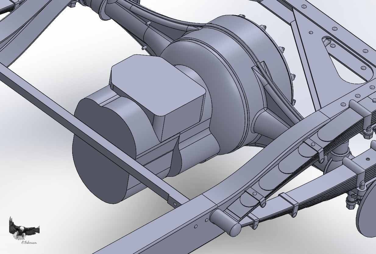

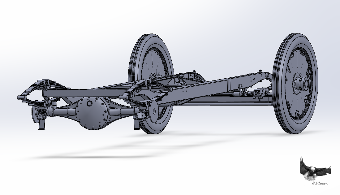

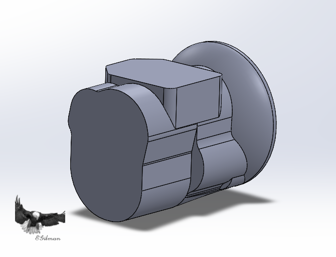

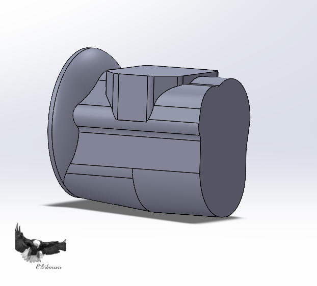

  14. Well four days of working on this, I think I'm calling it done or at least done till something needs adjusting to fit other parts.... I painted it yellow for a beauty shot.... And mounted to the axle/differential... The car was all yellow, with black painted trim but only on the outside surfaces.... Anyway, the Tranny in it's position... And the overall shot, I know too far away to see the differences but I assure you they are there... I'm figuring that it is 95% accurate to what was on the car.... Anyway on to the thrust bushing.... Onwards....
  15. Another short update.... The vagaries of engineering... {chuckle} I ran into a problem with the transmission, parts that I now have info for wouldn't fit on the design the way it was configured.... And I had reached the point in detailing where I couldn't just back it out, and rework it... This is where I finally had to stop and reconsider the design... And what it should look like in real life... Yeah there are issues... So, I started the reconstruction.... This is what was.... This is now.... The differences are subtle, but they make all the difference in the finished model... Everything in the pics has to fit on the model.... This redesign should allow me an easier, more accurate path to the finished transmission.... Restarting the detailing process as we speak.... Onwards.....

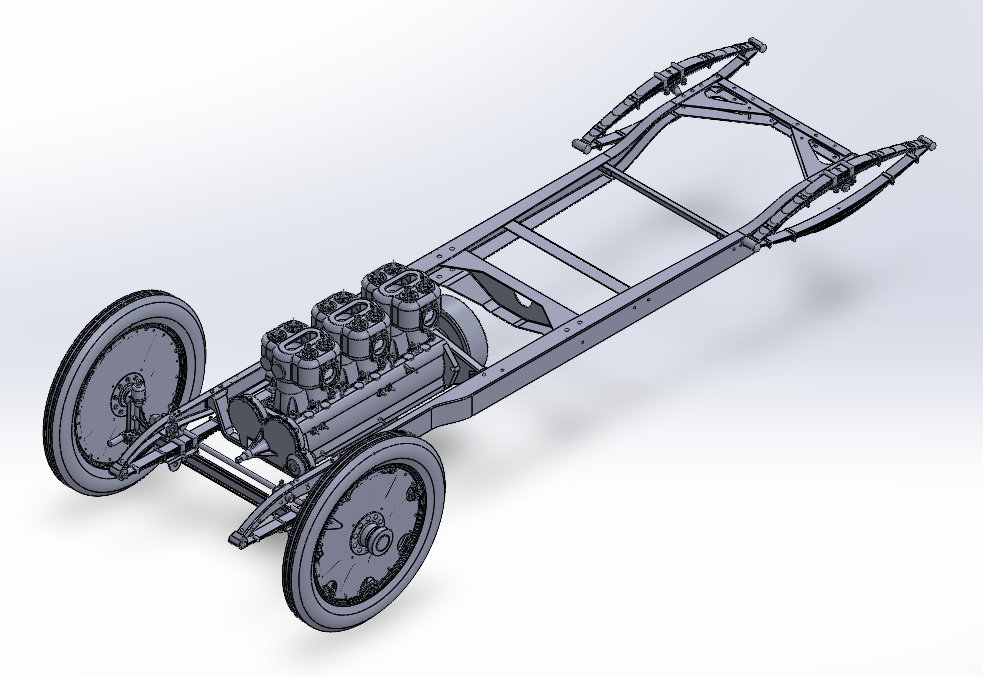

  16. Short update, Blocking out the Transmission.... In the chassis.... Now I get to work out the details..... And the overall... Onwards....

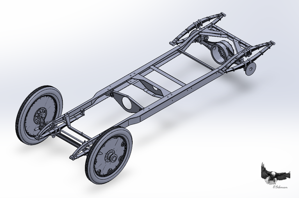

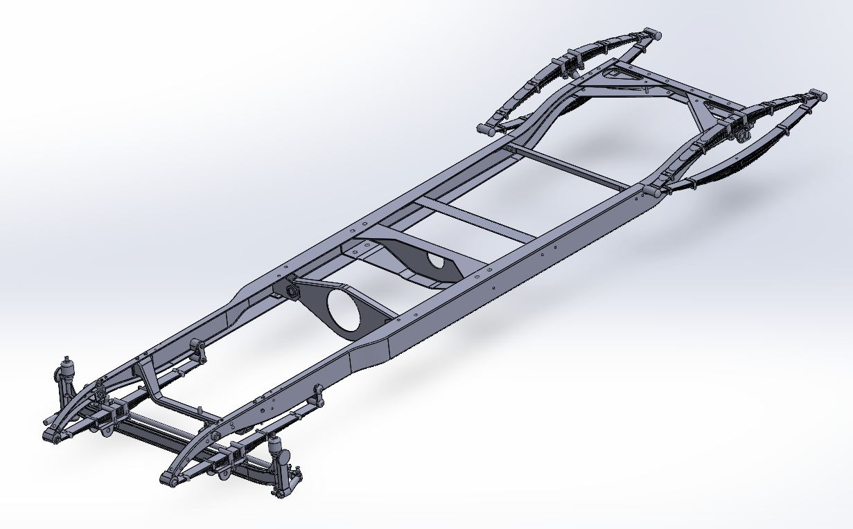

  17. Ok, the Rear end... Front... Rear... Mounted... Reverse low angle... Beginning to look like something I think.... The ubiquitous shot.... Onwards!!!

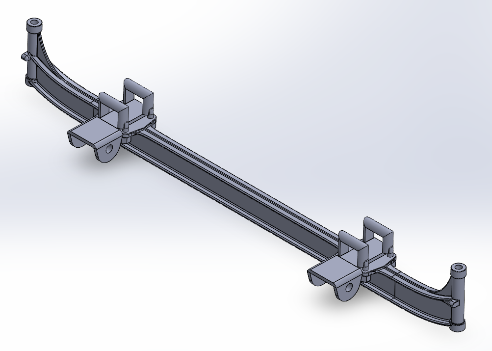

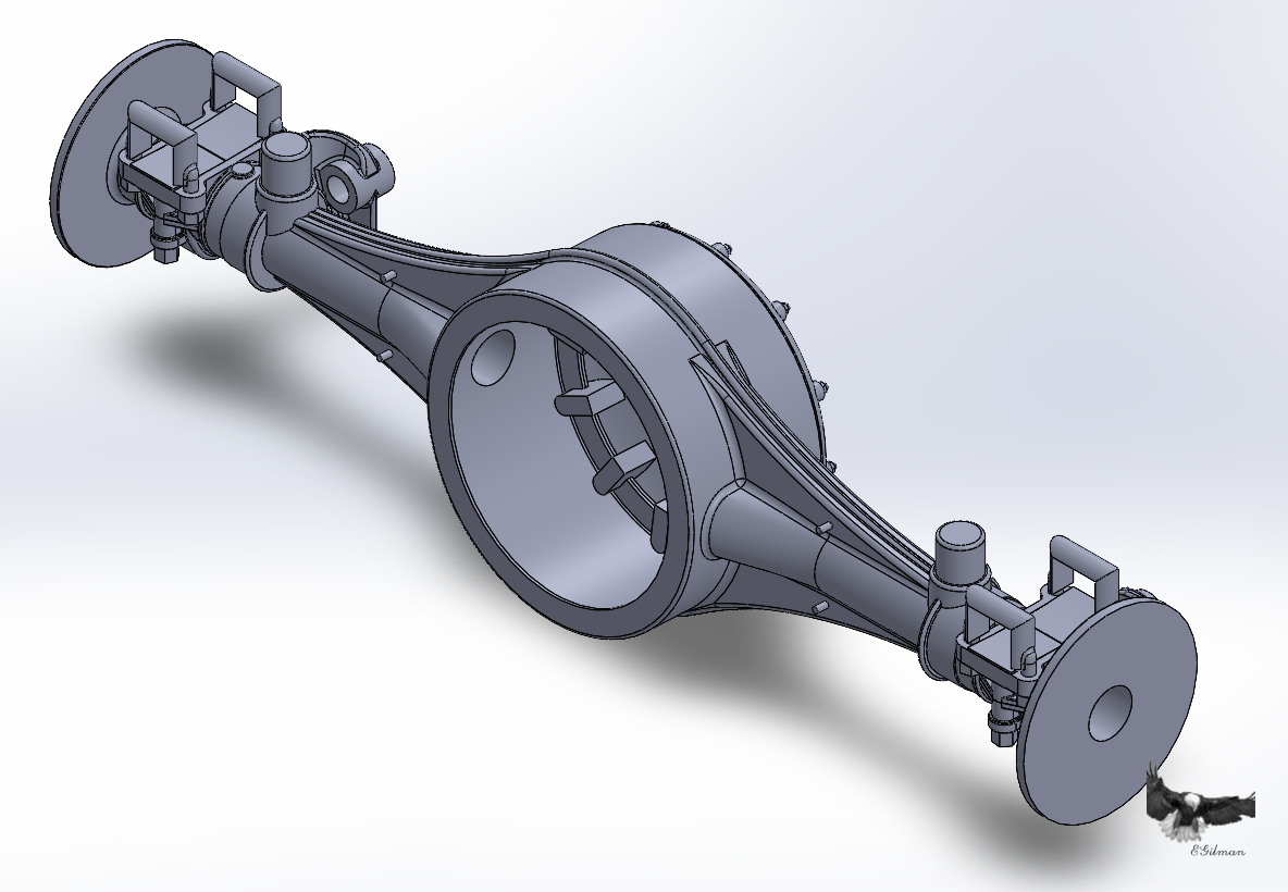

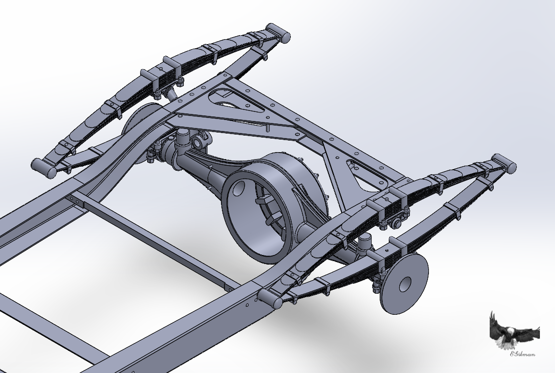

  18. Yep, it was a bit confusing until I figured out what a grease cup was doing connected to the Rear Axle mount plates.... {chuckle} The lower clamp piece wasn't the normal idea of a clamp, more like a bearing cap... This was so the axle housing could turn in the spring mount as the suspension moved up and down.... Effectively keeping the springs from taking any torque.... All the forward thrust went to the thrust Crossmember without the springs interfering.... A good design, I wonder why they went away from it....

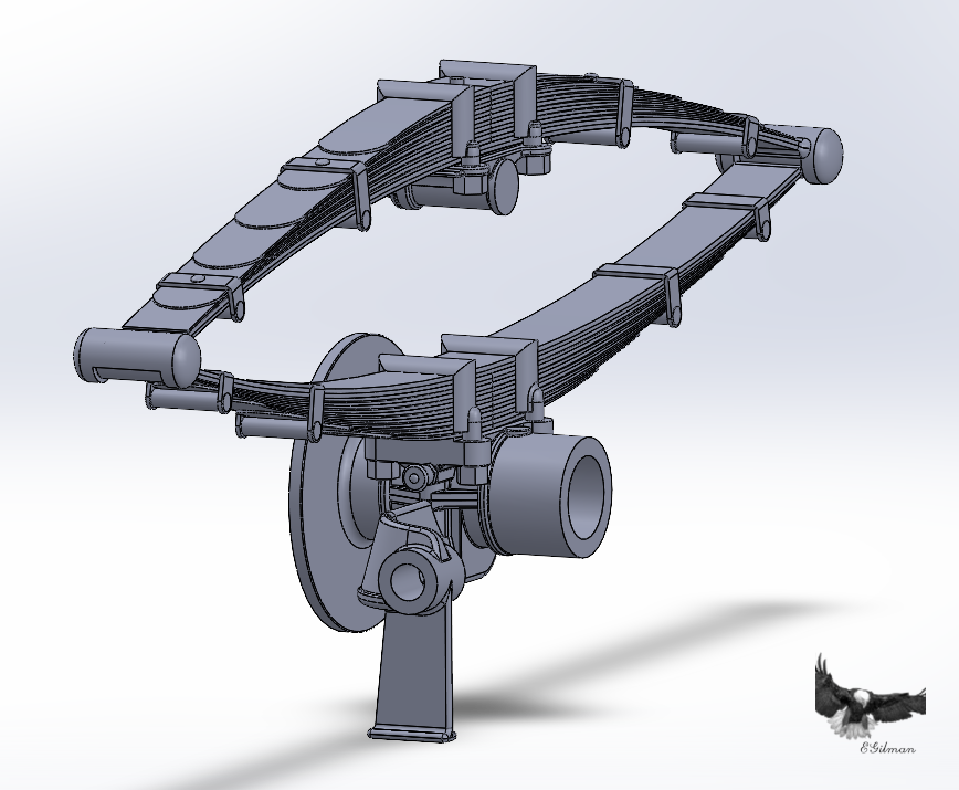

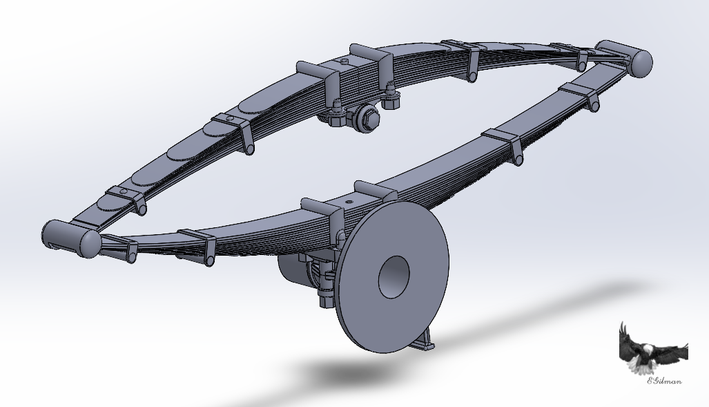

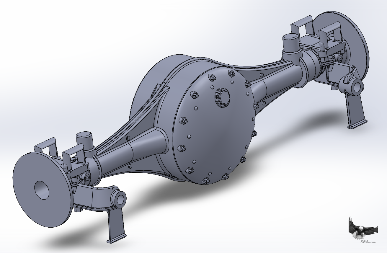

  19. Well, another Update... Rear Axle... We start with the spring plates and model the clamp... Front side.... Rear side... Of course the spring plate is the upper part with the shackles sticking up, and the clamp is the lower portion which has the Lower shock bracket and rear jacking plate incorporated into it.... Between the two of course is the outer casing of the Axle Housing with the large flange serving as the Brake Backing Plate...... It was done this way to allow rotational adjustment to the Axle Housing without affecting the compression line of the spring... Adding a jacking point was a brilliant idea... Mounted to the Rear Springs.... And the backside... Not quite finished, there are more details that will need to be added as the complete Driveline get designed, but this is where it starts.... Overall view... Next up, the Differential housing.... Onwards!!!

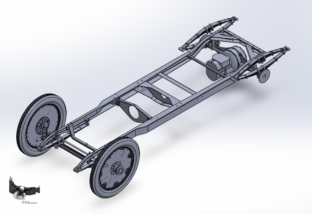

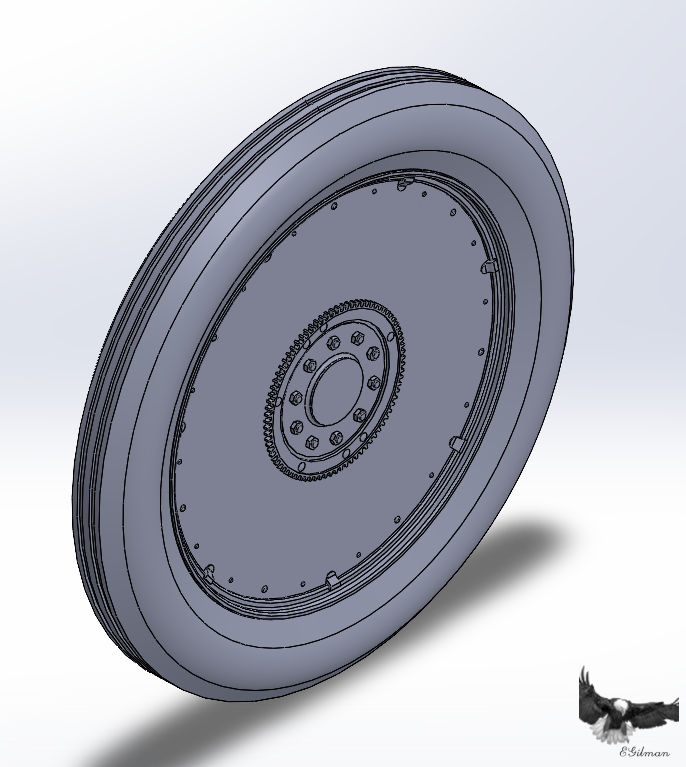

  20. Ok, Short update: (adding something I forgot last time) The Speedo Gear to the Right Front Wheel.... I figured I should add it now, so I split out the right wheel as it's own part and added it... I know it's a small detail but it would be noticed if it was missed.... Now, going to pay particular attention to her Rear End.... Onwards....

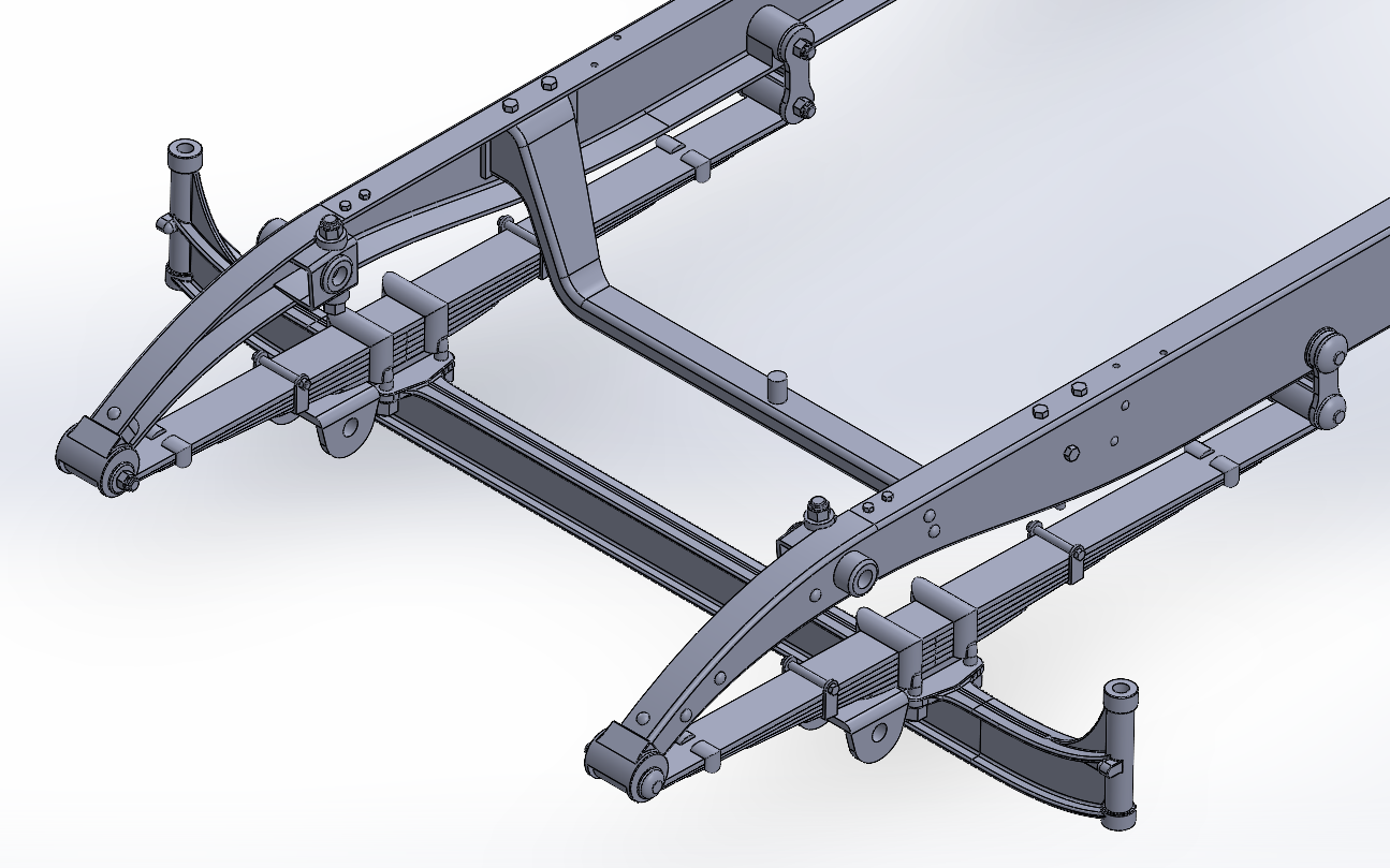

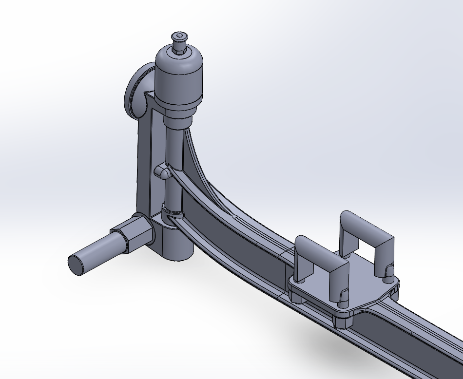

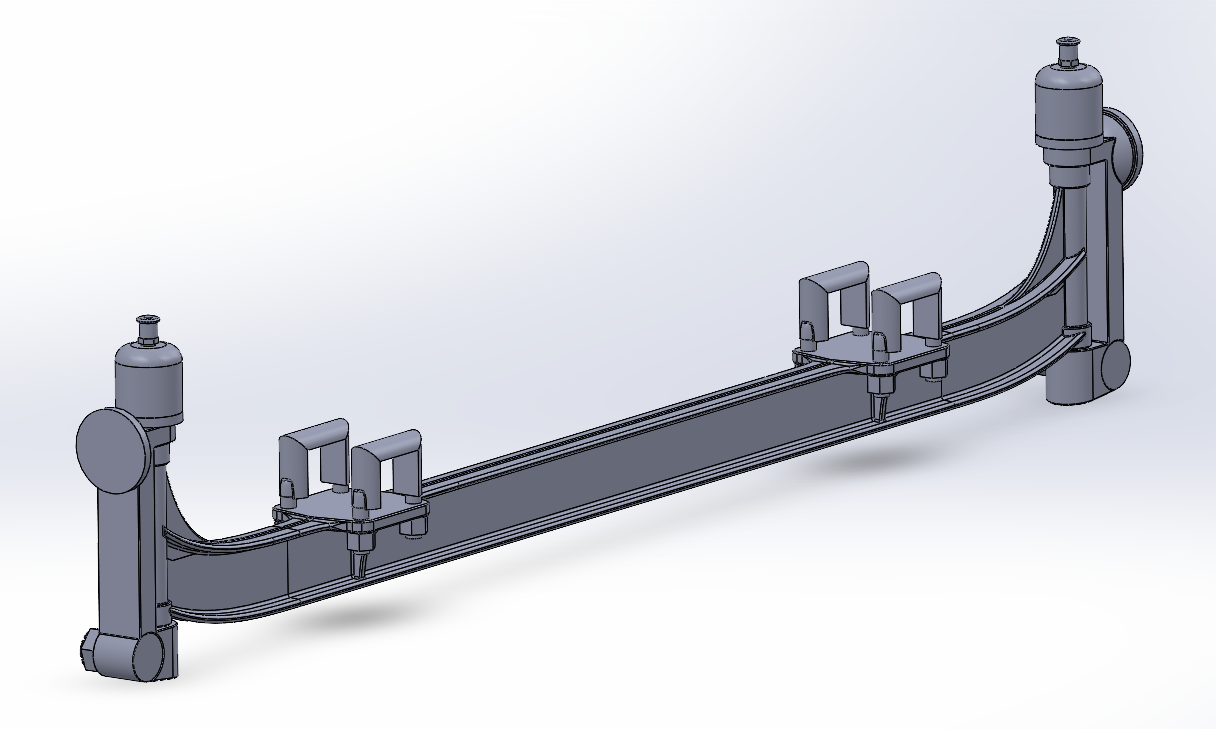

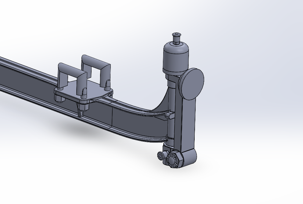

  21. Thank you John, Short easy update today, I added the front Wheels & Tires to the chassis since the front Axle are now complete... I used the ones I drew up earlier cause there is really nothing to add from what I had... But, I did incorporate the front end Wheel Camber to the installation... This make her compliant with the real car.... Next: on to the Rear Axle, now that the Front wheel are on she has to have the Rears installed as well.... Onwards....

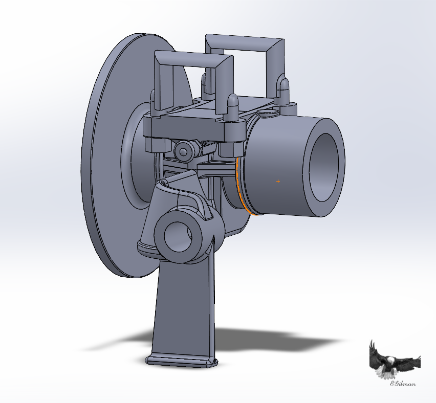

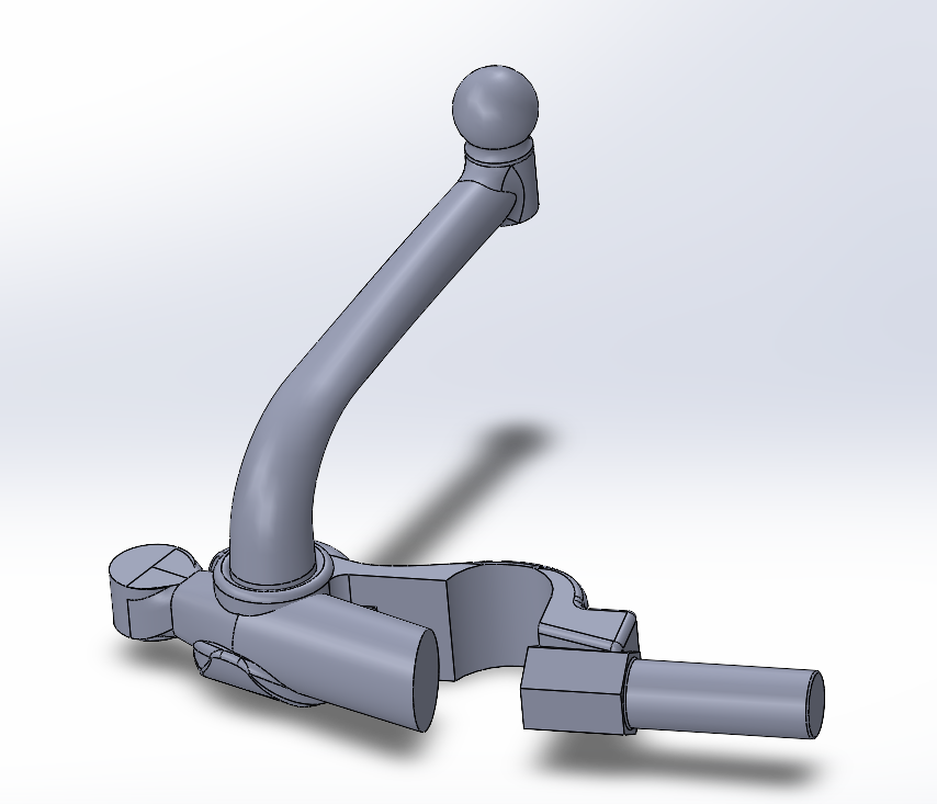

  22. Well, time for another update.... Steering Knuckles, Center Link and Steering Arm..... Starting with the Steering Arm.... A unique and ingenious piece of engineering The standalone part... The Speedometer mount post is included cause it's natural to connect it to the model here... It bolts to the hex portion of the post wraps around the lower end of the spindle carrier and then wraps around the Right Steering knuckle while supporting the Steering Arm.... Showing the Steering Knuckle in place.... It was really something to draw, someone with more experience could probably do it better, but I'm calling it done.... And the complete Front Axle steering assembly... And the complete Front Axle.... (back side) Considerably different than the Standard Steering Arm..... (and a lot stronger) And the usual overall shot.... Getting closer to a complete chassis.... Onwards!!!
  23. Thanks John, been working on her steady this week as time allowed... Here is the current status.... Left side... Right Side... Front.... Rear... I haven't drawn the Steering Knuckles yet, but I've learned they were identical from side to side just mirrored... The steering arm was a separate part that was bolted on over the right side knuckle so it is unique to the Wasp... My previous design was of the standard steering knuckle/arm, (one part) from a standard Marmon Speedster... Your pics of what is actually on the car are a godsend for getting it right... That's what I'm figuring out now, the steering knuckles will be easy, it's the steering arm that will be a challenge... Again thank you for your generosity.... EG...

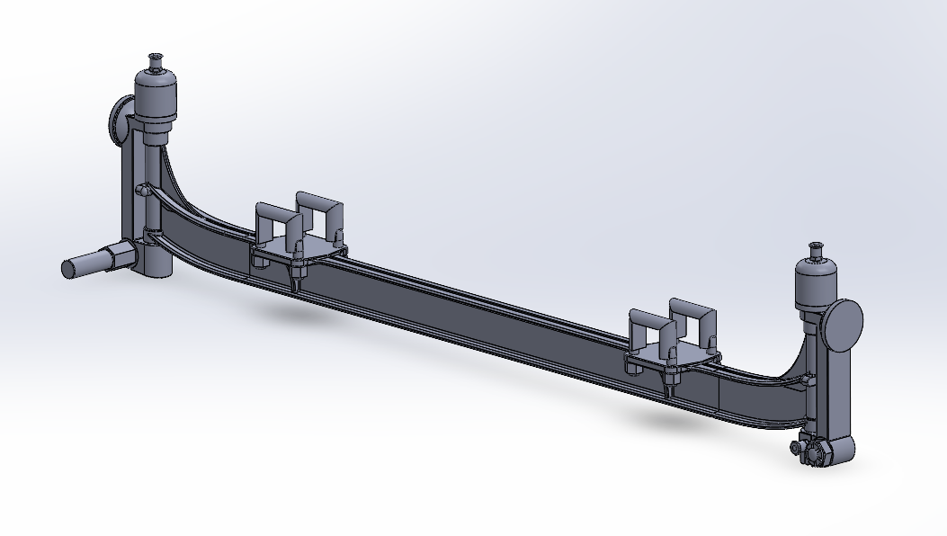

  24. The basic Axel is done.... (with the shock absorber brackets) And an overall view.... Next up is the Spindles..... Onwards...
