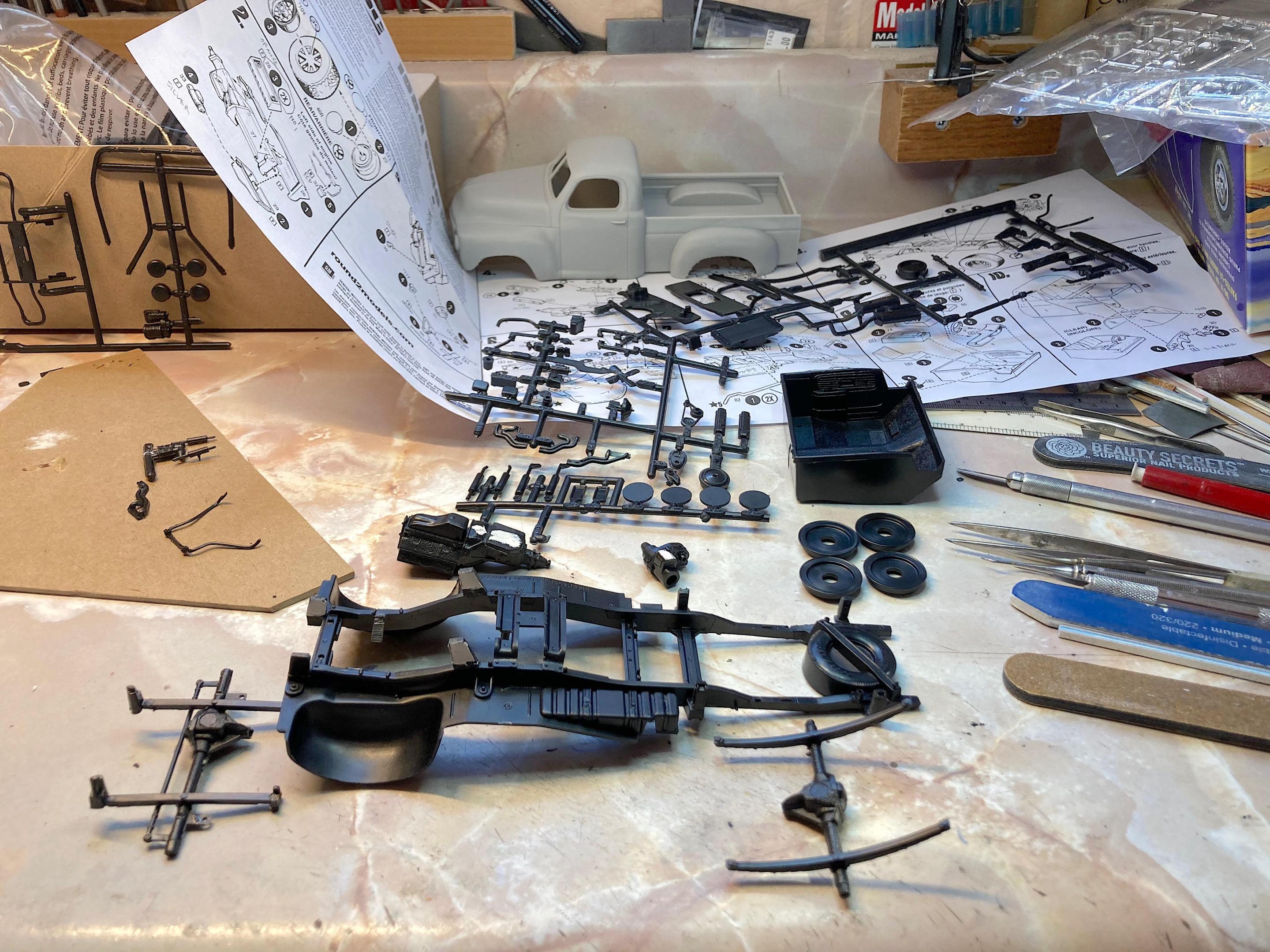

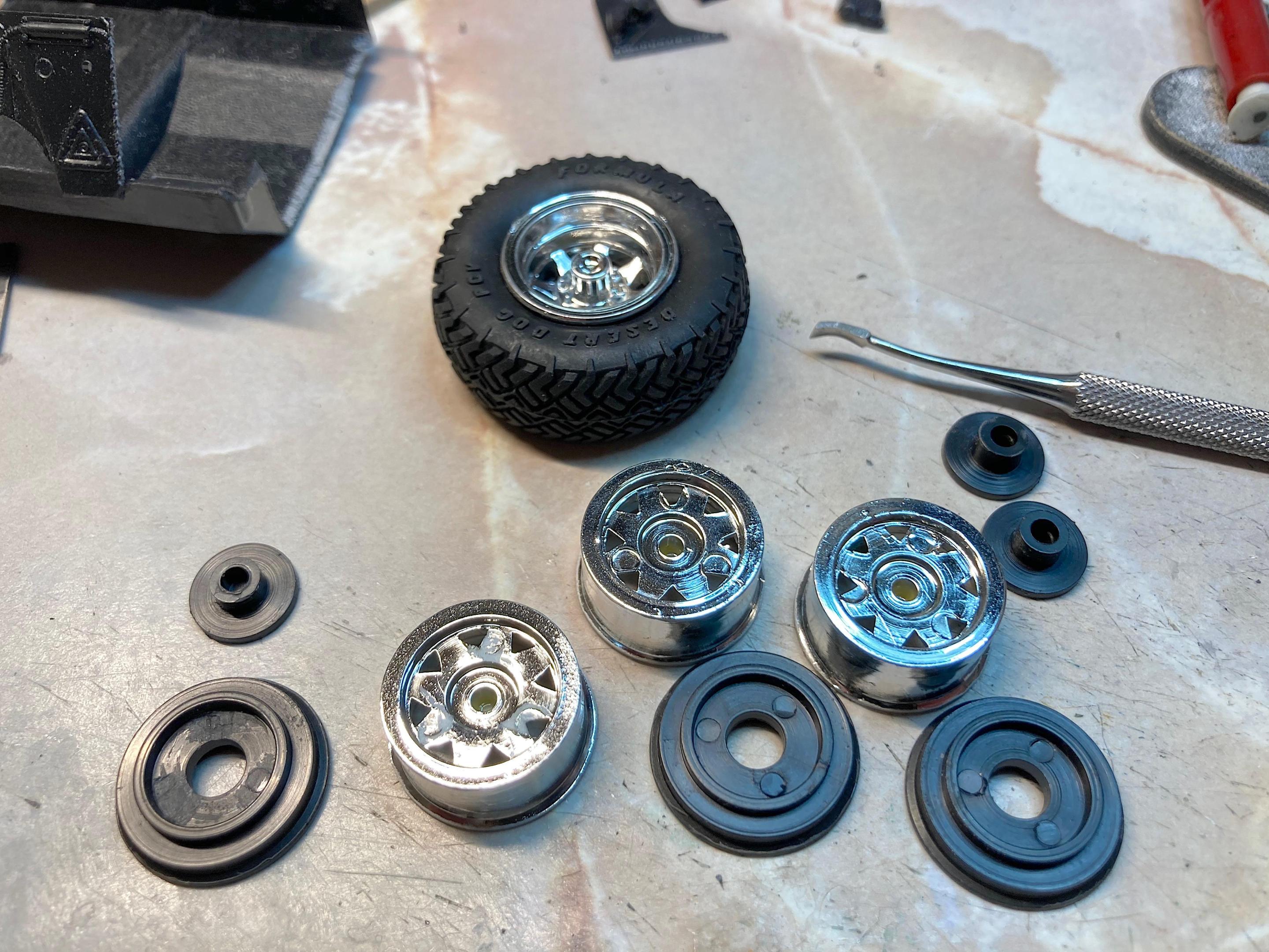

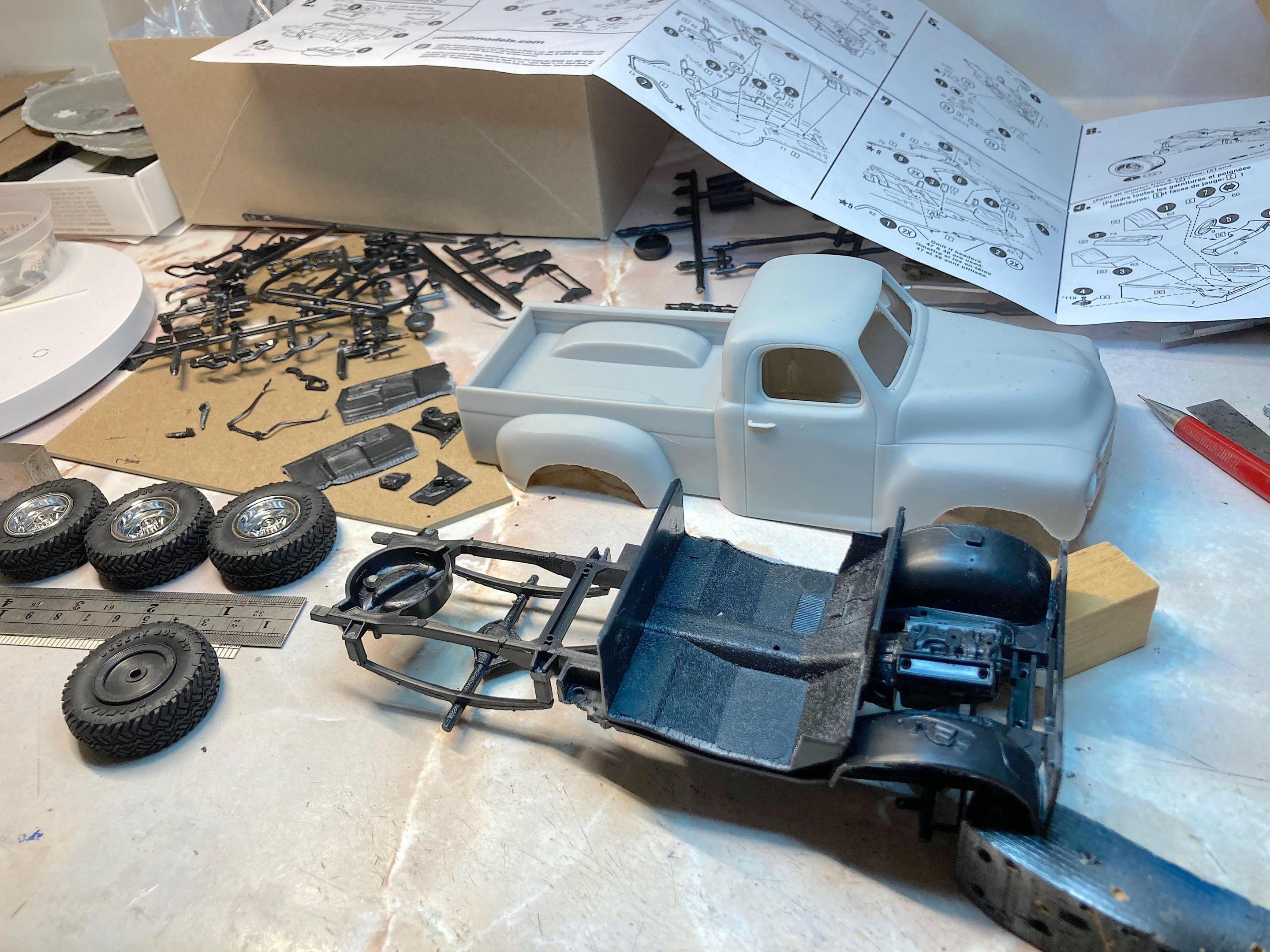

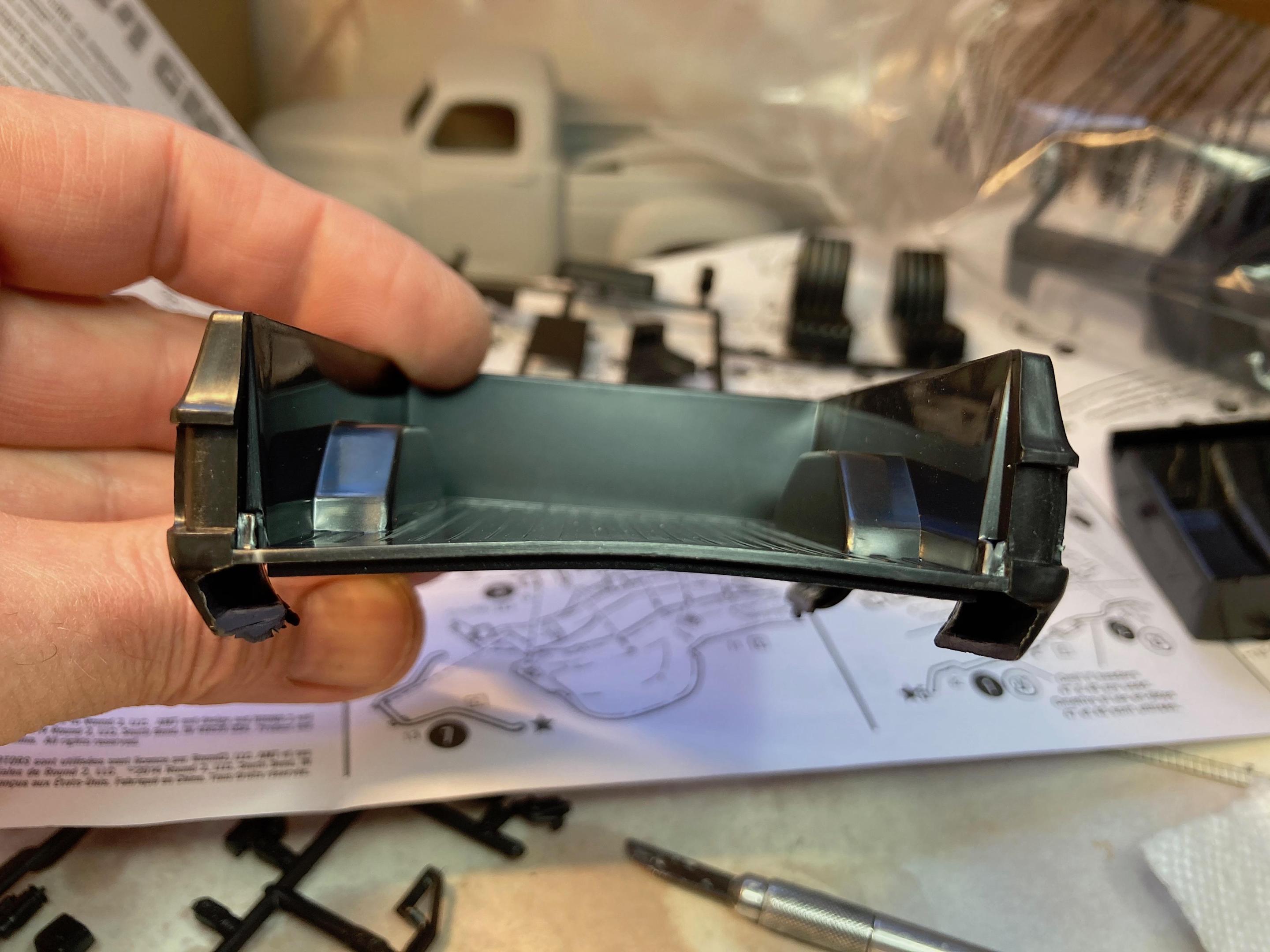

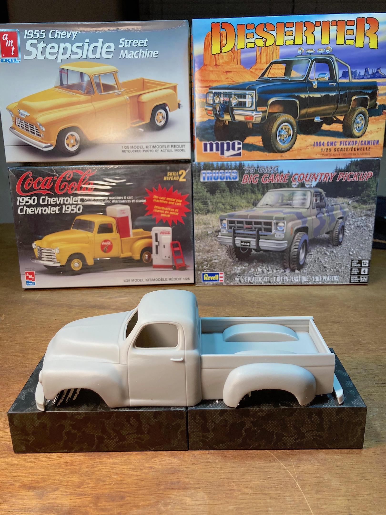

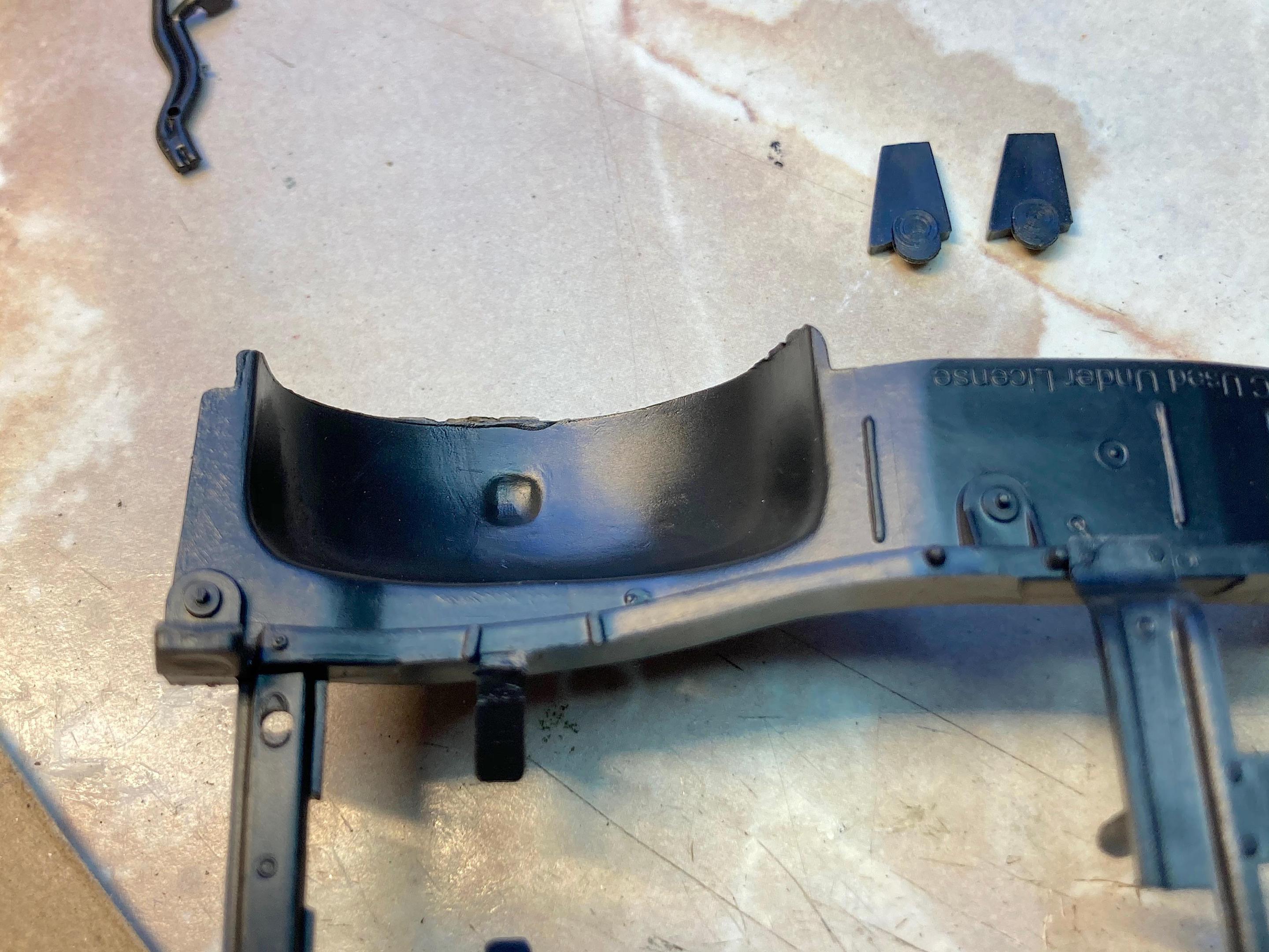

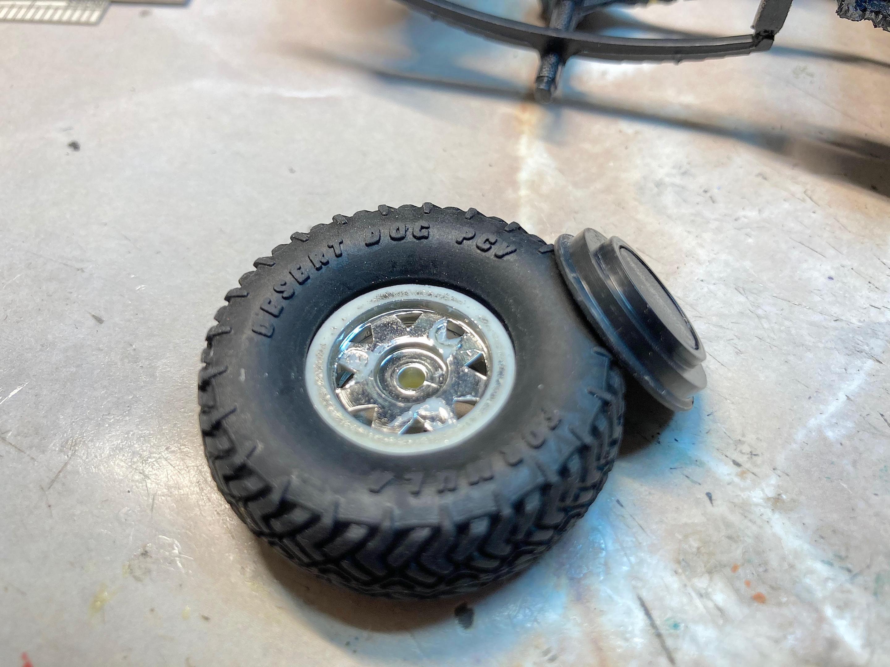

  1. Always had a soft spot for these Studebaker pickups, when I saw this new 3D printed 1953 body by Andy Lesiak , I *had to* get it. Evaluated what to use for a donor kit, decided on the MPC "Deserter" '84 Jimmy, because I'm not a fan of the Square Body era, especially the stacked quad rectangle headlights (I own a '68 Chevy C-10 so I'm extremely biased ?). The Studebaker bed is designed for a Pro Street build, that is going to get revamped. Was thinking of using the floor of the GMC bed, but this nixed that idea. Right off the bat, encountered bad engineering, the rear perches for the front suspension, no left/right, so slight modification required. Glued parts that are halves together, for now not cleaning up, goal is to do a mockup. Found the engine has left/right valve covers, but the instructions don't indicate such. Puttied some sink marks already. Rookie builders might get ticked off about how the wheels might not turn when assembled. The ejection pin marks needed to be scraped down. The part numbers on the tree are screwed up, there is a front/rear axle retainer with different lengths, the same number was on a front and rear part. ? The other thing about the wheels, they are about 1/16" wider than the tire beads. Can't just sand down the rim, need to evaluate what to do, this can't stand! Used the hotwire to cut off the door panels, modify the gas tank, and cut up the firewall part. Temporarily glued the drivetrain together with globs of Titebond glue. The instructions are useless for showing how the front leaf springs mount to the front perches, there is no positive connection, so the first mockup will determine what to do next. In fact, there is about 3/16" of play front-back to fix the front axle, I guess in this case with the different body that's a plus! I know the body will be painted a patina turquoise, with different color rear fenders, and will add some dents. The interior will have to be scratch-built, have a VW Bus bench seat which should suffice, dash will take more work, and door panels are simple enough. No emblems, street rods usually have that stuff shaved, but that hood ornament is cool, have to make that! Taillights are simple. Was planning to use the GMC mirrors, brush guard, winch.
  2. Stumbled upon this 3D printed 1953 Studebaker pickup that Andy Lesiak posted on Fakebook. He can also do a 1957 version. I've always liked these, didn't think twice about it. No interior, but it's simple enough for me to scratch build. Will post pictures when received.
