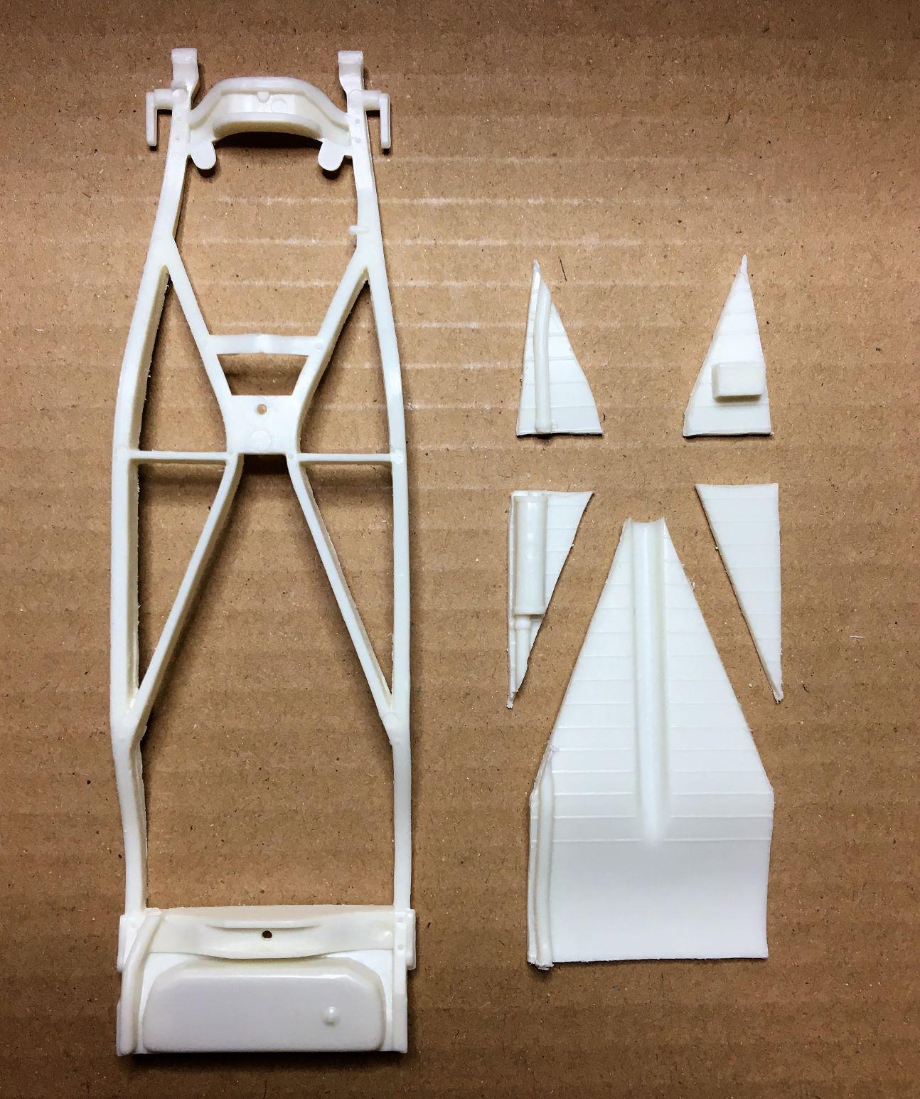

  2. I want to make a cool late 50s or early 60s hot rod/show car from the venerable AMT '36 Ford kit. 1: First thing I did was to remove everything from the frame, this was easy, drag the backside of the blade until through, we all do this opening doors and trunks. 2: Then I needed to replace what I removed but add it to the fender unit. I used styrene as thick as the kit floor. 3: To make the bend in my new floor panels, I filed a groove into it where it will bend. 4: Here's how it bends, I held it at the angle I needed then ran some Tamiya thin glue into the groove and held it for a minute or two. 5: Now it's part of the fender unit. 6: Here's how the interior tub will fit over it.
