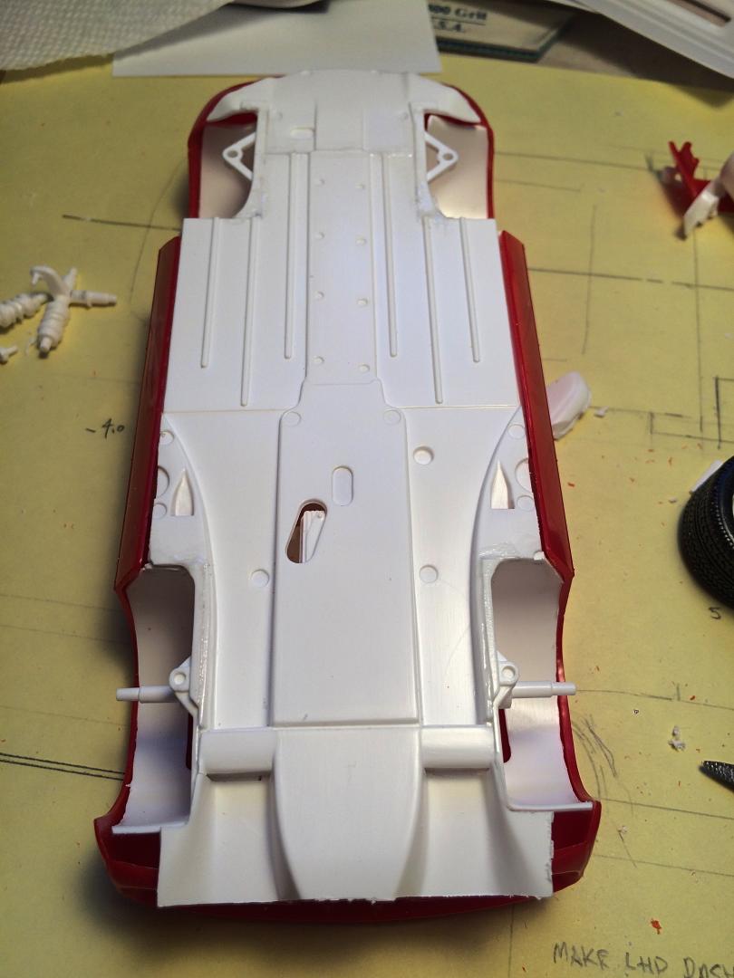

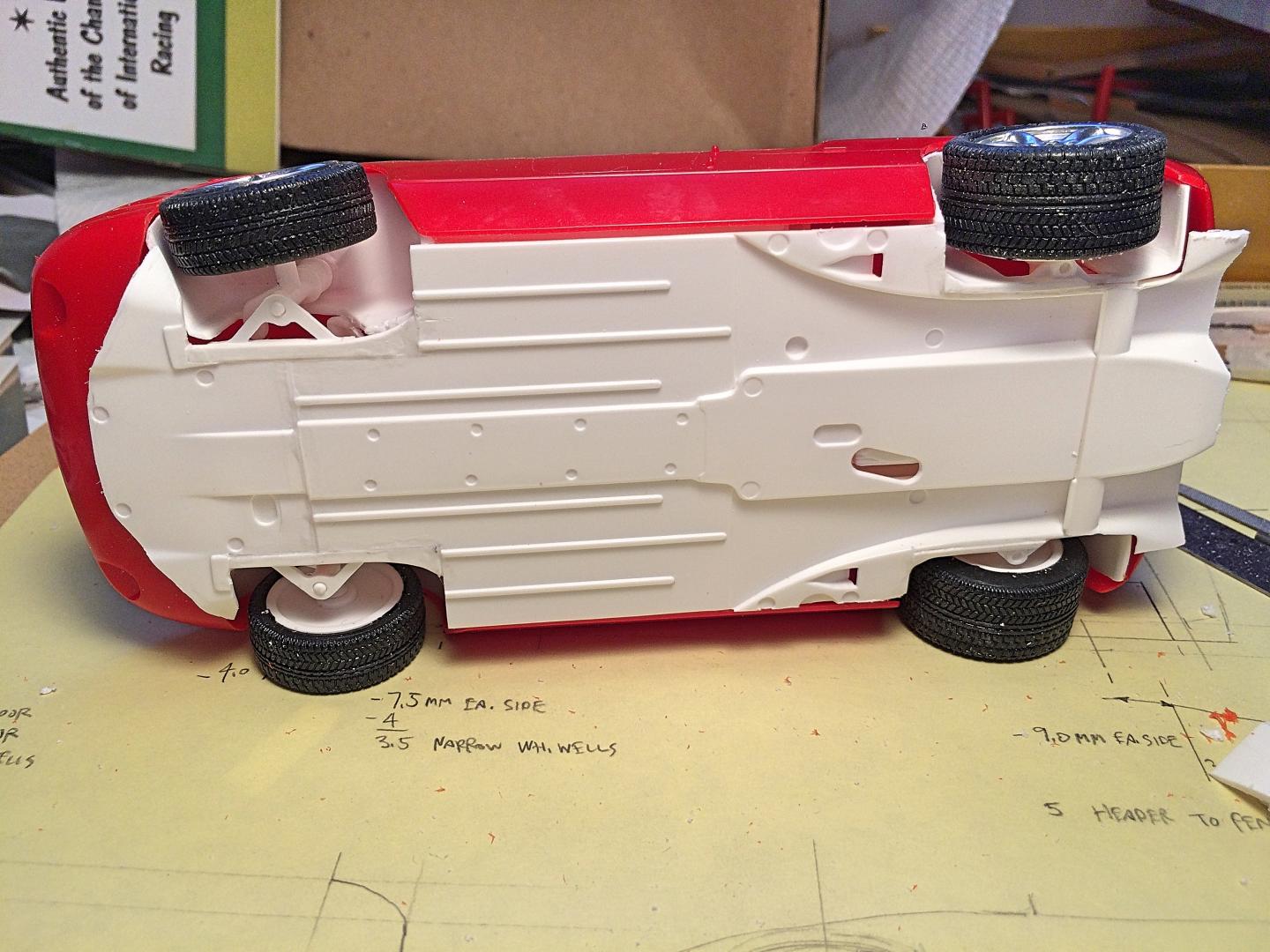

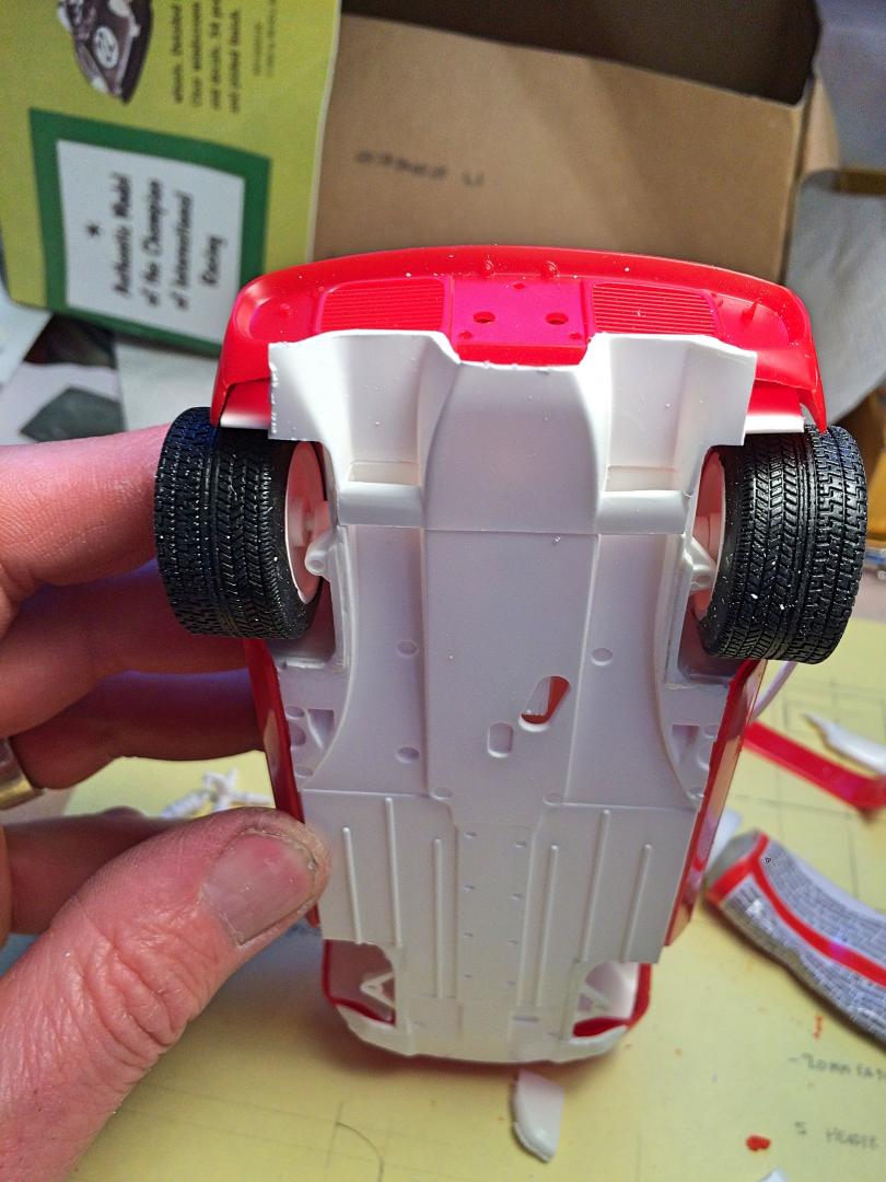

  1. Kitbash of the classic Monogram Ferrari 275P curbside/slot-car, a 1990 reissue of the 1964 kit, and the Revell 360 Modena Spyder that is sort of a curbside since the hood did not open, but had a window over the engine. Work In Progress I found the 275P at a Phoenix model swap last month, then saw the Modena and it was crazy time. Started Tax Day with a mock up, started butchering on the 18th, worked like a dog until the 3rd at Noon, just before heading up to GSL, 132 hours. I did rush it, could have spent a couple of weeks sanding and polishing, and it would probably would have ended up in the box like a few other projects. I just wanted something different than the typical super dooper shiny muscle car on the table. I didn't have time to write a build document, but had this for the description: Blasphemous and sacrilegious kitbash of a historic Ferrari race car that won Le Mans two years in a row, and another Ferrari that only has a 3586 cc 395 HP V8. Story is, this car was found in a chicken coop somewhere in Venezuela, missing the 3285cc 320 HP V12 engine and transmission, the aluminum tub was badly corroded from chicken poop. The Modena was bought at a tax auction, it was rolled by the drug dealer during a police chase. Built by a shop wanting to do a reality TV show, but never got funding because it’s just a Ferrari and not an American muscle car. Some of these pictures were taken at Page on the way home.

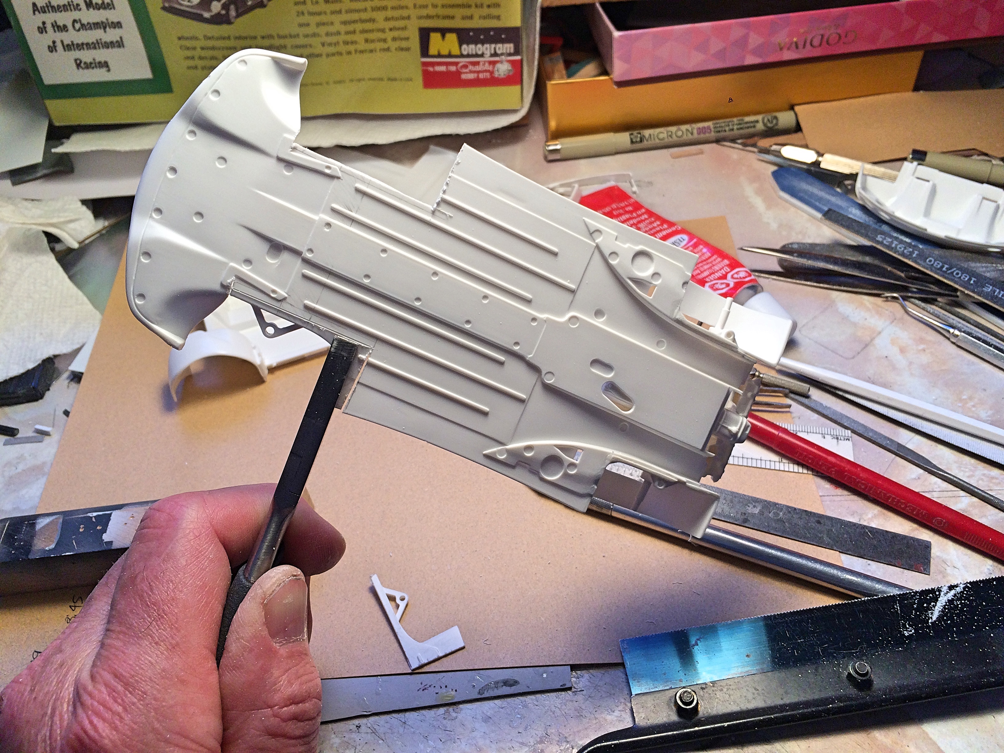

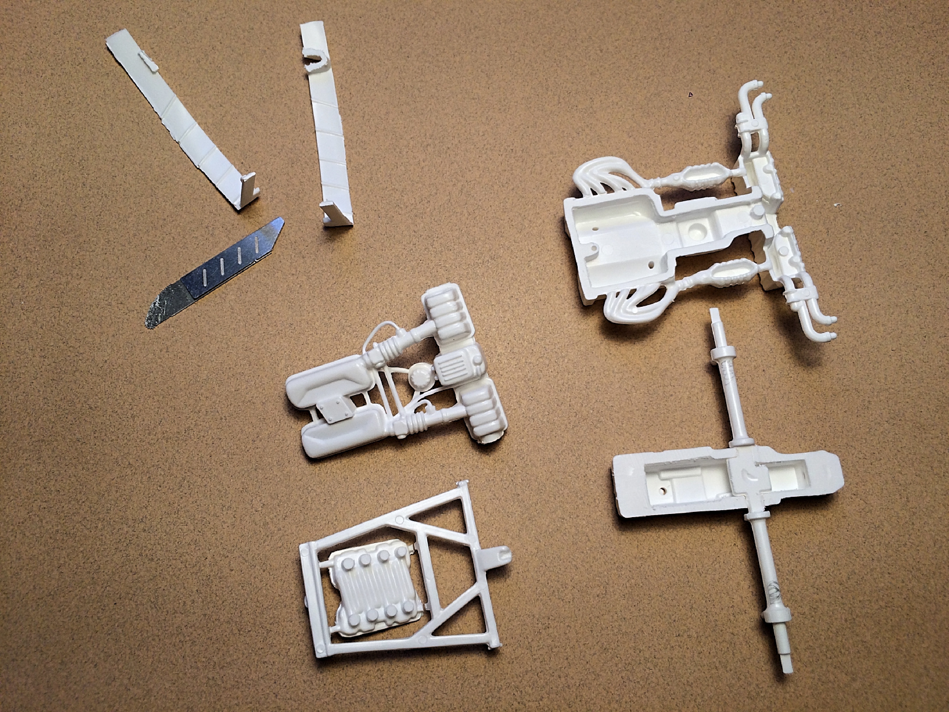

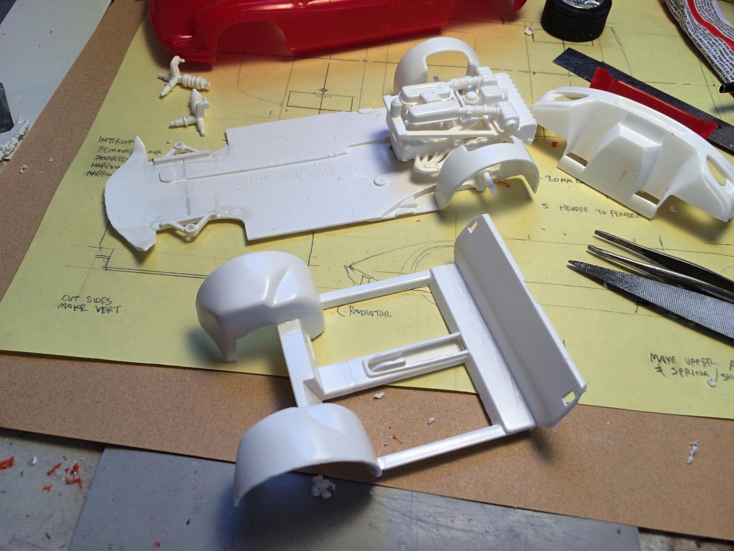

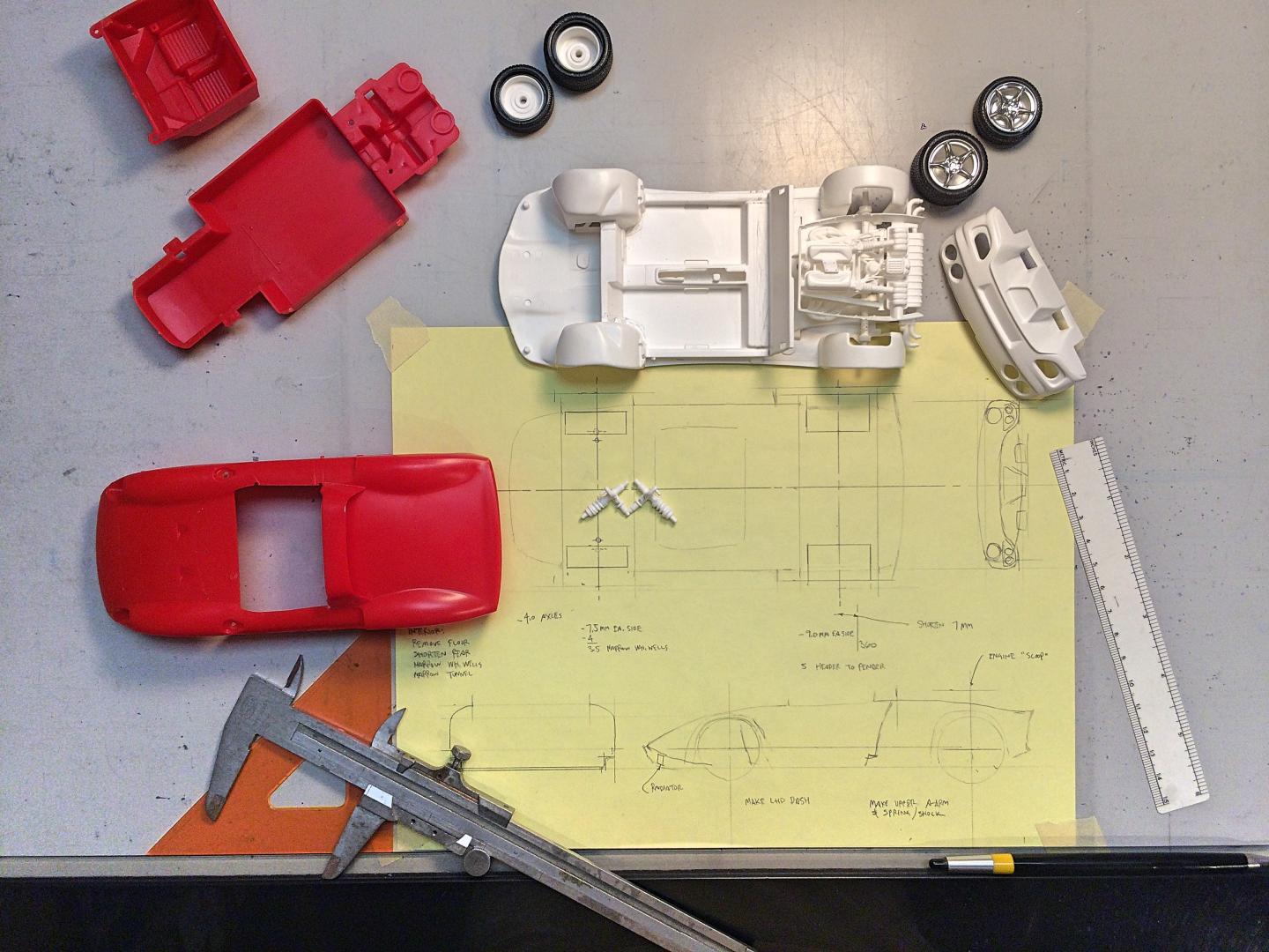

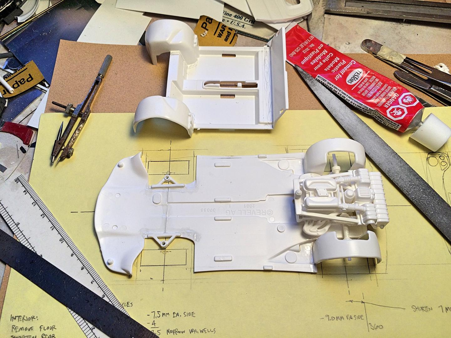

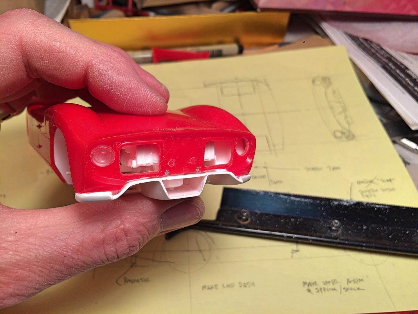

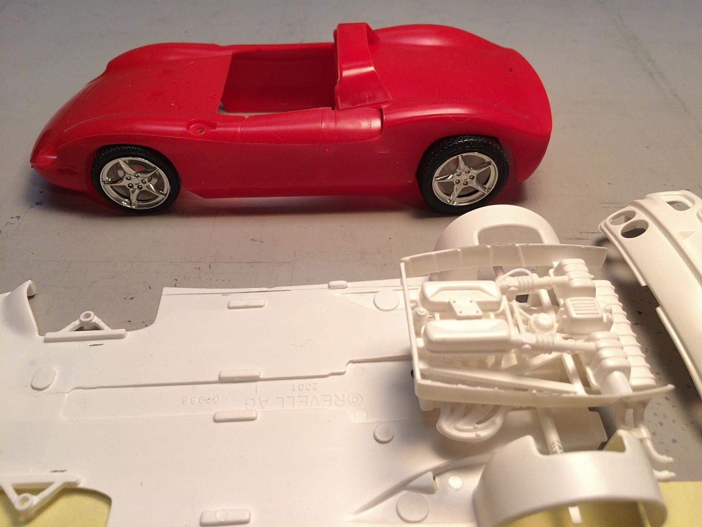

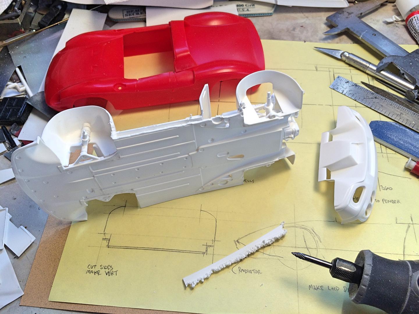

  2. Gestation happened in my Monogram Ferrari 275P vintage kit review thread. I started by barely tacking the engine together and onto the chassis pan. Measured and drew plans to figure out where to chop and modify. I thought cutting down the engine components would help, and considering the way Revell engineered it, nobody would notice. Each surface was filed down before reassembling with just a little more glue, but still can separate to paint. Cut apart the plenum, air filter and canister part. Sawed off the engine bay sides. I sawed, and in some cases scribed and broke apart the chassis pan. The suspension is really non-existent, lower A-arms were easy to relocate. The back has been narrowed. Shortened the pan behind the front axle line. I glued all this with regular toxic Testors glue, and Flex-i-file liquid cement, much like welding. That way if I needed to adjust, could pull apart, and I could squirm it around for adjustment (supergluing does not allow this). I used the Dremel with this bit for everything, here I just removed the edge of the pan. I really cut apart the interior tub, with a saw, and filed down and straightened the cuts. I needed to keep this as a separate piece, for being able to get the struts in later. I tacked parts onto the pan, but welded all together as I went. I adjusted my plan as needed, kept the tunnel which will need some modification to the chrome trim part. I really like the tunnels, so cut off the rear body part, made several saw cuts. Front of the pan was sawed off, some Dremel grinding to shape, real rough at this time. But it all fits in great, and don't need an engine hump! Thinking of how to add fender flares, simple round bumps most likely. Still need to shorten front axles. Modified the rear, decided to keep the original grills, but going to be modified at the bottom, and will be mesh. Drilled holes for the Mondial taillights, have also done for the headlights. The valance edge will be refined later. I was going to have the exhausts exit through holes similar to the Mondial, but it will be easier (I hope) to direct down from the mufflers into the tunnels, and then back. Now I need to leave it alone, so the cement will cure. I discovered the body is twisted, so need to consider how to straighten with strategic body mounts using screws. The fender flares will be fun. Interior should have simple door panels, and dashboard. Need to figure out the radiator in front, thinking laid almost flat, with channels exiting before the wheels. Then when all that is done, cut off the engine lid, and then will need to fabricate chassis box thingies and framework continued from the engine part. Two more radiators in back, modify the body ducts. Then exhaust pipes. Then seats, I got some cool aftermarket units at the DSC show. Color, Ferrari red with a pearl overcoat. Dann will hate that.
