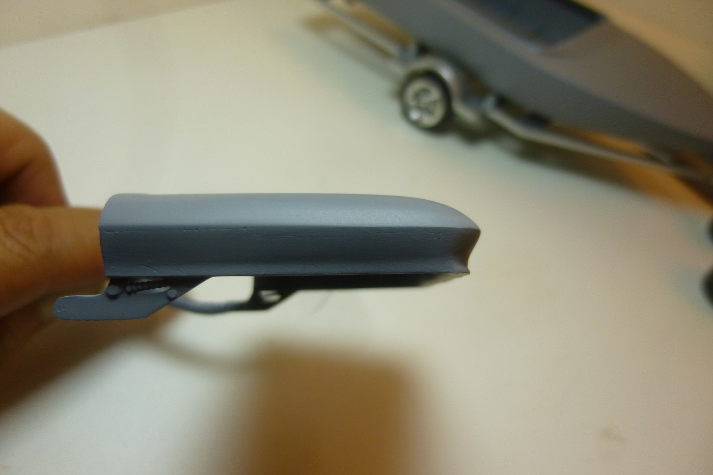

I moved back to the boat so I didn't get any more aggravated with the truck and it's wonderful hood. I got the boat re-primered, and sanded down a couple of spots that needed a bit more attention. The area where the water pickup will go had some bad scratches, so they got taken care of....

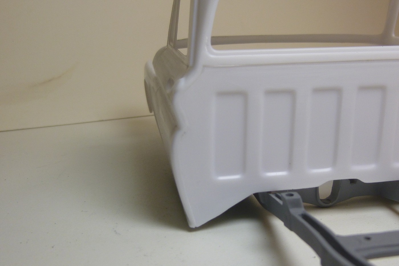

I glued the back of the cab in place to insure that I had the warp straightened out....
And I cleaned the glue joint up a bit on each side. I don't want it smooth, since there is a nice seam there on the 1:1 truck, but I don't want it looking nasty either!
Some more primer laid down on the boat, it's looking like it's ready for some Candy Silver once the primer cures!

I got some more primer thrown at the boat (It's now as close to perfect as I'll ever get!), the cab and the hood. The hood needs some filler for the pinholes on the passenger side, but otherwise is in great shape, and fits great!

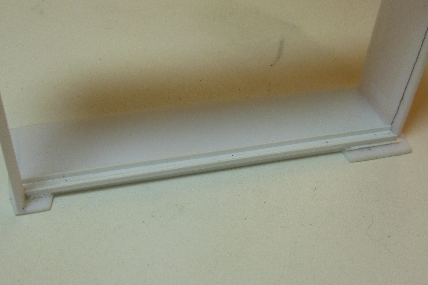

Next up is getting started on the bed. I glued some angle strip on the side of the bed, two pieces were used. I'll have slats on the top and bottom of this bed, unlike the '50 Chevy which had one solid piece of basswood on the bottom and slats on the top. I'm also going to have a piece of .030 sheet styrene between the pieces of basswood this time around, mainly to have something to glue the retaining straps between the pieces of wood to.
If you look closely at the angle styrene glued to the bed, you'll see that it has a ripple in it...the bed wall is still not flat, even after all that sanding! I'll sand the angle piece to straighten it out once the glue has fully set, maybe it'll satisfy my OCD over things like that!
A quick mock-up with two pieces of basswood and some .030 strip, it fits between the angle retainers perfectly!
I added the top angle strip to the other side of the bed, but not the bottom yet, I was waiting for the two pieces of .030 strip to dry on the bottom edge. Since it was recessed there, the lower strip would end up too far away from the basswood slat to hold it, so I brought the bottom edge out to the level of the rest of the bed sides.
And a shot from above, that's all for the bed tonight, gotta make sure the glue is good and dry before I do the rest of the work on it!

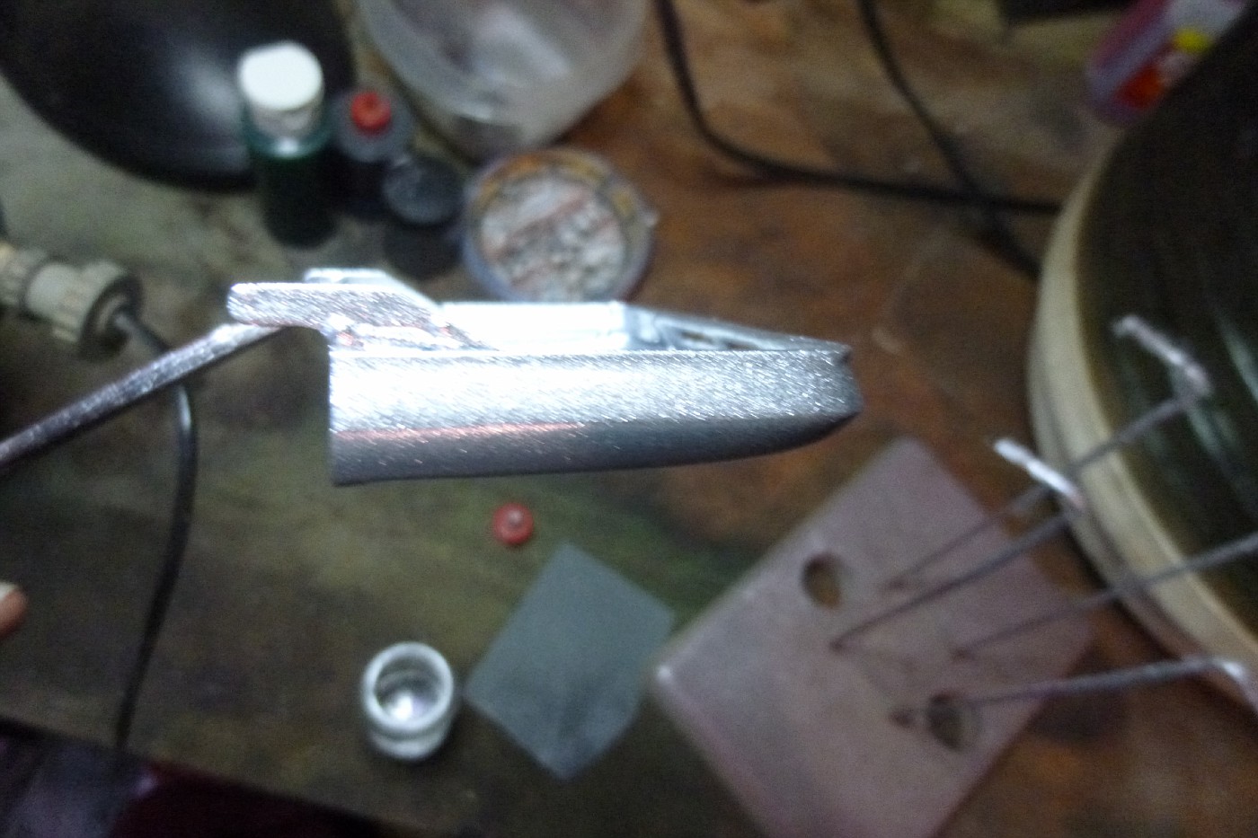

The first coats of Dupli-Color Candy Silver have been laid down, and so far, we're looking pretty good!
I've got a bit of debris to clean out of the slots out front, but that's the biggest issue I've got so far!
And the cab. Everything took a ride in the dehydrator for about last two hours, so I'm ready to mask off the cab, hood and boat so I can lay down some Candy Apple Green!
I almost forgot, the dash will be Candy Apple Green too, so it got some Candy Silver!
I got the boat masked off and painted, now to let everything cure, hopefully I'll be able to throw some Clear on all this stuff in the next few days!

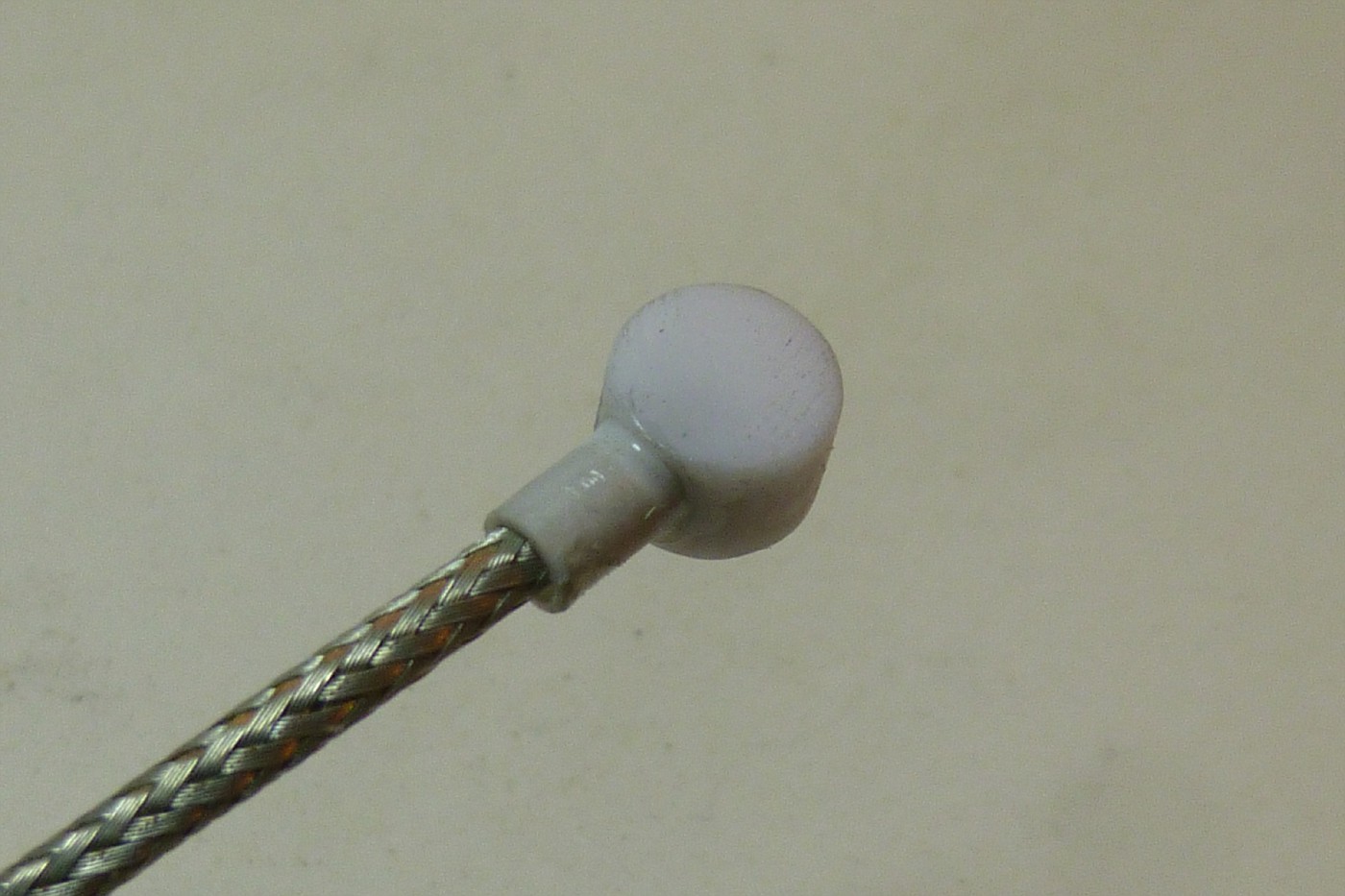

Next, I got started on the water pump for the boat's motor. I figured on something simple, an intake tube for the water, and probably a piece of 16 or 18 gauge wire for the "legs" that will go into the block on either side of it. I'll also have to drill a hole in the timing cover for the shaft coming out of the back side of the water pump, but that will be the last part of it. I may just put the pump directly on top of the timing cover so I don't need a shaft, we'll see when I get to that point.
I started with a piece of a parts tree, I used one of the huge rods at the ends of some of the trees. I drilled a series of progressively larger holes in one side until it was large enough to accept the tubing I'll use for the intake...
The intake tube glued into the new water pump, and a piece of braided line shoved into it for good measure. Not a bad start, I'm getting pretty good at this scratch-building stuff for sure!
And the water pump held up to the engine to see how it's gonna look once it's all done. This is about the angle I hope to have it at when it's finished...now to make the "legs" and get it painted!
I got the boat's water pump completed, I started by cutting a groove in the back side to run a piece of wire through.
