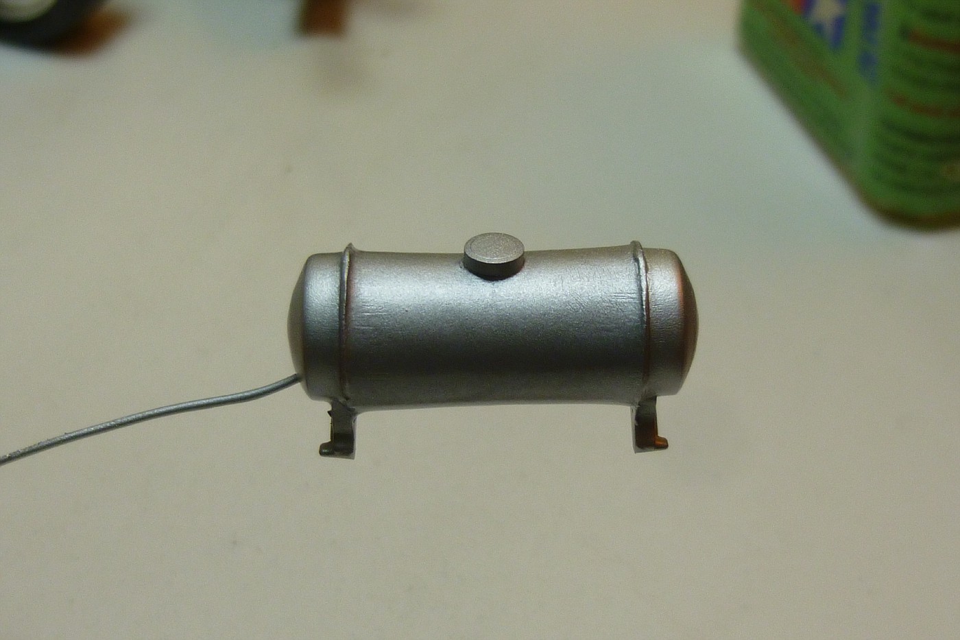

I got the fuel tank for the boat finished. I made a gas cap for it (Like the one I used on the '50 Chevy Pickup), drilled the tank, glued the cap on, and painted it with some Metalizer Aluminum Plate. It's all buffed out and ready to be installed!

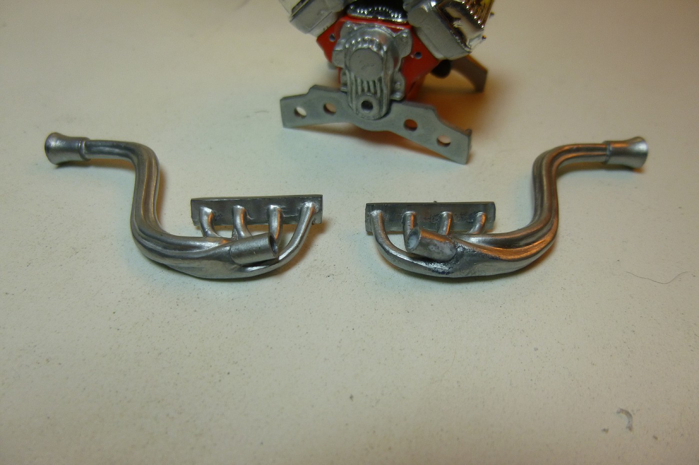

I got my exhaust pipe drilled out, painted with some Metalizer Stainless Steel, buffed and installed on the frame. I also got the exhaust manifolds painted (Stainless Steel & Burnt Iron), and installed on the engine!
Next up was gluing the engine in place and getting the exhaust glued to the manifolds. This was not an easy task, trust me! I held the glued joint together for almost an hour, then jammed an X-Acto blade between the crossmember and exhaust to keep it straight...it seems to have finally worked! :banghead:
